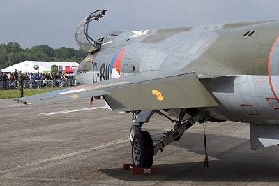

The Kinetic F-104 has a very serious shape issue. The fuselage shape where the air intakes run is completely screwed up.  The intake ducts on the Kinetic kit ends way to early, whereas on the original, the ducts extent to the very rear of the wing.
I haven’t heard anything about the fuselage being screwed up, but regarding the intake ducting not going all the way to the engine, the Hasegawa kit is not better in this aspect.  Both kit intakes end at a blank wall, but at least the Kinetic kit has some interior ducting, and with the curvature of the ducting, you really can’t see anything anyway.
Posted (edited)
Dave,
my post is confusing. I mean the outside shape of the fuselage, where the intake ducts run. The pictures, although not the same angle shows the problem with the Kinetic kit.
Thomas
Edited by Thomas
Thomas, I’m inclined to agree with you regards the fuselage shape. From the first CADs and sprue shots the shape issue stuck out like a sore thumb, however Raymond from Kinetic said it was a trick of the light whilst photographing the sprues and was done intentionally( why would you do that, and doesn’t explain why the CADs show the same flaw?) I’m waiting to see some actual builds of the kit/s to see if the issue is there, but to date I’ve only seen the one build over on BM and unfortunately I can still see the issue.
Raymond from Kinetic mentioned in the FB thread on the forthcoming release of the TF-104G kit as he was asked by a member if the fuselage shape issue will corrected, that it will happen. Unfortunately it is unclear, if also the single seater parts will be addressed. When you google Kinetic F-104 you will find some builds, where the shape issue pops out, like this one from Kitchecker:
When you compare it to the original it is so obvious:

And while researching the issue, I got the impression, that the Revell 1/72 has a similar issue with this, but a little less worse.
Thomas

The shape issue might also caused a problem with wrong panel lines in the transition between fuselage to the rear wing connection. The rest of the kit looks superb, as some other people already mentioned. I cannot check the dimensions of the Kinetic kit, as I don´t have it.
