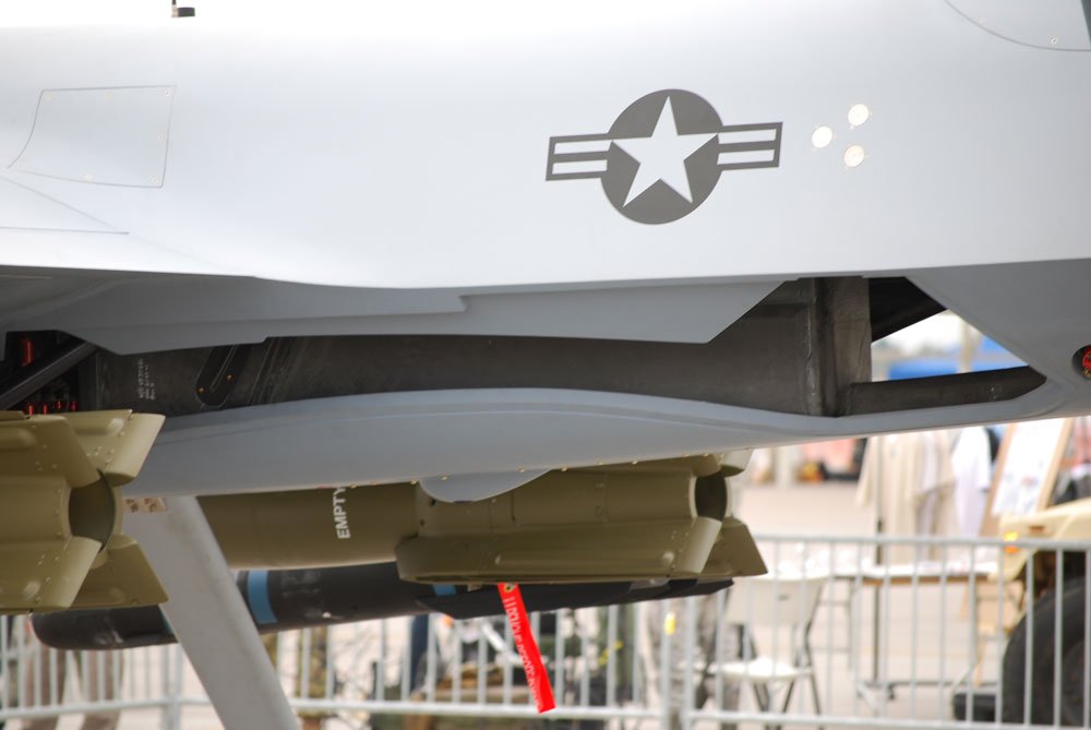

Thank you Rob, soo useful. The kit's bay shape is quite wrong, something I overlooked at first but now I can't say I don't know :rolleyes:
As it comes in the box, note the sharp angles, as if the Reaper was a stealth fighter :)
After modification, the outline is much smoother
And I added the inner center beam
Next time I'll do this before I join the fuselage, this was a bit annoying at this late stage but well worth the effort, thanks Rob again for the input! :thumbsup:
