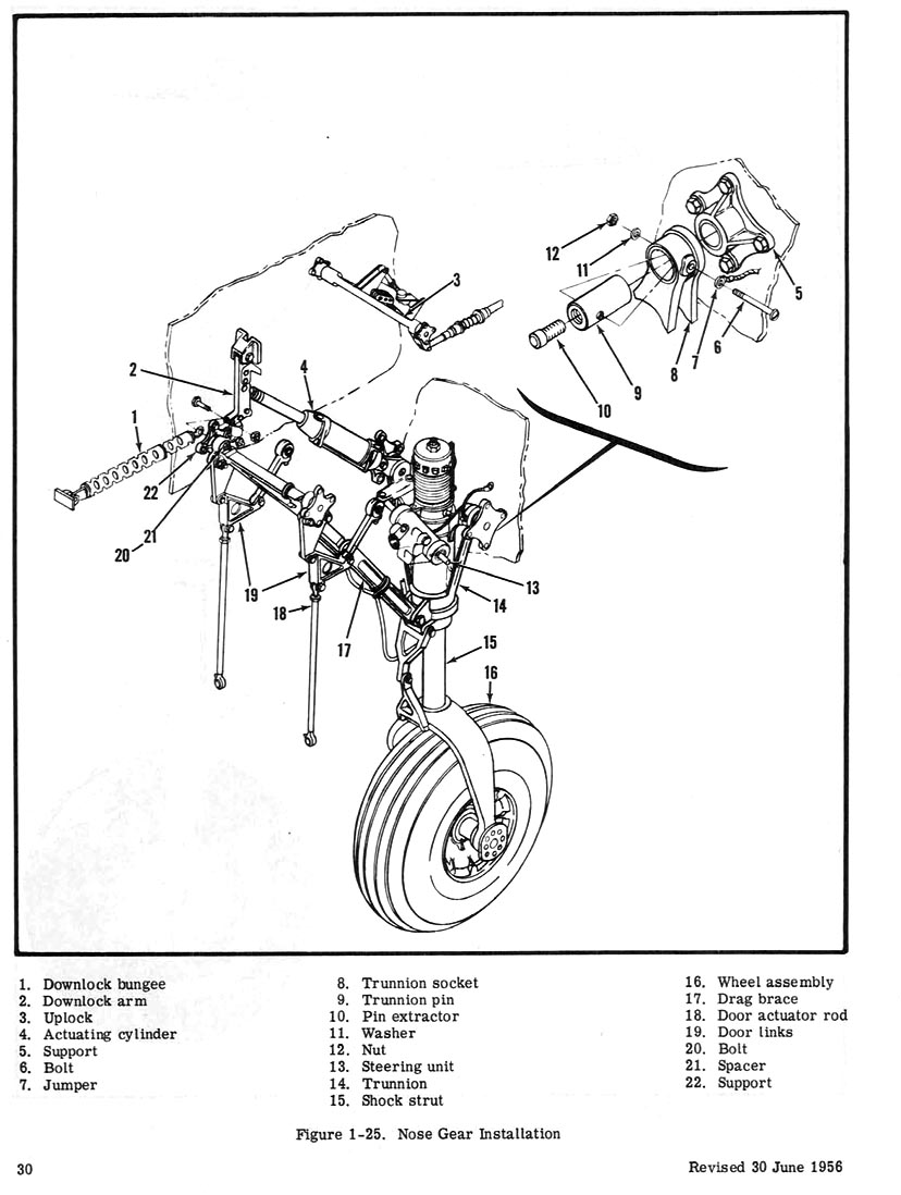

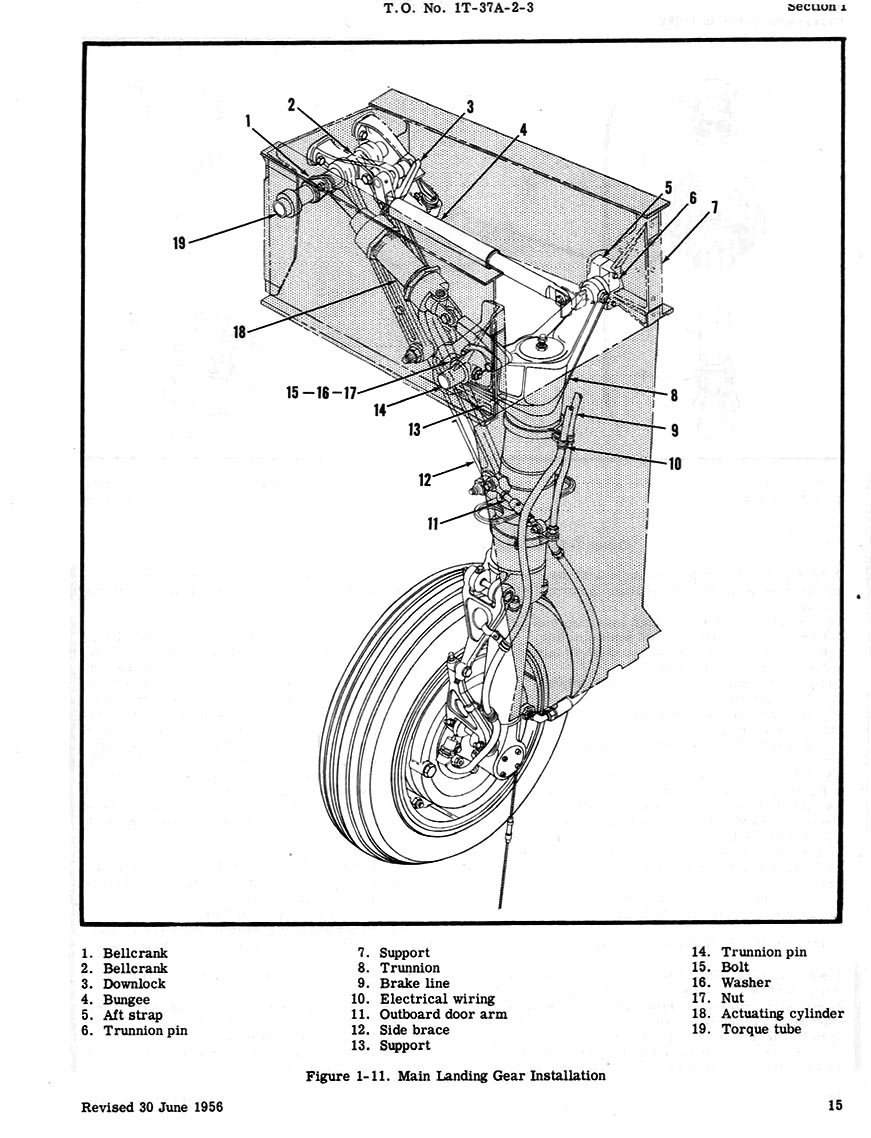

Ben Brown Posted December 10, 2024 Share Posted December 10, 2024 Here ya go. Courtesy of Cessna about 30 years ago. Ben Quote Link to post Share on other sites

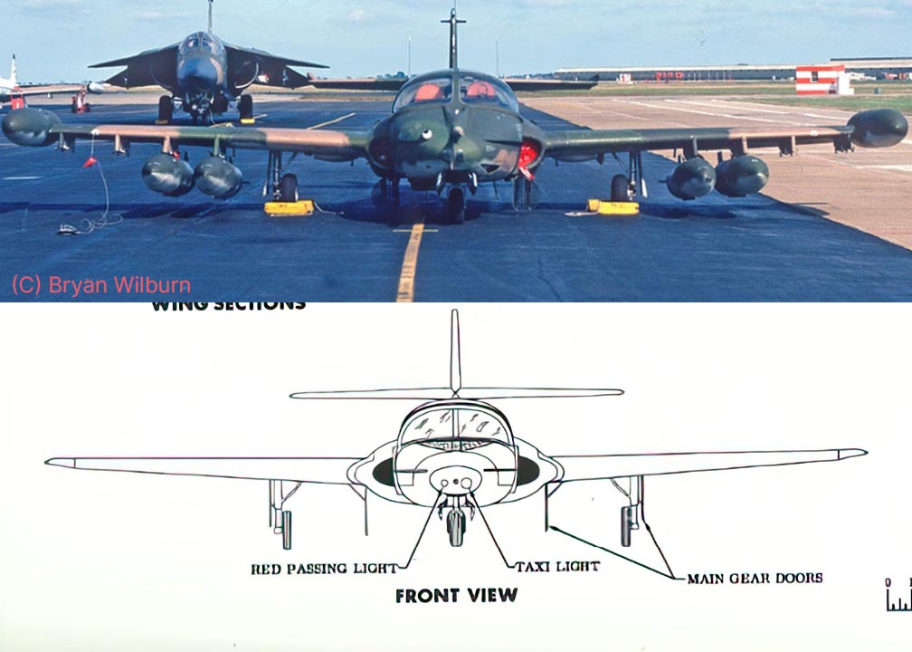

Ben Brown Posted December 11, 2024 Share Posted December 11, 2024 I was under the impression that the contours of the upper part of the fuselage around the engines are the same on both jets and the A-37 has a deeper fuselage under the wing for the bigger engines. Ben Quote Link to post Share on other sites
BWDenver Posted December 11, 2024 Share Posted December 11, 2024 5 hours ago, Ben Brown said: I was under the impression that the contours of the upper part of the fuselage around the engines are the same on both jets and the A-37 has a deeper fuselage under the wing for the bigger engines. Ben Possible, It would be nice to have a nose on shot of a t tweet. Some photographs indicate the intake area and lower fuselage was "flatter". Or at least it appears that way based on the 3 view. Quote Link to post Share on other sites
BWDenver Posted December 11, 2024 Share Posted December 11, 2024 Not sure if this helps or not, but the 3 View v the A-37 front shot Quote Link to post Share on other sites

Ben Brown Posted December 13, 2024 Share Posted December 13, 2024 On 12/11/2024 at 2:14 PM, BWDenver said: Not sure if this helps or not, but the 3 View v the A-37 front shot That helps. I haven’t been able to find any section drawings of the A-37 to compare, but I haven’t been really looking very hard lately. Ben Quote Link to post Share on other sites
