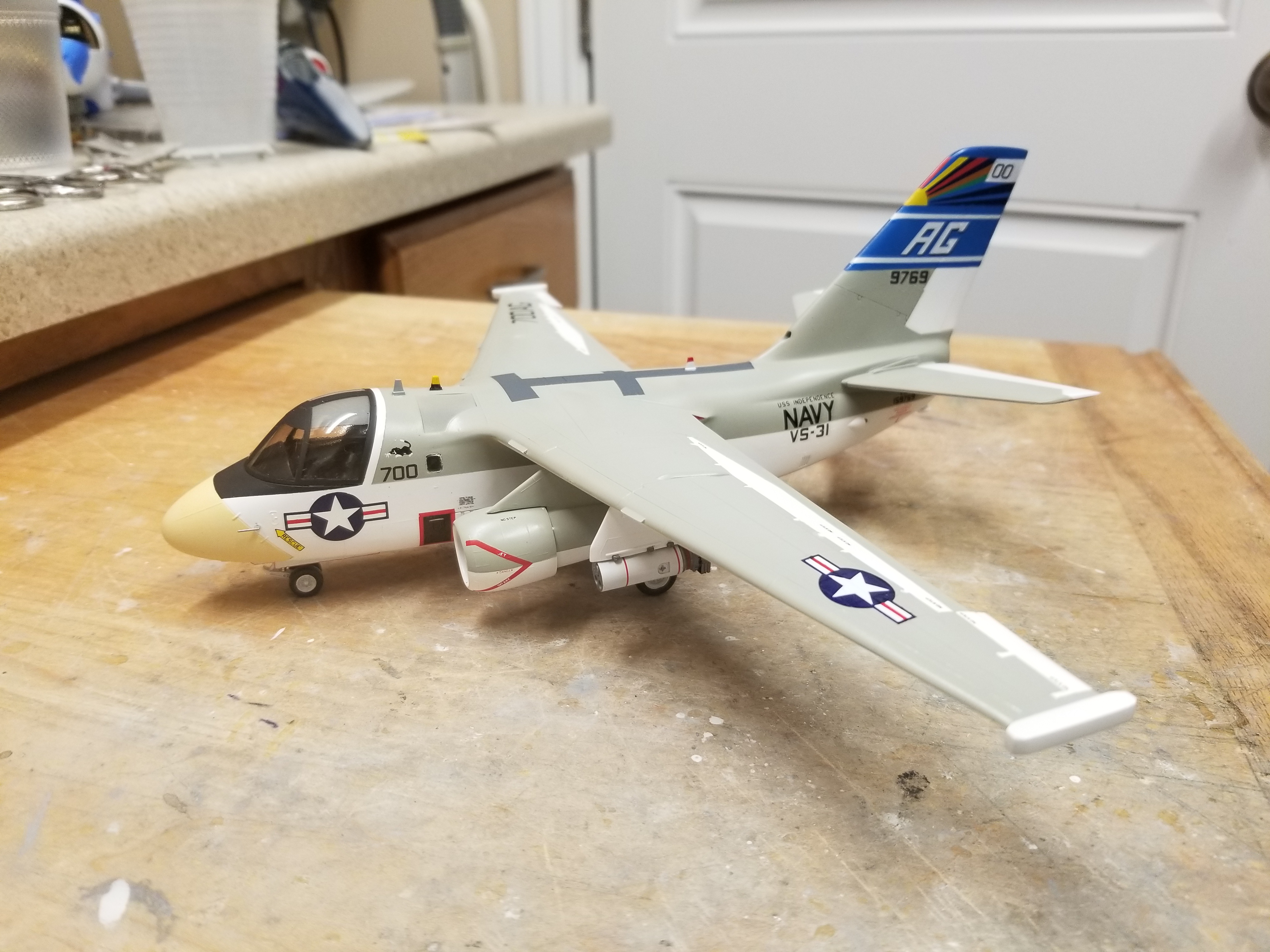

f5guy Posted August 29, 2025 Share Posted August 29, 2025 13 minutes ago, eraucubsfan said: Funny, I thought he had them but couldn't find them. Thanks, for the lead, I did contact him on Ebay and we'll see what happens John did do them, along with several other types of mines. His 3D stuff is top notch and very reasonably priced. I built this very old Hasegawa kit with a couple of his mines on it. HTH, Fred. Quote Link to post Share on other sites
usmcski6502 Posted August 29, 2025 Share Posted August 29, 2025 I’m surprised those Zunis never caused any problems with the engines, or did they? Ski Quote Link to post Share on other sites
