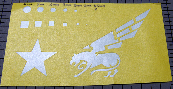

4 hours ago, crackerjazz said:
Hi Richard, I see there's a 0.5mm hole as well -- the Cricut Explore Air 2 can do that?   And what type of masking material is that?
Yes, it can cut a 0.5mm hole, but the edges of the hole are pretty rough since the hole is so small.  I would say the smallest diameter it can cleanly cut is 1.0mm.
Masking material is your basic Tamiya masking sheet, which you can get from here or here.
Thanks Richard.  Looks like it might even help for masking and painting instrument panels.  Does it help if I can make my own dxf or dwg files to operate one? And have you tried it on styrene sheet?

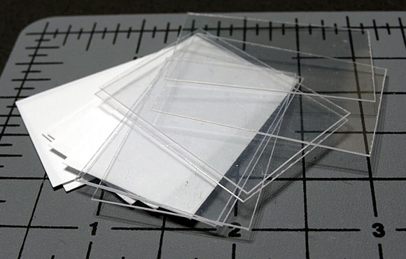

Yes, the Cricut software can import dxf files, so you are good to go.  I have cut styrene sheets (0.010 and 0.015) with it to make aircraft Head-Up Display and rectangular pieces for spraying paint samples.

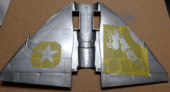

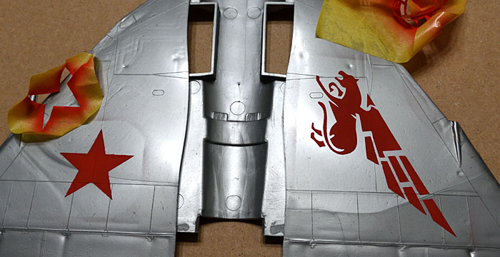

On 4/2/2021 at 9:48 AM, RichardL said:
Square holes, no problem 🙂 Not even intricate squadron insignia for that "painted on" look:
