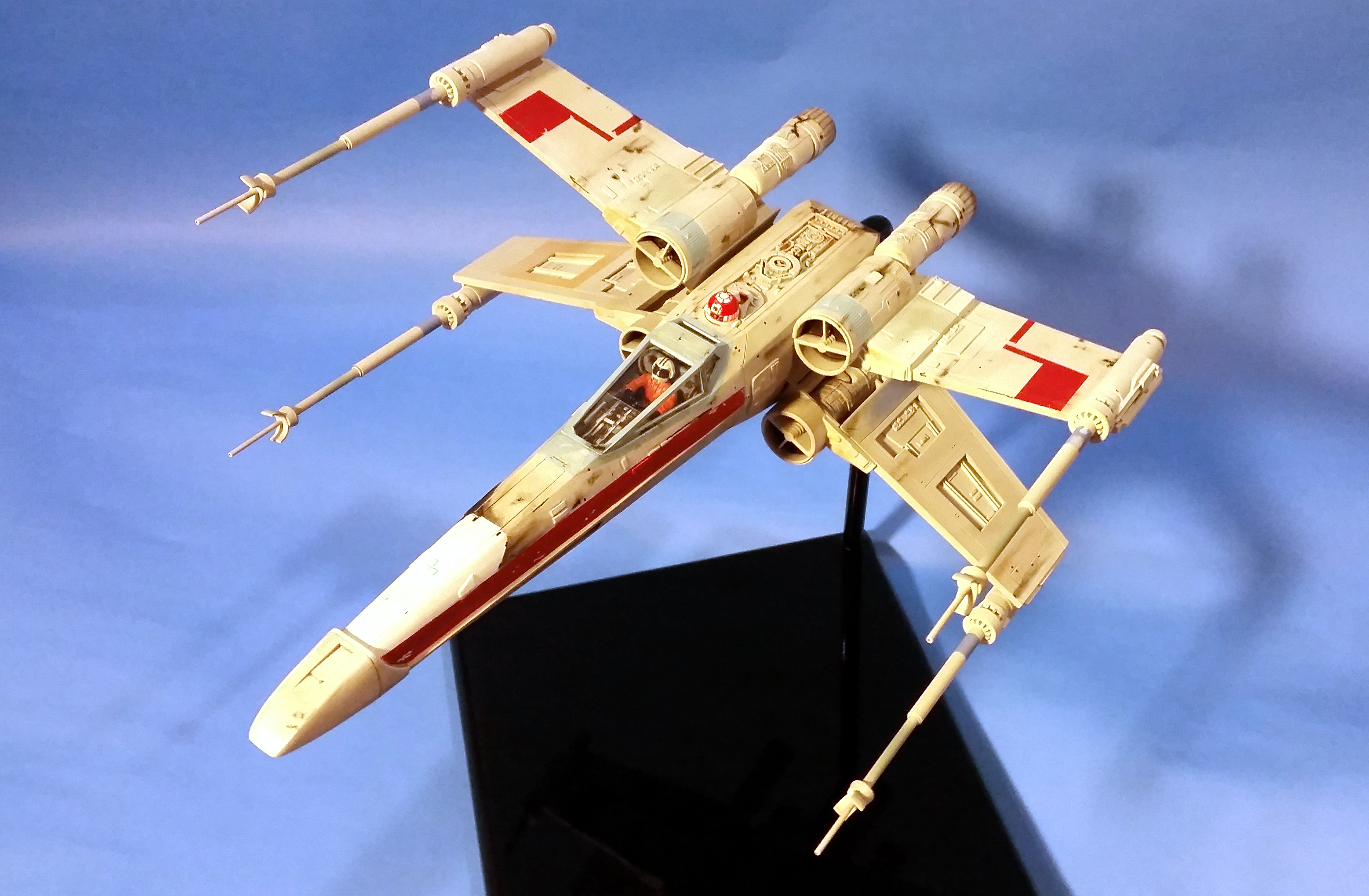

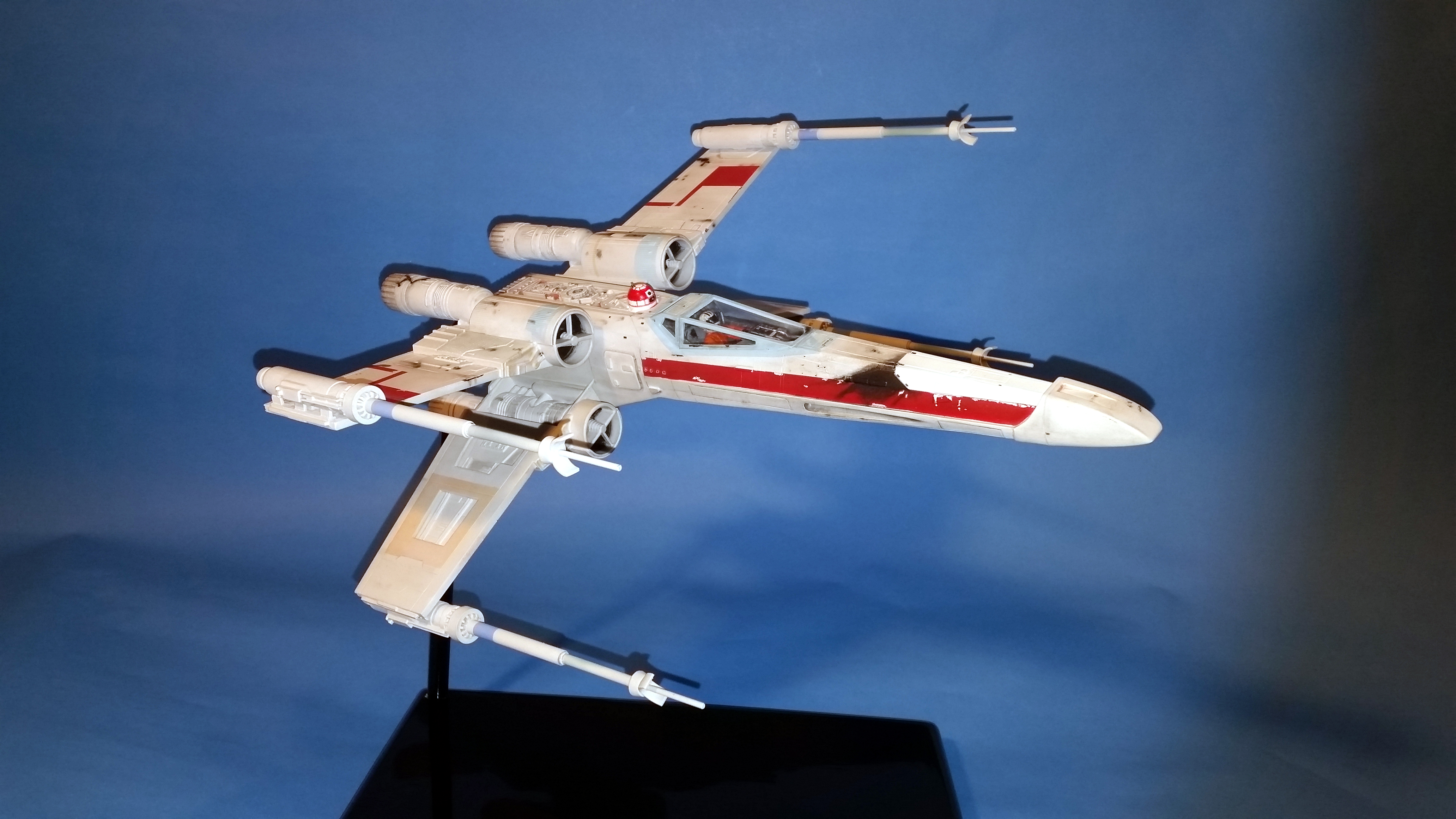

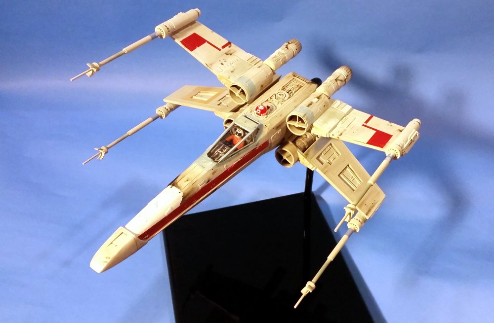

Jay Chladek Posted February 14 Share Posted February 14 OMG this is incredibly well done! Wish I had seen it when you were wrapping it up. I did my own Red Leader build during 2017-2018 using an original issue vintage MPC kit. But I went for more of a studio model look with the pilot: Quote Link to post Share on other sites
Andrew D. the Jolly Rogers guy Posted February 14 Author Share Posted February 14 4 hours ago, Jay Chladek said: OMG this is incredibly well done! Wish I had seen it when you were wrapping it up. I did my own Red Leader build during 2017-2018 using an original issue vintage MPC kit. But I went for more of a studio model look with the pilot: Jeez, that's definitely one of the best MPC builds I've seen, not an easy subject to tackle. Well done! Quote Link to post Share on other sites
Jay Chladek Posted February 20 Share Posted February 20 On 2/14/2021 at 6:52 AM, Andrew D. the Jolly Rogers guy said: Jeez, that's definitely one of the best MPC builds I've seen, not an easy subject to tackle. Well done! My pleasure. I went a little crazy on it as you can see. The engines were replaced with ones from an Estes X-Wing. I used parts from a second X-Wing kit to fix the kink in the bottom and made new proton torpedo tubes. This model acted as a bit of therapy for me in late 2017/early 2018 when some not so good things were happening in my life and it helped a lot. Quote Link to post Share on other sites
