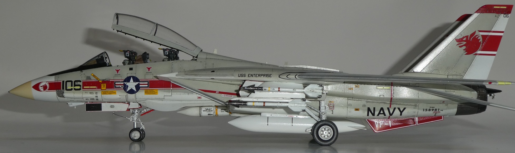

andrew.deboer Posted September 21, 2020 Share Posted September 21, 2020 (edited) I’ll be building my next Tamiya cat as one of the first in the fleet - VF-1 Wolfpack’s second 101 bird, which has been modeled a lot. Research is one of the things that really appeals to me in modeling, and this project has given me a lot to learn! For instance: the first VF-1 plane to be painted as NK-101 was this one, BuNo 158627. I believe it was a Block 65 machine. Note the radome without a tan front section, long gun muzzle trough (short cover), the black skunk stripe over the canopy and spine, completely white nose gear doors, pin striping around the NACA intake on the ventral fin, and “Wolf Pack” on the tail. These are all unique to the first NK-101, which was used for early squadron training; this plane did not go on VF-1’s first cruise. The next NK-101 was this one, BuNo 158989, a Block 80 (correction thanks to GW8345 - it was a Block 70). It can be distinguished by its long gun cover, black rectangles on the nose gear doors, radome with a tan section, no skunk stripe, different style of “NK” tail codes, and “USS Enterprise” painted on the wing glove. I could go on and on... Fightertown Decals have done both of these planes, but they kept the same BuNo for both - I think this is an error. VF-1’s Tomcats had the early style of beaver tail, which has been released as an aftermarket part by Steel Beach and Phase Hangar. I chose the Phase Hangar item because it depicts the beaver tail without the dielectric panels. These covers apparently did not like being so close to the engine nozzles and it was common to see them removed. More specifics on the beaver tail here... Phase Hangar also makes the 7-vent early gun panel. The Bits & Pieces Tamiya F-14A #61114 Fightertown Decals #48080, Fightertown USA Part 2 Phase Hangar Resin Accessories #48060, Early beaver tail and 7-vent gun panel Quinta Studios Interior 3D F-14A Decals. I guess it’s typical to begin your build with a layout of the kit and any aftermarket, but I got a quick start on this kit and didn’t want to derail my progress. So I’ll put the bits together and take a photo of the mess. V Phase Hangar 7-vent gun cover. This is a drop-fit replacement for the kit part. I like to fill the panel lines on the kit and aftermarket parts with Tamiya Panel Line Wash to see how they compare and find any lines that need to be restored. V Phase Hangar early beaver tail. The panel lines are indistinguishable from the kit ones. Edited September 22, 2020 by andrew.deboer Quote Link to post Share on other sites

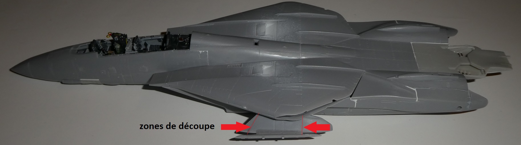

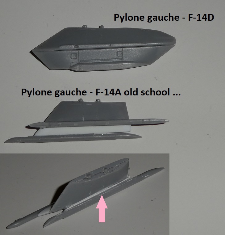

andrew.deboer Posted September 23, 2020 Author Share Posted September 23, 2020 Here’s something I won’t be doing: This shorty glove pylon is pictured under 158989. Quote Link to post Share on other sites

GW8345 Posted October 22, 2020 Share Posted October 22, 2020 (edited) On 9/23/2020 at 12:28 PM, andrew.deboer said: Here’s something I won’t be doing: This shorty glove pylon is pictured under 158989. One can make that pylon but you will need to do a lot of cutting. If you take the standard pylon in the F-14 kits, glue the Phoenix Adapter (pylon) to it and then cut it down to match the pylon above you have the early Sidewinder pylon. I don't have any documentations or dimensions for the pylon but going by the photos I've seen the early Sidewinder pylons were a one piece unit and the front had the same mold line of the MPP (Multi-Purpose Pylon, ie, regular wing pylon) with a Phoenix Adapter (Phoenix pylon) attached. The back looks like it was cut straight down at the trailing edge of the A station LAU-7 Adapter (upper Sidewinder launcher adapter/pylon). It looks to extend down from the A station LAU-7 Adapter about 8 to 10 inches. From everything I've been able to gather it appears that this pylon was very short lived, only being used during the Tomcat's first cruise and was not seen after 1975. Now some personal insight about the pylon. The MPP was a huge PITA to change, it required a Functional Check Flight (FCF) after it was changed due to flight controls having to be disconnected in order to remove the pylon. (the wingsweep swivels had to be disconnected, not something you wanted to do....ever) I've changed 2 MPP during my time in Tomcats and it took us a day to remove the old one and install a new on, that was working straight through, not going home at night (starting in the mid 90's the squadrons were not allow to change them anymore, it turned into depot level maintenance). I can understand why that Sidewinder pylon was short lived, in order to put it on you had to remove the pylon that was already installed so you couldn't do a quick "deconfigure/reconfigure" like you can today. The Sparrow and Phoenix used the standard MPP, only the Sidewinder (on the lower stations) used that special pylon. Edited October 22, 2020 by GW8345 Quote Link to post Share on other sites
andrew.deboer Posted October 29, 2020 Author Share Posted October 29, 2020 On 10/22/2020 at 7:17 PM, GW8345 said: One can make that pylon but you will need to do a lot of cutting. If you take the standard pylon in the F-14 kits, glue the Phoenix Adapter (pylon) to it and then cut it down to match the pylon above you have the early Sidewinder pylon. I don't have any documentations or dimensions for the pylon but going by the photos I've seen the early Sidewinder pylons were a one piece unit and the front had the same mold line of the MPP (Multi-Purpose Pylon, ie, regular wing pylon) with a Phoenix Adapter (Phoenix pylon) attached. The back looks like it was cut straight down at the trailing edge of the A station LAU-7 Adapter (upper Sidewinder launcher adapter/pylon). It looks to extend down from the A station LAU-7 Adapter about 8 to 10 inches. From everything I've been able to gather it appears that this pylon was very short lived, only being used during the Tomcat's first cruise and was not seen after 1975. Now some personal insight about the pylon. The MPP was a huge PITA to change, it required a Functional Check Flight (FCF) after it was changed due to flight controls having to be disconnected in order to remove the pylon. (the wingsweep swivels had to be disconnected, not something you wanted to do....ever) I've changed 2 MPP during my time in Tomcats and it took us a day to remove the old one and install a new on, that was working straight through, not going home at night (starting in the mid 90's the squadrons were not allow to change them anymore, it turned into depot level maintenance). I can understand why that Sidewinder pylon was short lived, in order to put it on you had to remove the pylon that was already installed so you couldn't do a quick "deconfigure/reconfigure" like you can today. The Sparrow and Phoenix used the standard MPP, only the Sidewinder (on the lower stations) used that special pylon. Thanks for the additional insight into the MPP. I have always had the impression that it was non-trivial to remove and install. I may change my mind about not doing that; it wouldn’t be a lot of work and it would be unique. Quick progress report: The seats are done but I haven’t taken a photo. More on that soon. I wanted to tint the center pane of the windscreen, but I usually find that the blue-green color is overstated on many models. I took 1/3 of a bottle of Tamiya X-22 Clear Gloss and added ONE drop each of Tamiya Clear Green and Clear Blue. Originally I tried that with Future instead of X-22, but the Tamiya clears (especially the blue) would not dissolve cleanly in the Future. I applied a coat of the blue-green tinted Clear with a paintbrush, heavily enough so the layer leveled out without brush strokes. A couple of hours later I came back and decided to apply another coat. I like the effect – and I have enough left for about 300 more canopies. I will be painting the canopy framing with black and then with the Gloss Gull Gray, so the “inside” of the canopy framing will be black. However, I applied Tamiya NATO Black to the inside of the clear part where it will be most visible to the left and right of the pilot’s instrument panel. After that, I applied a decal from Fightertown Decals to represent the Grumman data plate. Quote Link to post Share on other sites
