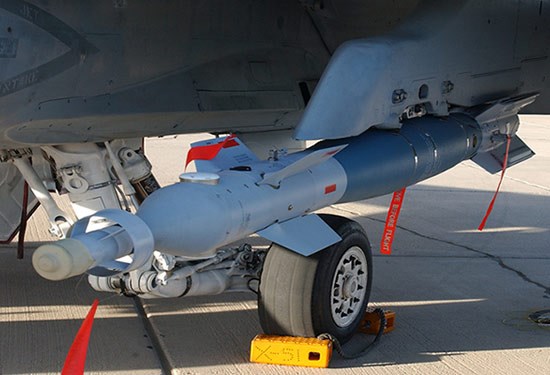

I had a few questions about the ordnance. The build will be roughly around the 2014 timeframe. I want all to be training loads.
- With the two GBU-12s, I want one to be all blue (like this one: https://www.asdnews.com/NewsImages/b/39580/39879_O.jpg or this one: https://c1.neweggimages.com/ProductImage/A1S7_1_201711101581030552.jpg). These would never come with thermal protective coating, can you confirm? Also, for the forward control section, would be possible to see both the gray and the green version loaded up?
- Are there training GPU-12s that are olive drab in color but might have a blue band? I can't find any examples of this.
- Around that timeframe, would the Navy have all-blue Aim-9L/M or would they only come in LGG with the blue band?
BDU-45's (inert mk-82) are blue and smooth. There is no reason to have TP coating on an inert bomb. The guidance and control section, as well as the tail assembly would be the same as those used on live ordnance.
No, the Navy and Marine Corps does not use inert ordnance that is green in color with a blue band.
Throughout my entire career, I never saw an inert AIM-9 that wasn't blue overall.
Thanks Dave, this is very helpful. One last question about ordnance. There will be a -9L, -9X, AIM-120, and an AGM-88. For these, I can't find good pictures of the exhausts. For the training versions, are the exhausts all blanked off with a flat cap (I think I saw one HARM that way) or are they in anyway different than a live version of each?
