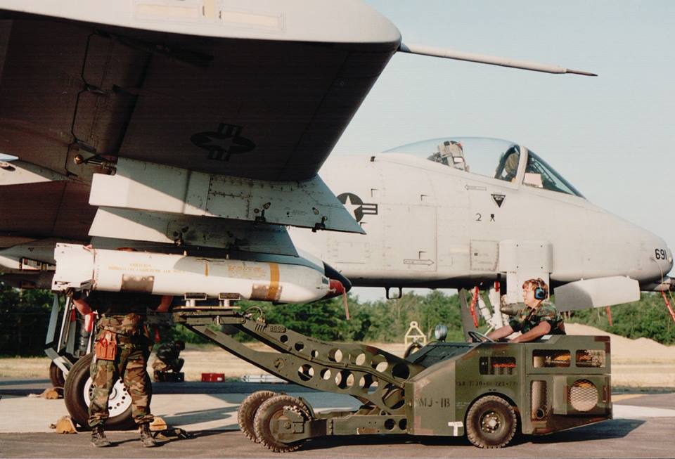

Guard Hog Posted December 4, 2020 Share Posted December 4, 2020 On 12/2/2020 at 11:28 AM, mrvark said: I believe that only AGM-65As & Bs could be carried on LAU-88s. Subsequent variants had a heavier warhead and could only be carried on LAU-117s. It's actually a weight issue, so the LAU-88's can be loaded with the shaped charge 125lb warhead variants (A/B/D/H); the blast/frag 300lb warheads (G/K/L) are too heavy/out of balance. Craig, 691 was one of yours before she was transferred to Idaho, right? I found this pic a while back, taken at Fort Drum in the mid-90's... thought you might like it. The Mk20's must have been one of those once-in-a-lifetime munitions allocations Easter eggs. Turning iron at the FOL... the glory days of the Guard Hog Community!! - Tom Quote Link to post Share on other sites
boom175 Posted December 4, 2020 Share Posted December 4, 2020 We got 691 from AD or a early AFRES unit that was closed down can't remember which unit. This was due to the robust when our unit went from 18 PAA to 24 PAA that lasted a few years, then after the realignment we shipped a bunch of jets to guard units. Heck we shipped a few to AD since I retired. Quote Link to post Share on other sites
