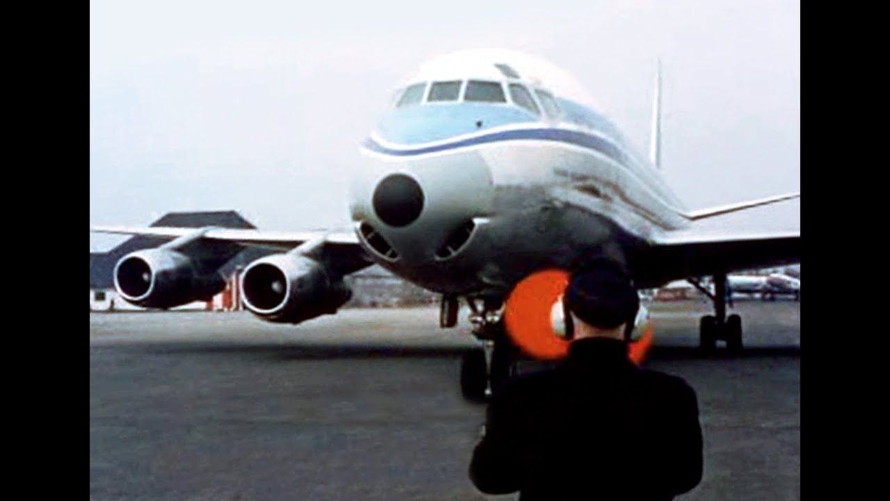

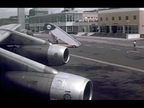

Dutch Posted January 27, 2021 Share Posted January 27, 2021 Tom, Based on close up photos of the -55 JT3D engines, I would say you have hit it pretty much on the nose. Quote Link to post Share on other sites
TommyP Posted January 28, 2021 Author Share Posted January 28, 2021 Those are great images, @Dutch... but things have suddenly taken a bit of downward turn... I tried to fit the engines last night, but unfortunately have discovered a rather major problem. I trial fitted the landing gear to check for ground clearance of the engines, and the inboard nacelles sat firmly on the ground! The problem, I think, is the fact the pylons are too deep and therefore the engines sit far too low. I wish I'd discovered this before I'd attached the pylons to the wings, as I now have the rather delicate task of removing the lower portion of the pylon to enable to the engine to sit higher and have the correct ground clearance. Below you can see the area in need of removal on the outer pylon, with the inner already trimmed. This was done after consulting photographs and the good old-fashioned MkI eyeball - not an exact science but I hope it will solve the problem: Untitled by Thomas Probert, on Flickr The engines also had a bit of a nose-down attitude which I can now correct too. I've been scratching my head and wondering if I've done something wrong, so will be interested to see if others have this problem... Onwards and upwards! Tom Quote Link to post Share on other sites
Dutch Posted January 29, 2021 Share Posted January 29, 2021 (edited) Tom, You have my sympathies. I hate it when something as dramatic as that happens. After looking at the two photos above, I have concluded that the upper photo is of a -33 and the lower photo of a -55. I would say there is quite a bit of ground clearance on both engines. Are the undercarriage legs long enough, do you think? Do the wings have the correct dihedral angle? K/r, Dutch Edited January 29, 2021 by Dutch Quote Link to post Share on other sites
TommyP Posted January 29, 2021 Author Share Posted January 29, 2021 10 hours ago, Dutch said: Tom, You have my sympathies. I hate it when something as dramatic as that happens. After looking at the two photos above, I have concluded that the upper photo is of a -33 and the lower photo of a -55. I would say there is quite a bit of ground clearance on both engines. Are the undercarriage legs long enough, do you think? Do the wings have the correct dihedral angle? K/r, Dutch I'm 99% certain the gear is fine, and the wing dihedral also looks about right. When you compare the real deal to the kit, it becomes clear the pylons are too deep, and I also think, when you look at the upper leading edges of the pylon, the angle is too steep - hence they sit too low. Anyway, the engines have been more or less sorted - to a point which is about as good as I get them. As outlined above, the pylons are too deep and therefore needed a portion removing - this has the effect of raising the engines up sufficiently and gives them the necessary ground clearance: Untitled by Thomas Probert, on Flickr This was done with a thin hacksaw blade, and amazingly the pylons themselves suffered no ill effects. Some careful filing to ensure all were identical, and then I could add the engines themselves: Untitled by Thomas Probert, on Flickr I've also been able to correct the nose-down attitude of the engines too, which was exaggerated by the kit pylons. Untitled by Thomas Probert, on Flickr The pylon to engine join will need a quick lick of filler, but overall the surgery has been a success: Untitled by Thomas Probert, on Flickr A couple of top-shots: Untitled by Thomas Probert, on Flickr Untitled by Thomas Probert, on Flickr And the underside: Untitled by Thomas Probert, on Flickr I think it'll tackling the cockpit next: Untitled by Thomas Probert, on Flickr All the best, Tom Quote Link to post Share on other sites
