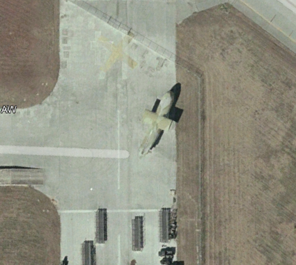

Da SWO  Last time I saw 56-0522 was as a wingless instructional trainer down at Kelly AFB when I attended 2T2 Tech School in the mid 1990s. She was parked out by the 433rd ALW, pretty much gutted and do to low hydraulic fluid it really sucked hand-pumping the tail doors open and closed. Google Shows her in the same place until the mid 2000s. I'm guessing either moved inside or scrapped.

Ah HA!
I was looking in the wrong spot.  I was told she was at IAAFA, Google Earth showed a different frame.  I need to tool around the 433rd area again.
