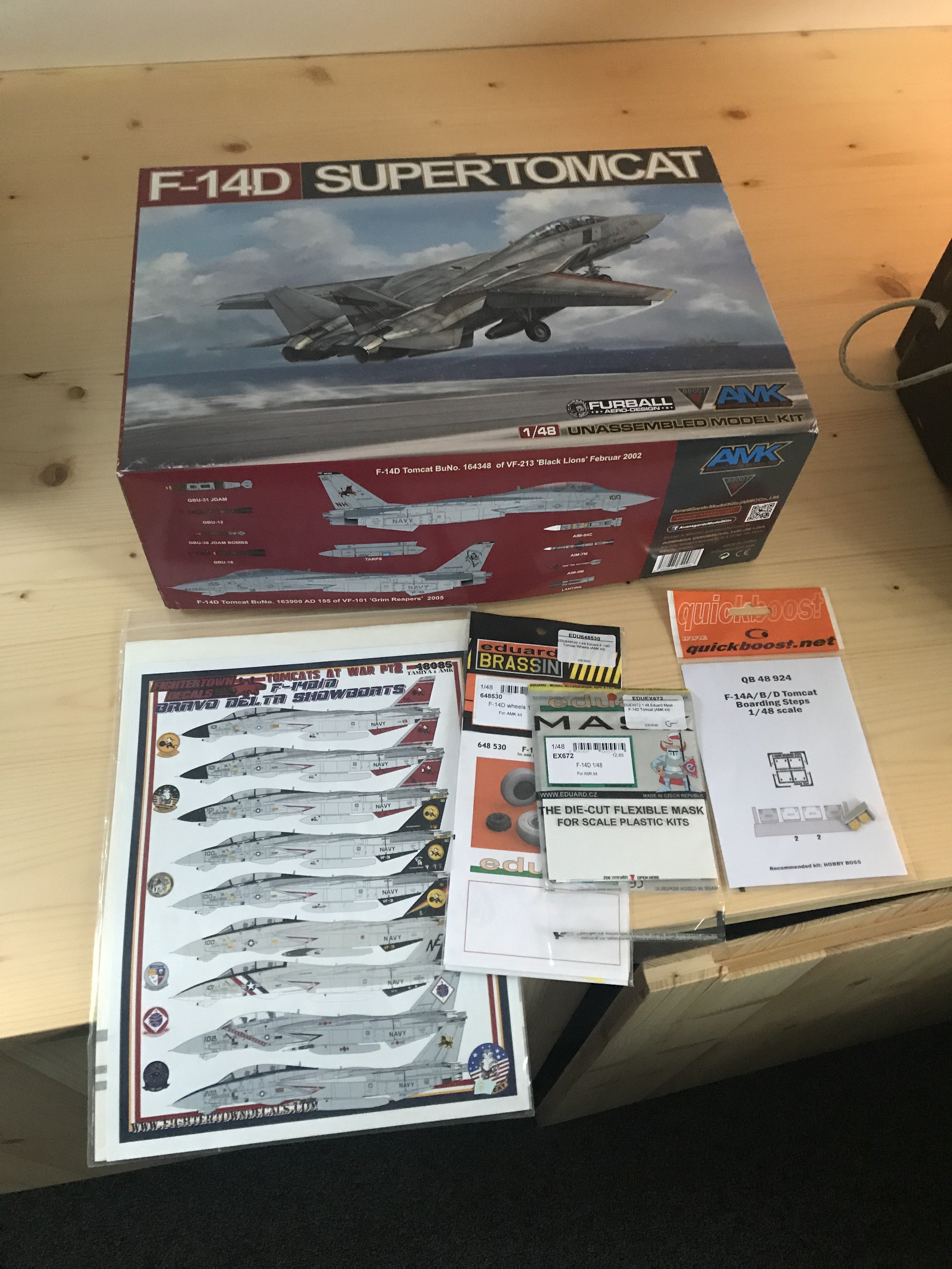

Hello, here is my contribution for the venerable USN jet.
The start point is AMK F-14D with some goodies:
Fightertown decals sheet #48085
Quickboost Boarding steps #48924
Eduard masks for AMK #EX672
Eduard F-14D wheels #648530.
The aircraft is VF-31 CO callsign i guess "Bandwagon 101" Buno164603 (oct 2005-may2006)
I will use MRP lacquers for de TPS scheme.
Let's go!
Stephane

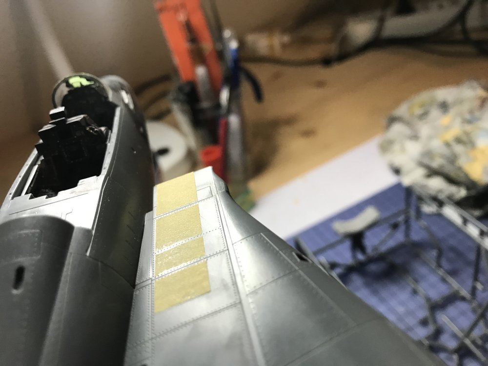

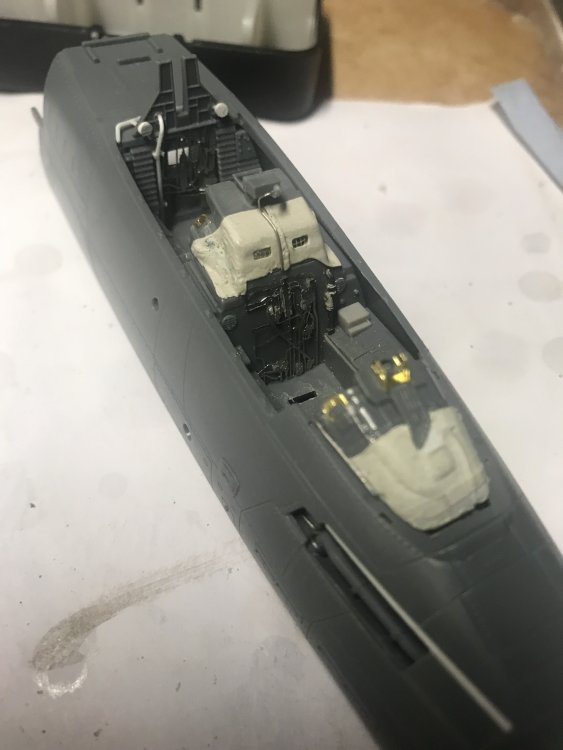

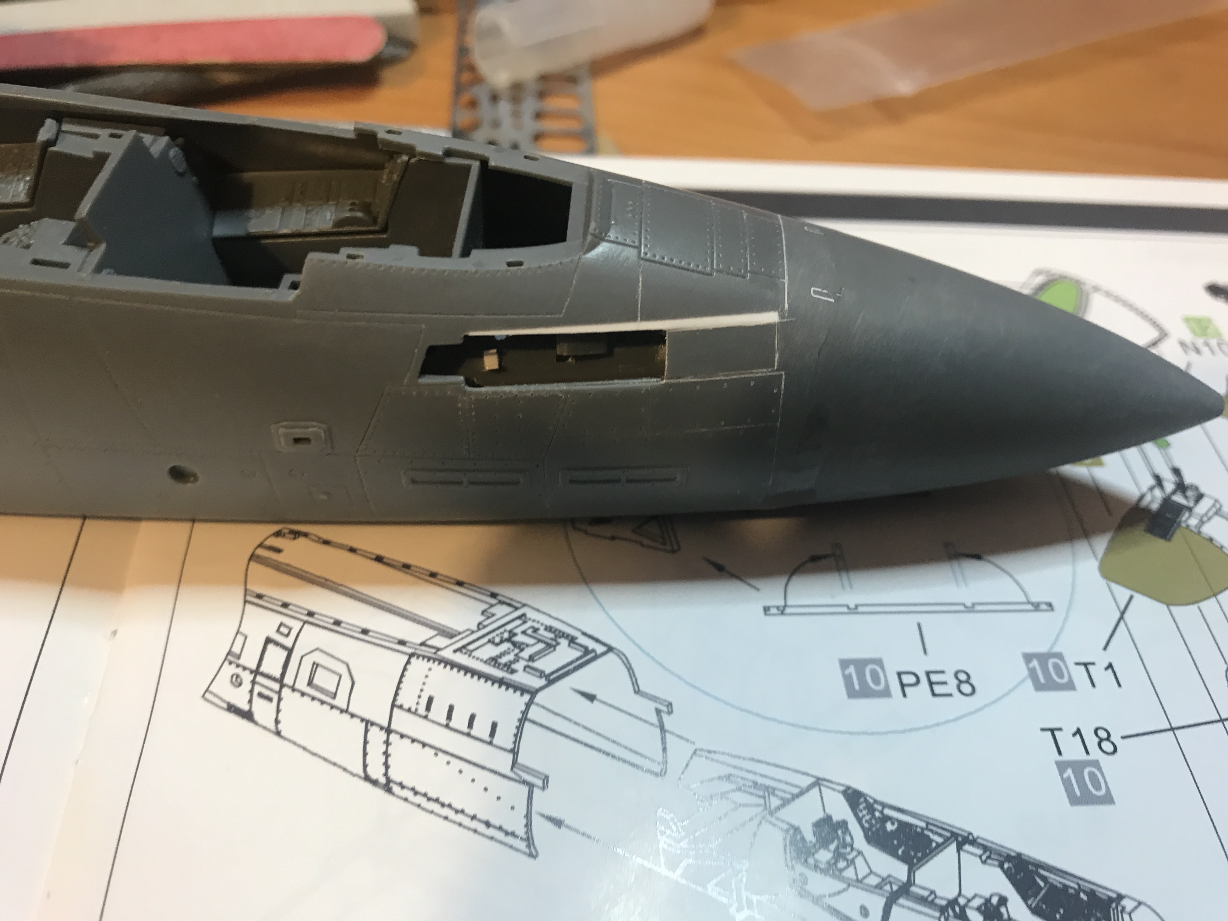

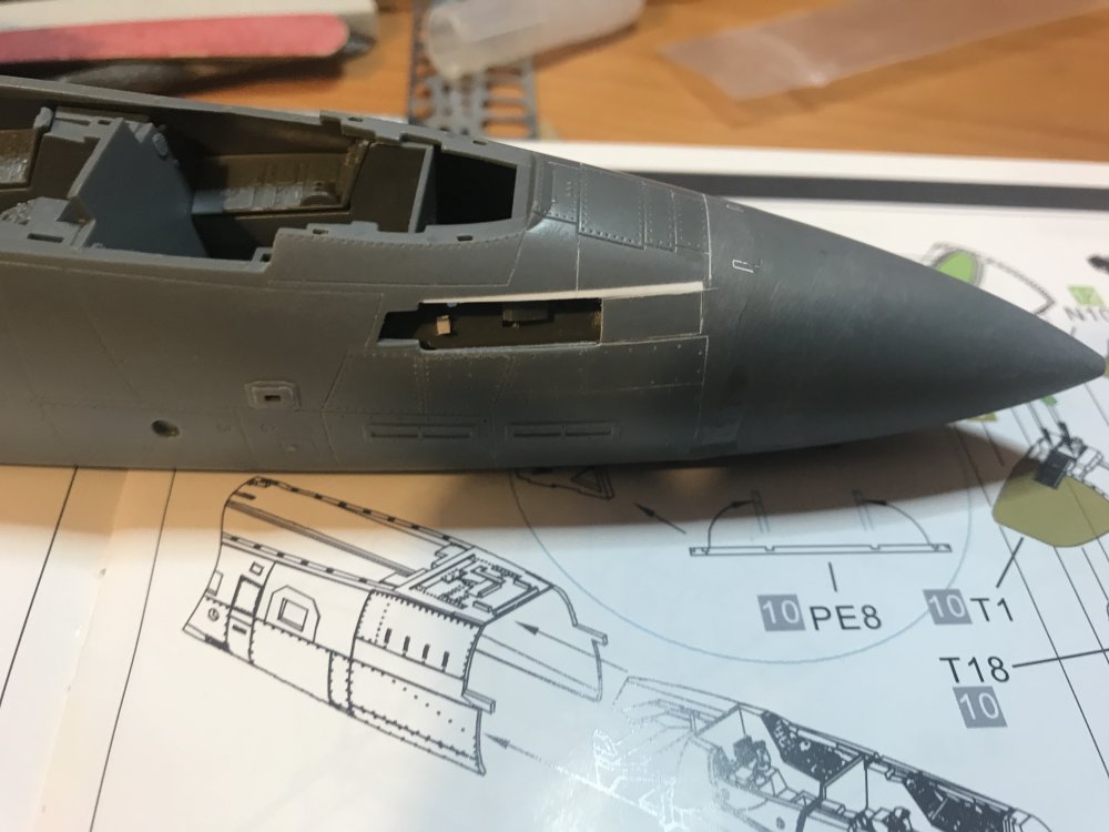

Hello here is some few improvements.
Cockpit : relocated the IFR probe

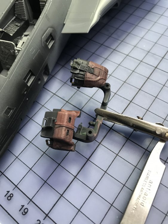

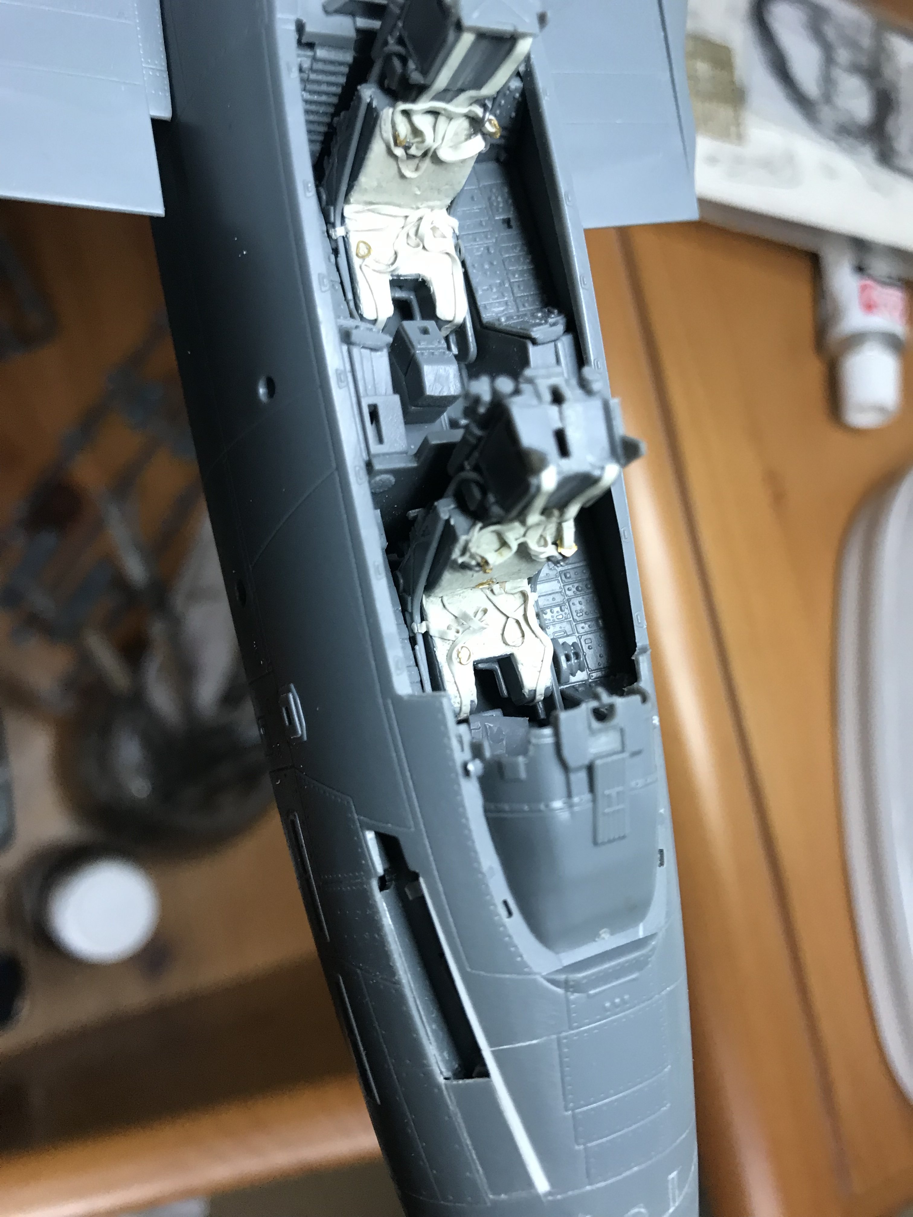

Added some details on the ejection seats and test fitting of the baththub

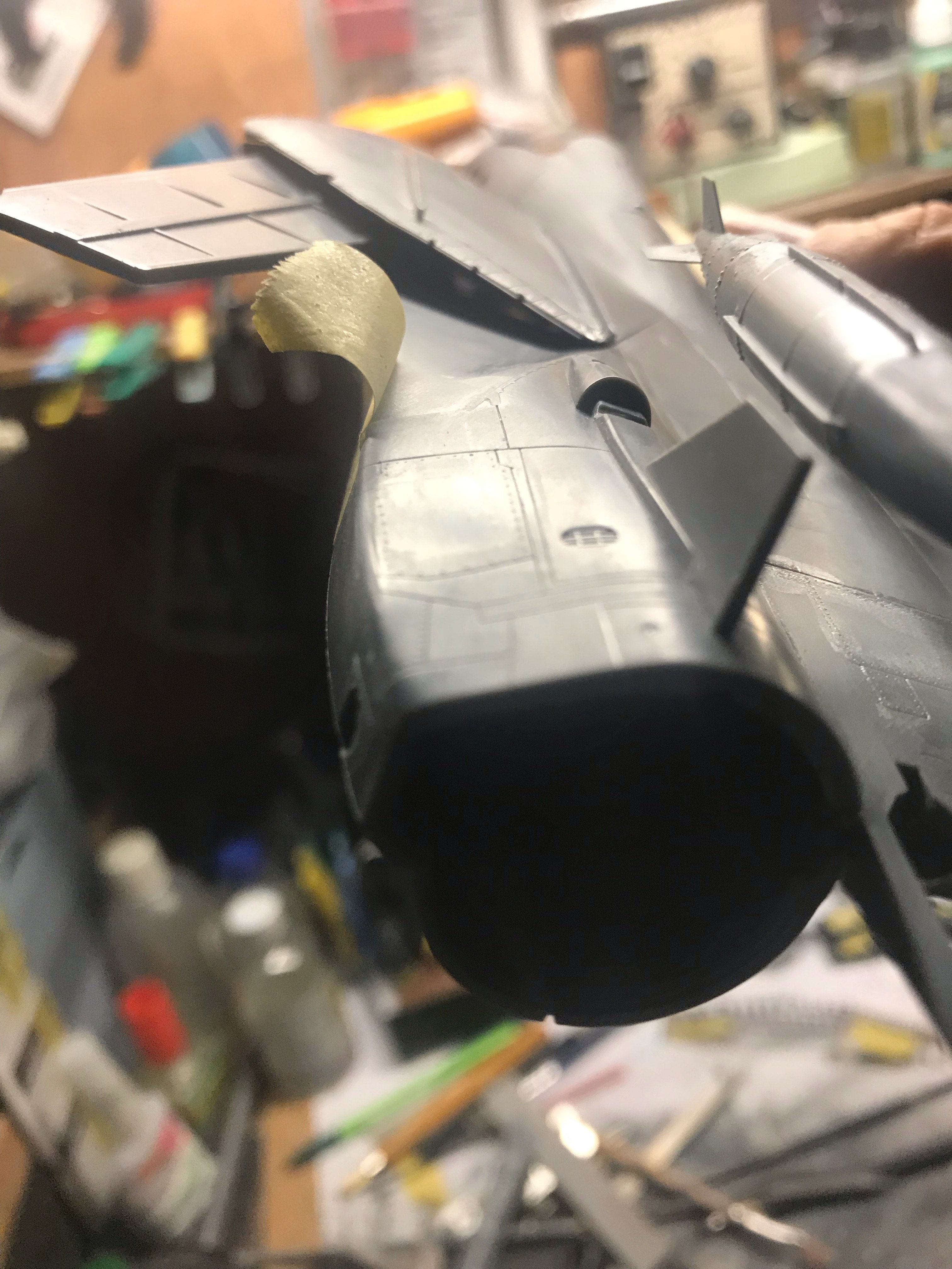

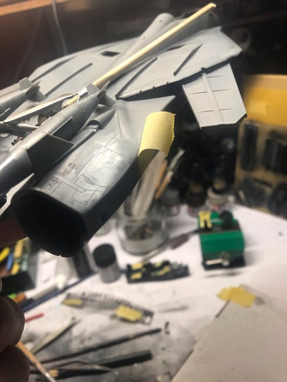

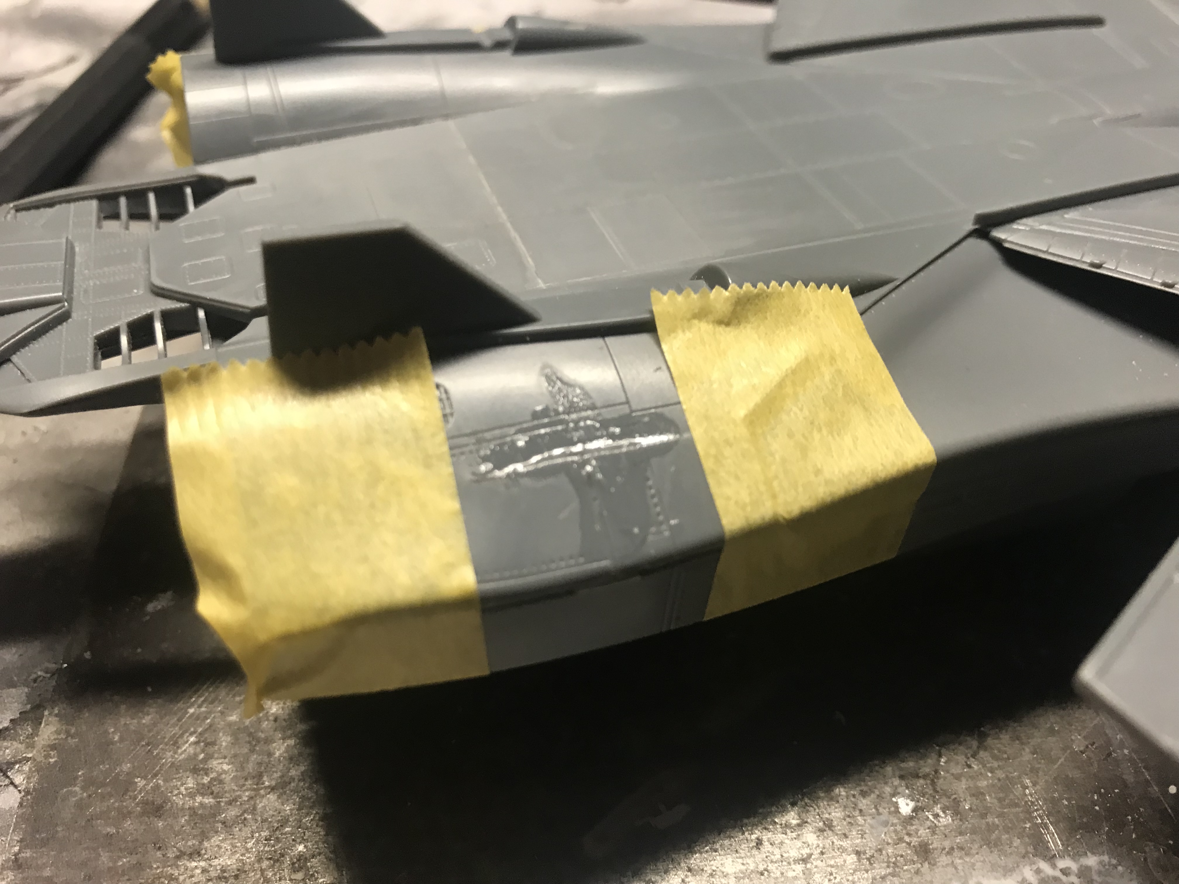

And some plastic surgery on the rear of the Kardashian style fuselage 😁

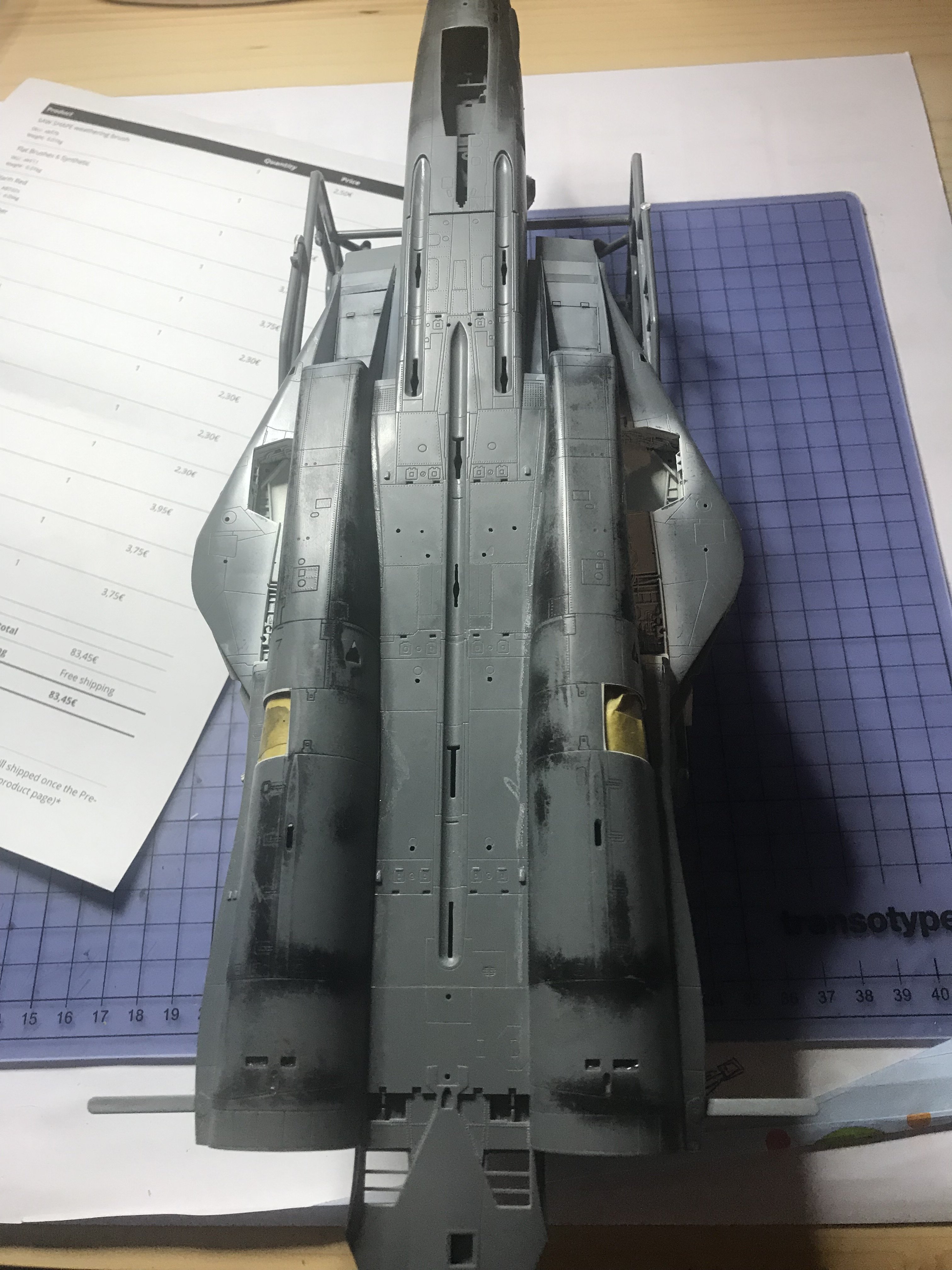

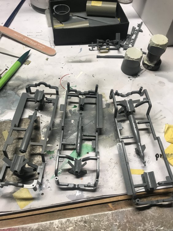

Some building this week.

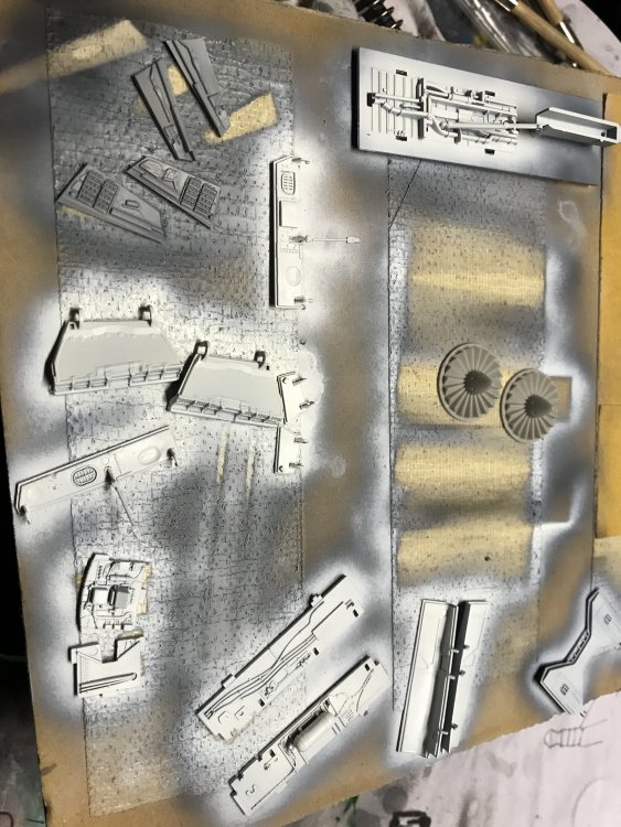

I have completed  front wheel well assembly and painting (require some testing and sanding before glueing).

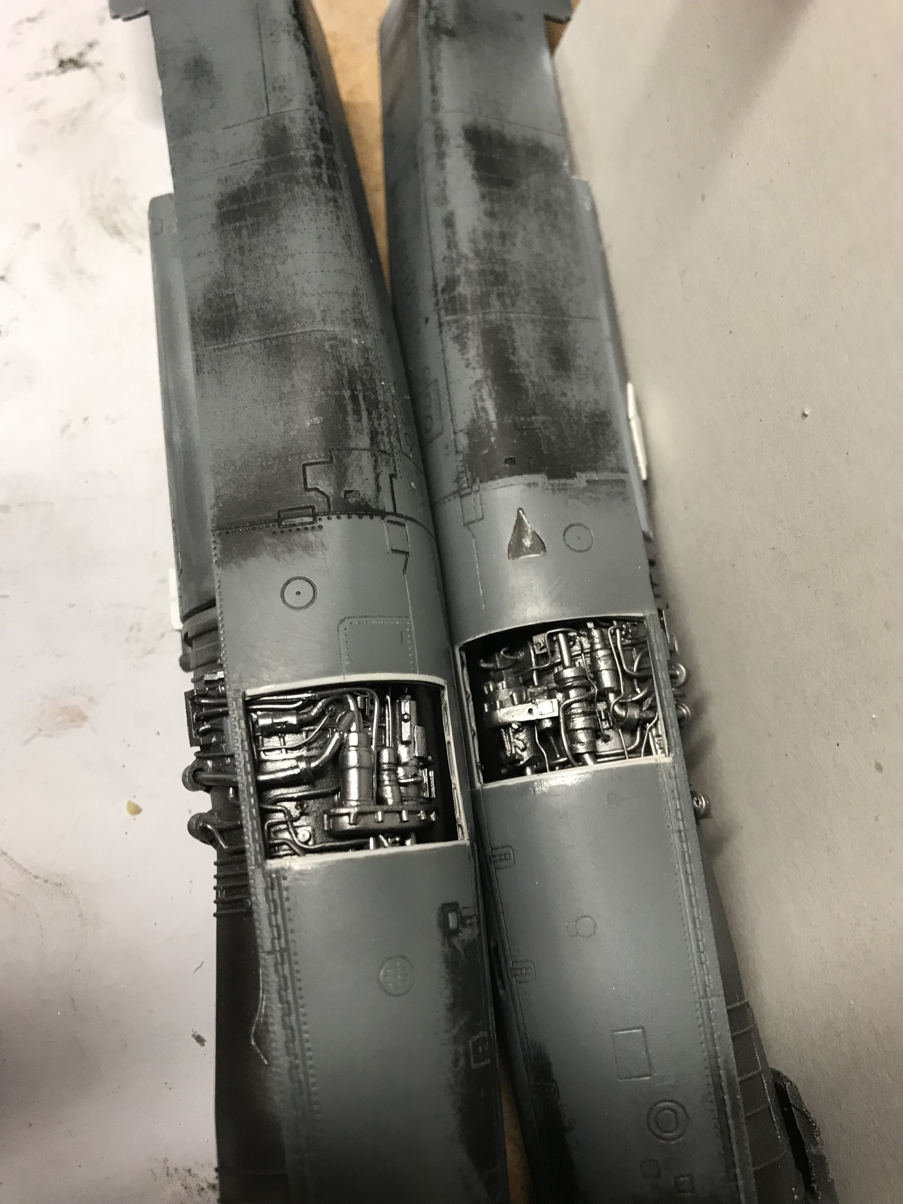

Also opening the maintenance panels underside to see the engine (pathologic idea i confess).

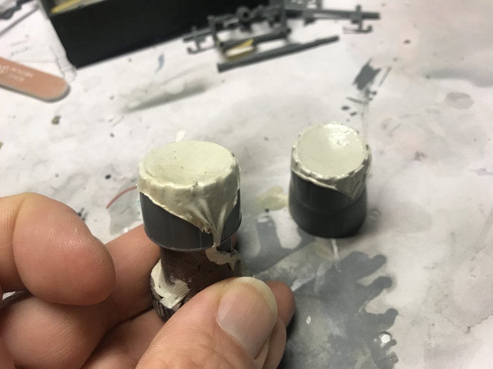

Detailled the engines before painting.
The parts for the engine nacelles need to be rescribed as their details are somewhere differents (looks like they dont came from the same kit, weird...).
Putty work again on the exhaust and the cockpit.
So far this kit is the more detailled kit of the Tomcat i've ever seen OOB.
All comments are welcome

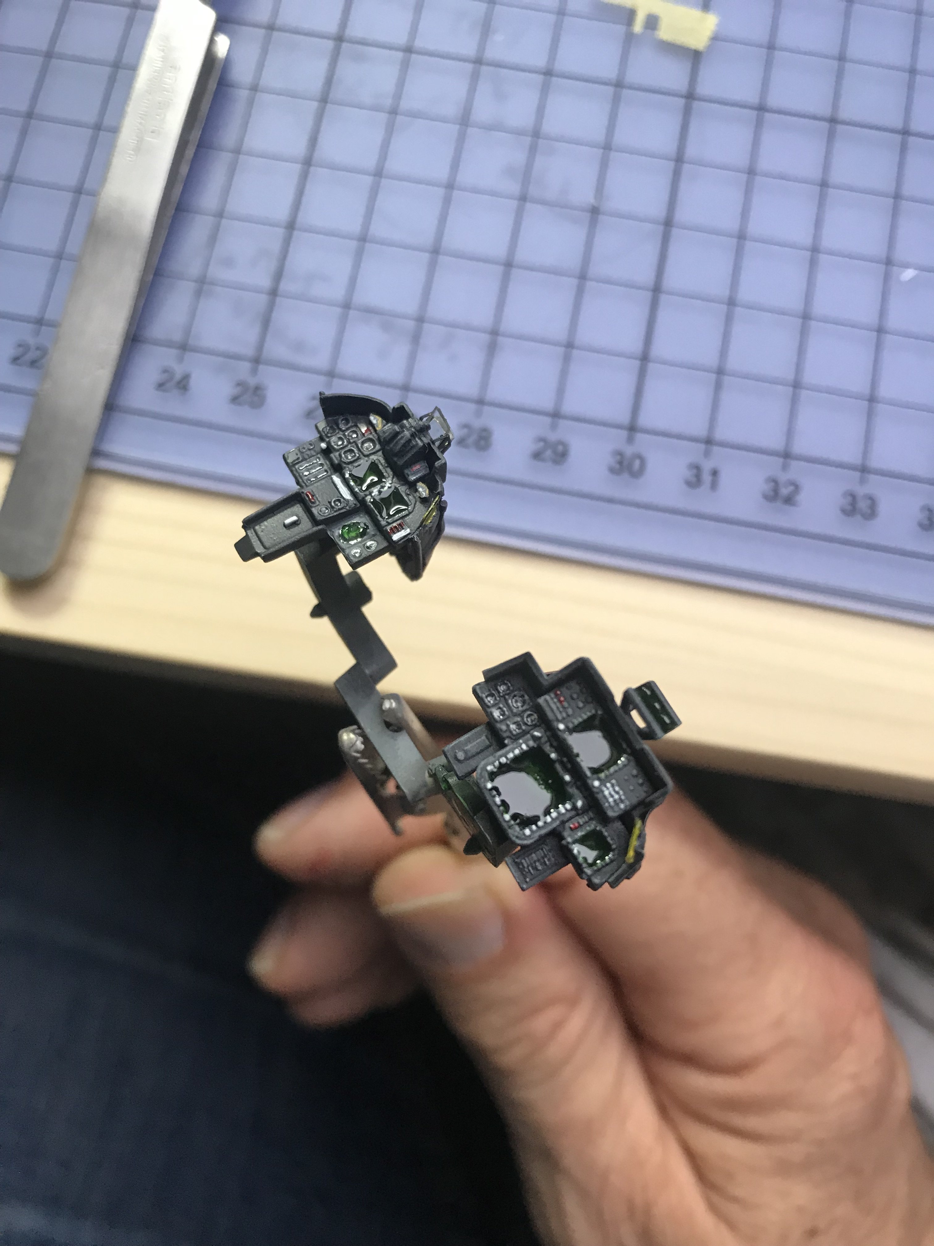

Hello Folks!
WIP update.
Instruments panels are done.IMG_8386.thumb.JPG.f0c7a62f20a8de291d84226fb245d688.JPGimage1.thumb.jpeg.6780f88b56f714d75c3bd2f385140860.jpegIMG_8387.thumb.JPG.f9f83ca4dcd9a27272c81e6ef30fa359.JPGIMG_8417.thumb.JPG.fa927bdb68a6ec6638b94ed6f3ff8c56.JPGIMG_8234.thumb.JPG.0ad42759386d1360132db5135b2bfdfe.JPGIMG_8423.thumb.JPG.0c9e363e551401ed6c0740ff8d4ebc73.JPG

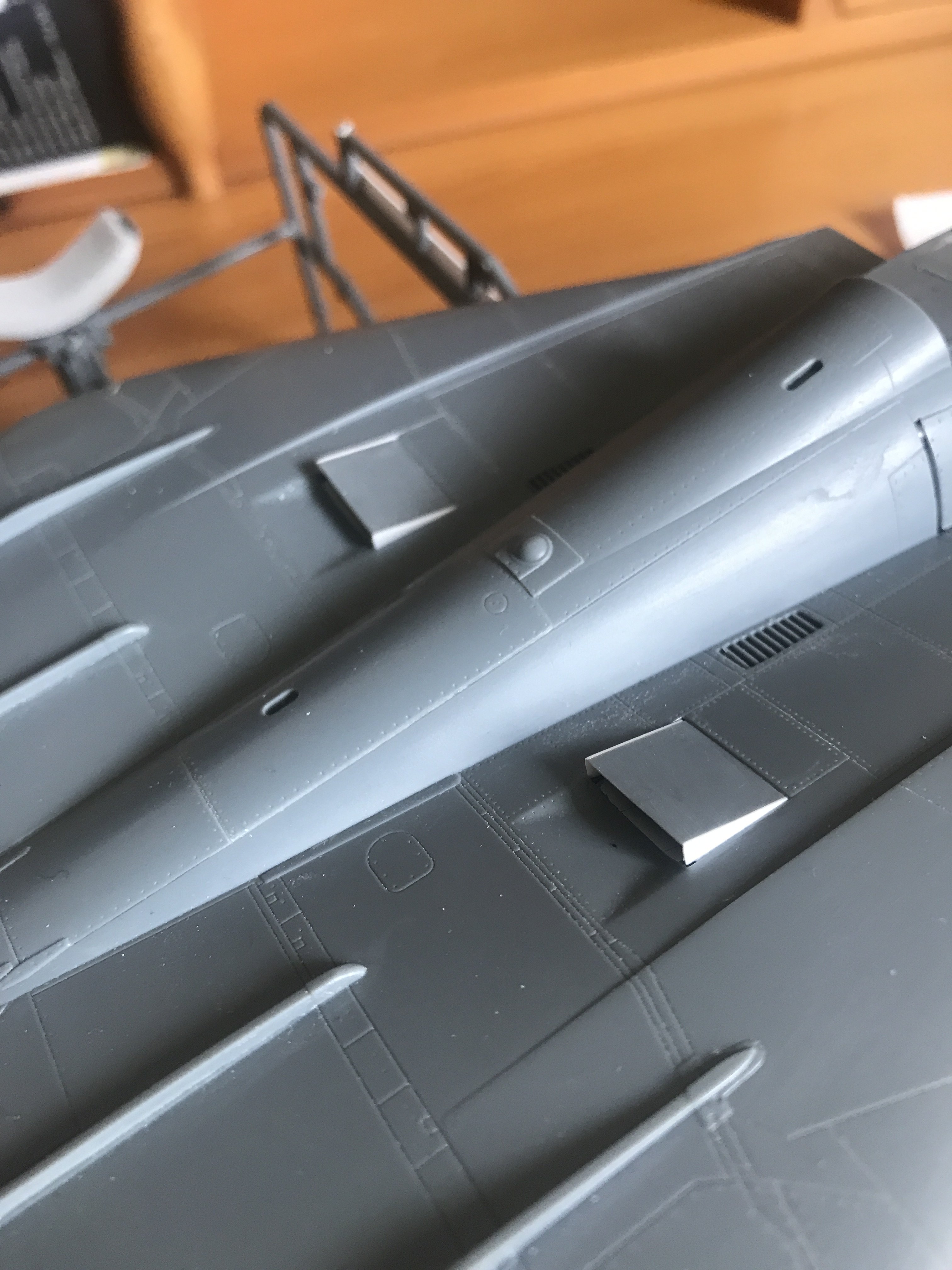

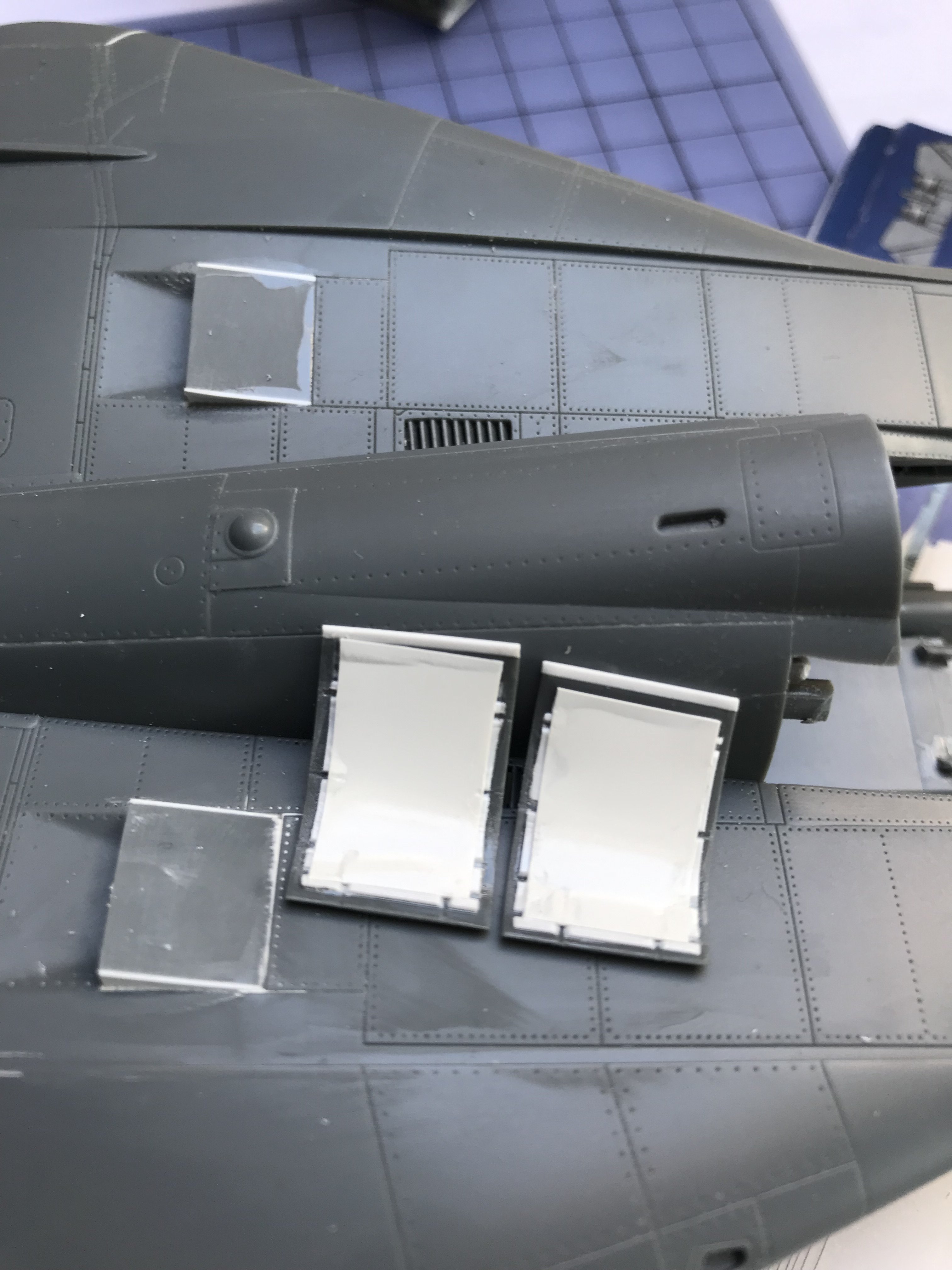

Make some minor modification on the upper vents near the spine to match my reference pics.
Open up the manitenance doors of the both engines (oftenly seen opened when the thing is parked).

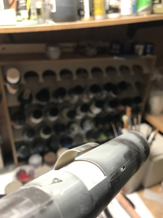

On 2/17/2021 at 9:12 PM, Thadeus said:
Looking nice. I hate it when the diet and excersice doesn't work 😉
This part of the kit was pointed out in several blogs around, so the Proxxon needed to do some minor corrections!

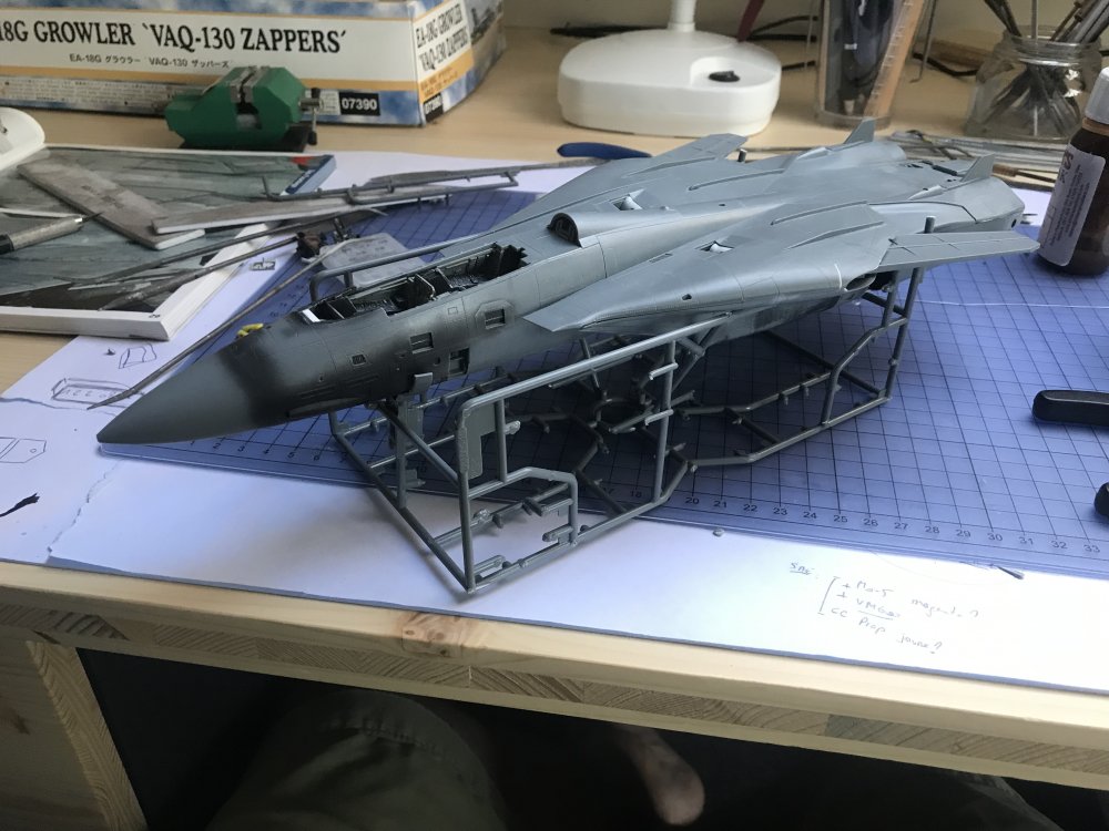

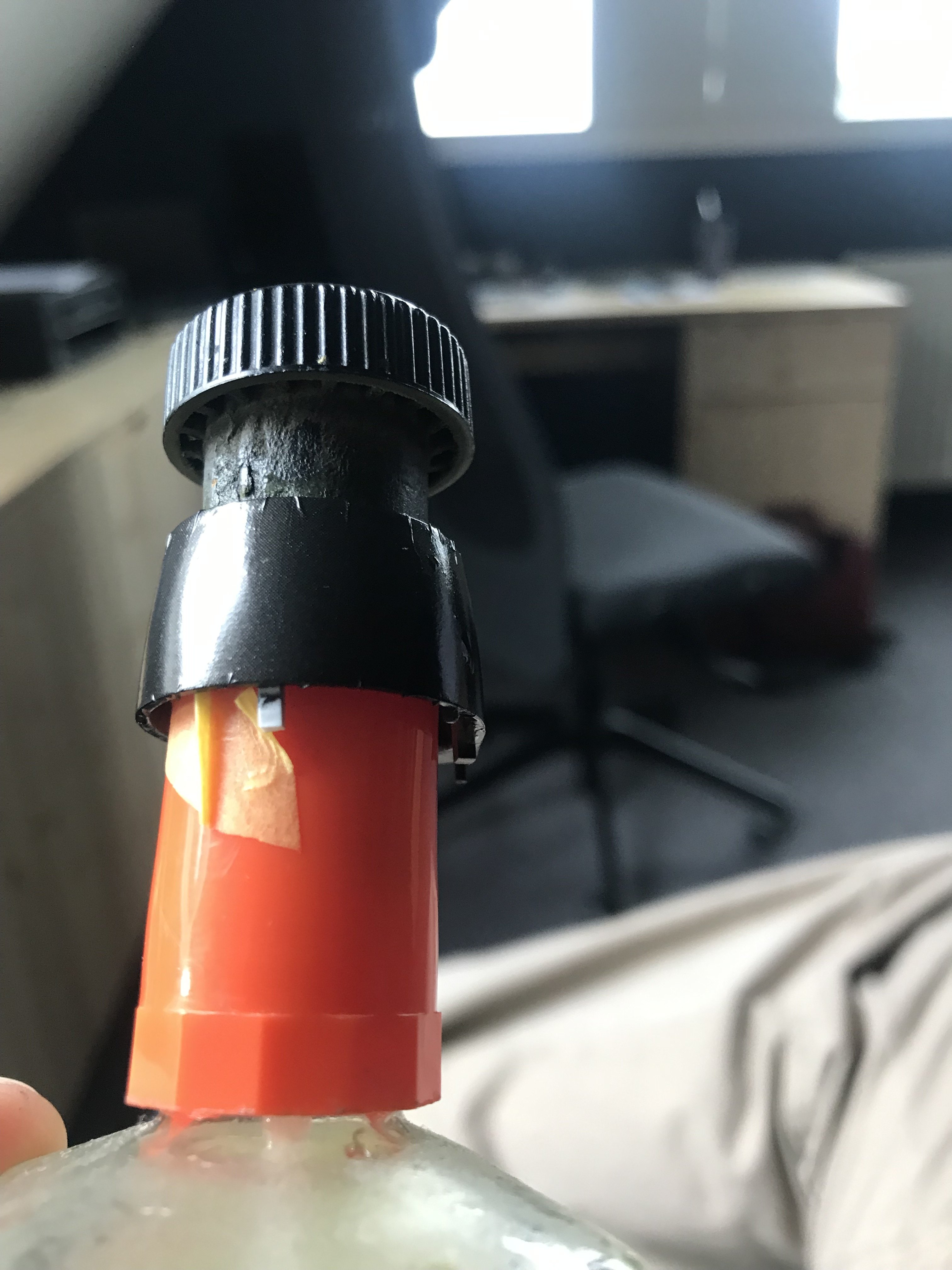

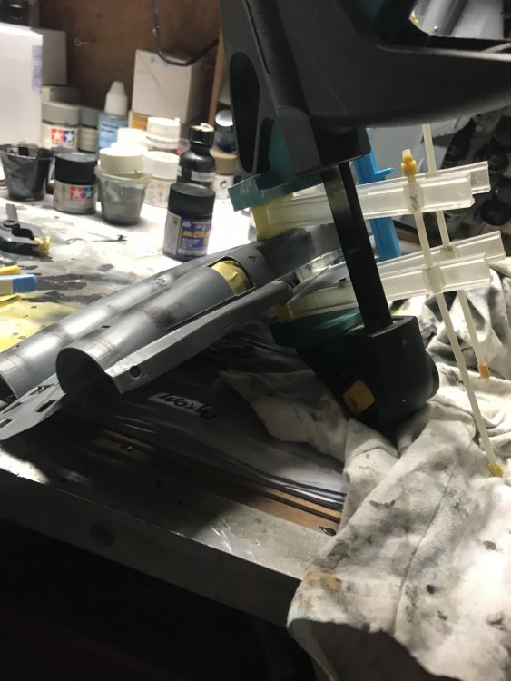

8 hours ago, MA Cooke said:
OK, I am flummoxed.....what is that?
Hello MAC, your question is understandable. There is so much sprue trees in this box and i need a jig for the forthcoming steps (painting, decaling, etc...) so i decided to tinker an homemade thing for that. Not very sure of it's lifetime 😉.
Here is the model (unglued) sitting on it.
Also this is a good derivative to me as i'm currently not glueing anything (test fitting, sanding most of the time).

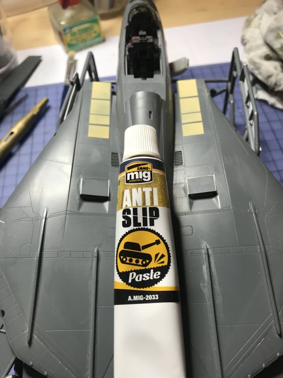

Just a small update to share my thoughts about the specific texture of the walkways located upon the air intakes. This antislip areas are quite visibles and show signs of aging.
I give a try the A.MIG-2033 paste (1/35 scale, the sand color one). I think the product is usefull for AFV project but for aircraft?
and the result is great to me. I delimit the area with some tape, apply generously the paste. Just remove it with a spatula, remove the tape and "Voila!" (like Doogs says).
When it dries a thin granular film will remain. Photos show the result on the upper fuselage.
All your experience with this product are welcome.

Awesome work so far, Stephane!   Great attention to detail.    I've been wondering about what walkway color this is as I couldn't find any references for it -- so there really are sand-colored walkways?   And it looks like that product is the key : )
Looks great, but all the references I have so far seen for the last cruise pencil Tomcat show the walkways with very little difference in colour from 36237.
Its there, your sand effect and dirty 36237 will be enough.
Than you. Perhaps the tint can appear in transparency with a thin layer of the FS35237 ?
Such a shade of walkway is not so common, is it?
In the case of Maverick planes this gives a worn look of the most beautiful effect I find.
(Talk to me Goose!)
Thank you. My references say the same things. I plan to spray the plane in overall black primer, so the sand won't be a problem. At this point i don't know how to deal with the paint of this area. FS36237 can be a solution.

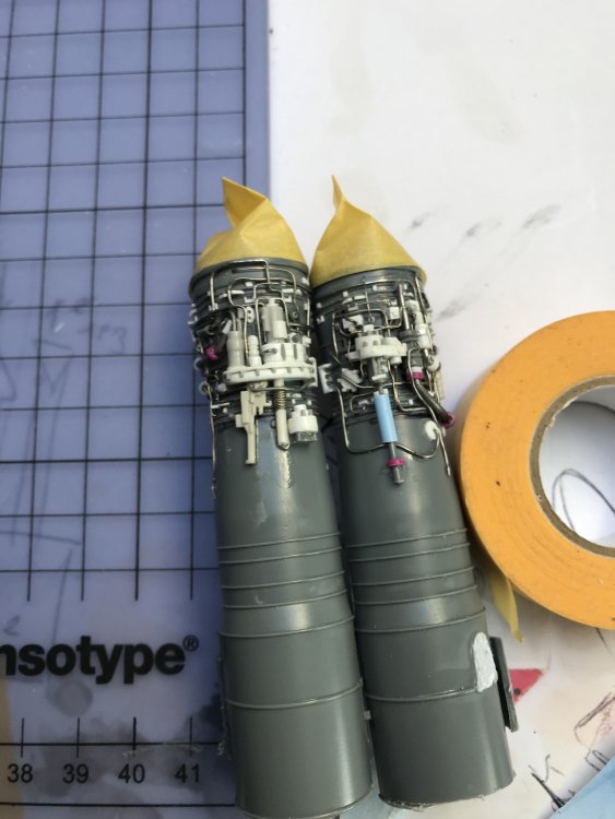

UPDATE BABY!
Spent hours after work detailling engines with lead wire and wrapping thin copper wire.
Some good reference on the internet and in the Daco book for that.
I sprayed Alcald lacquer and  yellow acrylic paint on the exhaust covers (weathering is not very realistic to my taste....will try another thing).
Will finish the engines tomorrow and glue them to the engine nacelles ASAP to move to the final building stages.
To be continued this weekend
Edited by FASTEAGLE107
On 3/5/2021 at 6:06 PM, Red Dog said:
yep, great work on these engines !!
Thank you Red Dog, these are now glued and hidden under the fuselage.
