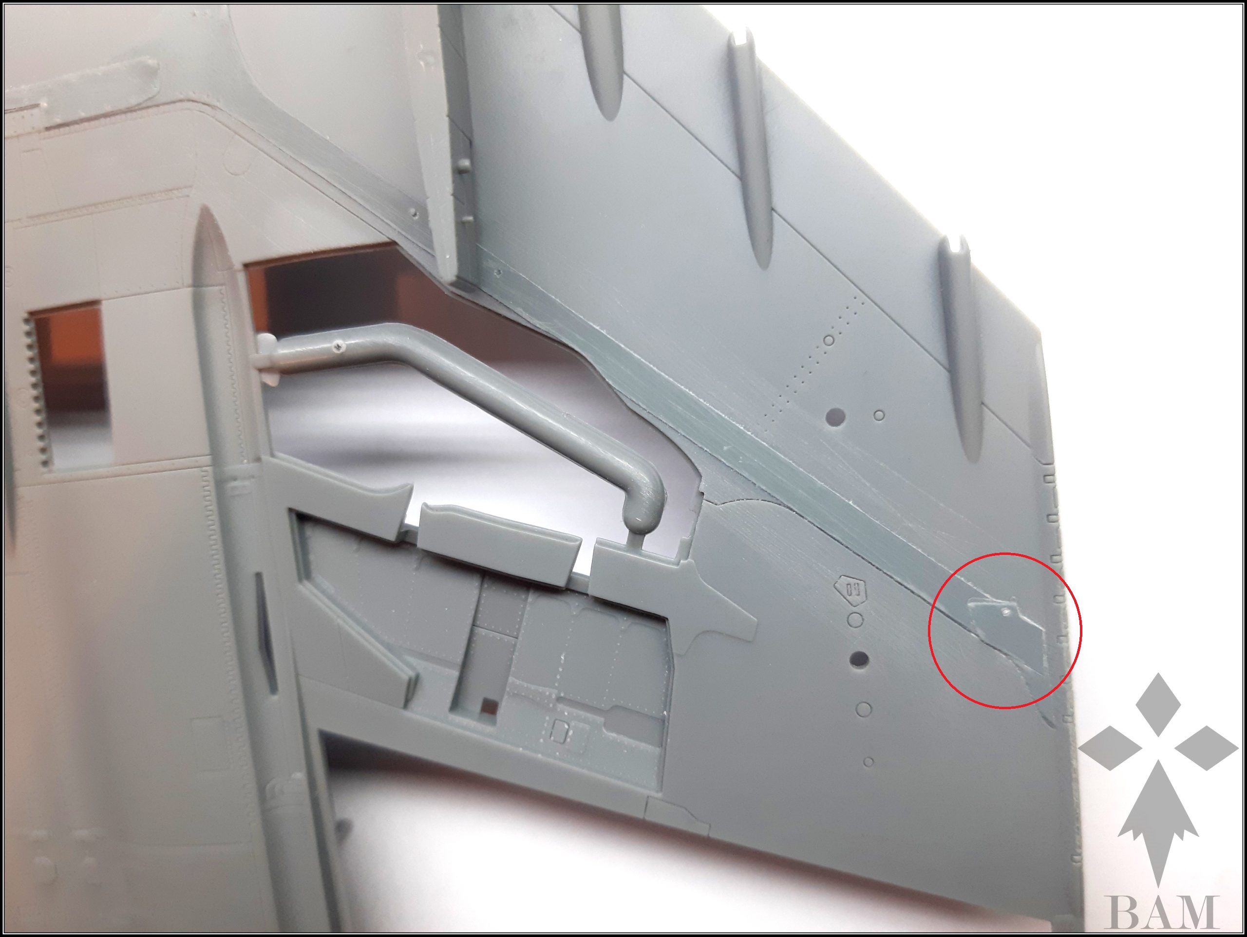

serendip Posted March 8, 2025 Share Posted March 8, 2025 Hi, Regarding the set for the F4, does anyone know where the bits circled in black below go? Sorry for the awful quality of the picture, but the circled location should give a way the bits I mean. Thanks: Quote Link to post Share on other sites

arnobiz Posted March 8, 2025 Author Share Posted March 8, 2025 5 hours ago, serendip said: Hi, Regarding the set for the F4, does anyone know where the bits circled in black below go? Sorry for the awful quality of the picture, but the circled location should give a way the bits I mean. Thanks: Hi, They are reinforcements that go on top of the main part, at both ends - their location in engraved on the main part 😉 Arnaud Quote Link to post Share on other sites
serendip Posted March 9, 2025 Share Posted March 9, 2025 Thanks all, all clear now. Quote Link to post Share on other sites
