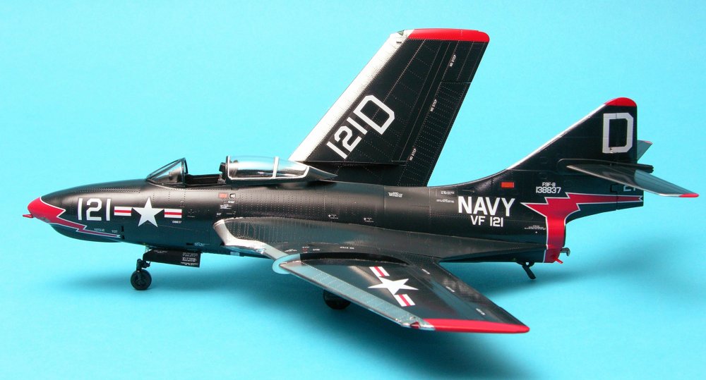

I made the mistake of building one after making the Tamiya Tomcat. Big mistake. Keep fighting it!
Just out of curiosity, what's wrong with it? Like Paul, I too am mainly a 1/72 builder but some 1/48 & 1/32 kits have been known to catch my eye once in a while and the Kittyhawk Cougar is one of them.  Liked the boxart and thought of pulling the trigger to buy & build that one.  Any glaring inaccuracies or things to look out for?
Kitty Hawk has a tendency to over engineer their kits. Combine that with some interesting solutions to a build like the wing fold on the Cougars. Just strange.  However, I find their kits a bit of a challenge but overall can produce a really nice looking kit with modeling skills applied. They get a lot of props for their 1/35 and 1/48 helicopter kits. I haven't heard too many complaints on their military vehicle kits either. They are certainly not Tamiya. KH designs their kits with details that Tamiya just would not include or just simplify as much as possible.

The one real issue with the Cougar is the nose gear strut. The oleo is too short. An easy fix or use a strut from the Monogram F9F Panther.
2 minutes ago, Paul Boyer said:
Forgot about that. Yes, I fixed mine by replacing the oleo with a longer piece of SS tubing.
I have a doner Panther so I will use that part. I personally really like their Cougars. They are not perfect but they are pretty much correct overall. I may be an outlier but I even like their Banshee. The Michael Rieth correction set pretty much takes care of the most glaring issues with the kit being the intakes.

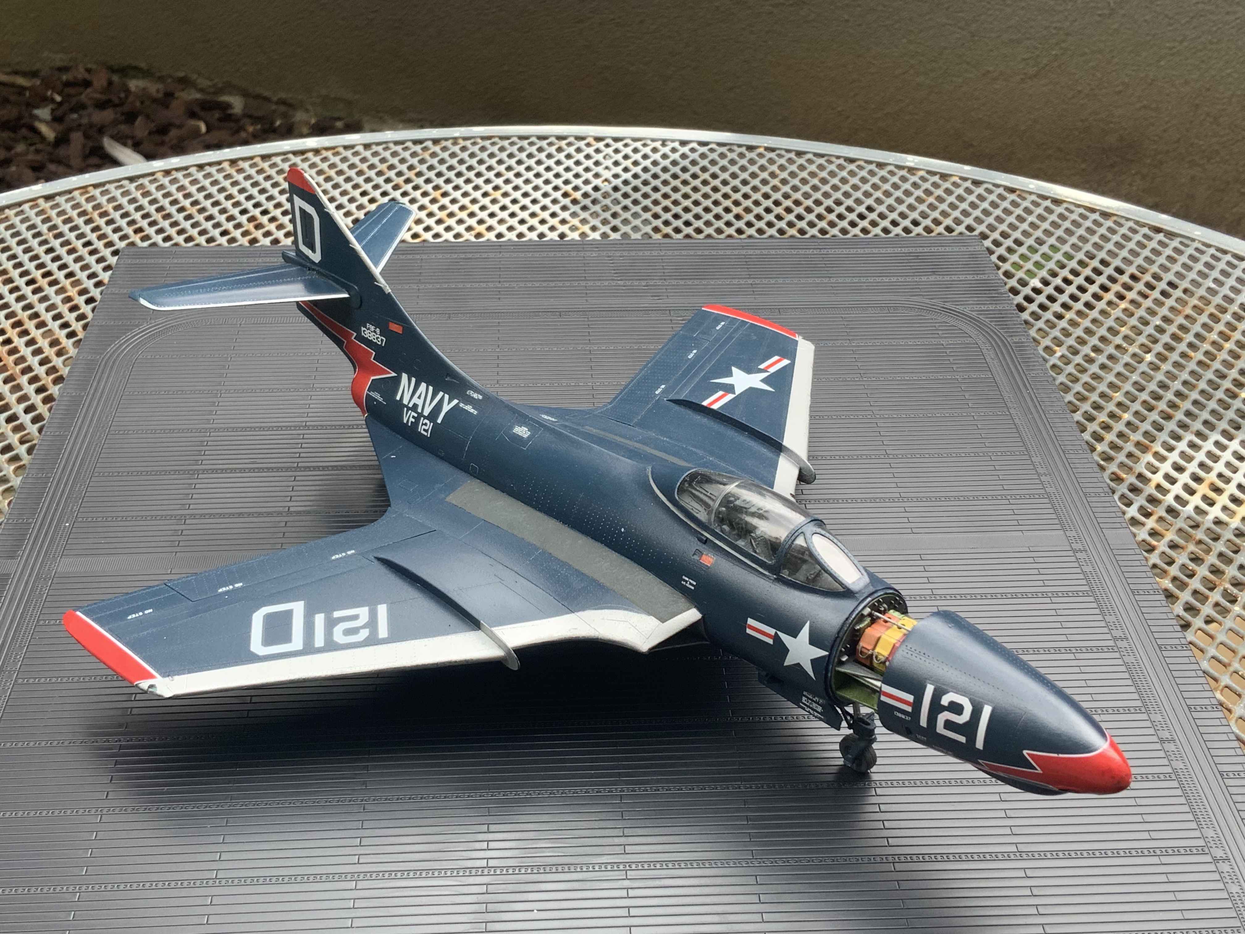

It does test patience. But it does look good finished and on the shelf.  I think it must be an early effort by KH, I remember the sprue trees being the thickest I have ever seen in a kit like a limited run thing. The newer KH Flankers I've built are pretty good.
Yes, their sprues were quite thick. If IRC the Cougs were their second and third 1/48 kits released after their F-94 Starfire. I recall having a conversation with the then Kitty Hawk rep at the Orlando Nationals in 2012. The Starfire was their only kit out then. He told me they were going to release two USN 50's jet kits. I asked if one was going to be a Tiger and he said no. I was disappointed but glad they didn't in retrospect. I think their kits have improved quite a bit since. The Coug sprues are very thick but I think the kits are fairly accurate if somewhat overly complex. However in their defense they chopped up the fuselage to produce the two versions with a minimum of having to create totally new molds. They are not the only manufacturers to do that.
