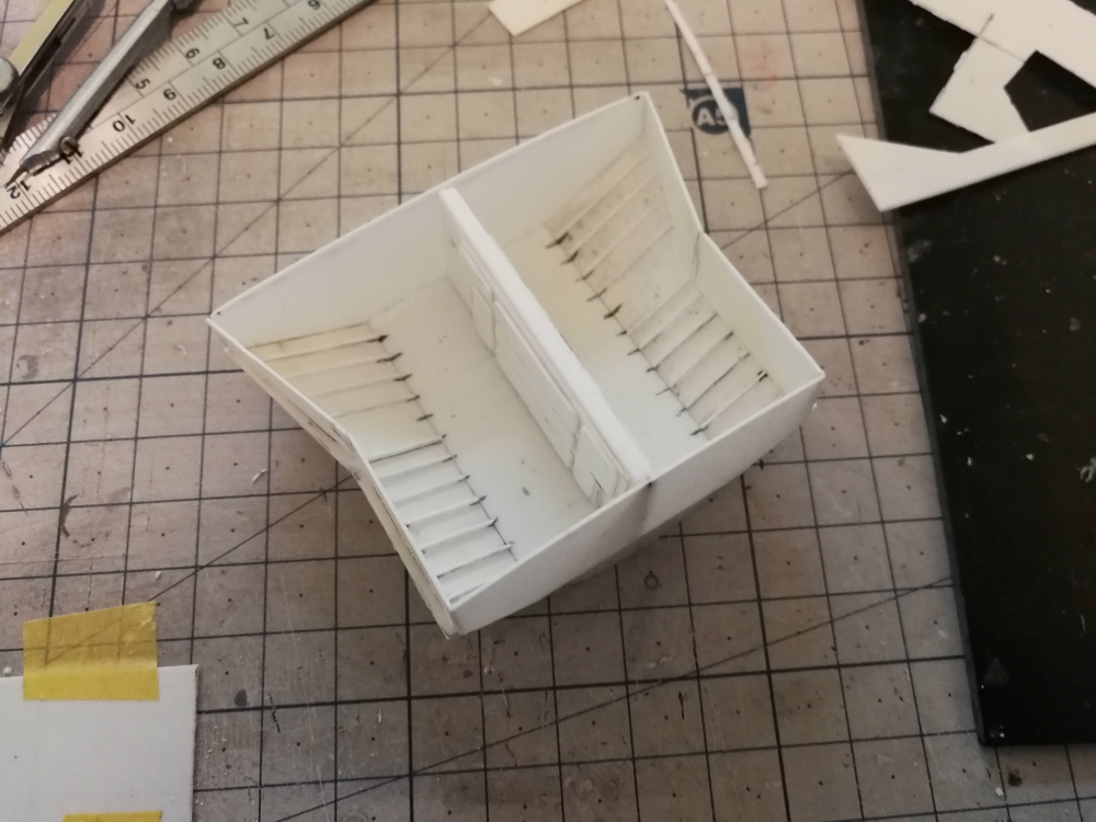

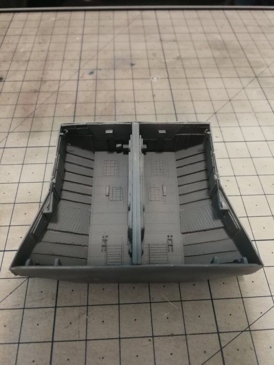

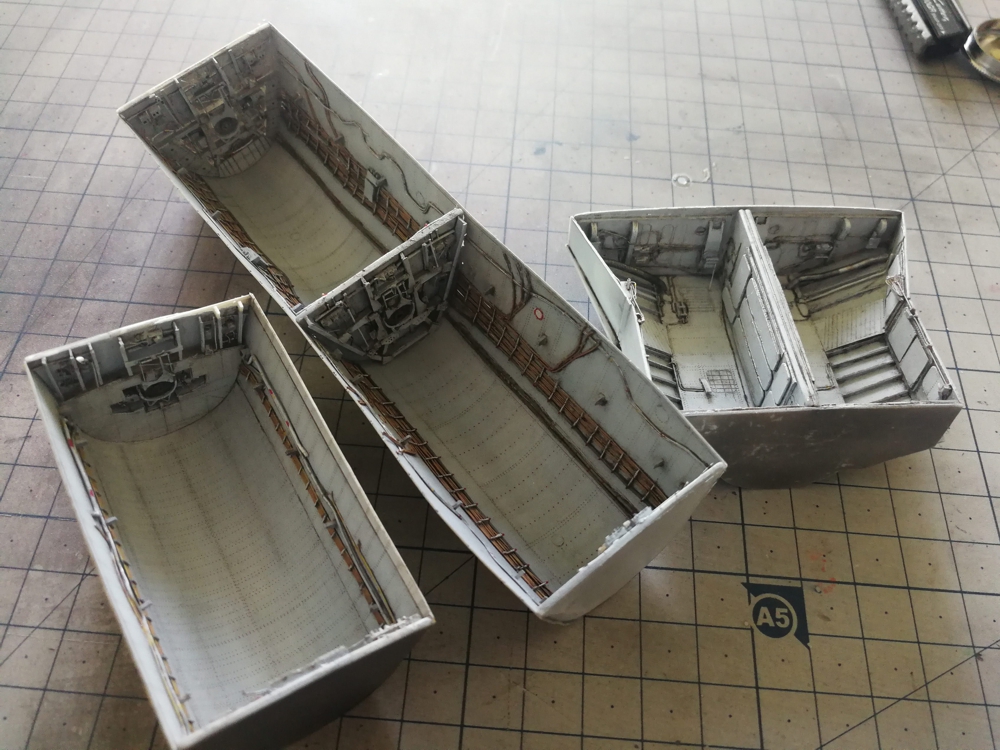

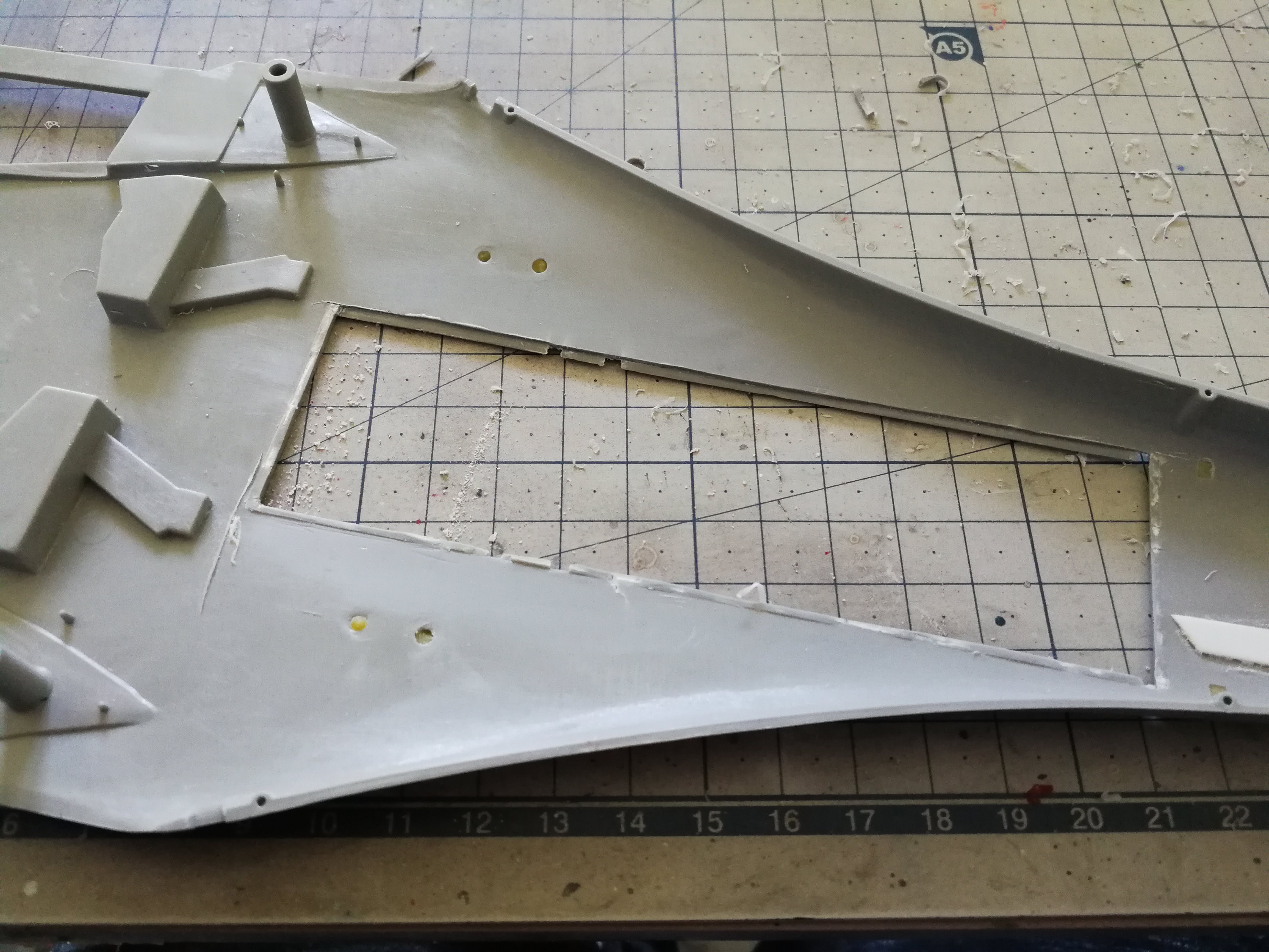

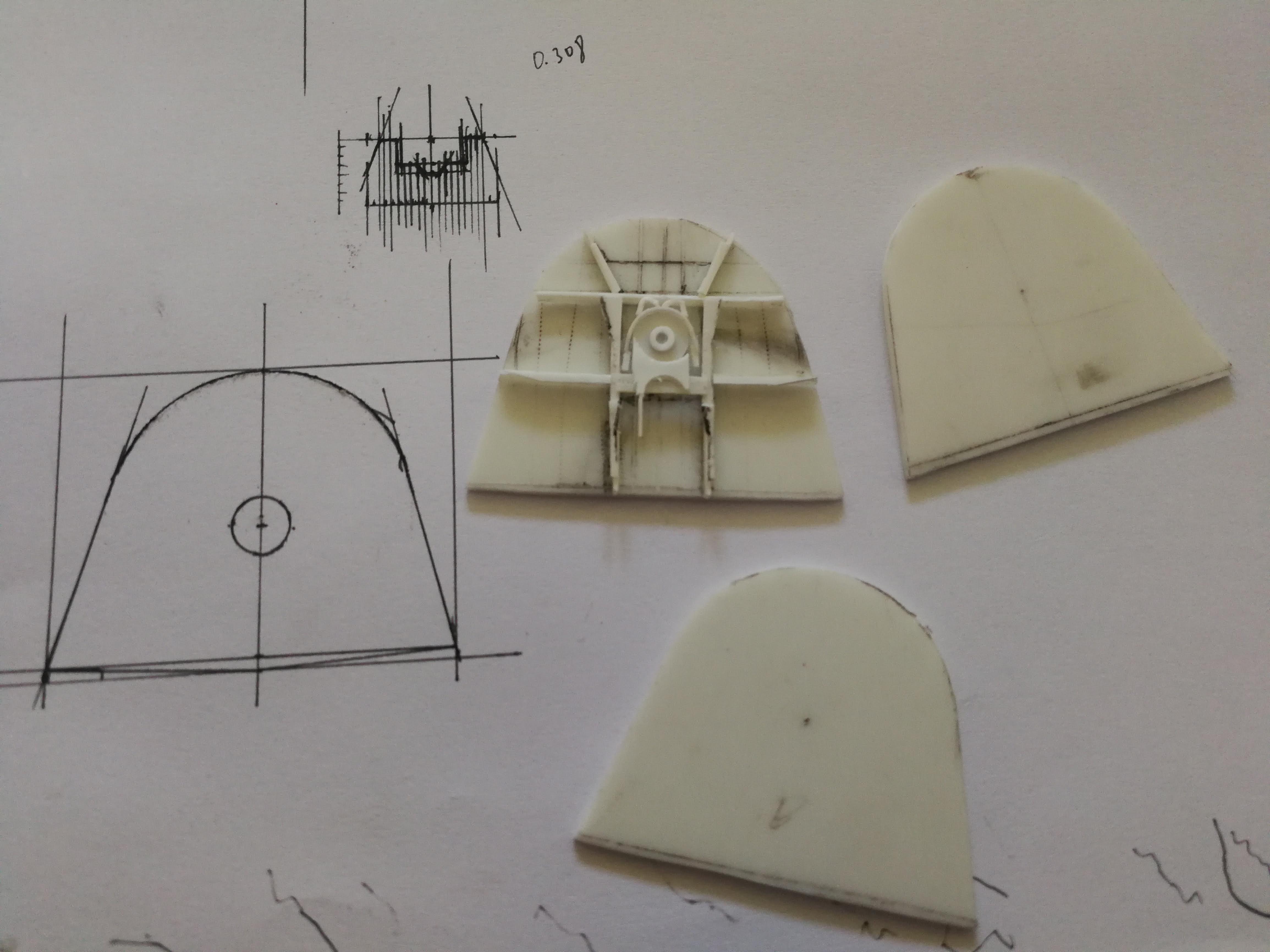

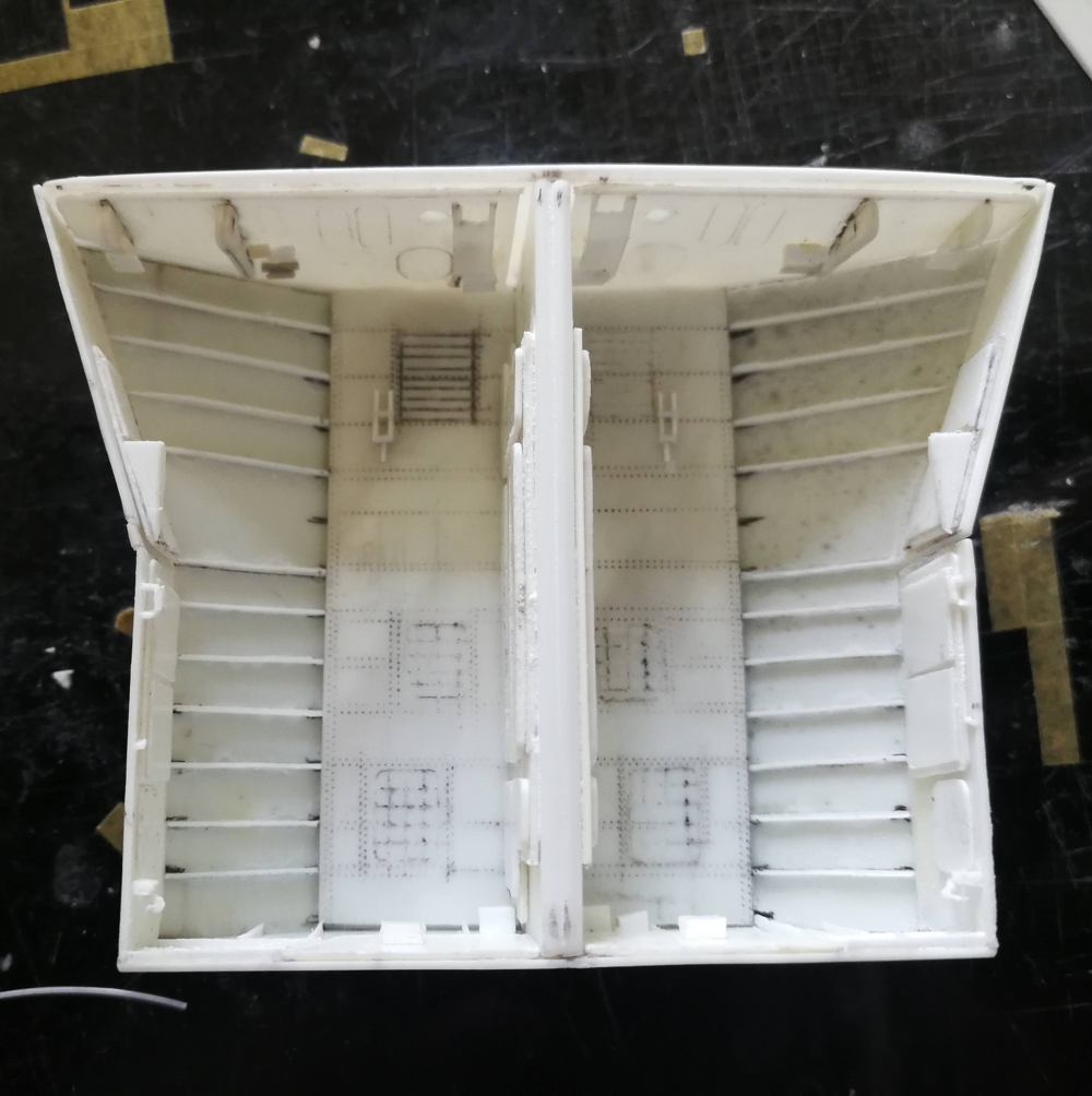

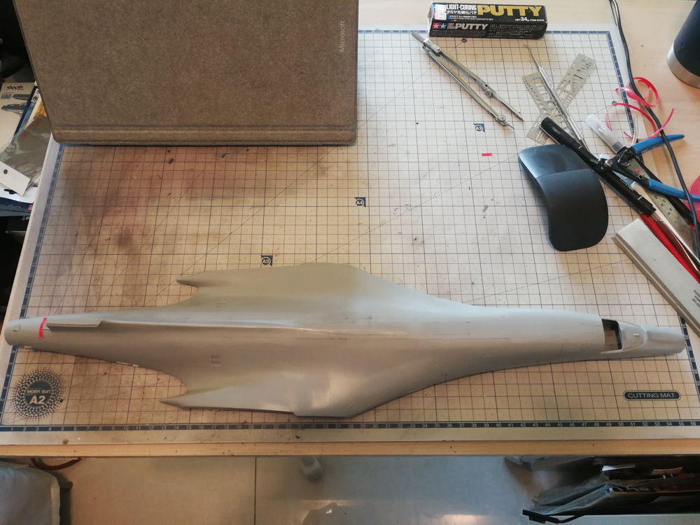

Badmofo Posted March 15, 2021 Share Posted March 15, 2021 (edited) Hi all, here is my 1/72 Revell BONE build in progress. I have done some scratch building on Main Wheel Bay and the Bomb Bays. Started this project a month ago and I hope I can finish it some time later... I did away all the raised panel lines and rebuilt them with 0.15 Tamiya panel engraver. Then added rivets to the panel line. Cut out the original bomb bay for scratch built bomb bay Used reference pix and blueprints found on the web as well as Willy Peeters' B-1B book to scratch build bomb bay and main wheel bay. Aft bomb bay Forward bomb bay test fit. To be continued... Edited March 16, 2021 by Badmofo Quote Link to post Share on other sites

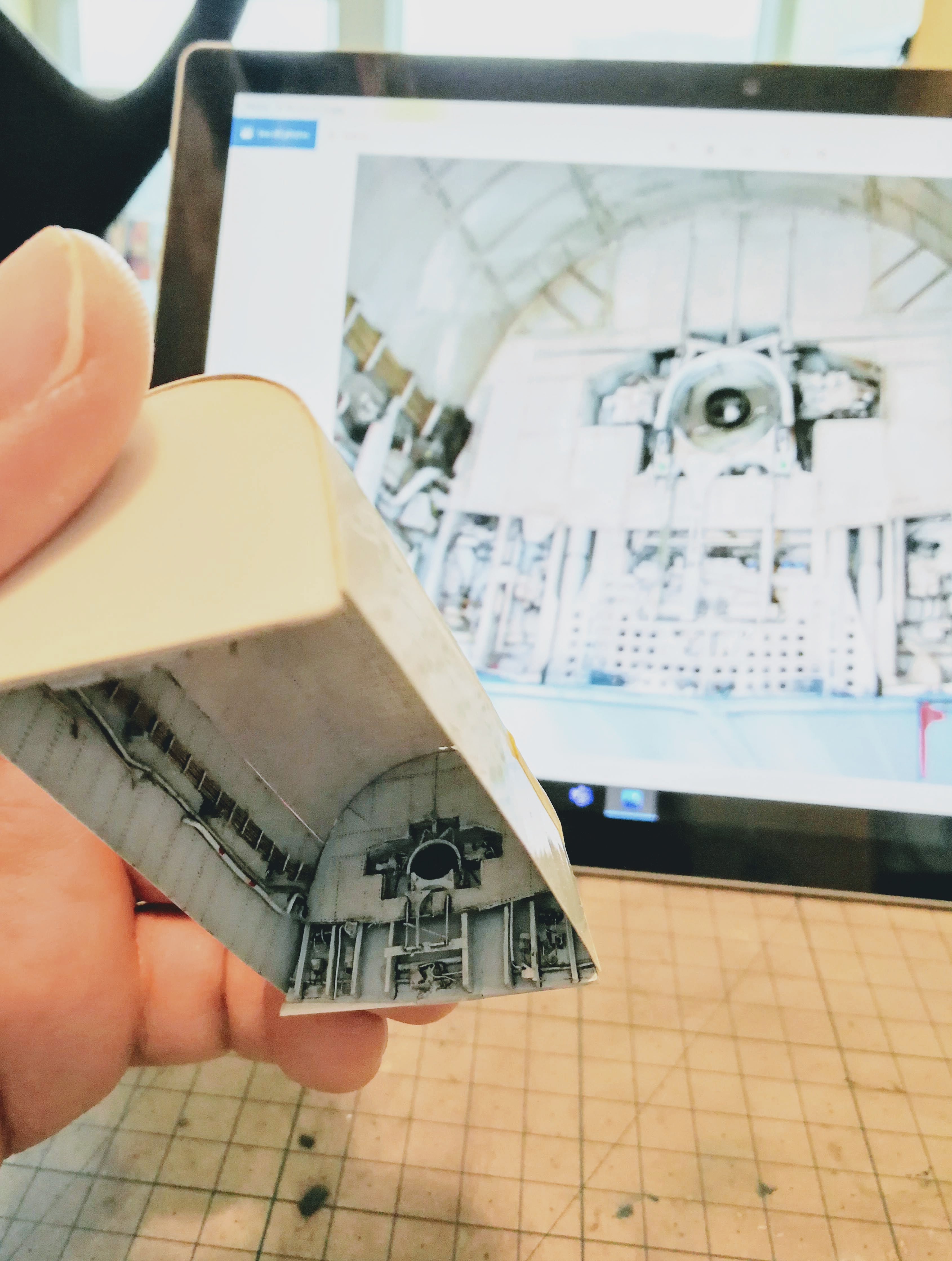

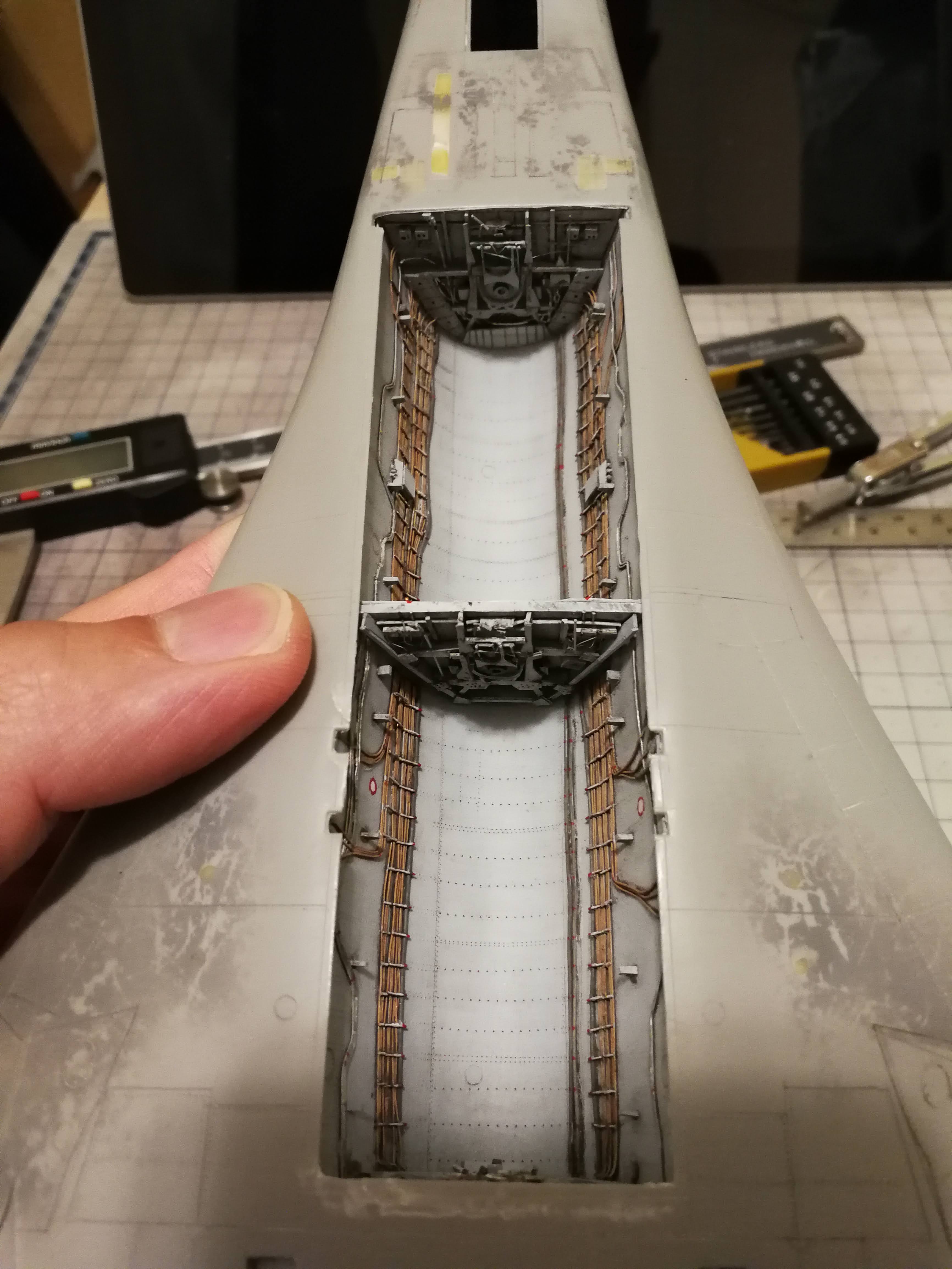

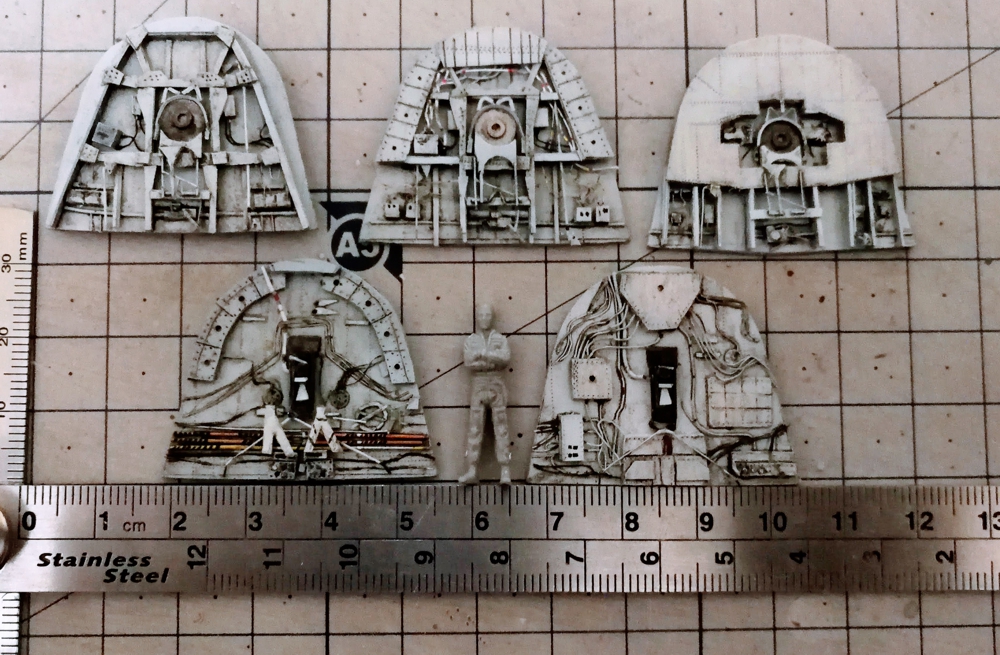

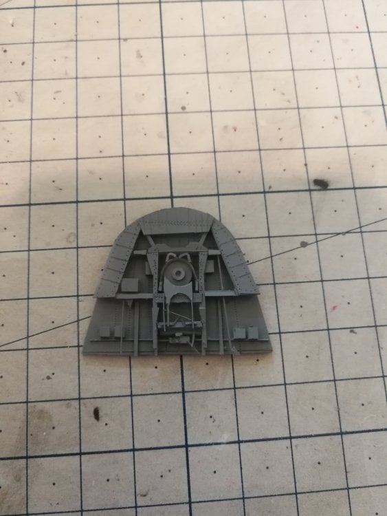

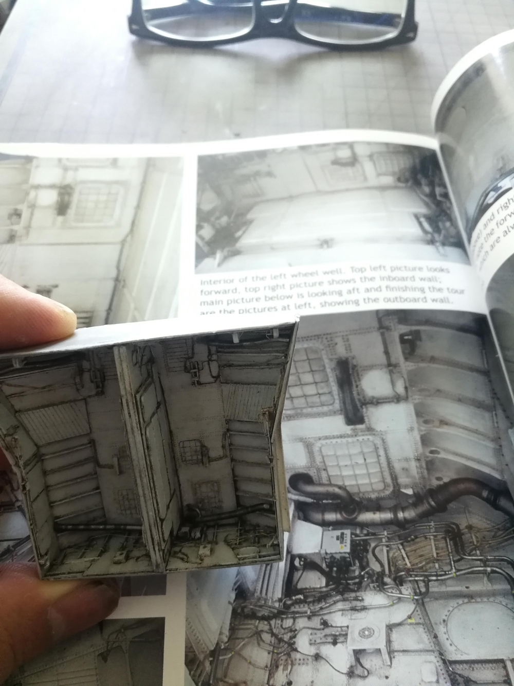

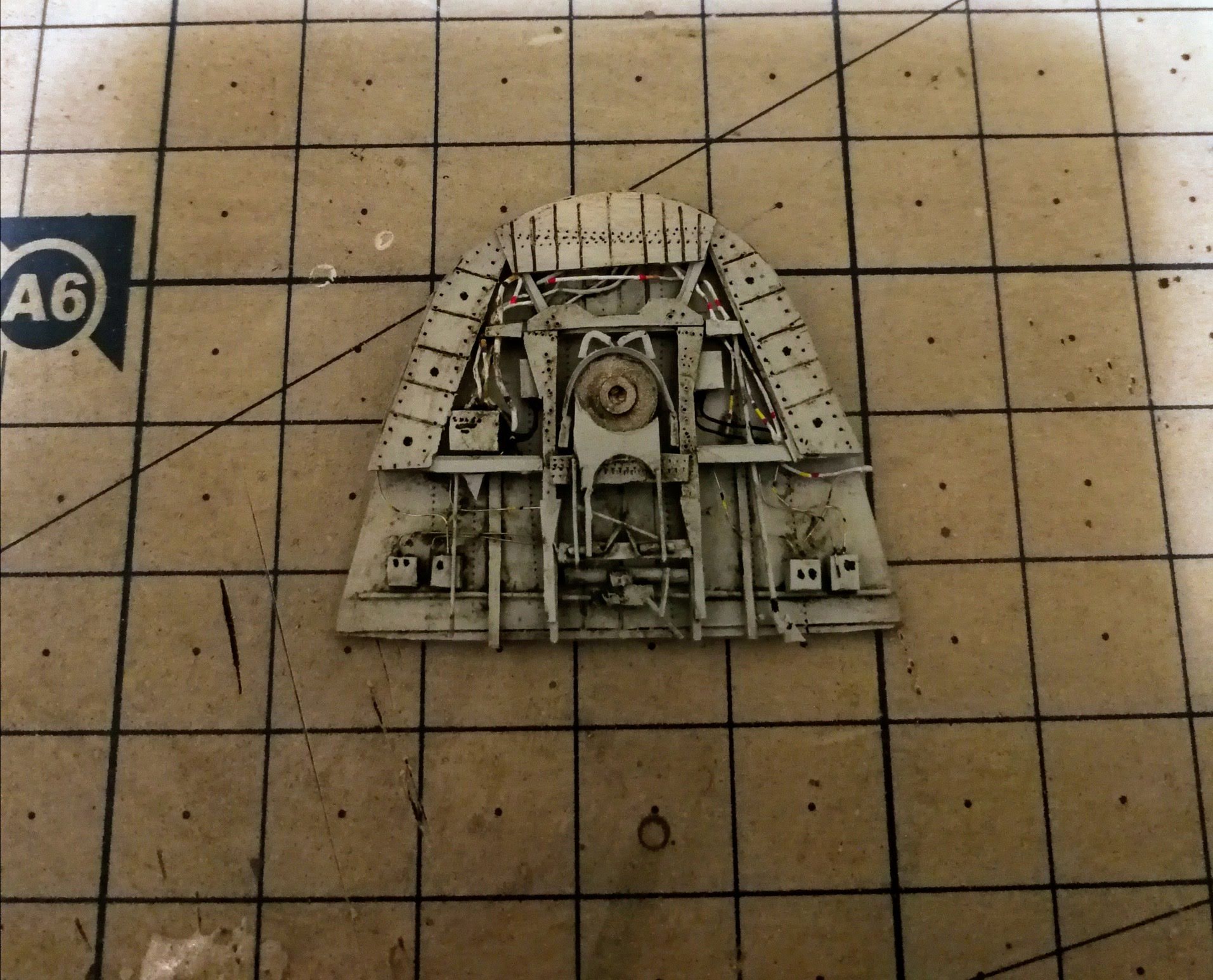

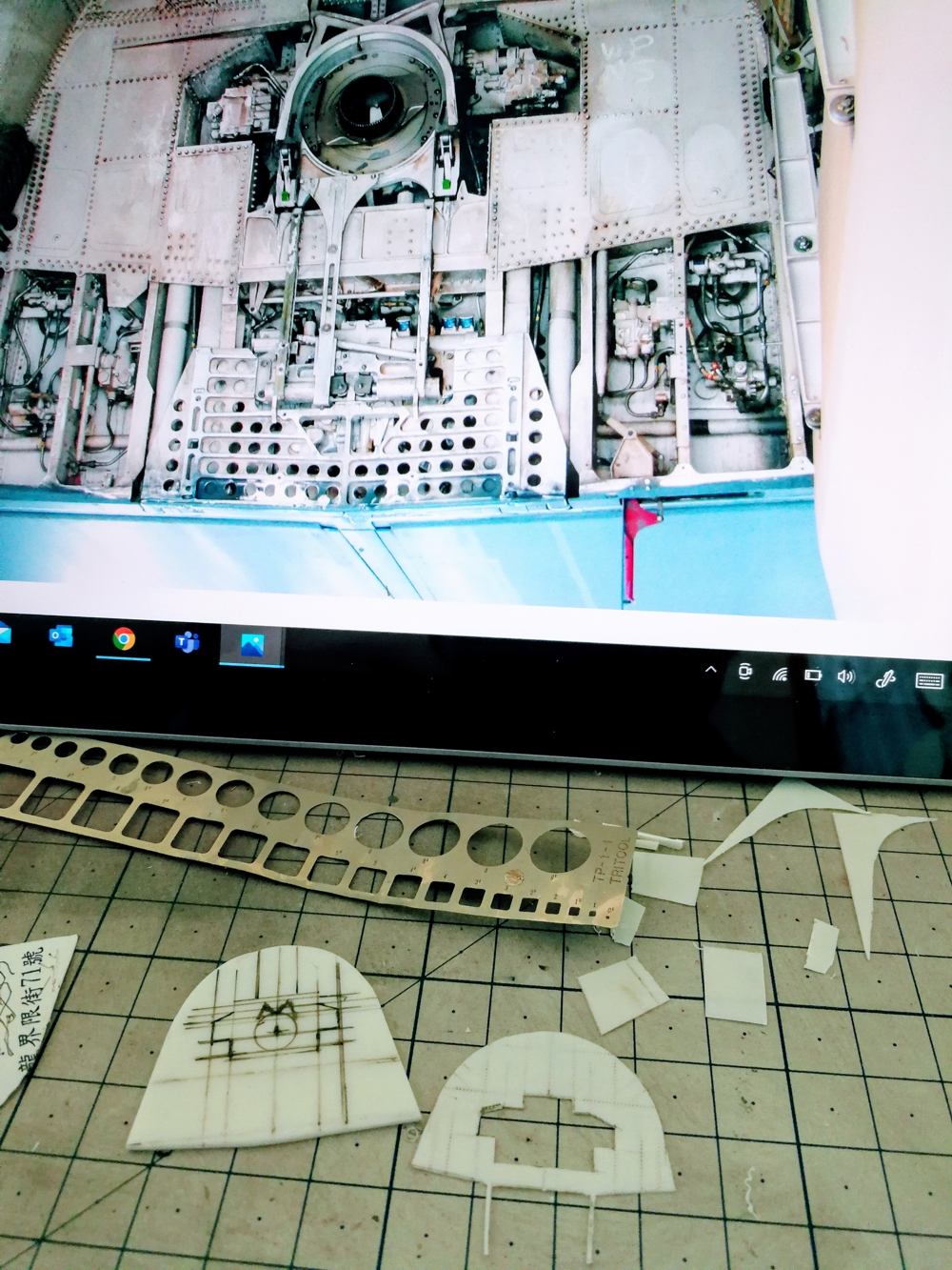

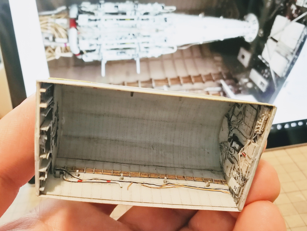

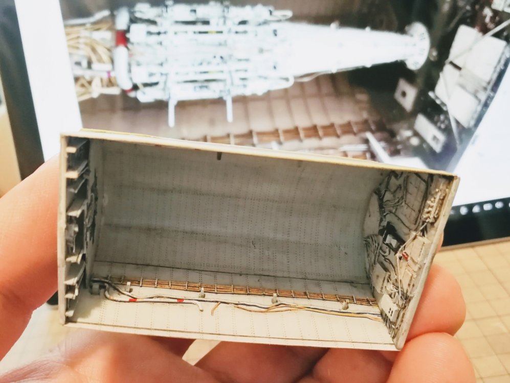

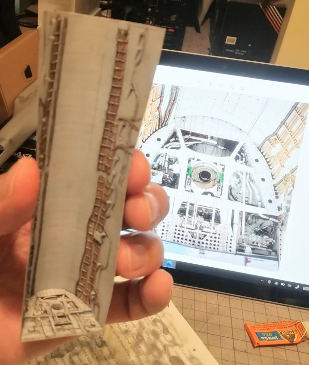

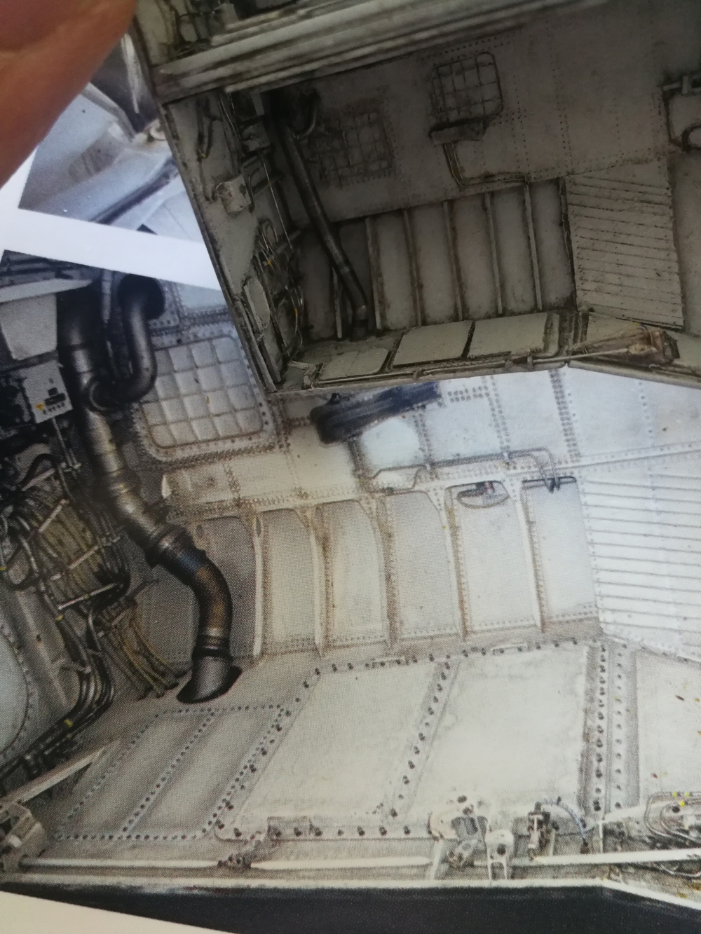

Badmofo Posted March 17, 2021 Author Share Posted March 17, 2021 Hi all, here are some more pictures of BONE's bomb bay and main wheel scratch built parts. I installed 2x1mm magnets at the center of forward bulkhead and aft bulkhead. So I can swap between the scratch built CWM or CRL modules when they are installed into bomb bay without glue. Scratch built main wheel bay. I used Tamiya PLA paper with thickness from 0.3mm to 1.2mm. As for wheel bay dimension I used Revell 1/48 BONE instruction manual as reference to come up with correct 1/72 size. To create a good representation of BONE, Willy Peeters' B-1B book is always a must. With MIG primer Copper wires from 0.1mm to 1.6mm styrene rod were used to create ducts and electrical wirings. Wheel bay painted in off-white then weathered with panel line wash. On to wings! Stay tuned.. Quote Link to post Share on other sites

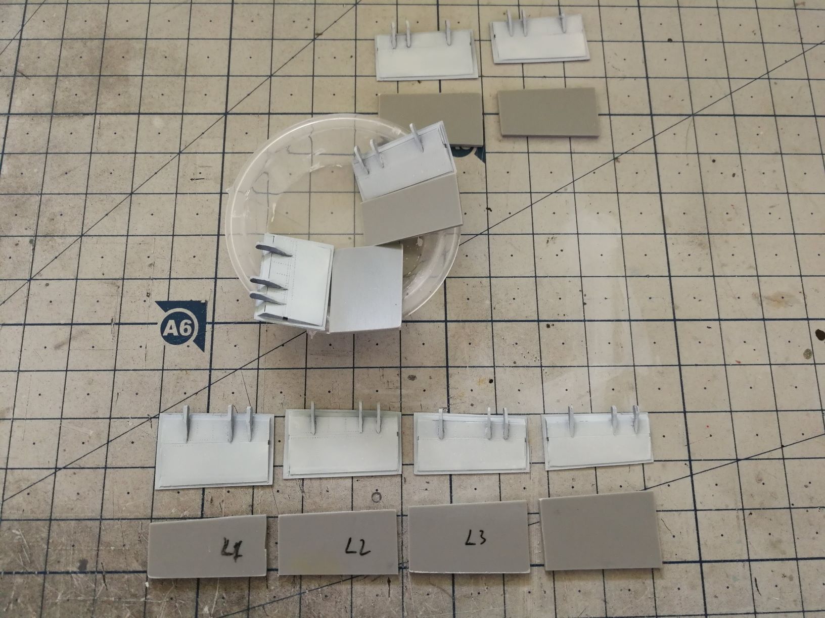

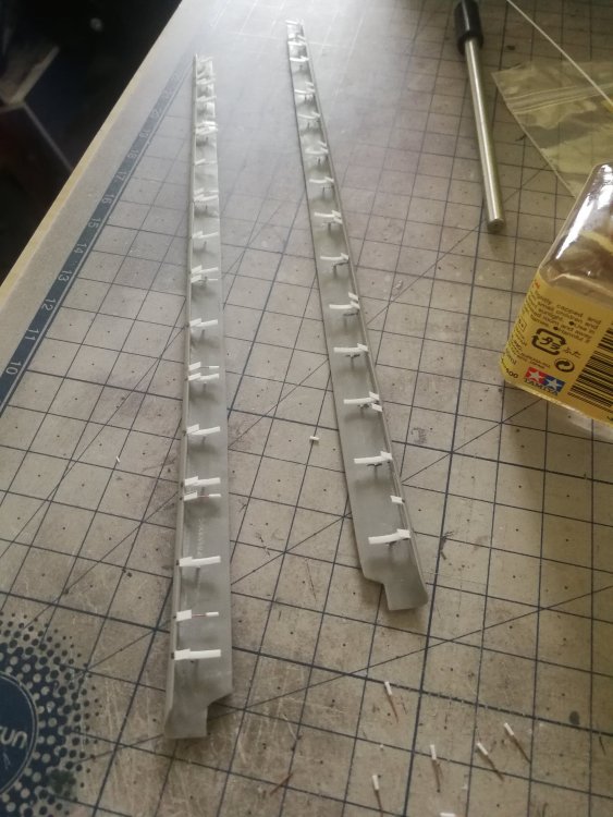

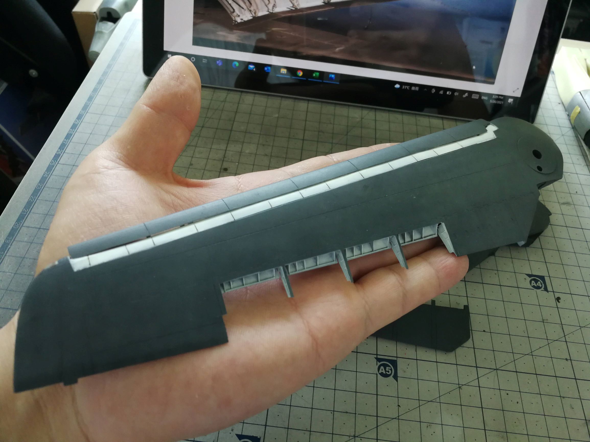

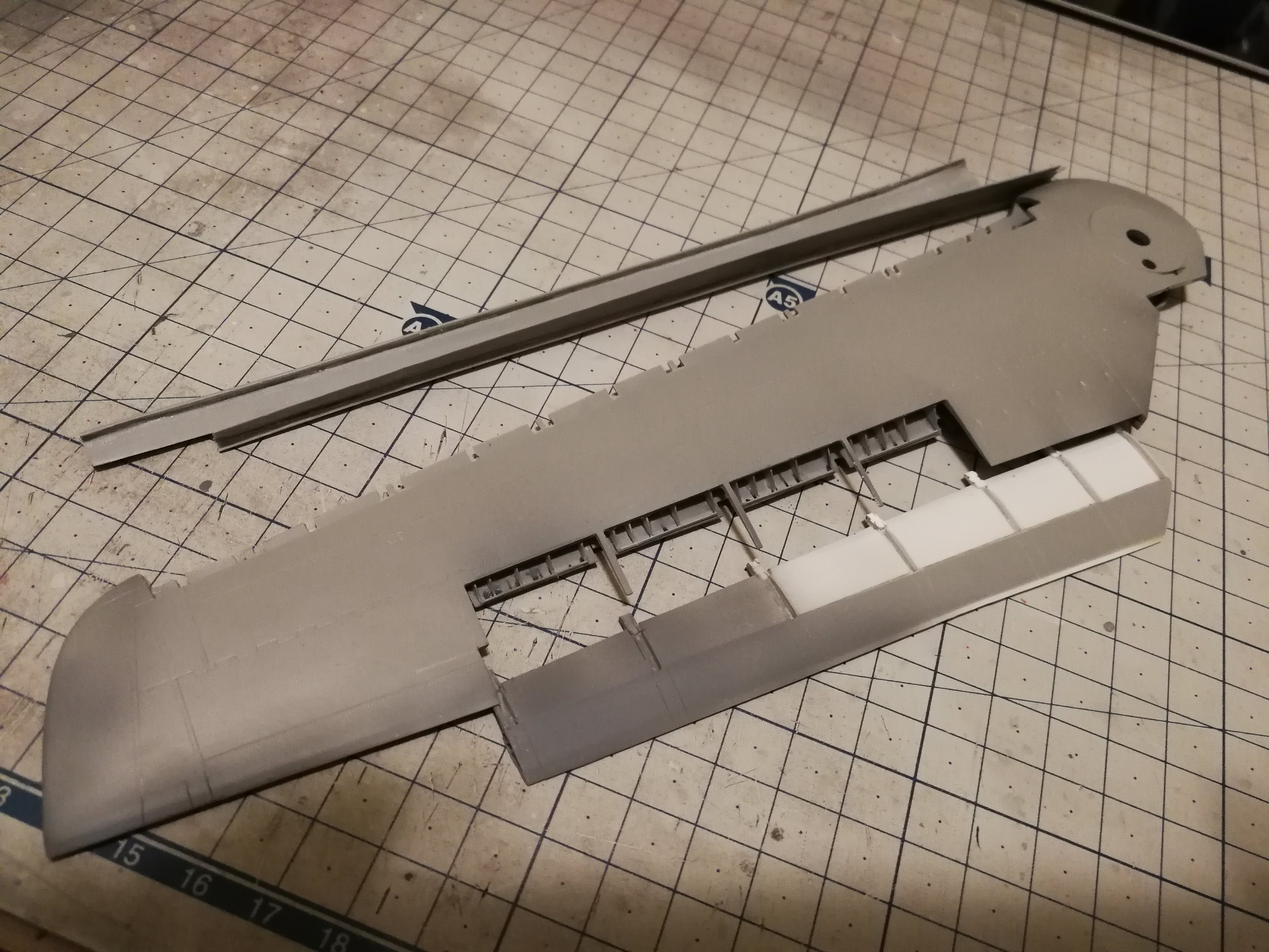

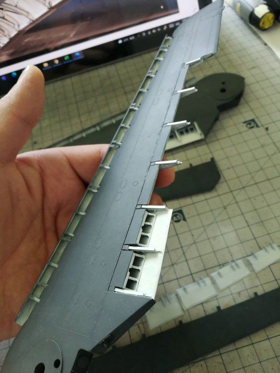

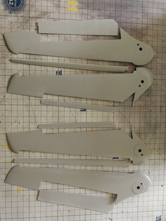

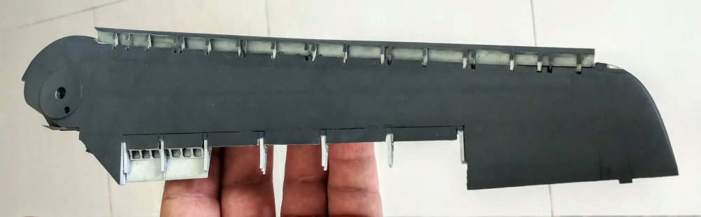

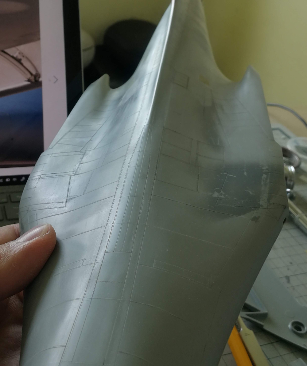

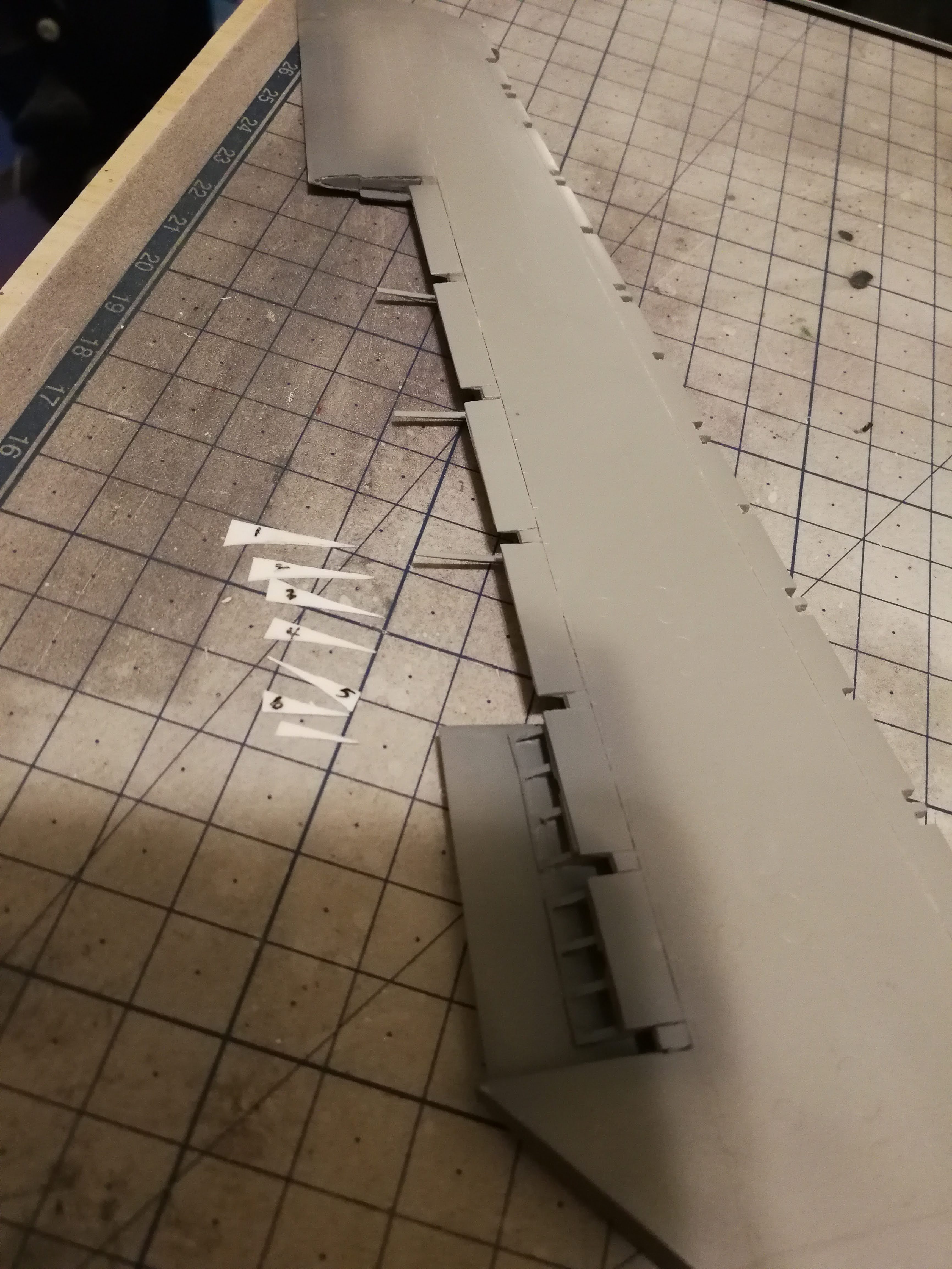

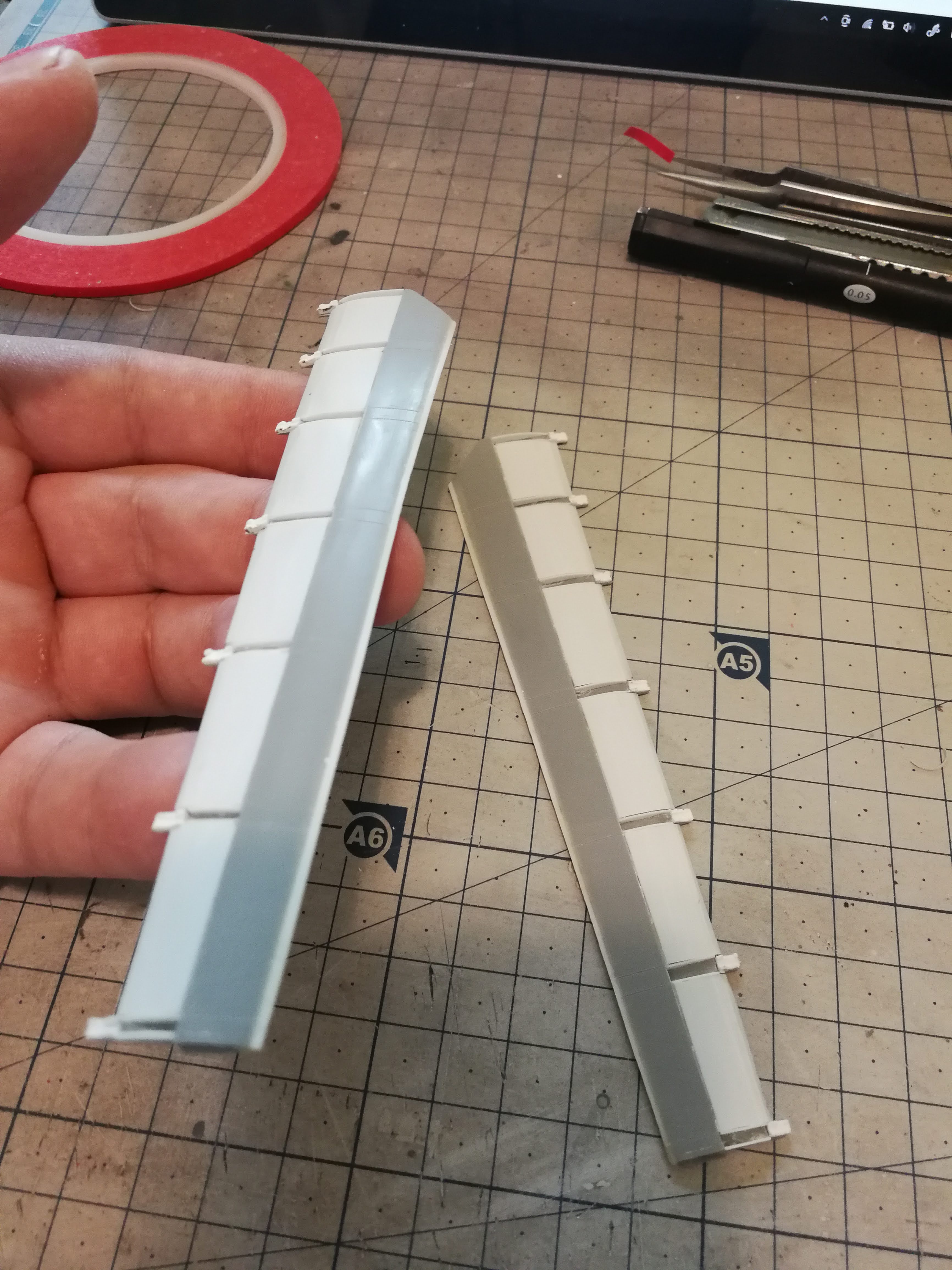

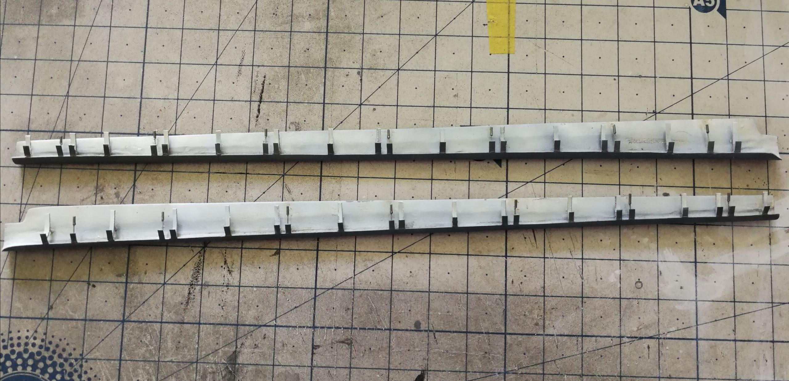

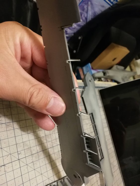

Badmofo Posted May 26, 2021 Author Share Posted May 26, 2021 (edited) Hi all, another round of my BONE building update. Wing's part need to sand and fill putty to correct the shape of flap styrene sheet added more wing structure added original spoilers are too thick. Just made new one with 0.2mm thick styrene sheet. Painted slats Painted in FS36118 medium gunship gray using black basing technique. Before weathering. On to Turbofan parts Stay tuned... Edited May 26, 2021 by Badmofo Quote Link to post Share on other sites

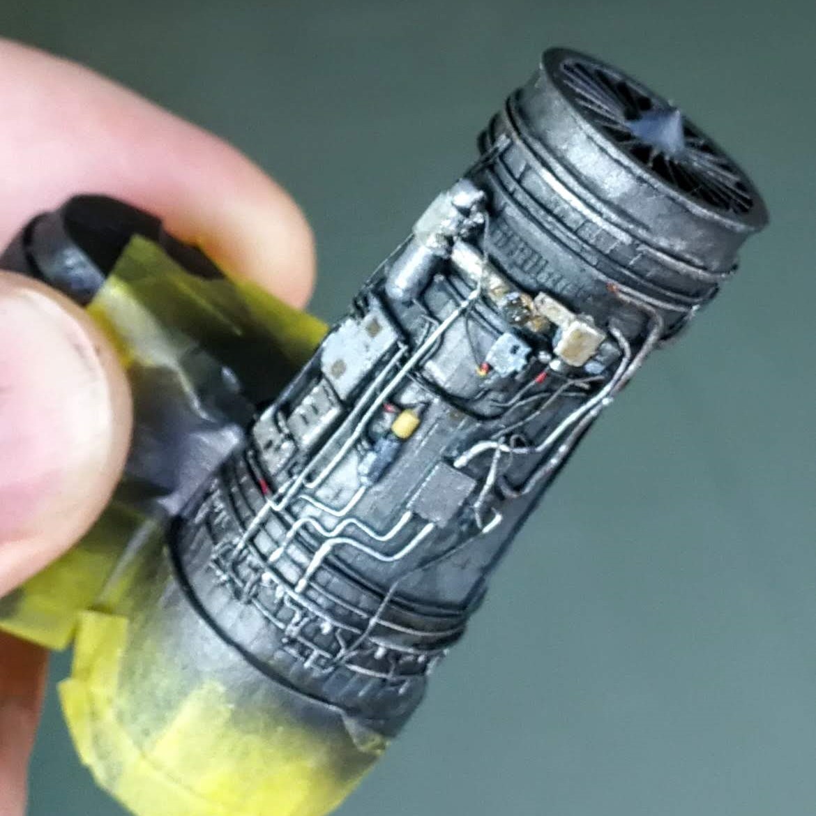

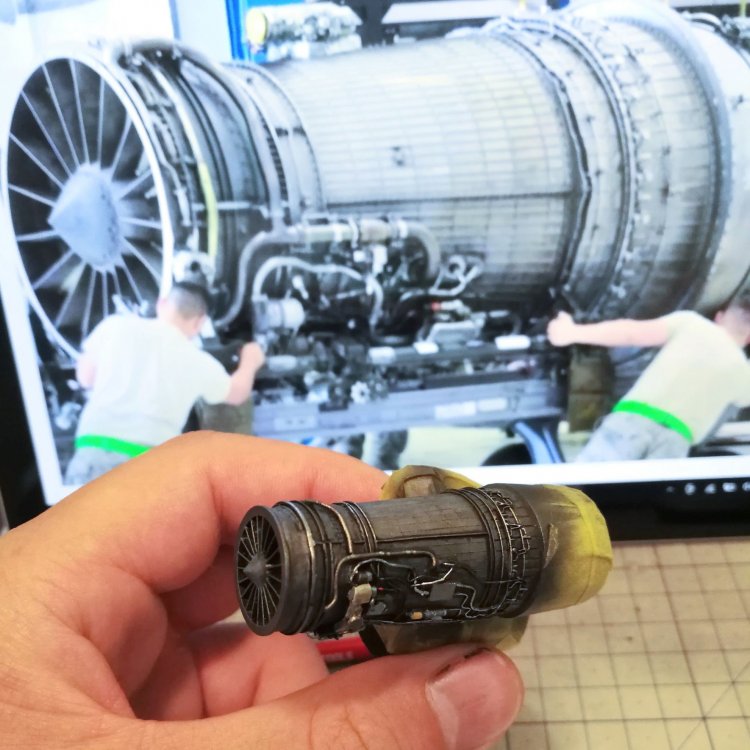

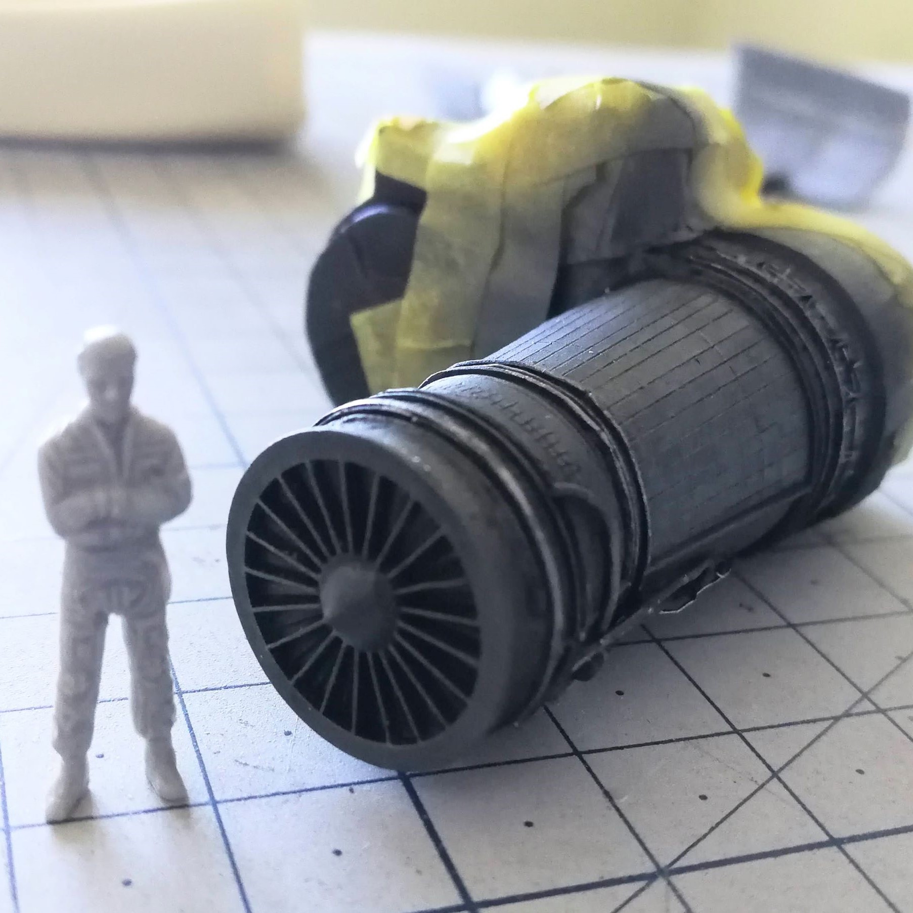

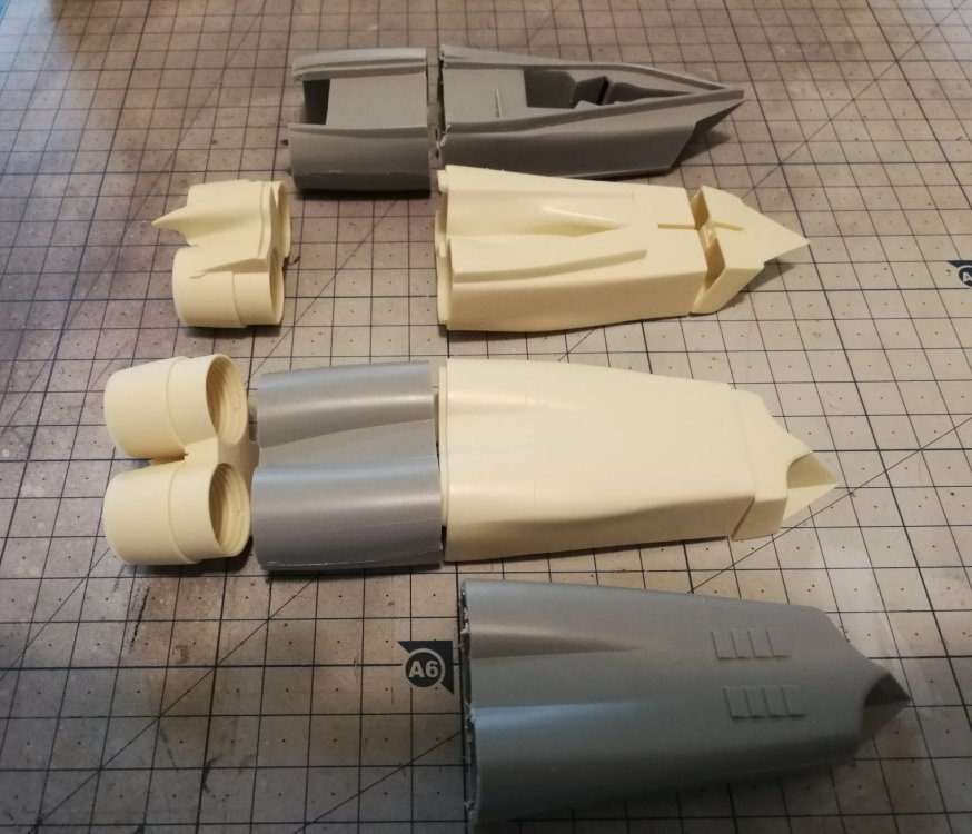

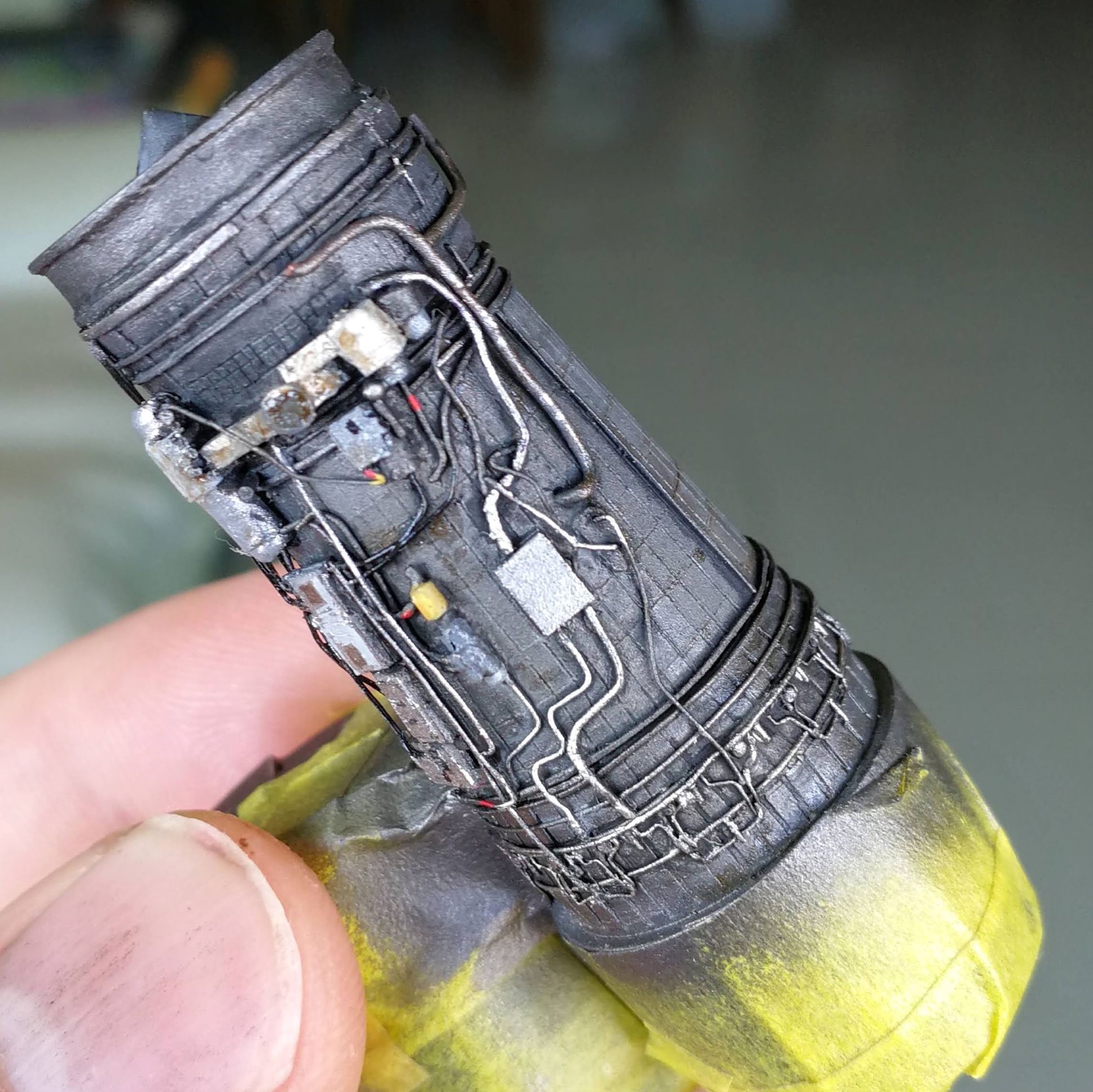

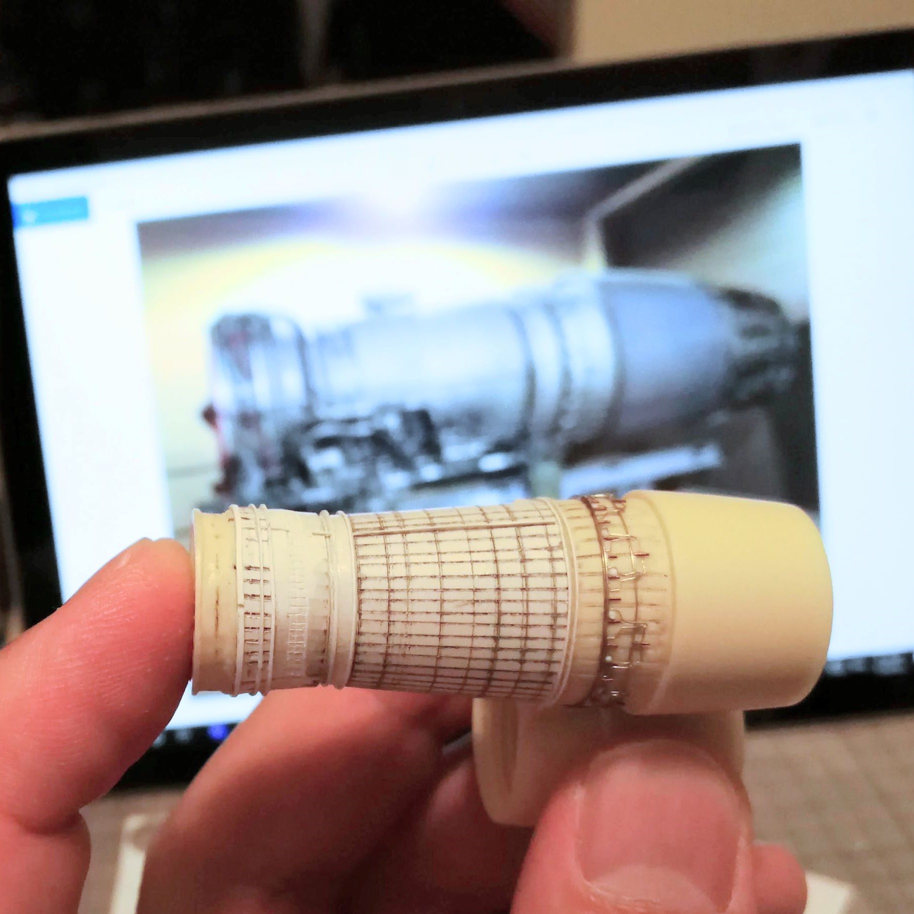

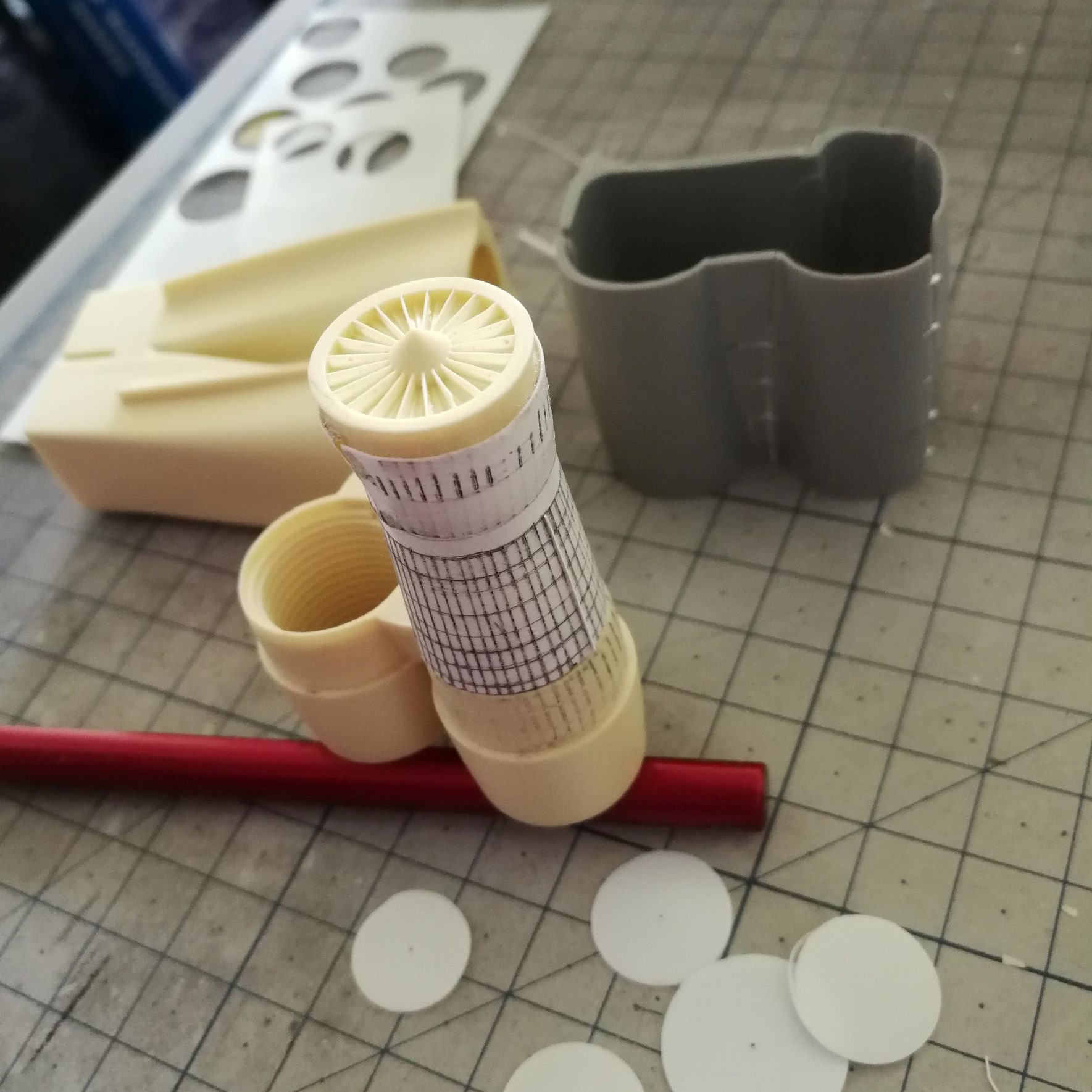

Badmofo Posted November 14, 2021 Author Share Posted November 14, 2021 (edited) Hi all, another round of my BONE building update. Turbofan part's part Edited November 14, 2021 by Badmofo Quote Link to post Share on other sites
