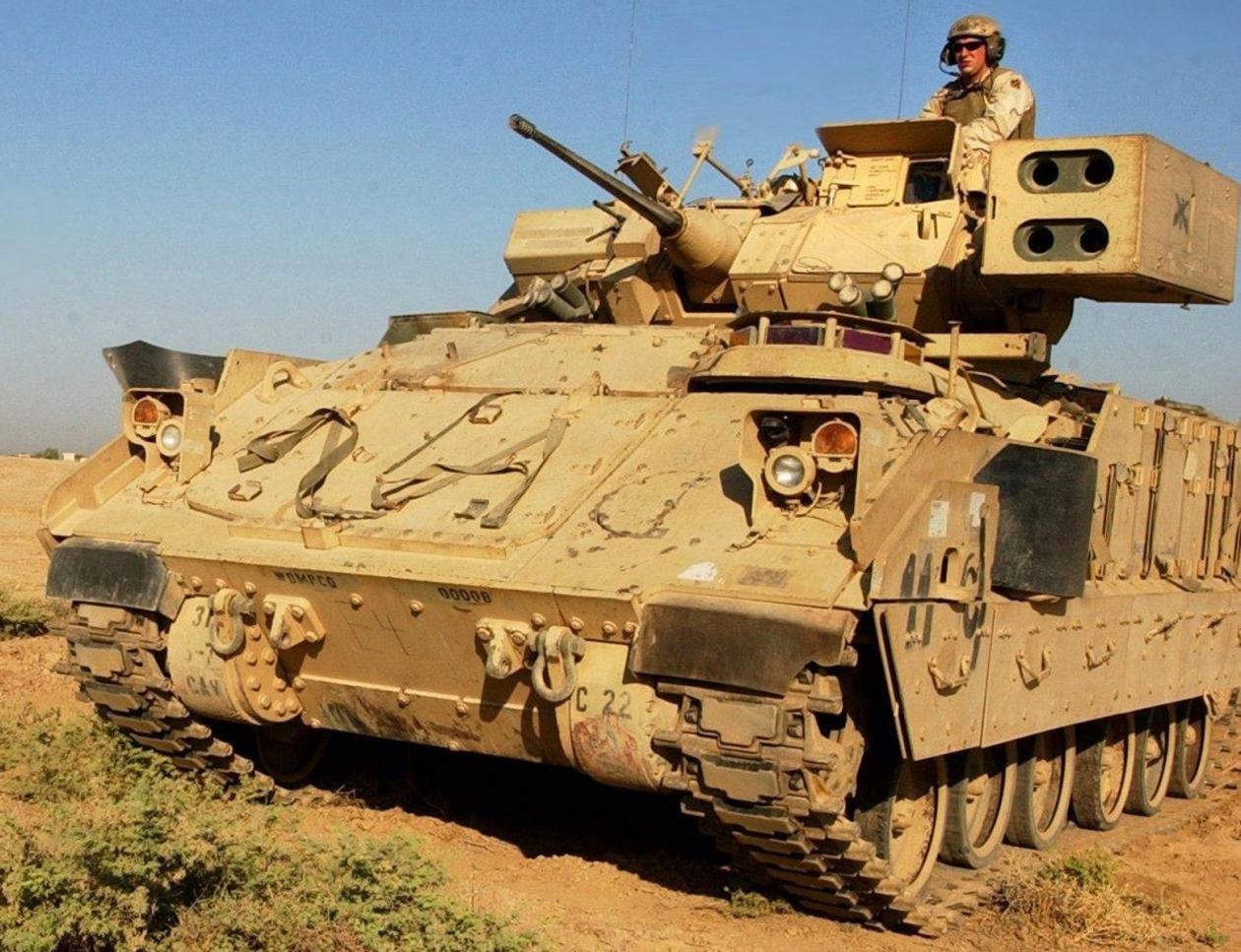

The M6 Linebacker was an ADA version of the Bradley.  There was a four pack Stinger launcher in place of the TOW and the internal stowage and gear layout was different.  They were fielded after Desert Storm and used up through the invasion of Iraq in '03.  They were all converted back to standard M2A2/3 Bradleys by the mid 2000s and are now out of service.  The Army is considering bringing back an updated version now that we are preparing for fighting near-pear competitors with an Airforce and attack helos in the future.  I plan on building it with a full interior.

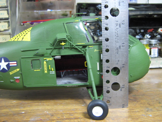

2 hours ago, midnightprowler said:
Beautiful.  Can you put a ruler next to it for a sense of size?
Sure.  It measures right about 4 1/2 inches to the top of the fuselage.
Edited by HeavyArty
Fuselage is 17 1/2" from the nose to tip of tail.  Rotor span is 22".  It is about the same length as a 1/35 Black Hawk, but almost twice as tall.  Like I said, it's big.
Edited by HeavyArty
