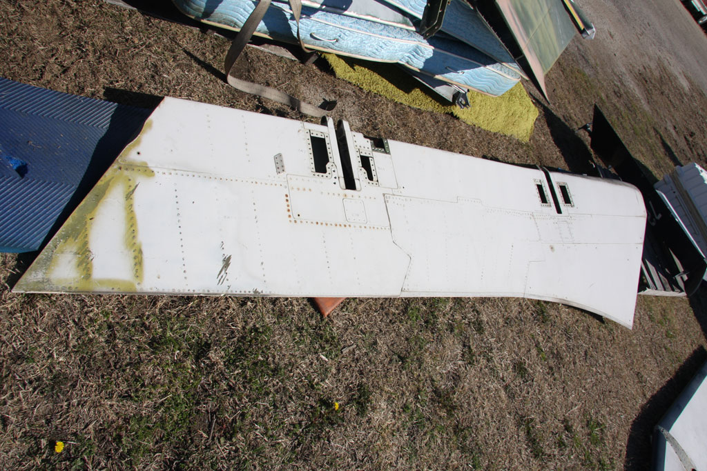

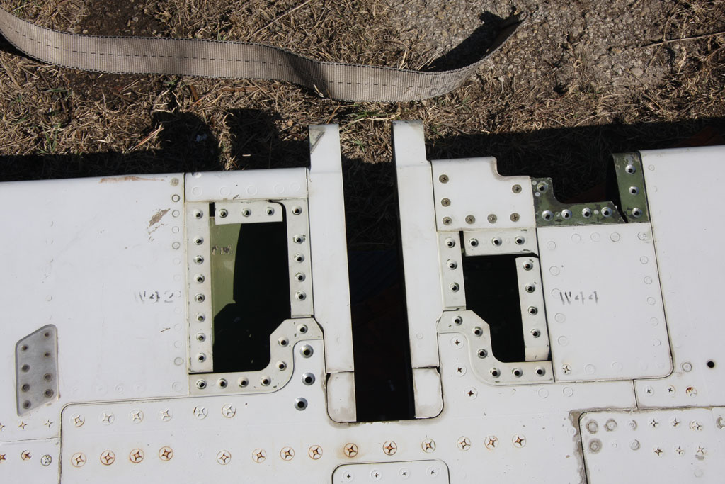

Photogator Posted April 24, 2021 Share Posted April 24, 2021 A few shots of the flap well and a flap laying on the ground are in this series: F-105D 60-5385 Look at pager 2,8,9,10,11,12. I will see if I have anything better from when she arrived in Ft Worth. bill Quote Link to post Share on other sites
chek Posted April 27, 2021 Author Share Posted April 27, 2021 Thanks for the reminder Bill. I've saved many of your WAs over the years. While I had the '385 WA already, I'd forgotten about the detached flap which is very helpful Quote Link to post Share on other sites

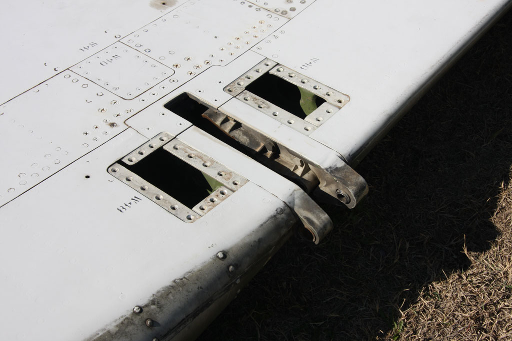

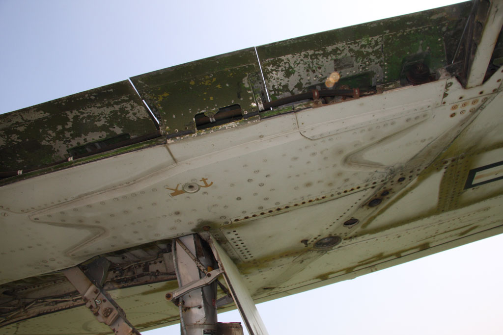

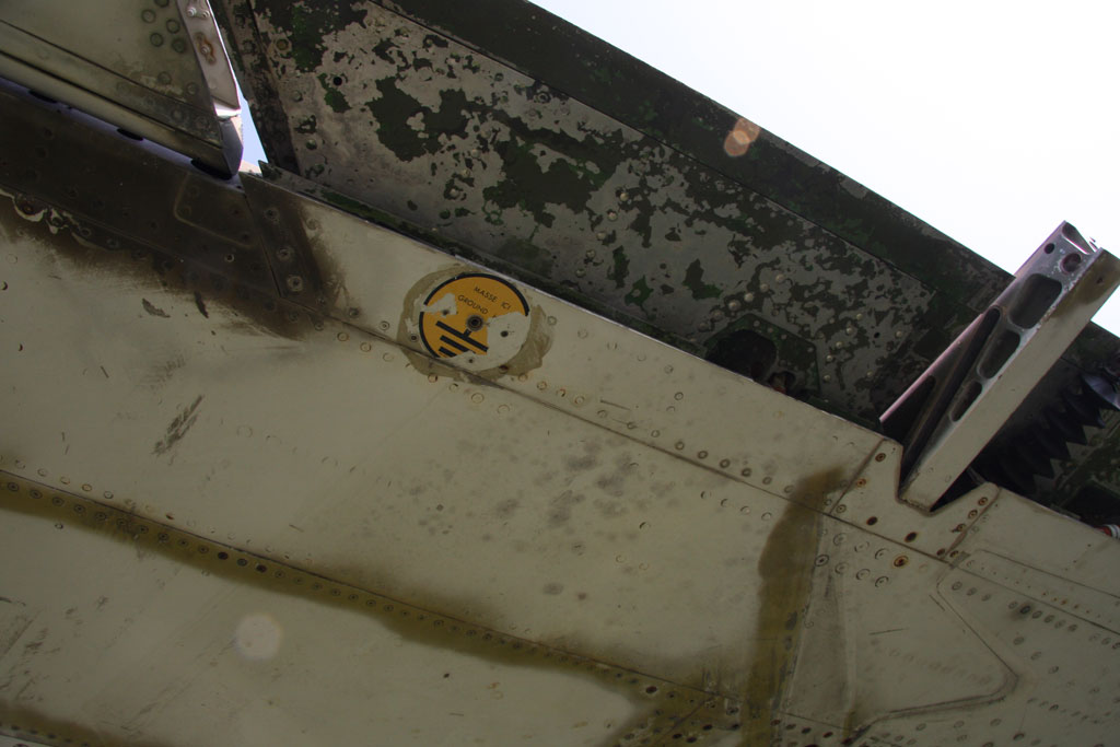

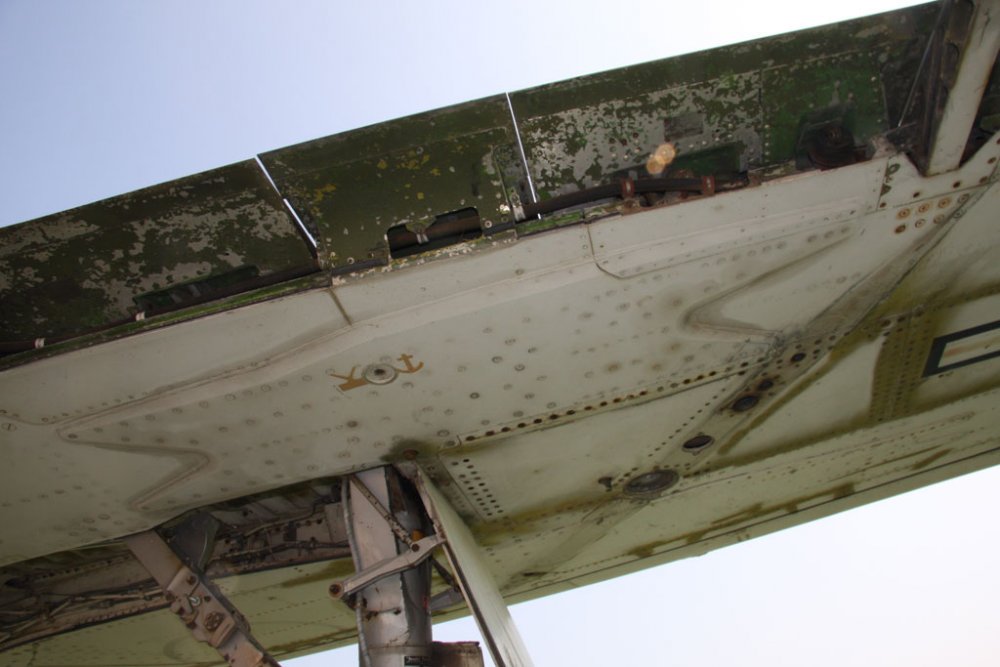

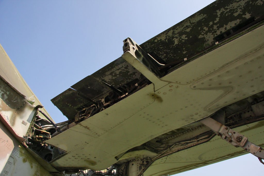

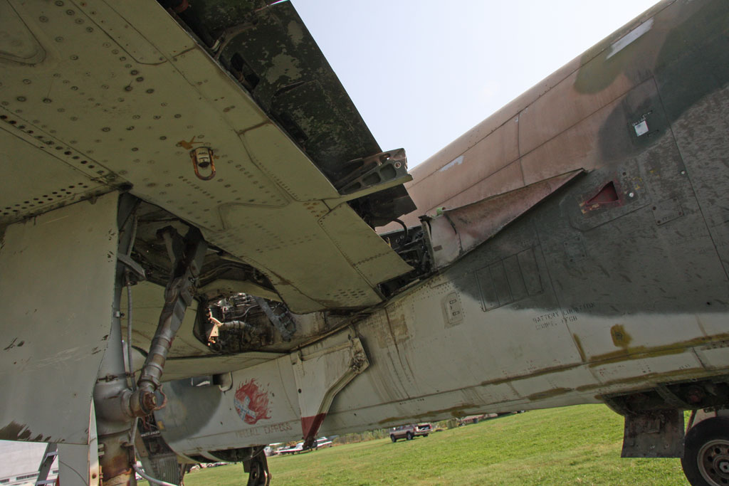

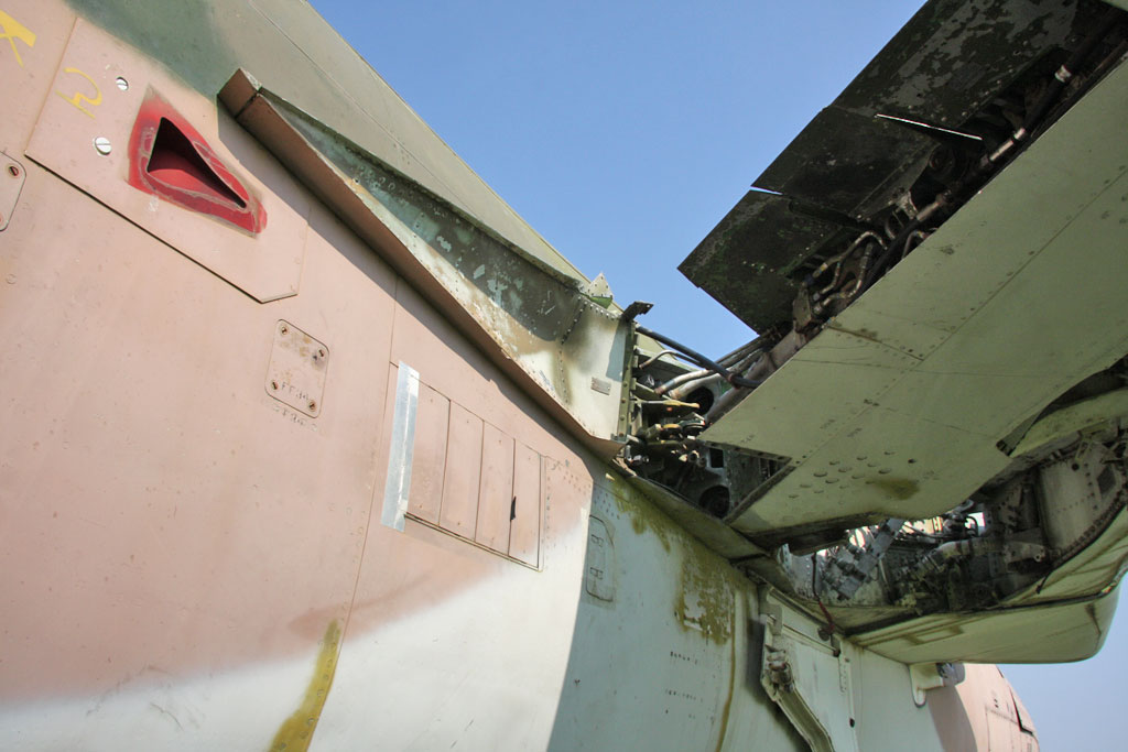

Photogator Posted April 29, 2021 Share Posted April 29, 2021 Here are some views of the left hand flap well and bottom of flap. It appears that I never got around to shooting the top side of either flap after the jet arrived in Ft Worth. Quote Link to post Share on other sites

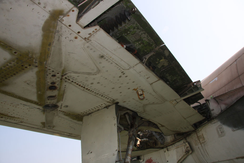

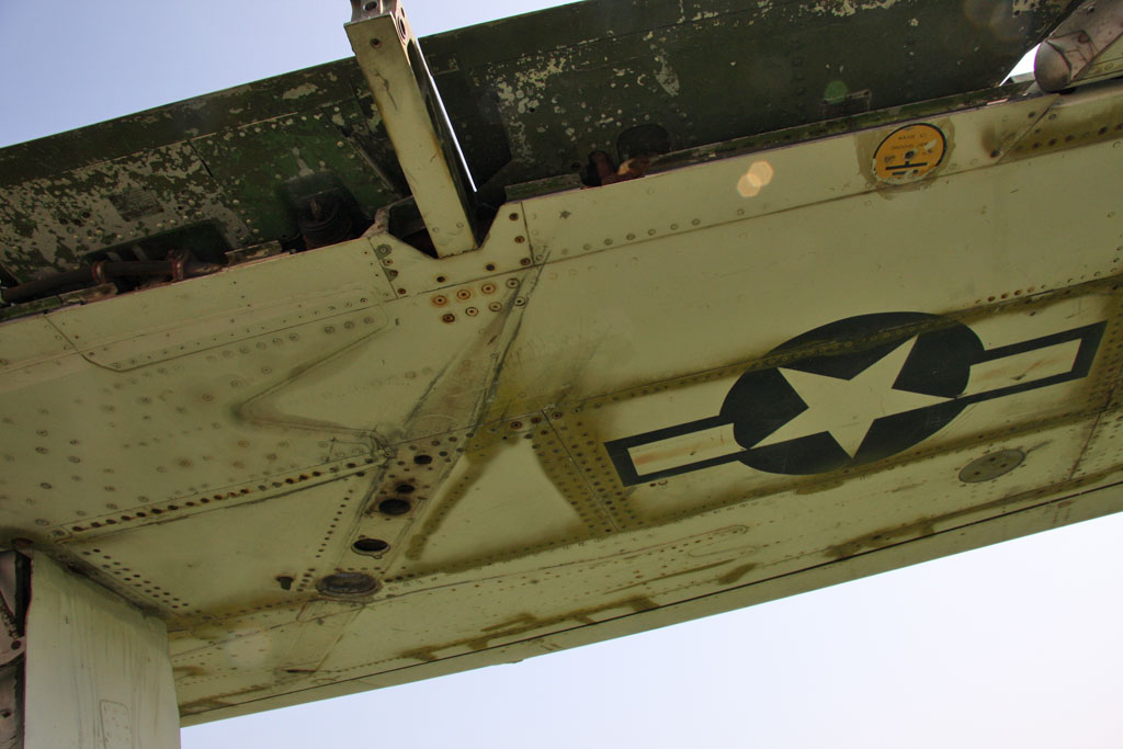

Photogator Posted April 29, 2021 Share Posted April 29, 2021 Here are right side flap well details. Quote Link to post Share on other sites
chek Posted April 29, 2021 Author Share Posted April 29, 2021 Thanks Bill, those photos are a great help. I'll have to build a rig to figure how the flaps actually move, with the hinges pointing inboard but the flaps apparently moving rearwards. Quote Link to post Share on other sites

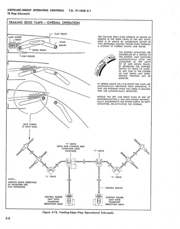

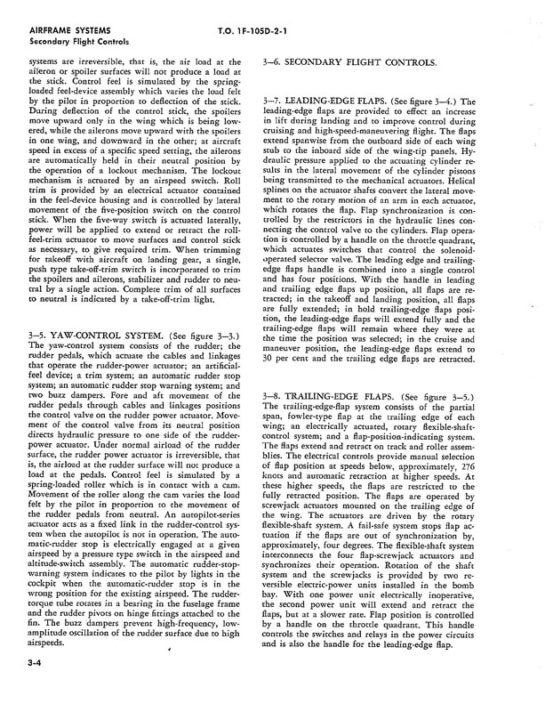

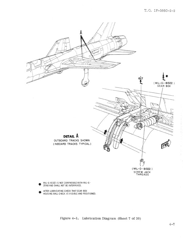

Photogator Posted April 30, 2021 Share Posted April 30, 2021 14 hours ago, chek said: Thanks Bill. It might seem a bit weird, but I like a model that helps to understand how things work. Btw the two pdf links aren't working. Sorry about that. They uploaded just fine last night. I guess the system gagged on them afterwards. Here are jpgs of the same pages from the manuals. As for understanding how things work, that is why I got into aviation. Quote Link to post Share on other sites
