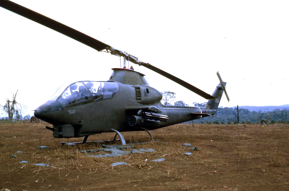

Here's a follow-up to my earlier posts. One of the problems you face when modeling Cobras is time and place. Not surprisingly, most of the photos you see of Cobras in Vietnam have shark-mouths, cool names, and other artwork all from later in the conflict. When I flew in the Central Highlands in 1969 and 1970 there wasn't any of that. The Cobras were basically as delivered from the factory. They had conspicuity and unit markings and little else. Occasionally, you'd see the crew chiefs' name. Here’s an example:
68-15051-03-Corrected.jpg.3869710d0f6eb56f53a1b8150b31ebfb.jpg.
This is 68-15051, the 594th Cobra built; a 361 Aerial Escort Company G model at the Volcano LZ near Duc Lap in November, 1969. It has a blue canopy and there is no Environmental Control System inlet. Additionally, the VHF blade antenna is not present on the underside of the tailboom. It's worn OD overall. The 90 degree gearbox cover has been replaced, and it's still in zinc chromate. The skids are black. There are no technical markings visible. It carries the standard conspicuity markings from that era; orange on the front half of the surfboard, orange on the tops of the sync elevators, the top of one rotor blade painted white, and the top of the opposite blade painted black. The tail rotor is flat OD with yellow tips. The red, white, and blue rings on the tailboom are 17th Combat Aviation Group markings. The tops of the sync elevators carry “52” in black on the left sync elevator and “361” in black on the right sync elevator (52nd Combat Aviation Battalion, 361 Aerial Escort Company) a common practice for 1st Aviation Brigade helicopters. The crew chief’s name (L. Sciapo) is hand painted on the nose in white. You'll also notice that the front crosstubes have the fairings installed and the rear crosstubes do not. The “last 3” are carried on the vertical stabilizer in yellow. Notice that the "5" is in fact an upside down and backwards "2". It carries a minigun in the right bay of the turret, and a 40mm grenade launcher in the left bay. Two XM-200 19-shot pods and two XM-158 7-shot pods are carried on the wing pylons. This loadout was ubiquitous at time. It has the original pusher tail rotor. Also notice the sand shields on the rotor head.
Not as colorful as later Cobras, but still interesting.
