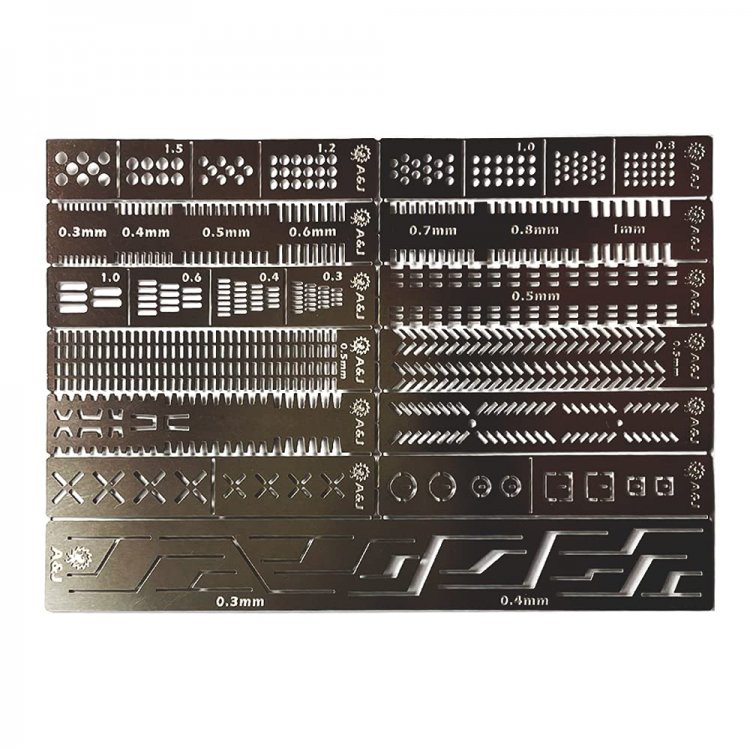

RichB63 Posted March 21, 2023 Share Posted March 21, 2023 (edited) Since the rivets on the LH forward fuselage appear to be intact, you could lay a piece of clear tape over them and gently puncture the tape above each rivet with a needle. Remove the perforated tape and reapply it over the RH forward fuselage. Now you have a rivet guide. It worked for me on my Phantom build...click here (see second post on page two). Edited March 21, 2023 by RichB63 Quote Link to post Share on other sites

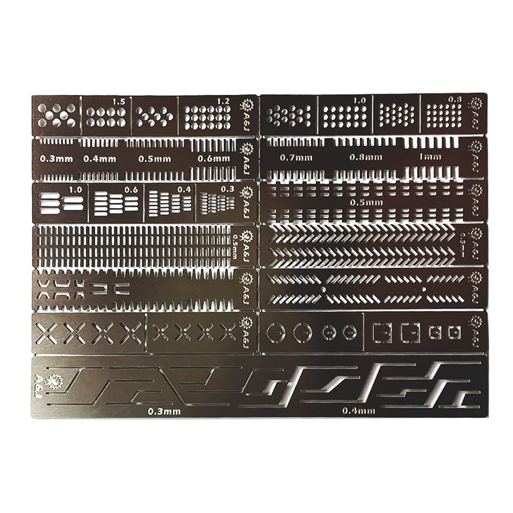

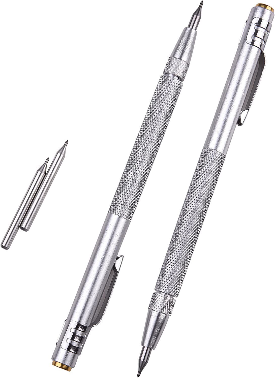

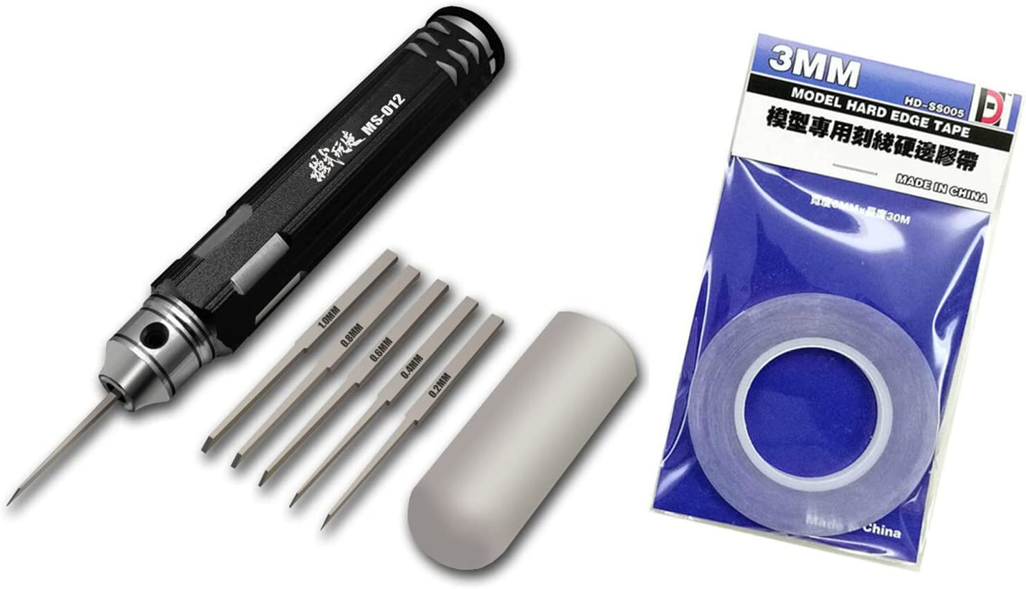

dai phan Posted March 21, 2023 Author Share Posted March 21, 2023 Hi all, I went ahead and order some tools hoping to get the scribing job more acceptable. I think the only way to place the rivets evenly is with the guide as RichB63 pointed out and I ordered one on Amazon. Dai Quote Link to post Share on other sites

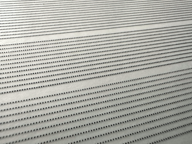

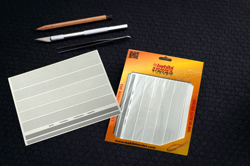

dai phan Posted March 22, 2023 Author Share Posted March 22, 2023 (edited) Hello all, I just ordered the Babibi rivet set and hopefully I can use it on the future builds. Dai Edited March 22, 2023 by dai phan Quote Link to post Share on other sites

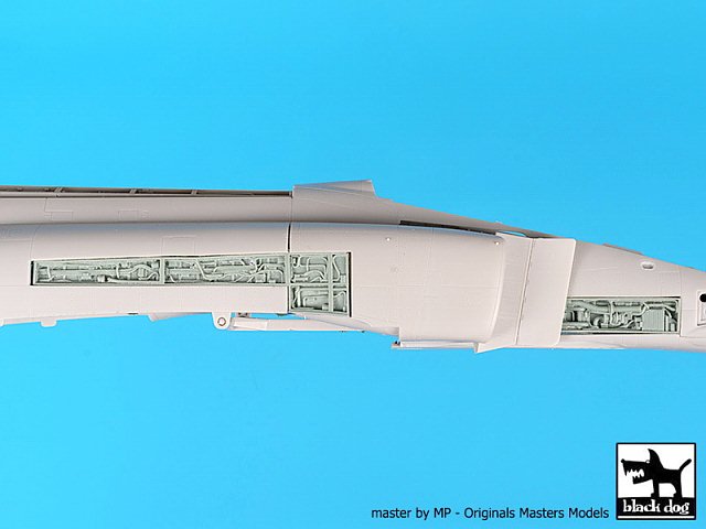

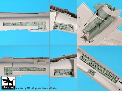

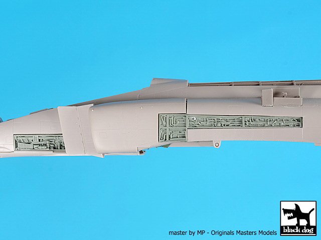

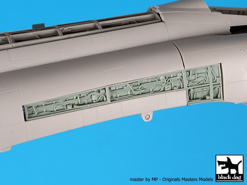

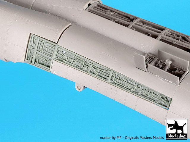

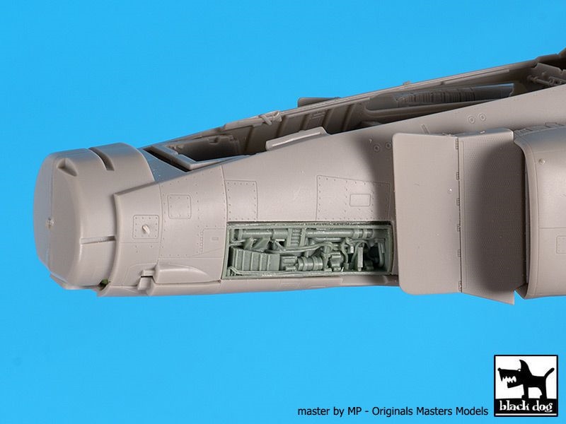

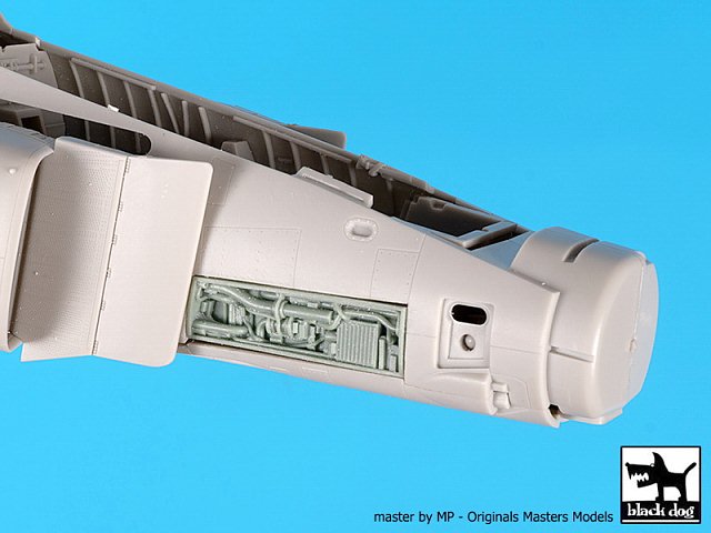

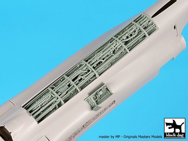

dai phan Posted March 22, 2023 Author Share Posted March 22, 2023 (edited) Greetings, I do not have the Black Dog detail set in my hands but looking at the photos, I do not think there are any mounting tabs. This is not a big problem but the potential issue is the fit of the parts to the fuselage. There seems to be gaps every where and this means filling and sanding. And that means panel lines and rivets are to be lost (the main reason why I start all over). The only thing that seems to fit well is the RAM on top of the left fuselage. On EB there are some offers with spare fuselage so I will order these to check the fit of the resin parts. Dai Edited March 22, 2023 by dai phan Quote Link to post Share on other sites
lockheed2004 Posted March 22, 2023 Share Posted March 22, 2023 The pieces in those photos are not glued together, note the large gaps present. The Black Dog sets are 3-D printed and fit quite well, in my experience. I'd pump the brakes a bit until you have the sets in hand, before buying additional fuselages pieces. Quote Link to post Share on other sites
dai phan Posted March 22, 2023 Author Share Posted March 22, 2023 2 hours ago, lockheed2004 said: The pieces in those photos are not glued together, note the large gaps present. The Black Dog sets are 3-D printed and fit quite well, in my experience. I'd pump the brakes a bit until you have the sets in hand, before buying additional fuselages pieces. Yes of course. I see the pieces are just there not glued together for photos but I wished they have. Does not look good on photos. Dai Quote Link to post Share on other sites
dai phan Posted March 22, 2023 Author Share Posted March 22, 2023 3 hours ago, lockheed2004 said: The pieces in those photos are not glued together, note the large gaps present. The Black Dog sets are 3-D printed and fit quite well, in my experience. I'd pump the brakes a bit until you have the sets in hand, before buying additional fuselages pieces. Do they have mounting tabs of just the pieces? Dai Quote Link to post Share on other sites

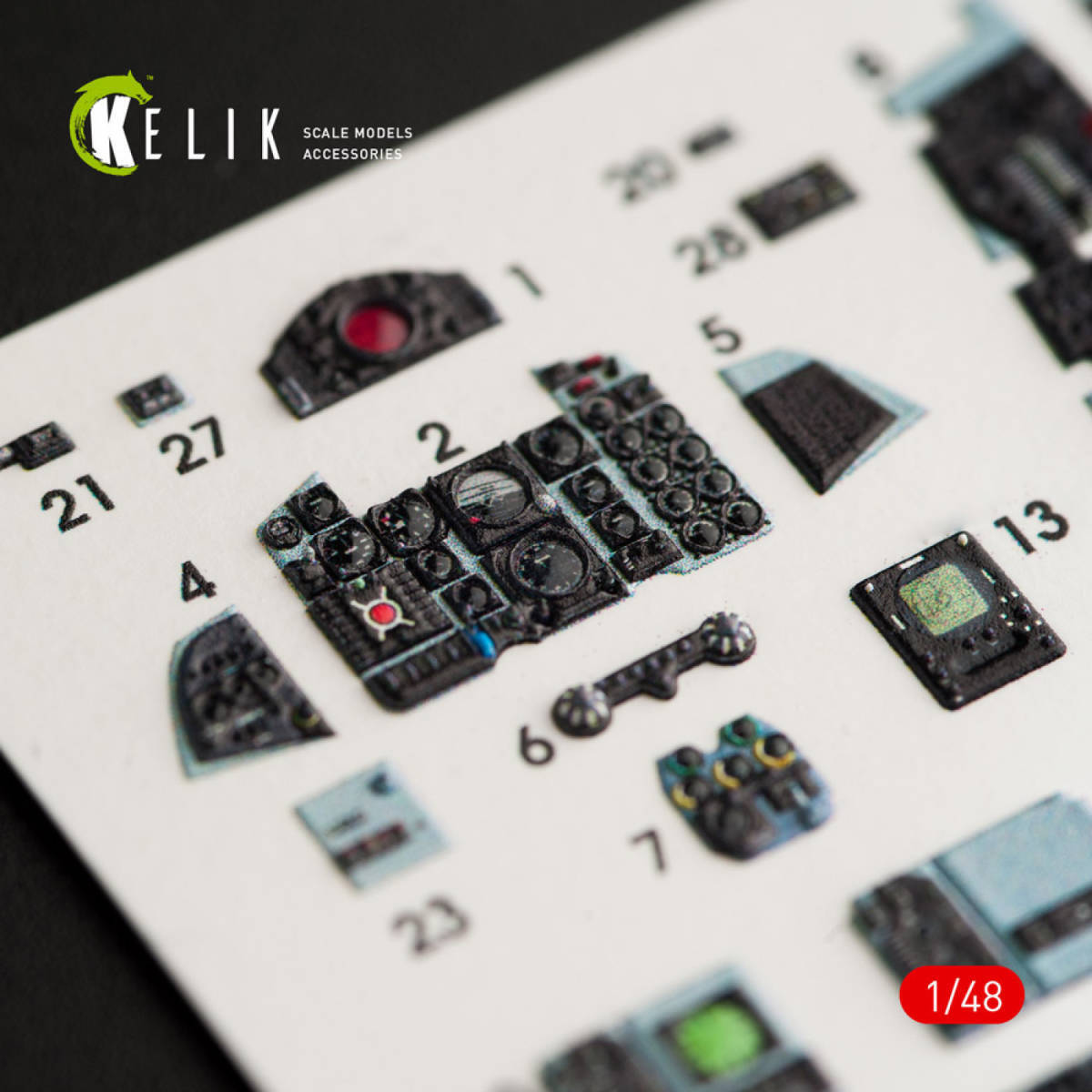

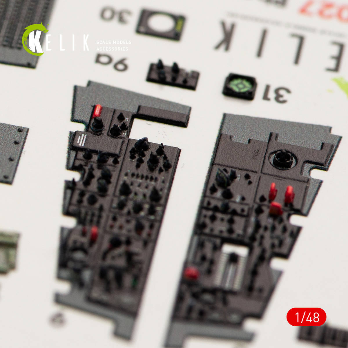

dai phan Posted March 23, 2023 Author Share Posted March 23, 2023 (edited) Howdy, Many companies are joining in the feeding frenzy of the Tamiya's kit. Newest comer is Kelik (Ukraine) 3D set and I ordered it. It seems to have the correct dark gull grey and the details are more raised and defined than Quinta. Will keep you informed. Dai Edited March 23, 2023 by dai phan Quote Link to post Share on other sites
SERNAK Posted March 23, 2023 Share Posted March 23, 2023 All these aftermarket sets are a MUST-HAVE!!! Quote Link to post Share on other sites
crackerjazz Posted March 23, 2023 Share Posted March 23, 2023 Woooow! That looks absolutely cool. Thanks for sharing. Quote Link to post Share on other sites
dai phan Posted March 23, 2023 Author Share Posted March 23, 2023 47 minutes ago, SERNAK said: All these aftermarket sets are a MUST-HAVE!!! Yes gone are the days of PE cockpits. Dai Quote Link to post Share on other sites
dai phan Posted March 23, 2023 Author Share Posted March 23, 2023 41 minutes ago, crackerjazz said: Woooow! That looks absolutely cool. Thanks for sharing. Although the name is Kelik, it is the same as Reskit. Dai Quote Link to post Share on other sites

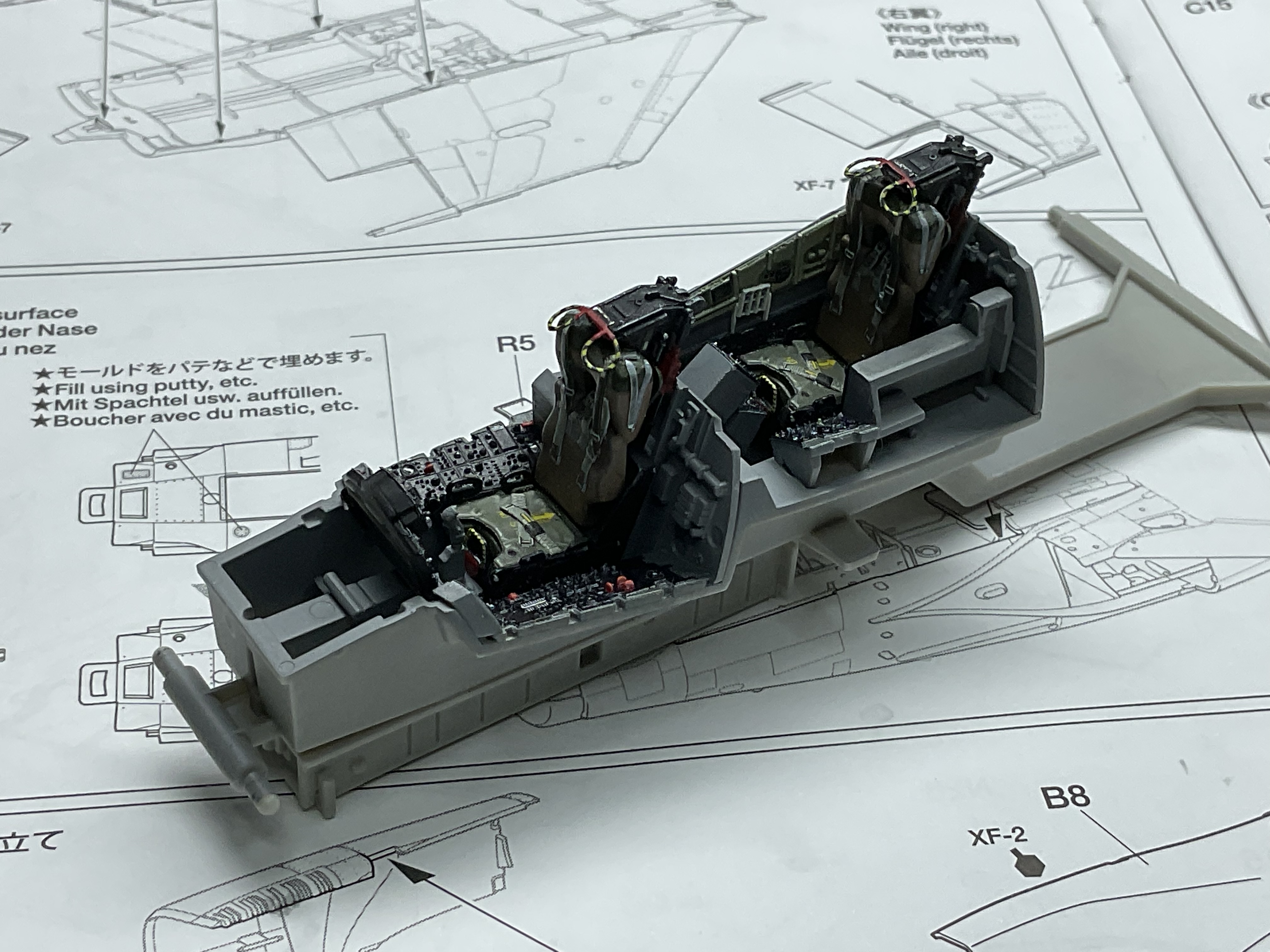

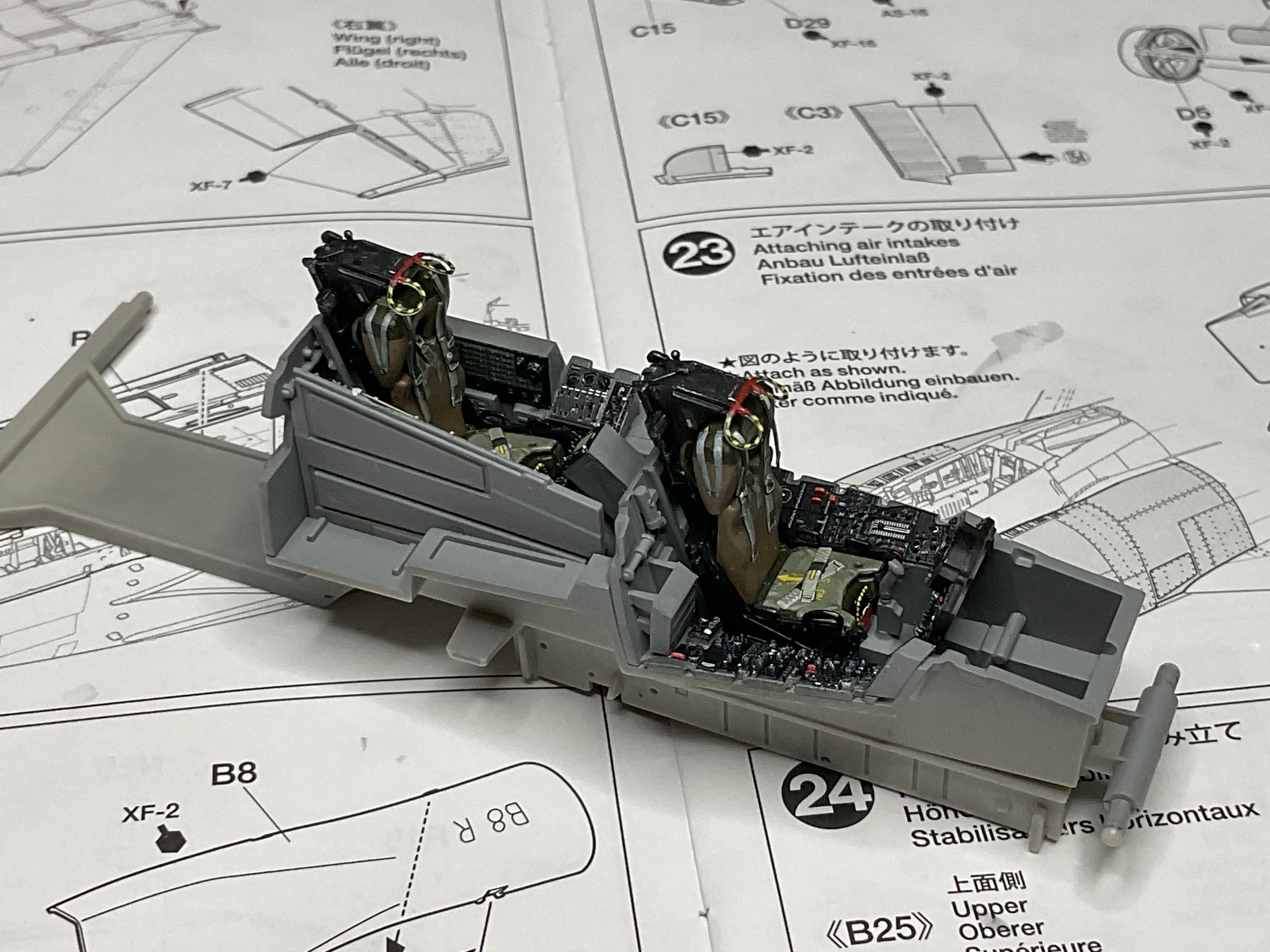

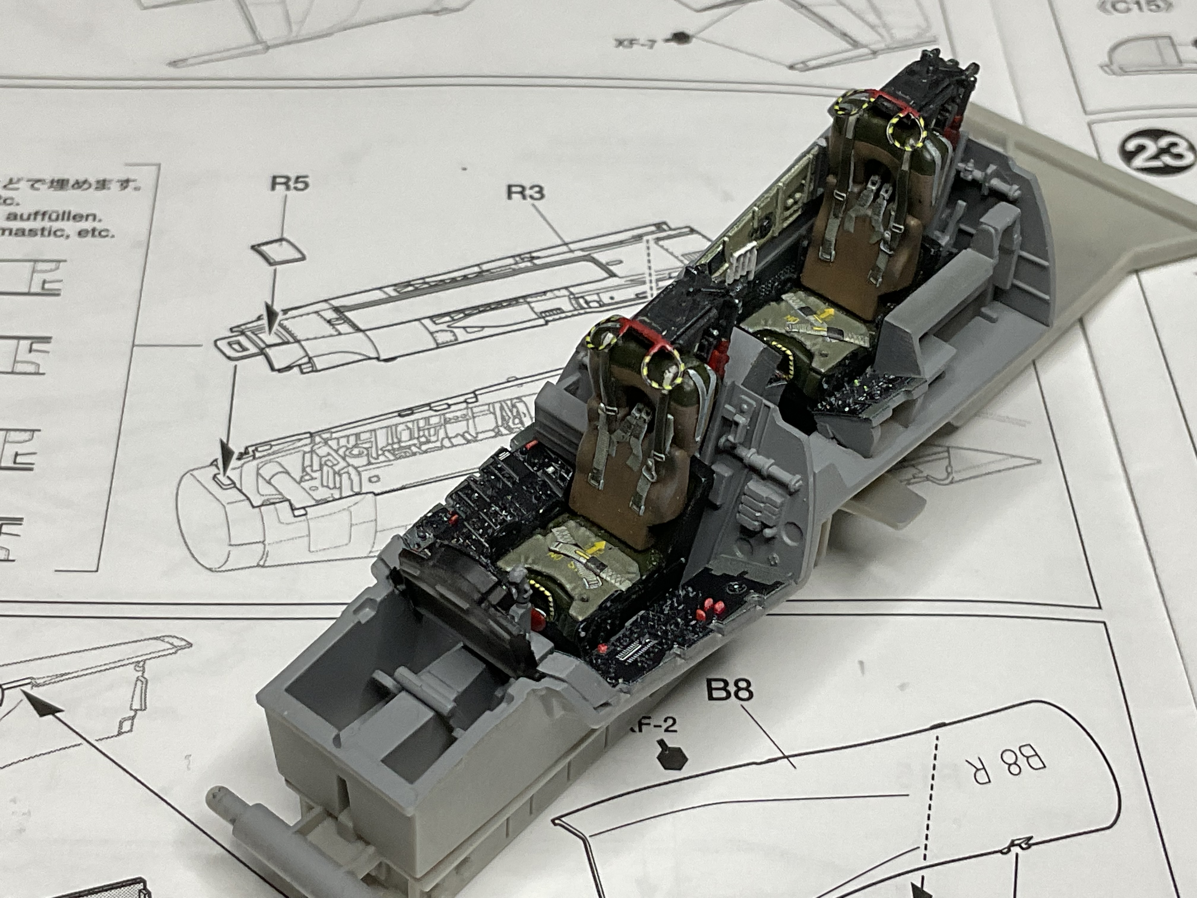

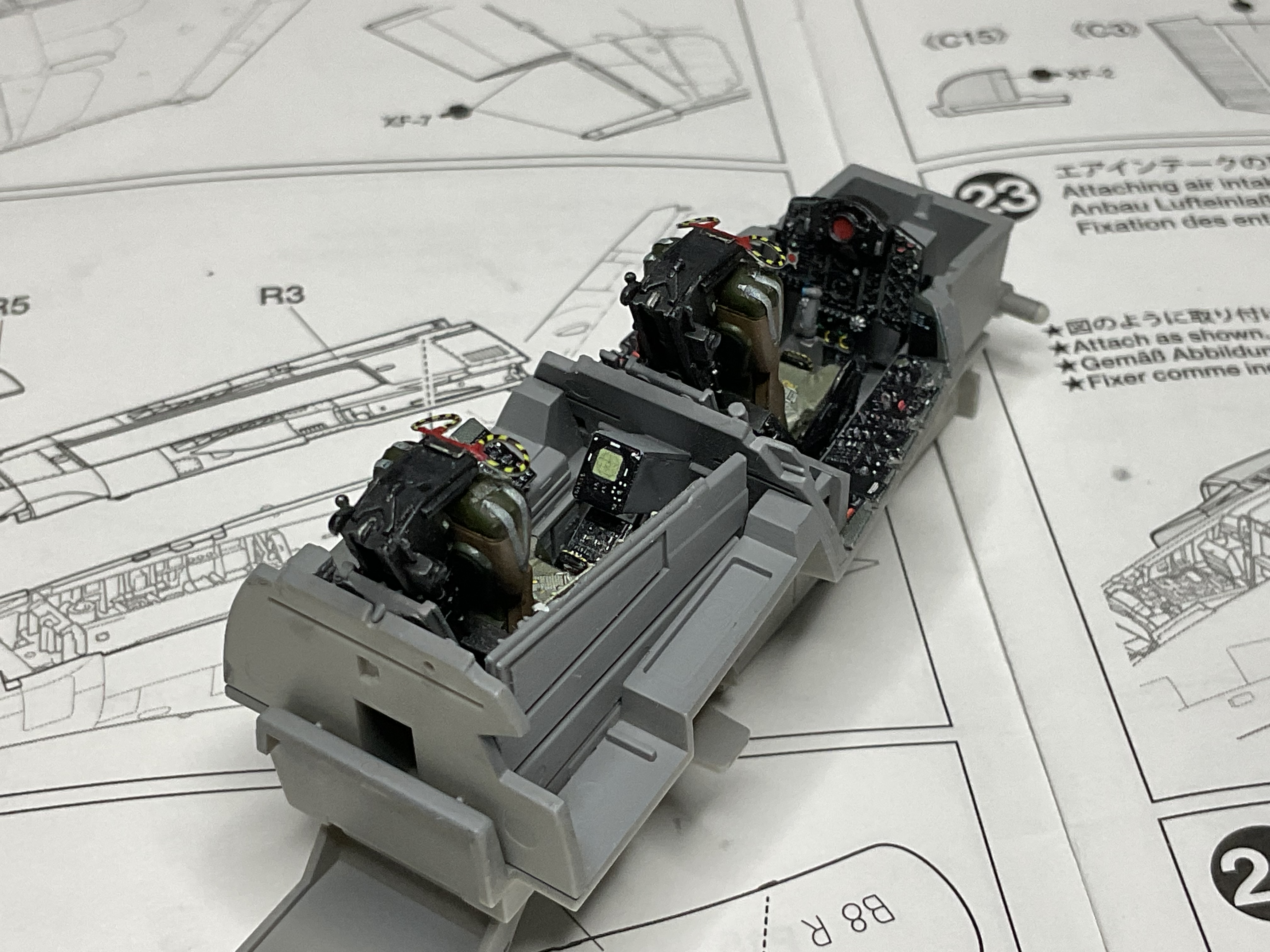

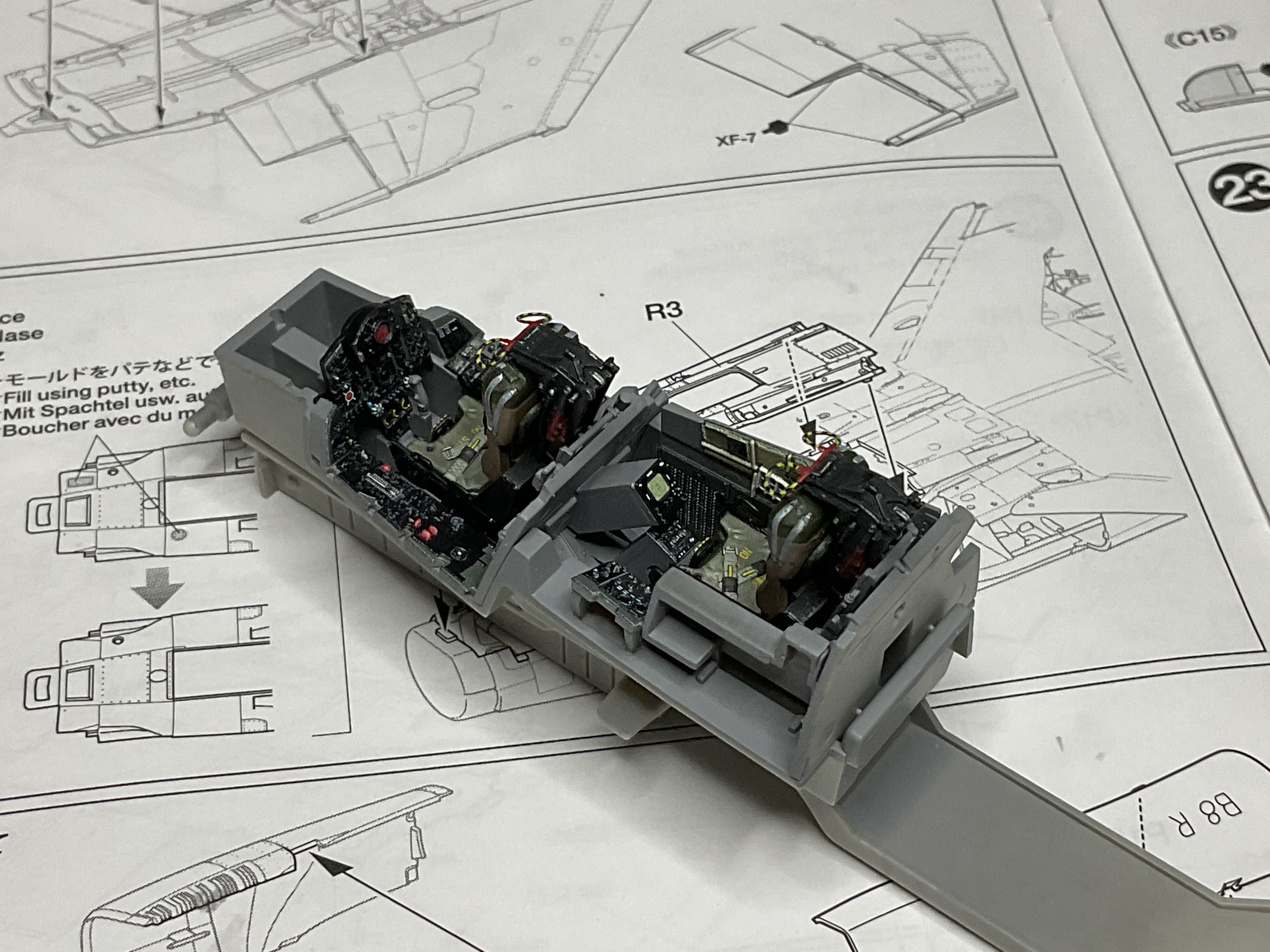

dai phan Posted March 27, 2023 Author Share Posted March 27, 2023 (edited) Hello everyone, The rebuilding of the fuselage has begun. The 3D cockpit set is Kelik (Reskit) and it is very nice except for the weird gray-greenish background that I will have to correct. I do not know why all of these companies get the grey background wrong. The Kelik gives you more panels than Babibi and Quinta. Still have to do some additional painting and wash. I dry fit the bottom piece on the new fuselage and it is a prefect fit. Must have done something to cause much aligment on the previous build. Dai Edited March 27, 2023 by dai phan Quote Link to post Share on other sites

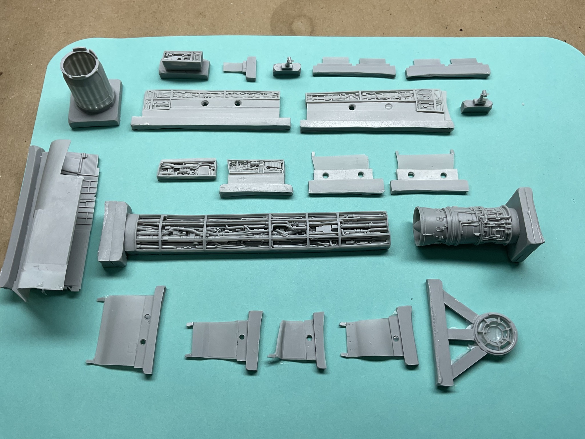

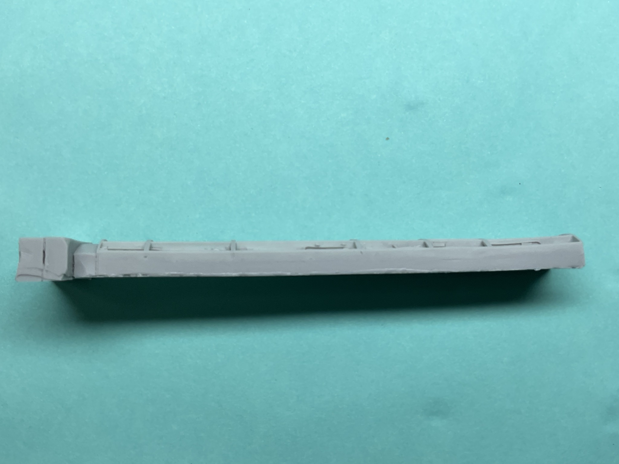

dai phan Posted March 28, 2023 Author Share Posted March 28, 2023 (edited) Greetings to all, I got the Black Dog detail set today. The parts are cast resin rather than 3D printed. The details are sharp but sadly the top spine electronics is warped as you can see on the photo. I plan to use the top spine, the left RAM and the right gun bay but let's see how the small gun bay fits first before going any further. The engine is nice but beyond my ability to stratch build the holding bay. Dai Edited March 28, 2023 by dai phan Quote Link to post Share on other sites

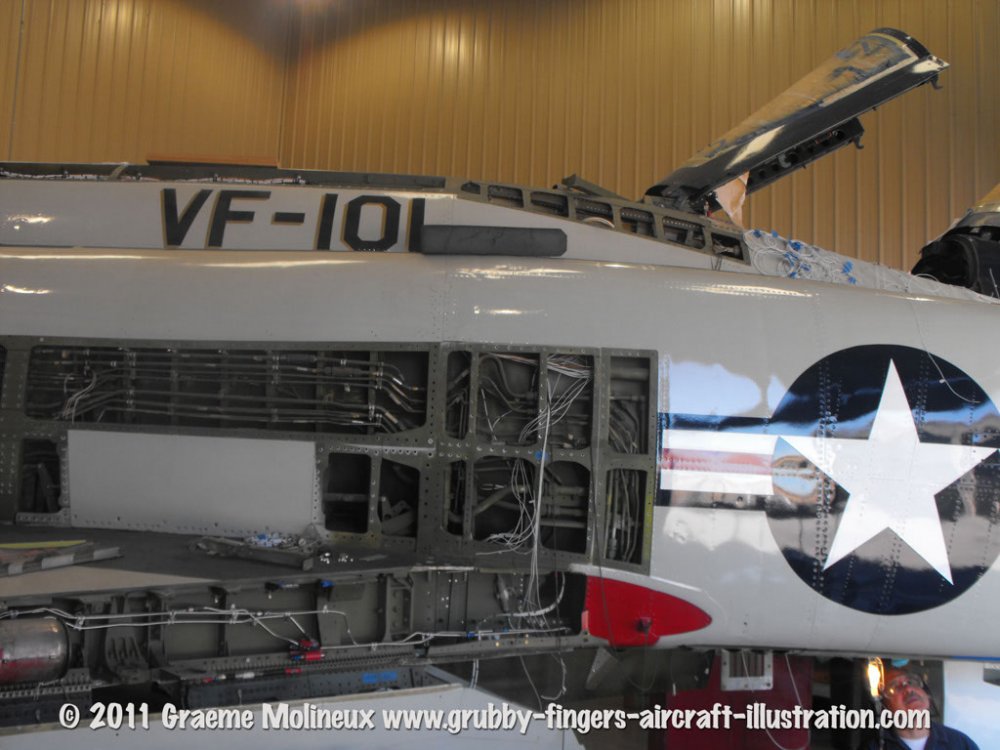

dai phan Posted March 29, 2023 Author Share Posted March 29, 2023 Hello all, Looks like I will have to remove the warped part if I cannot straighten via heat application. I am not going to use all resin parts because I do not want my plane to look like a skeleton. I have yet to see an actual photo of the Phantom with its internal structure showing so can someone comment on the colors of the pluming? Silver I assume ? Dai Quote Link to post Share on other sites

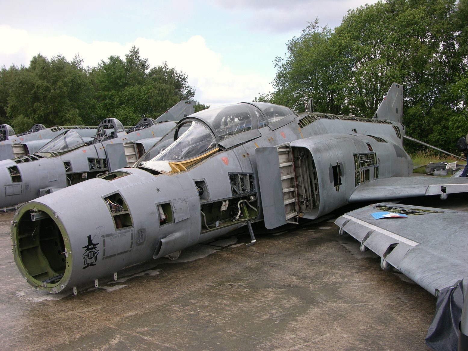

dai phan Posted March 29, 2023 Author Share Posted March 29, 2023 (edited) I found this photo on the Net. Looks like green zinc chromate with silver plumbings. Dai Edited March 29, 2023 by dai phan Quote Link to post Share on other sites

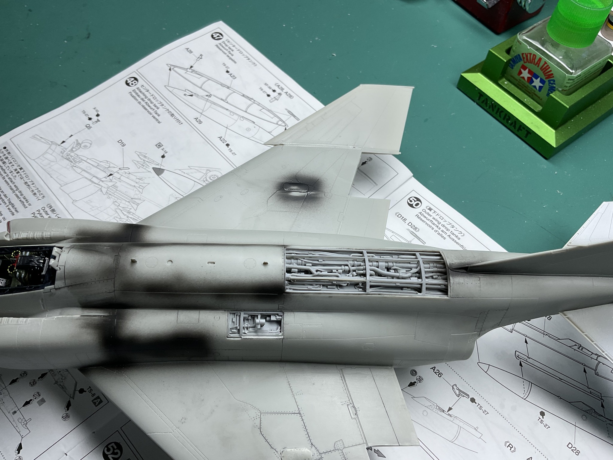

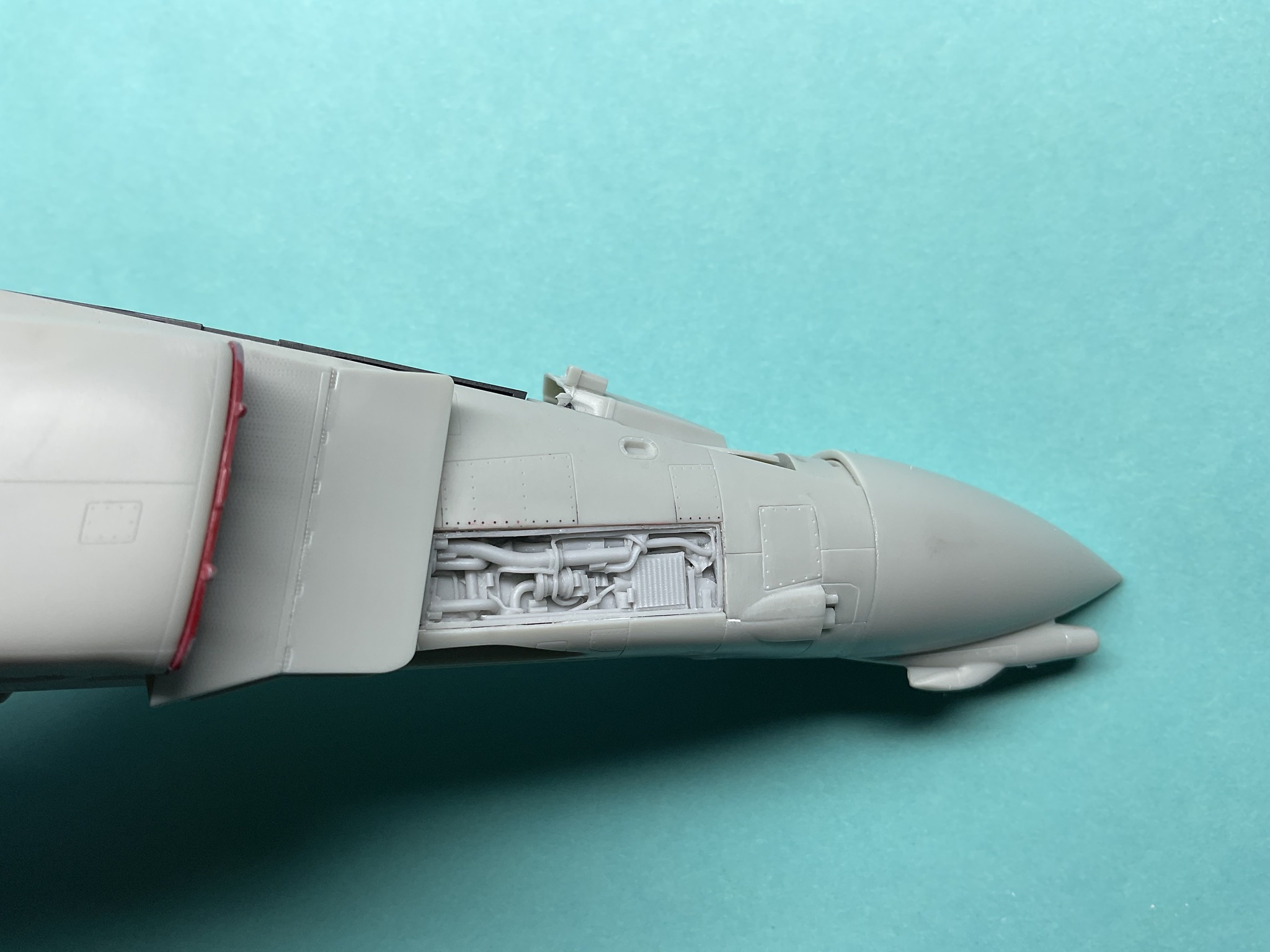

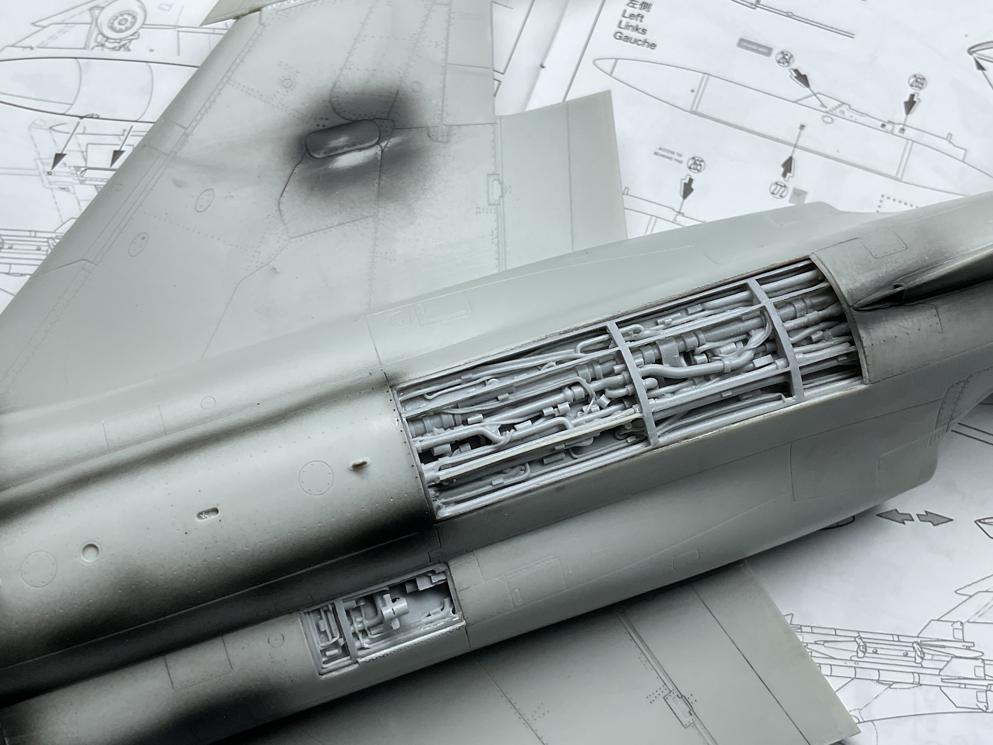

dai phan Posted April 2, 2023 Author Share Posted April 2, 2023 (edited) Hello friends, Started working on the Black Dog set. I use the top compartment, the left RAT compartment and the right gun bay. The RAT bay and the gun compartment fit well but there are lots of dry fitting and careful sanding to avoid gaps. I had to apply a little bit of putty as you see on the RAT bay. The propeller of the RAT is too thick and I wish BD would provide PE for this part. The top resin part is warped so I could only use 1/2 of the bay. I cut the kit's panel to where the panel line is. Unfortunately the bulk heads of the resin parts do not correspond to the rear and the front panel lines. I opt to favor the front most bulkhead as it is more readily seen compared to the rear. When you glue the resin parts, make sure the edges of the resin and the kit are NOT flushed with each other. Remember a panel will go over on top of the resin so there must a slight step to account for the thickness of the panel. Dai Edited April 24, 2023 by dai phan Quote Link to post Share on other sites
Geoff M Posted April 2, 2023 Share Posted April 2, 2023 Masterful job getting those parts in the fuselage. Looks like they were made that way. Quote Link to post Share on other sites
JEN722 Posted April 3, 2023 Share Posted April 3, 2023 Why is it that you add the radome before the windscreen? You seem to have done so on both your F-4Bs. Jens Quote Link to post Share on other sites
dai phan Posted April 3, 2023 Author Share Posted April 3, 2023 1 hour ago, JEN722 said: Why is it that you add the radome before the windscreen? You seem to have done so on both your F-4Bs. Jens At step 33, the instruction indicated the radome be attached to the fuselage. Am I wrong ? Thanks Dai Quote Link to post Share on other sites
Nathant Posted April 3, 2023 Share Posted April 3, 2023 2 hours ago, JEN722 said: Why is it that you add the radome before the windscreen? You seem to have done so on both your F-4Bs. Jens I have the same kit and don’t see how that matters? Quote Link to post Share on other sites
dai phan Posted April 3, 2023 Author Share Posted April 3, 2023 (edited) Hello all, Photos of the Phantom with panels removed are extremely rare. I will post them here as I find them. Therefore there is not much to go by rather than basic green zinc chromate and silver hoses. Dai Edited April 3, 2023 by dai phan Quote Link to post Share on other sites
