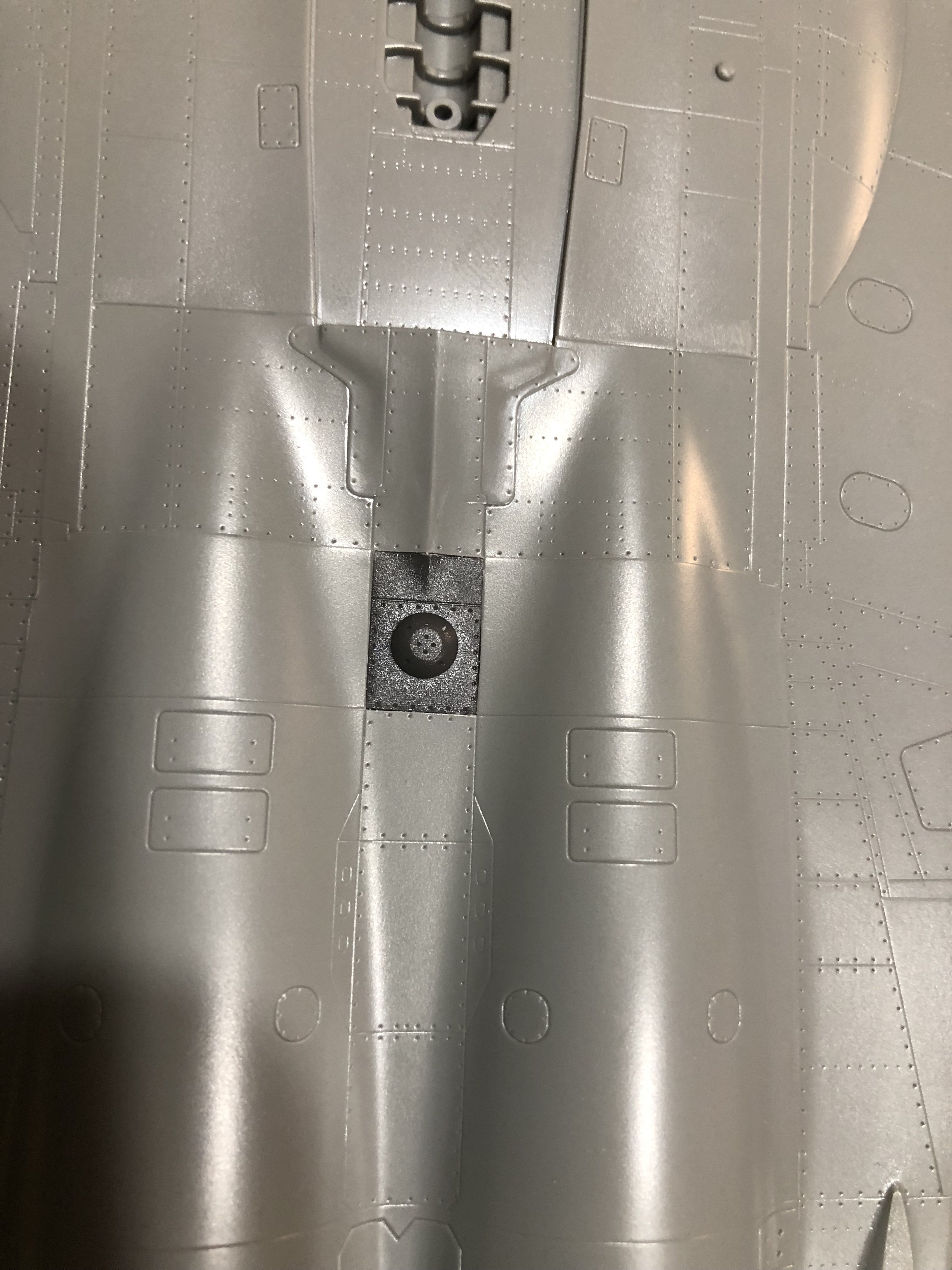

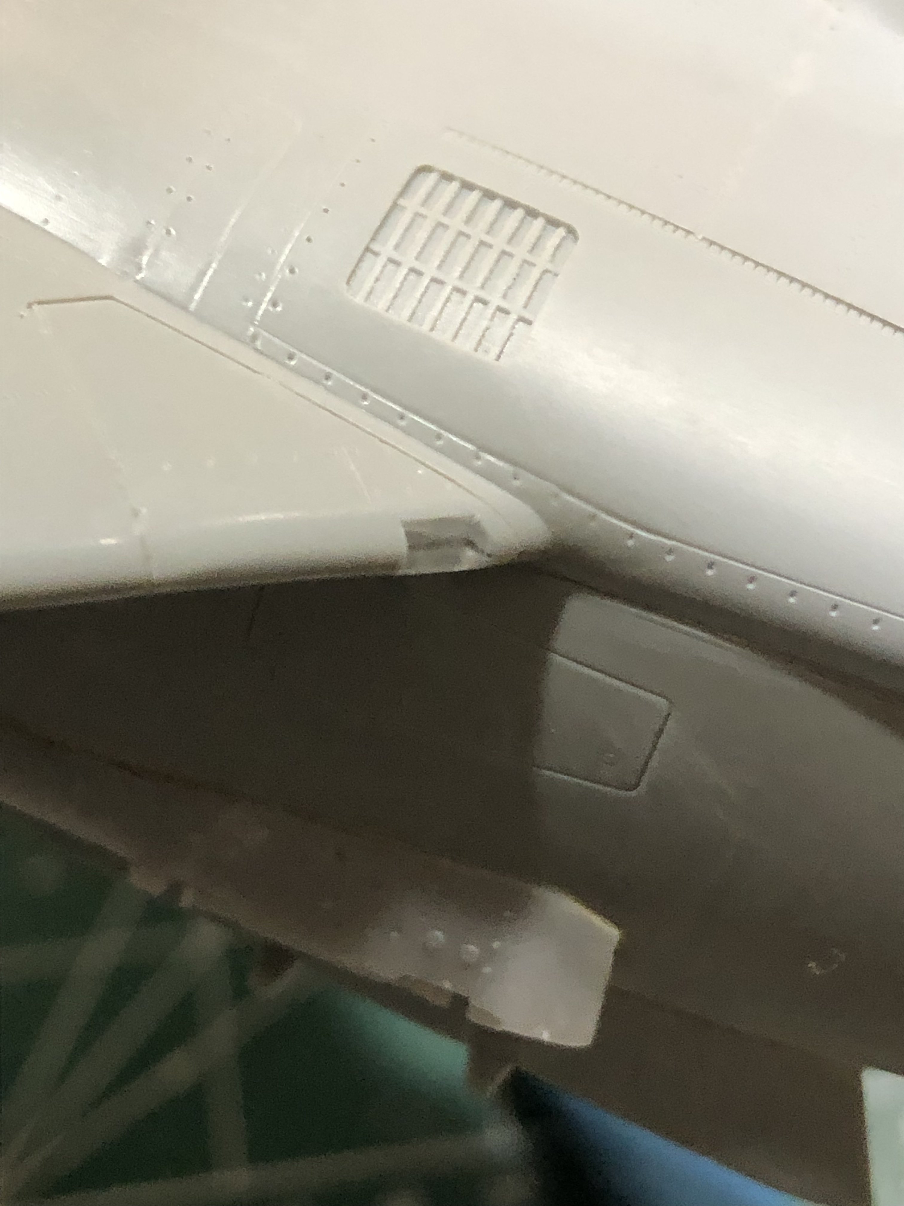

ORANGF15Guy Posted August 3, 2021 Author Share Posted August 3, 2021 Started to test fit some of the BAM Models parts. First observations…..parts are excellent quality and they fit very well. First thing I did was install the new GPS antenna just aft of the air break. Quote Link to post Share on other sites

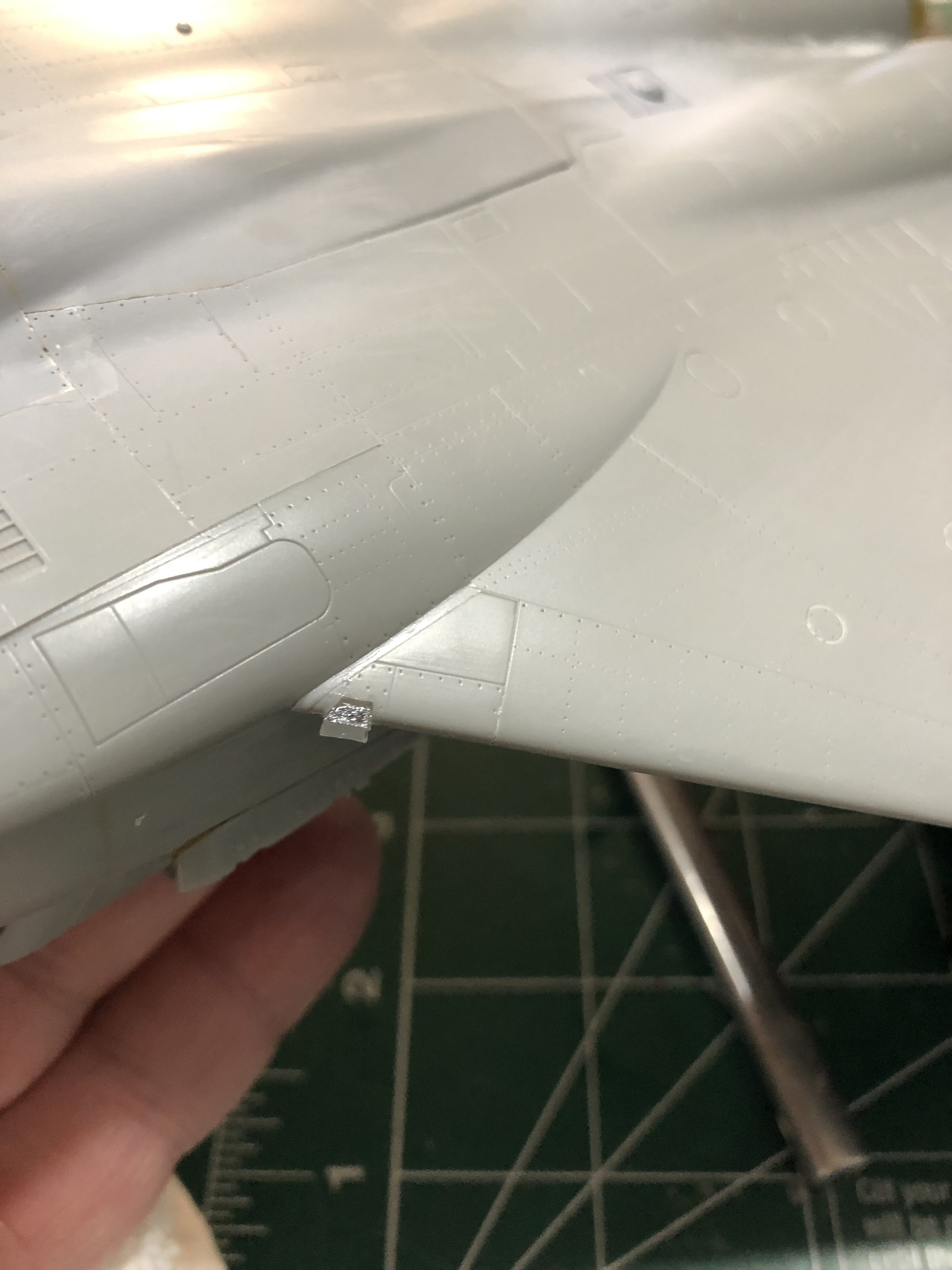

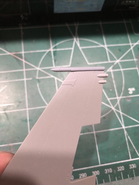

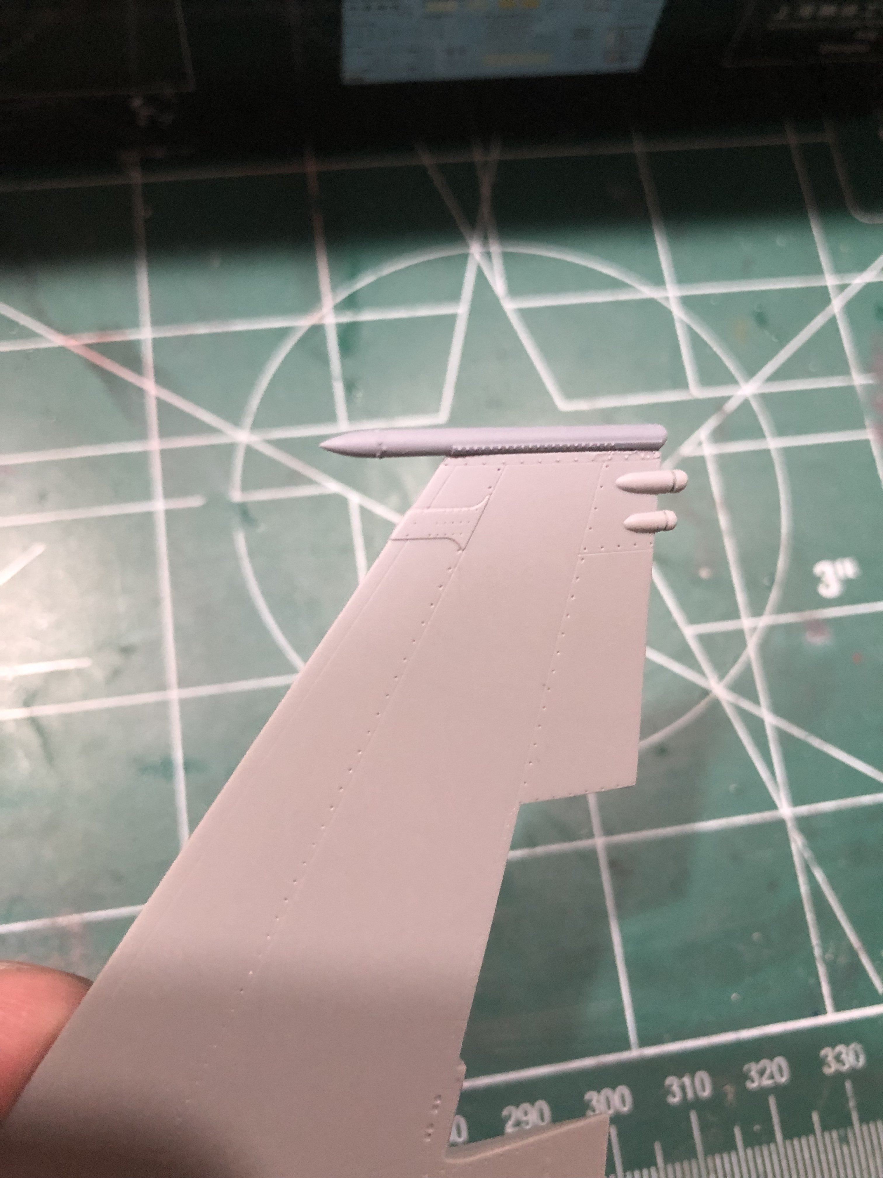

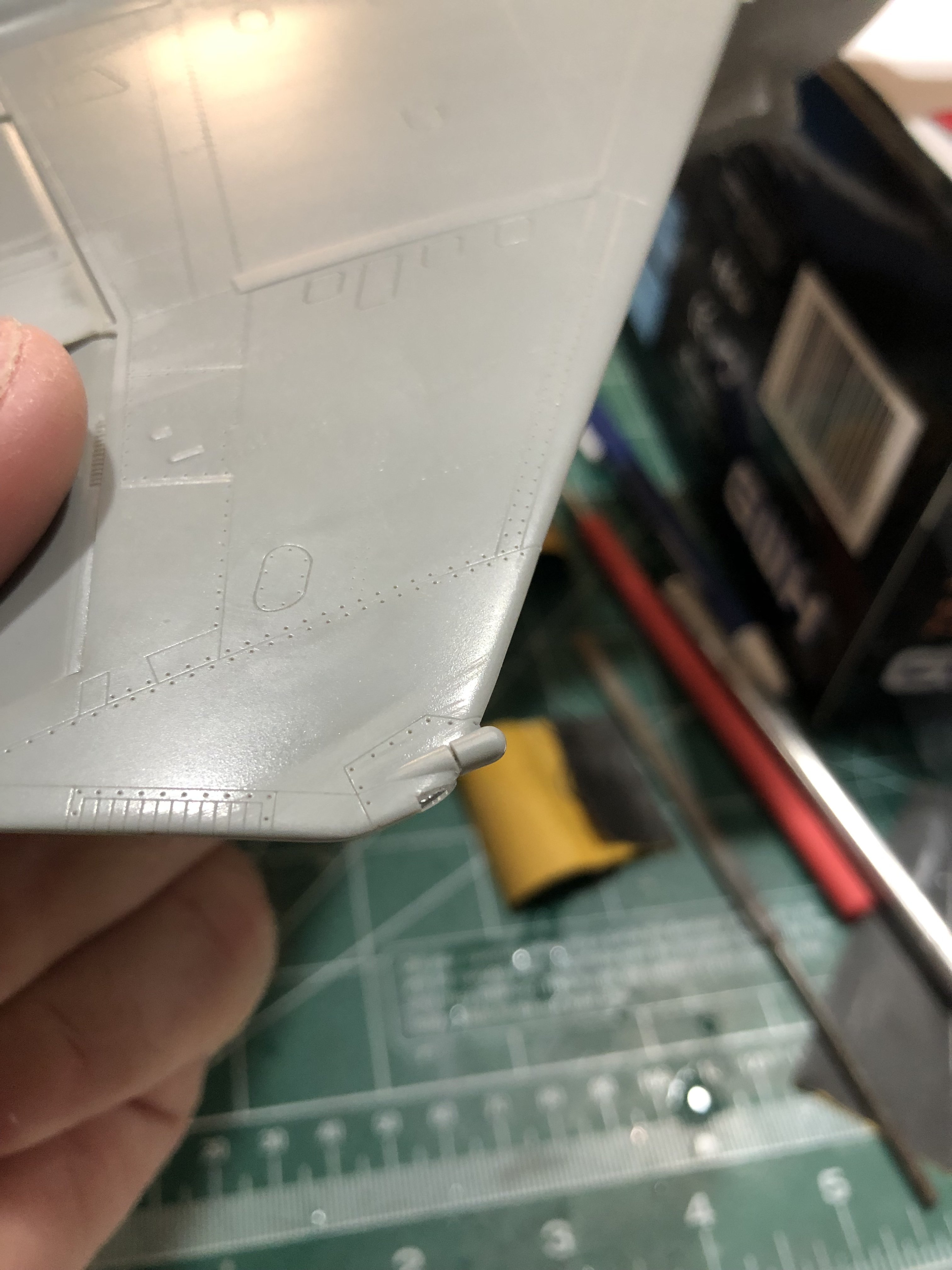

ORANGF15Guy Posted August 3, 2021 Author Share Posted August 3, 2021 (edited) After the GPS was done I installed the JSF and the vertical stab antennas/counter weights? Not sure what they are, but they fit very well! One think to be careful of on the BAM Models parts…..they are 3D printed and the resin is very brittle! But if you take your time and go slowly removing the parts from the printing blocks should be OK! Edited August 3, 2021 by ORANGF15Guy Quote Link to post Share on other sites

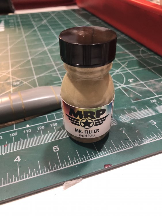

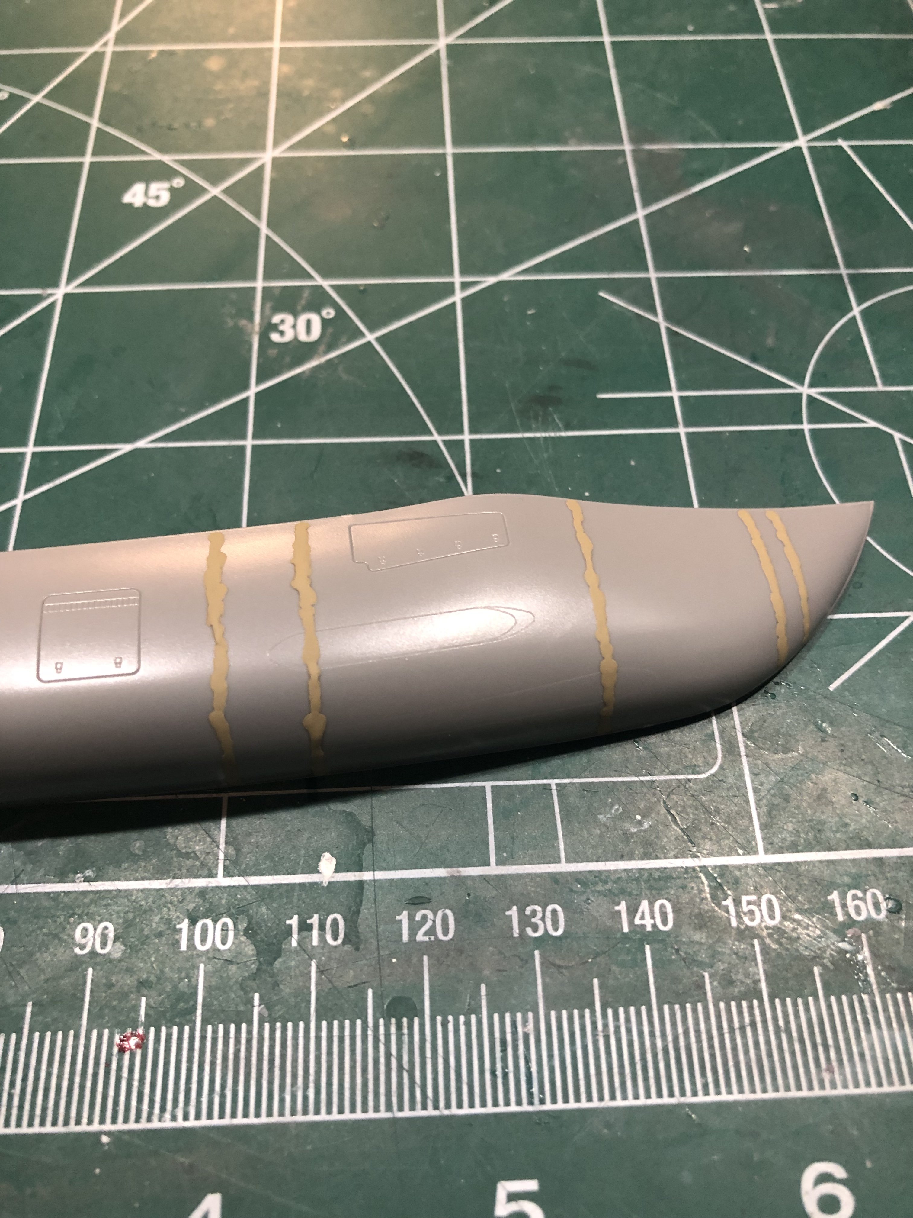

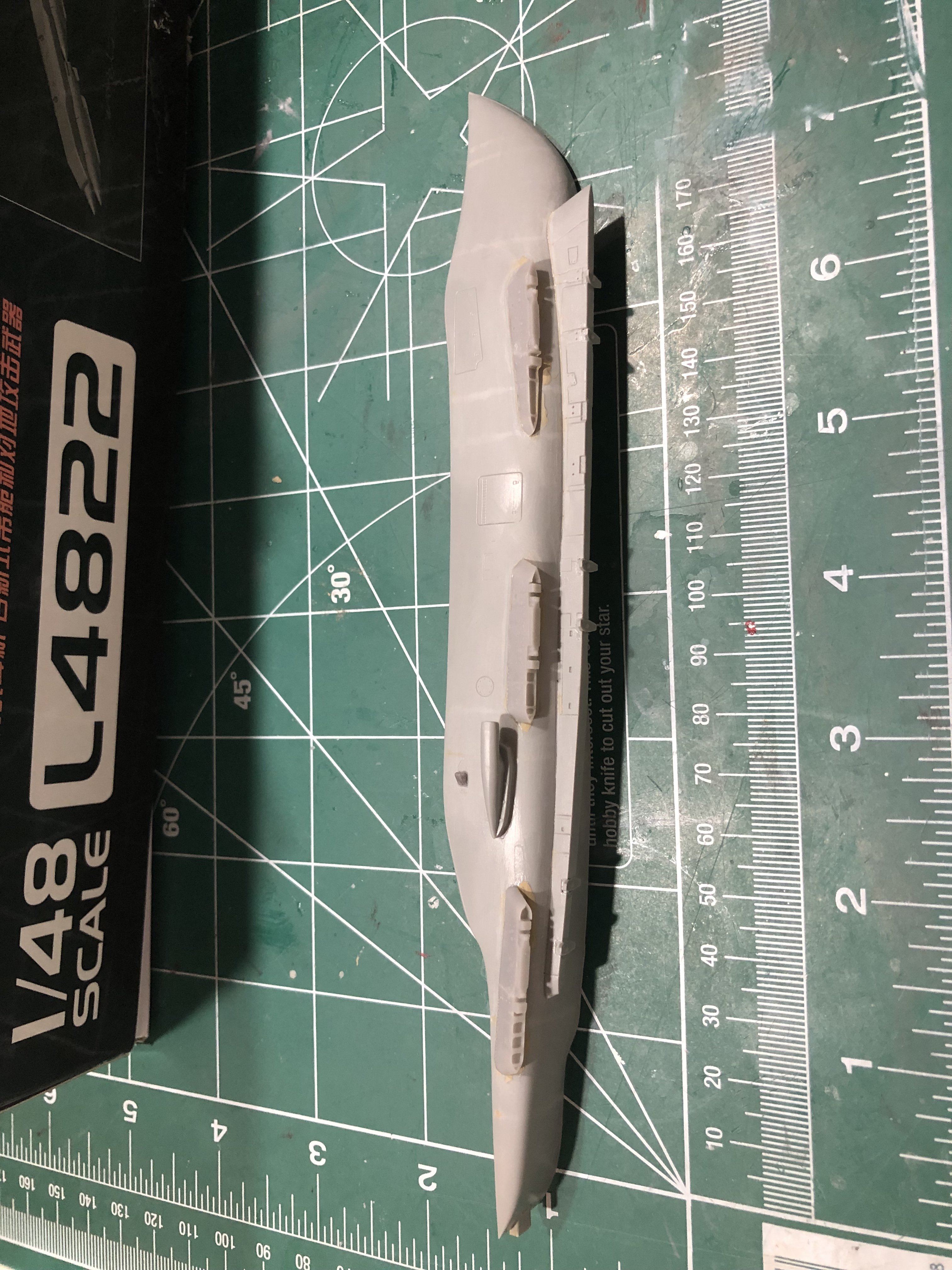

ORANGF15Guy Posted August 7, 2021 Author Share Posted August 7, 2021 On 8/2/2021 at 5:54 PM, ORANGF15Guy said: After the GPS was done I installed the JSF and the vertical stab antennas/counter weights? Not sure what they are, but they fit very well! One think to be careful of on the BAM Models parts…..they are 3D printed and the resin is very brittle! But if you take your time and go slowly removing the parts from the printing blocks should be OK! Started working on the CFT’s. First thing was to loose the recessed panel lines. Used MRP liquid putty, absolutely love this stuff for small jobs. Then added the BAM Models pylons and finished with the stock GWH pylons and other parts! I’ll add some pictures after I get it primed! That’s it for now! Quote Link to post Share on other sites

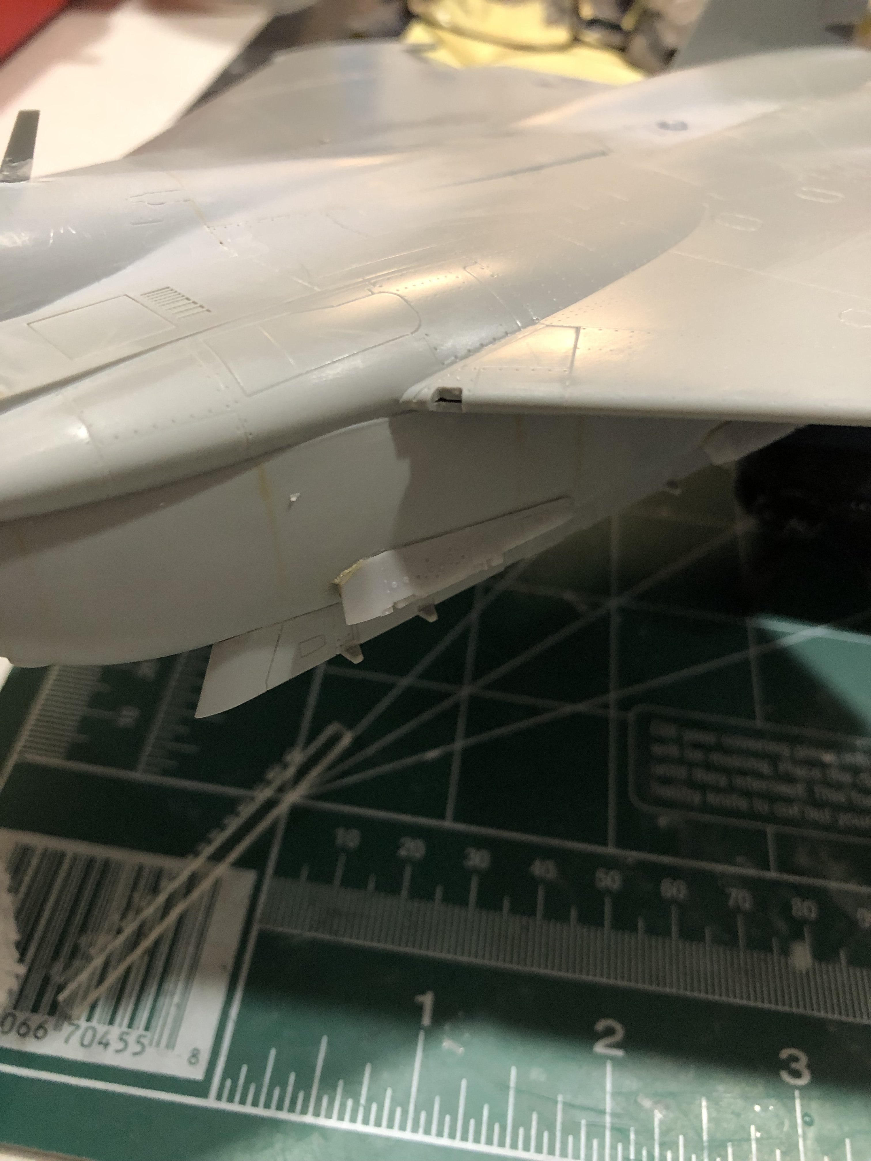

ORANGF15Guy Posted August 7, 2021 Author Share Posted August 7, 2021 58 minutes ago, ORANGF15Guy said: Started working on the CFT’s. First thing was to loose the recessed panel lines. Used MRP liquid putty, absolutely love this stuff for small jobs. Then added the BAM Models pylons and finished with the stock GWH pylons and other parts! I’ll add some pictures after I get it primed! That’s it for now! And here is the first pylon, still have a little sanding to do on the backside of the 3D pylons and then I’ll prime it and start on the other side! Quote Link to post Share on other sites

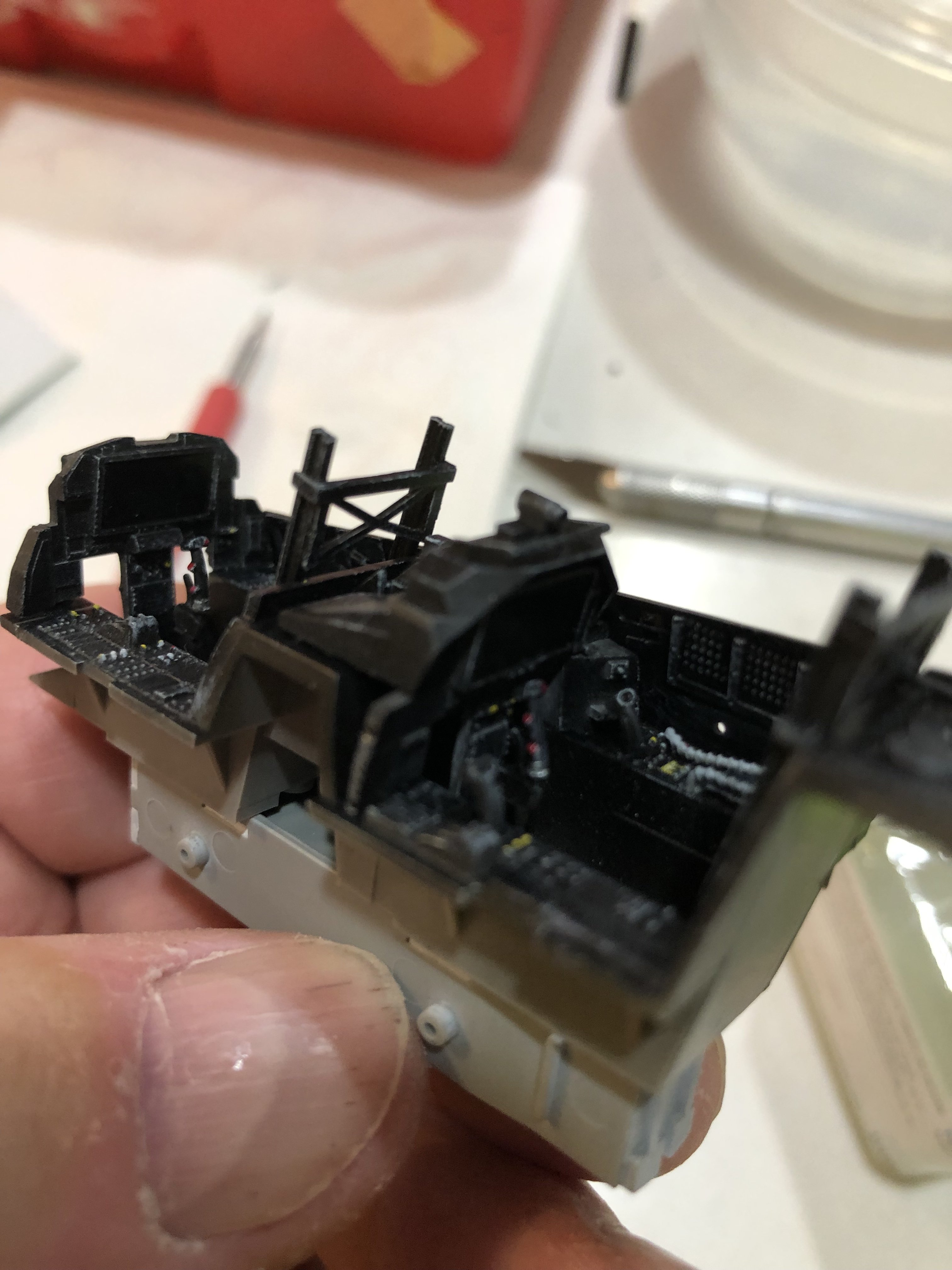

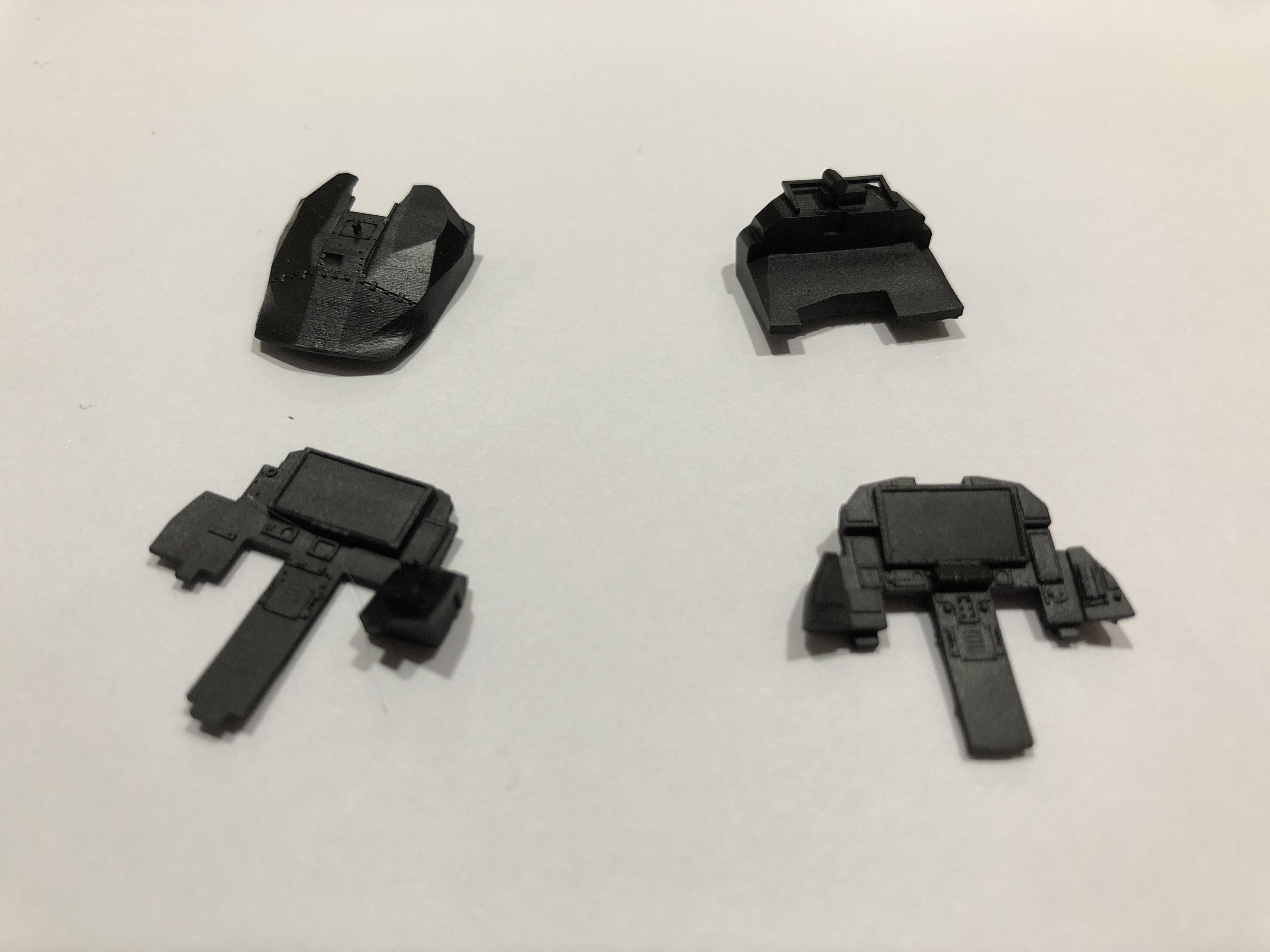

ORANGF15Guy Posted August 15, 2021 Author Share Posted August 15, 2021 (edited) Got a little work on the cockpit done. The pictures that I’ve seen of the real thing show it’s all black……I assume for NVG compatibility, so that’s what I did. The BAM IP’s and IP comings are excellent and the fit is really good. I should have the dry brushing and detailing done on it this week some time and I will post photos as soon as I do! Edited August 16, 2021 by ORANGF15Guy Quote Link to post Share on other sites

arnobiz Posted September 3, 2021 Share Posted September 3, 2021 Awesome to watch the first WIP of an EX! Thanks for the tip on MRP microfiller, I did not know about it and it looks excellent (I absolutely love their paints). Does the nail varnish remover/cotton bud technique work on it or only sanding? Arnaud Quote Link to post Share on other sites
ORANGF15Guy Posted September 4, 2021 Author Share Posted September 4, 2021 (edited) 21 hours ago, arnobiz said: Awesome to watch the first WIP of an EX! Thanks for the tip on MRP microfiller, I did not know about it and it looks excellent (I absolutely love their paints). Does the nail varnish remover/cotton bud technique work on it or only sanding? Arnaud Hi Arnaud, I haven’t tried the nail polish remover trick with the MRP filler, just sanded, but it works really well! I have been working on the tail booms and almost have them done and primed! I’ll try to post some pictures of the booms and the pit this weekend! Edited September 4, 2021 by ORANGF15Guy Quote Link to post Share on other sites

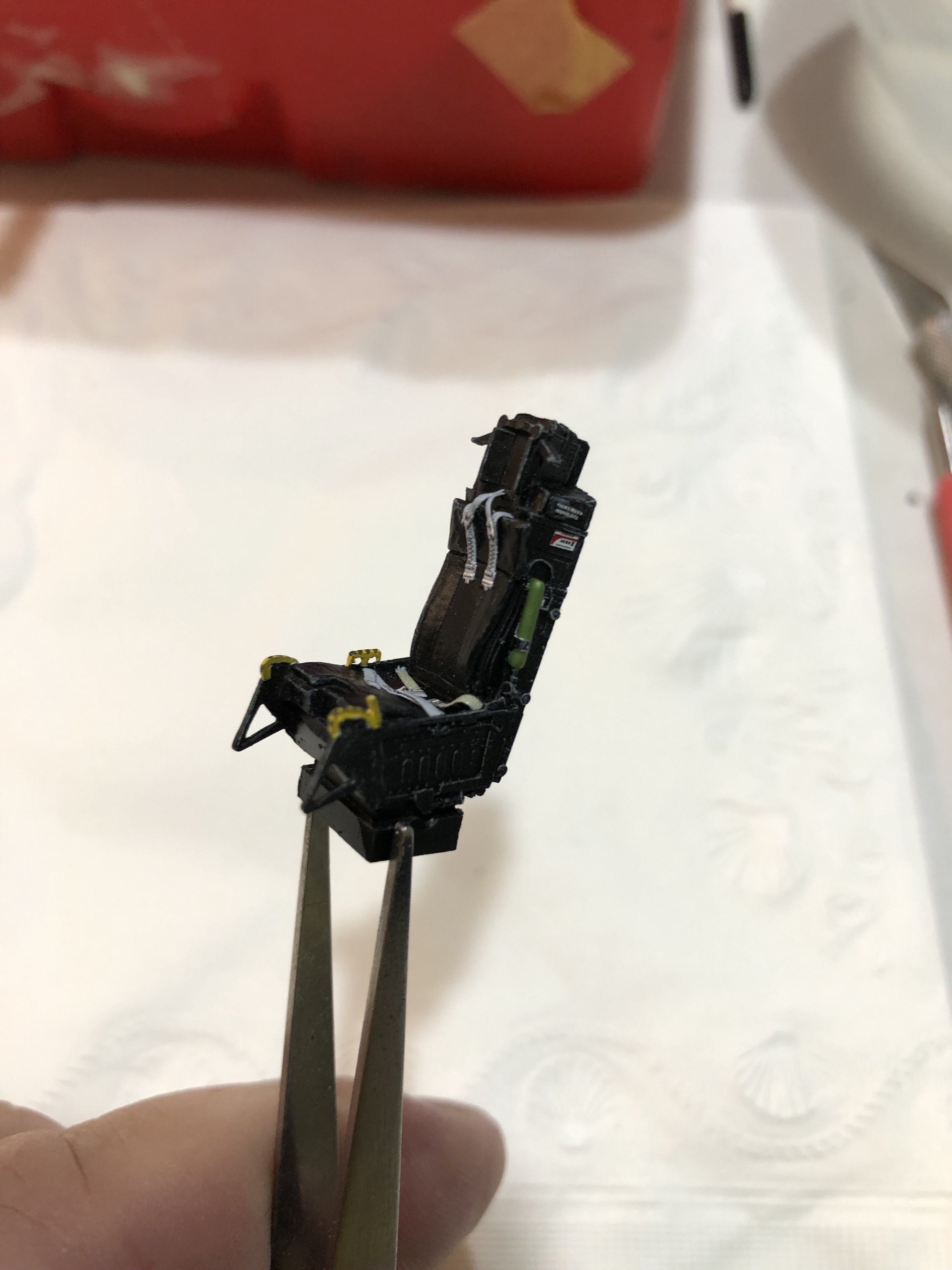

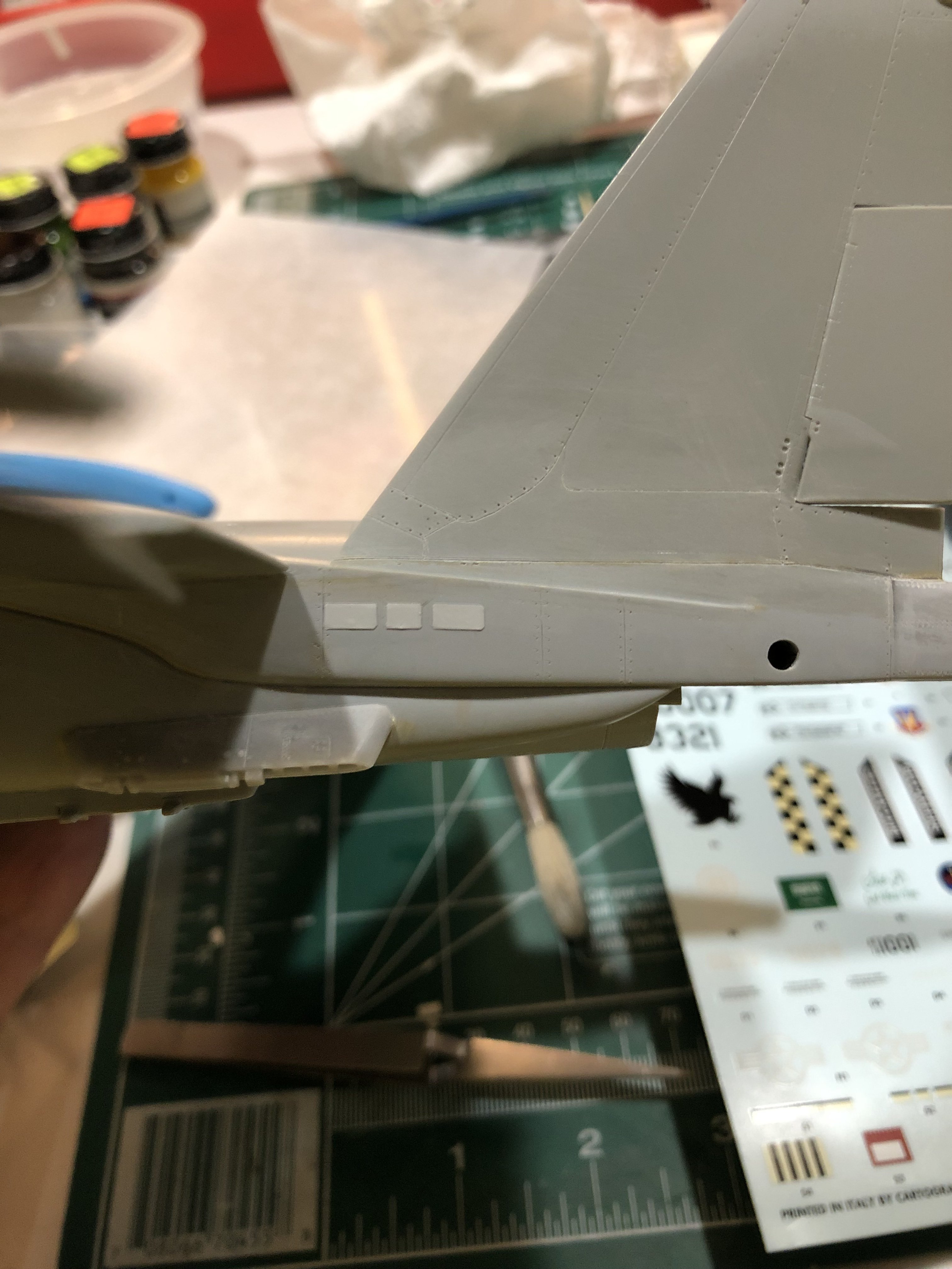

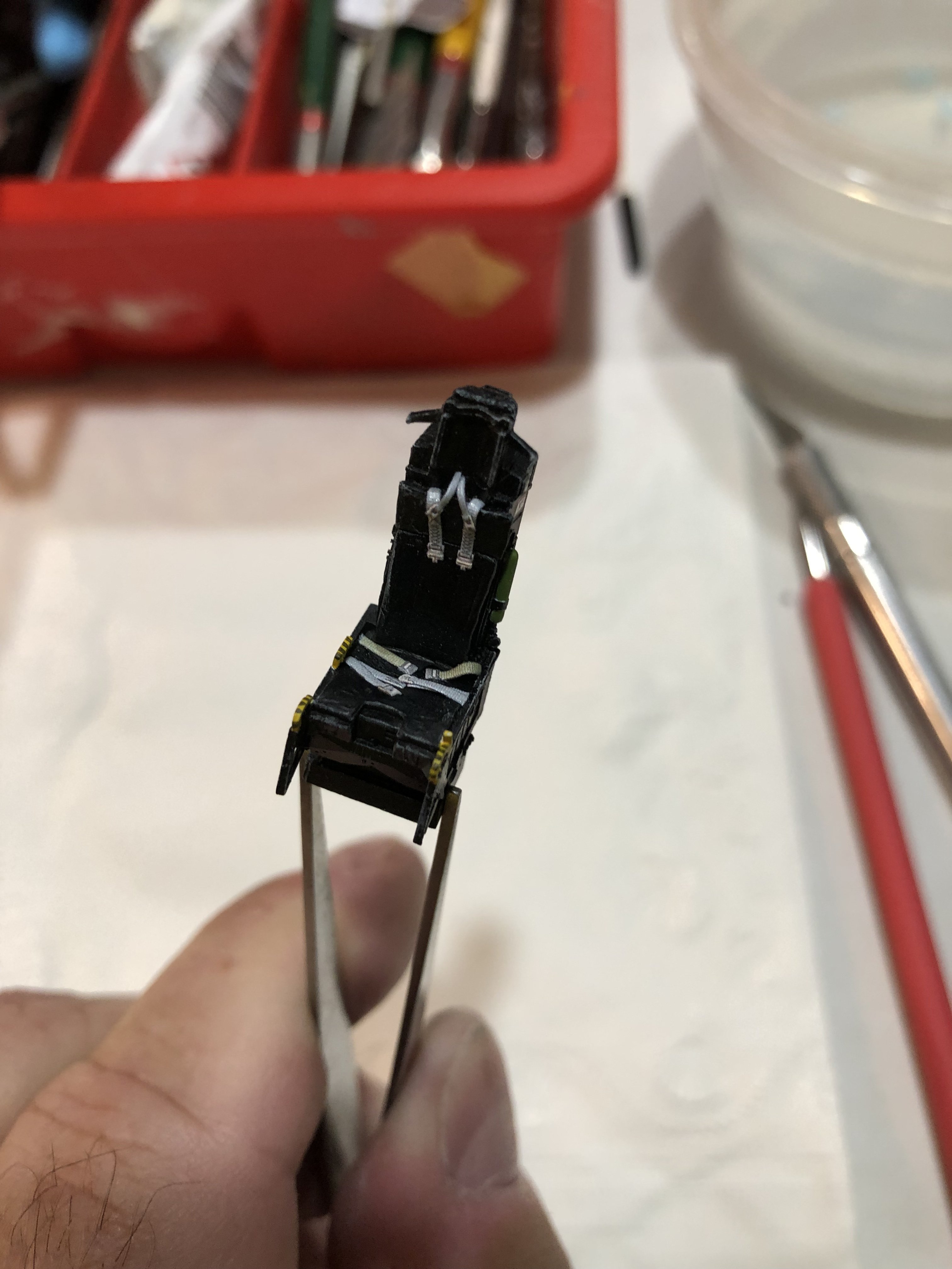

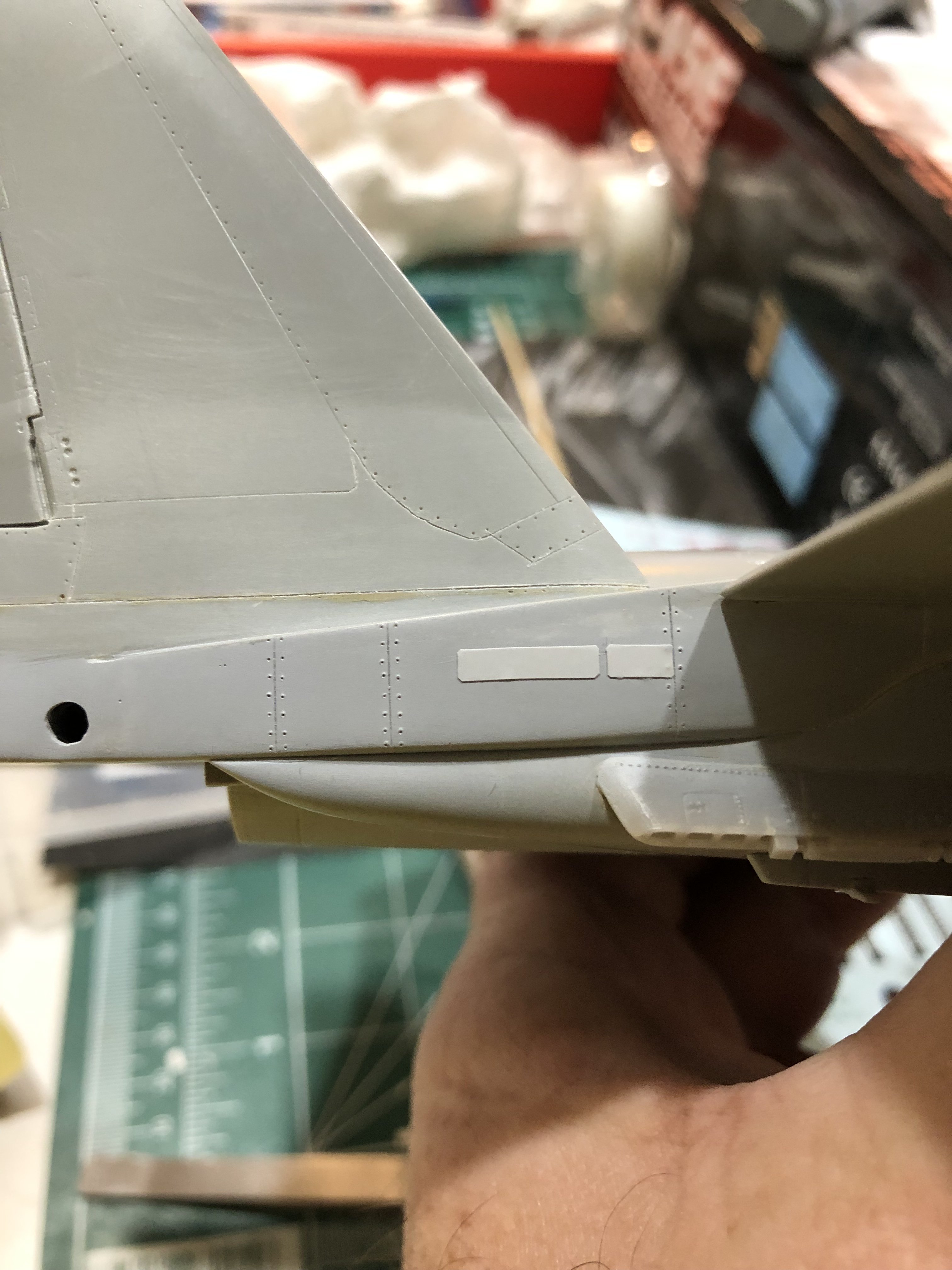

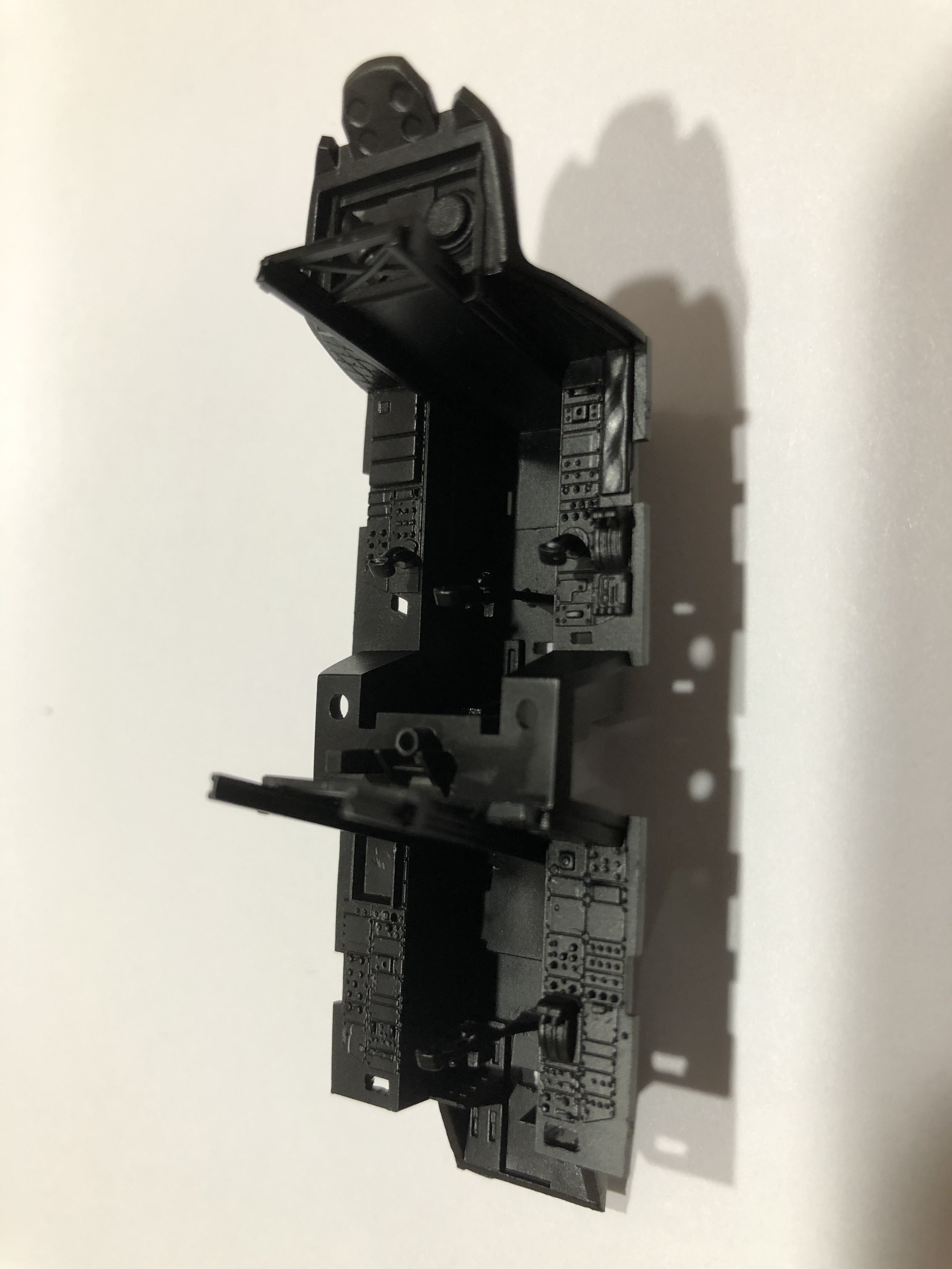

ORANGF15Guy Posted September 12, 2021 Author Share Posted September 12, 2021 (edited) On 9/5/2021 at 12:06 AM, arnobiz said: Brilliant, I look forward to seeing pictures 😋 Some progress made on the EX! The pit is in and finally close up! I decided to use a pair of Aries resin seats to replace the kit seats, because the GWH seats are, in my opinion are over sized. Because the Aries seats don’t have belts, I chose to use 3D printed belts from a Quinta set for the F-15, that way I was able to make sure that the belt placements were not the same front to back. One other thing I tackled were the rear slime light placement. On the EX they are different than the E. I used automotive tape for the frames after measuring the lights that are in the Caracal EX decal set. EDIT: made a mistake on the ACES II ejection seats. I modeled them with the pitots in a fixed position, and after some research, the EX jets use the newer folding pitots, so those have been removed! Edited September 19, 2021 by ORANGF15Guy Quote Link to post Share on other sites

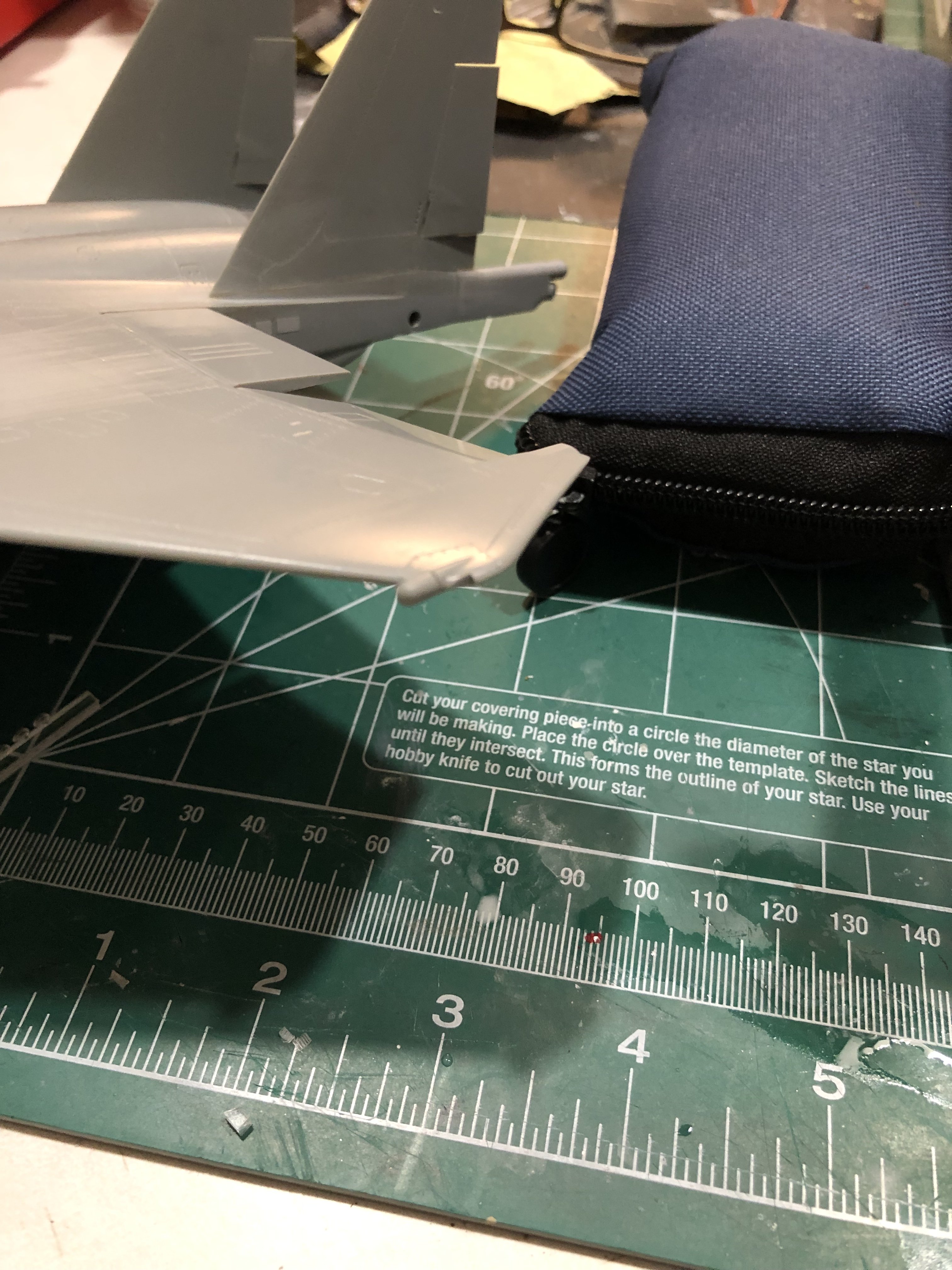

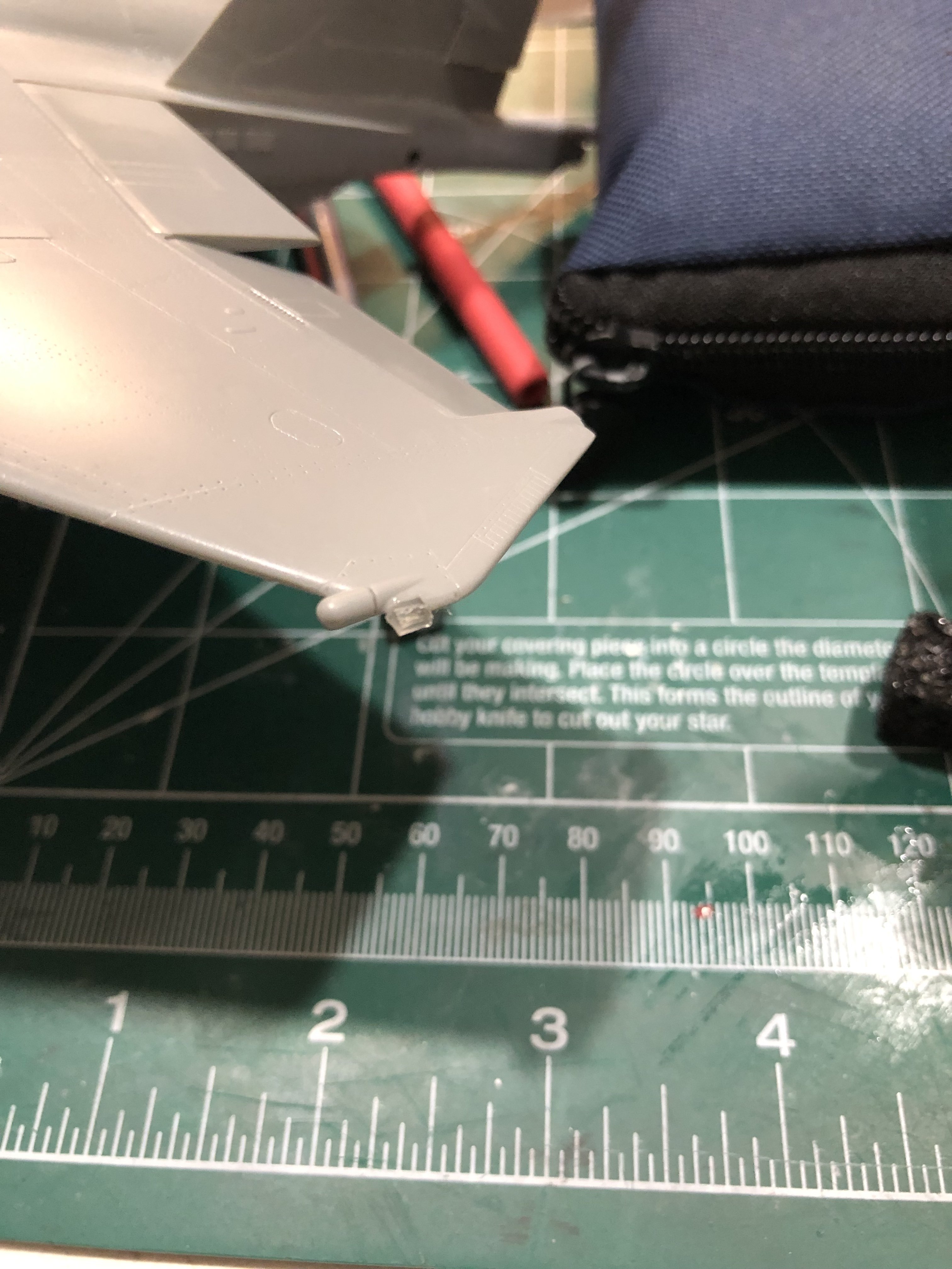

ORANGF15Guy Posted September 19, 2021 Author Share Posted September 19, 2021 (edited) The position lights on the leading edge on the wings and on the wing tips are clear, and not the usual red and green on the EX. So I cut away the plastic and used clear resin plugs to start to form the lights. After I got them sanded to fit, I’ll do some polishing! Edited October 2, 2021 by ORANGF15Guy Quote Link to post Share on other sites

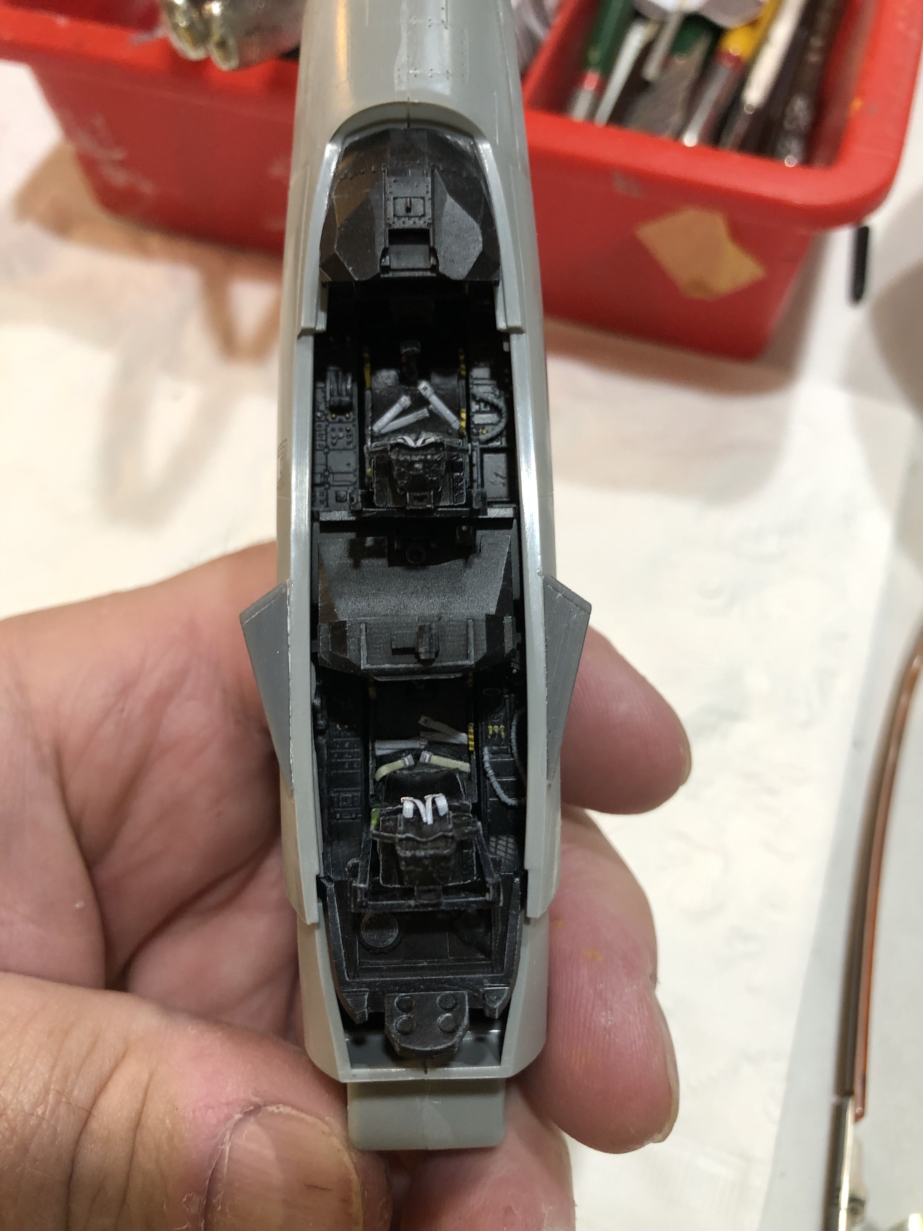

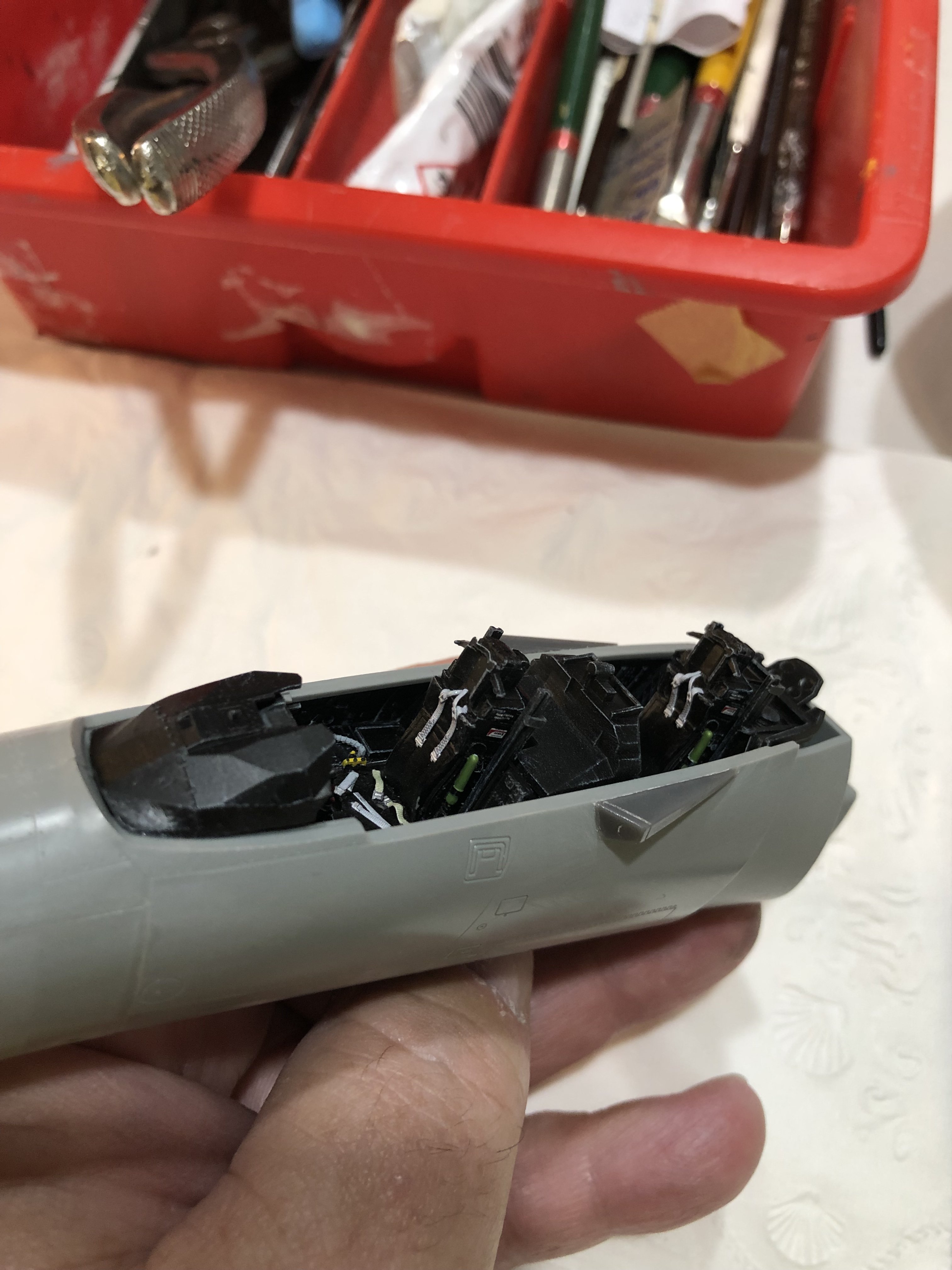

ORANGF15Guy Posted October 1, 2021 Author Share Posted October 1, 2021 Cockpit is all buttoned up and ready to be attached to the fuselage. Quote Link to post Share on other sites

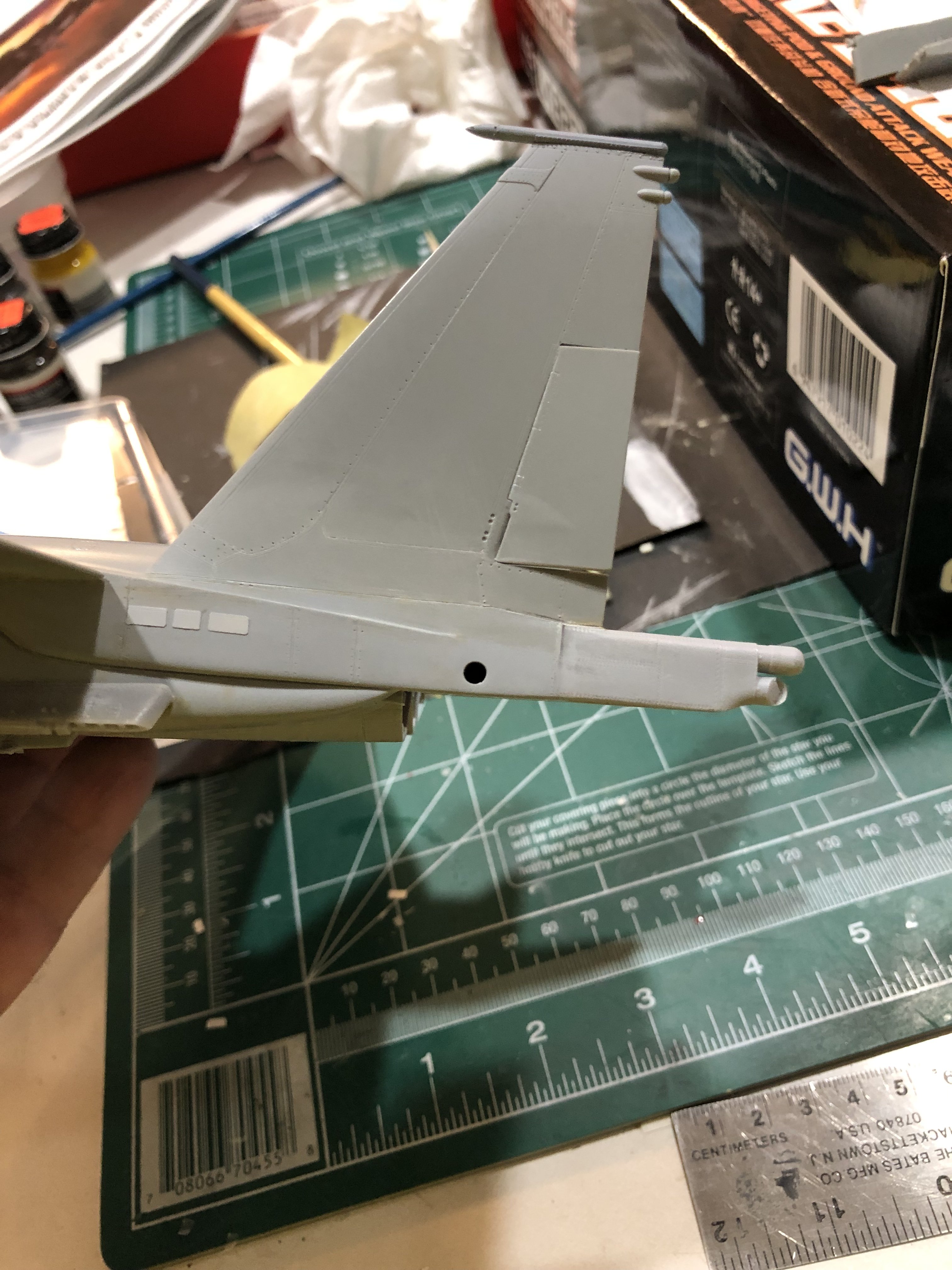

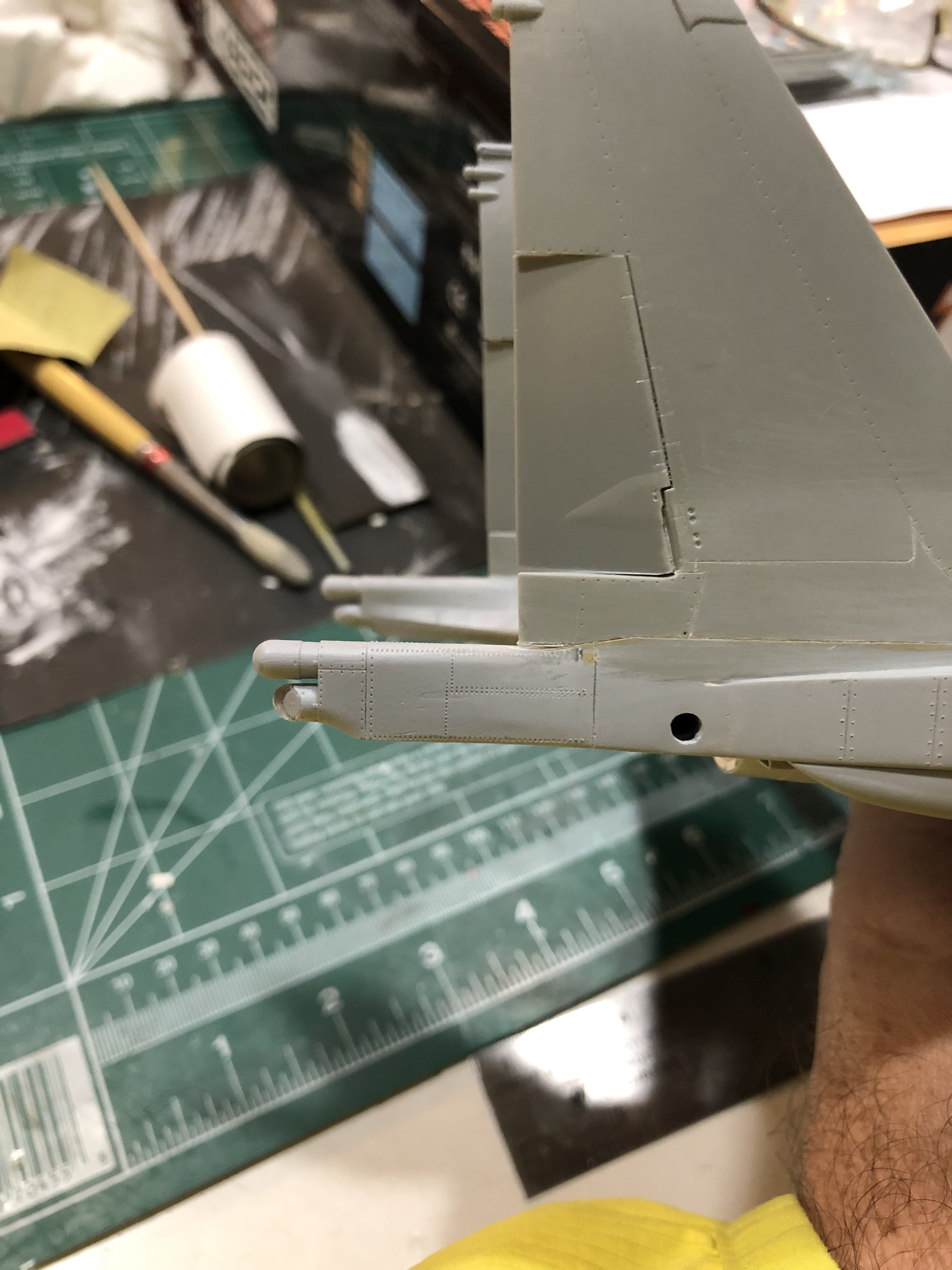

ORANGF15Guy Posted October 1, 2021 Author Share Posted October 1, 2021 Also have the new tail booms attached. The inside of the BAM Model booms have raised rivet detail like the real thing, unfortunately some of it was remove during sanding. So I will be replacing that with some Archer rivet decals Quote Link to post Share on other sites
