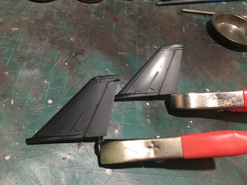

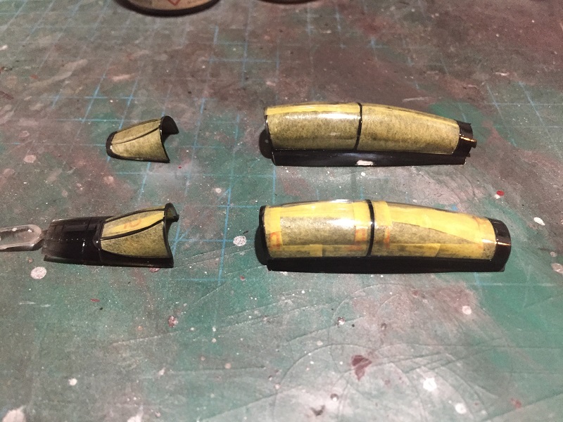

First, I masked the canopy inner frame and pained it with black. I always use a "lighter version" of black - a mix of Tamiya X-18 and XF-63, which allows me to do highlight and shadow...
...as you can see on the vertical fin...

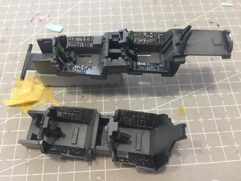

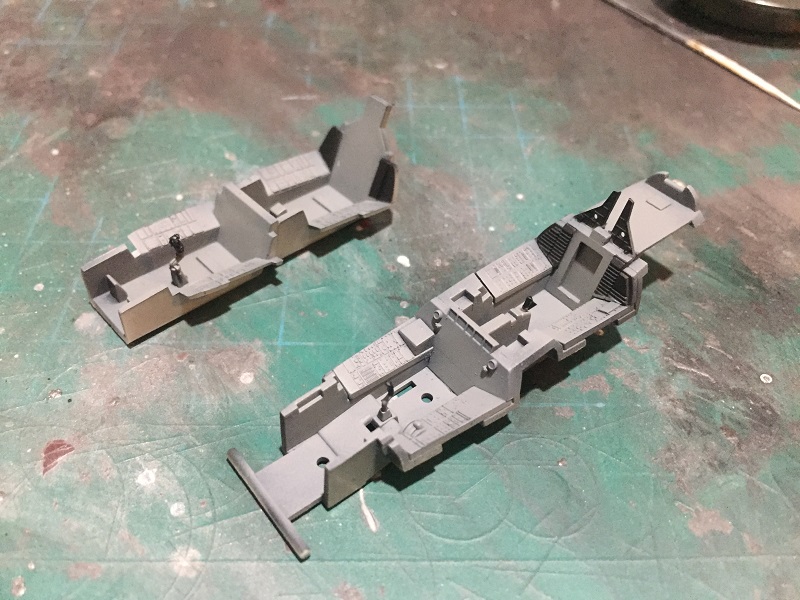

The same black was airbrushed on the cockpit tub, before interior grey (H317), creating a basic light and shadow effect.

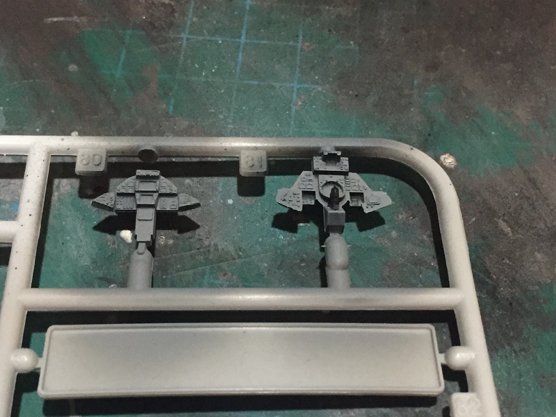

Same went to the instrument panels, I kept a downward angle when airbrushing, to give a more 3D effect, a technique I learned from a figure painting video.

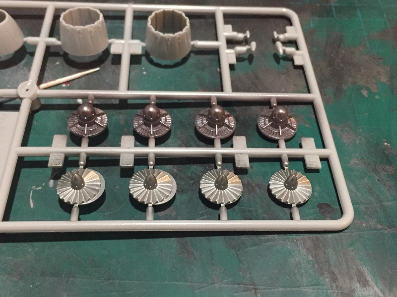

I also painted the intake fan. At first I used AK titanium, to my surprise it was rather dark, so I over sprayed a layer of Gunze titanium, now they look OK.

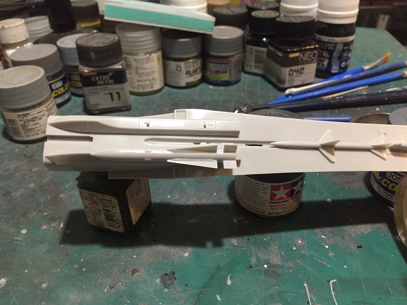

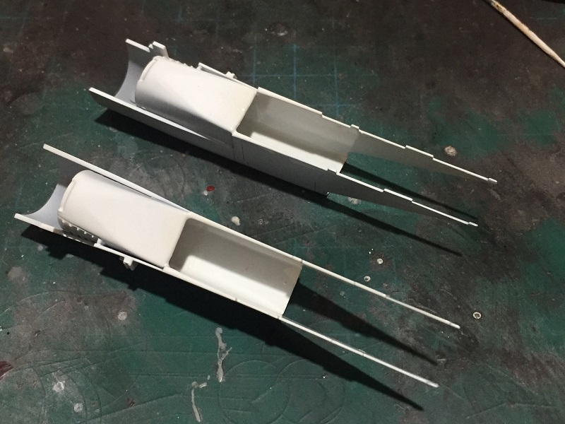

While waiting the paint to dry, I worked on the intakes. The Academy kit has full intake trunk but in pieces, so they are glued and seams has to be removed before painting.

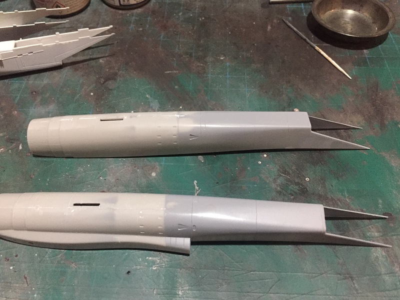

The Fujimi intake was a bit warped, so I had to glue them together, and removed the joint seam by section.

Think I have to post the following pic before closing the cockpit. The decals of both kits did not only work well with softener but also fit the details of the parts perfectly, gotta give both makes a lot of credit.

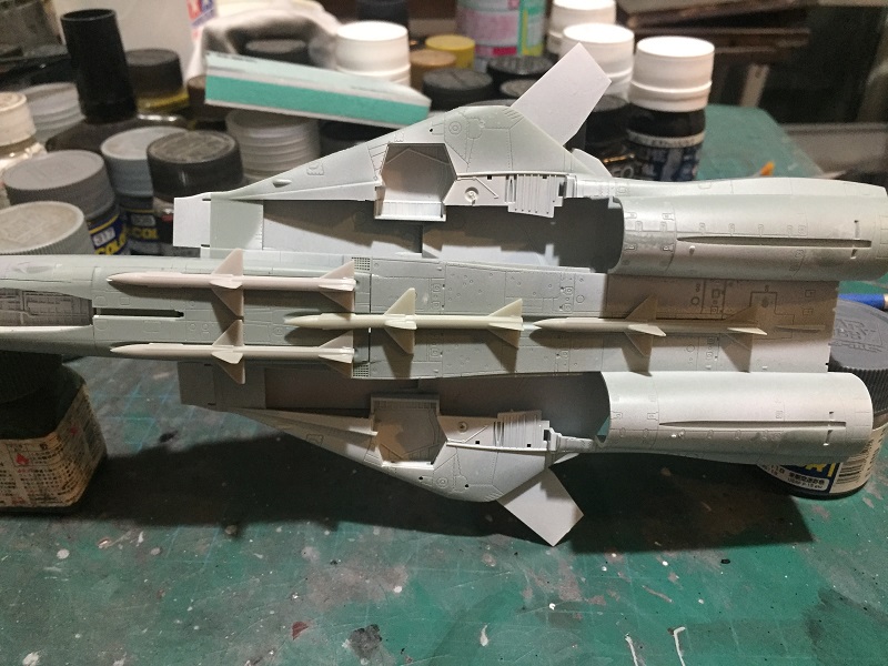

To avoid drilling a bunch of holes, I used magnets  on the fuselage and the Phoenix launchers, to keep them in place. Please ignore the misalignment of the missiles  as they are just held temperately by Tack-it to test if the magnets could hold the weight. Now I can choose to use the Phoenix missiles...
Or Sparrows, without any holes...
Or a mix...just having some fun

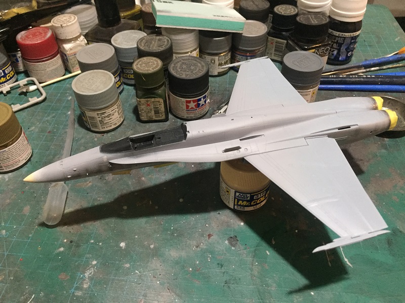

Another decal arrived, F/A-18C desert storm MiG killer
Actually I already started building the Hornet, using the Academy "Golden Dragon" kit. The kit depicts a later version Hornet, so I have to back-date it a bit, like using some of the "unused part", and removing the AIFF on the nose. The build was simple and straight forward, and close to paining stage now.
