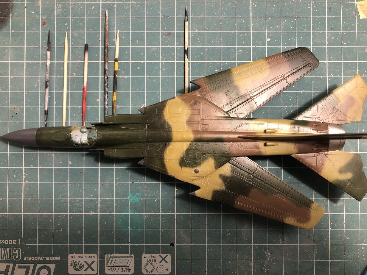

JackMan Posted September 21, 2022 Share Posted September 21, 2022 On 9/7/2022 at 8:37 PM, Thadeus said: The Flogger still awaits some decals... But I still don't feel the colours are "right"... Could it be the "sand color" actually looks more yellow? Quote Link to post Share on other sites
Thadeus Posted September 21, 2022 Author Share Posted September 21, 2022 Yes, kind of. The brown is another suspect. They actually might be working together - contrast here feels off. The brown could be more reddish. While I know I can kill the yellowness in the sand colour, I don't feel confident in changing the brown too much. Quote Link to post Share on other sites

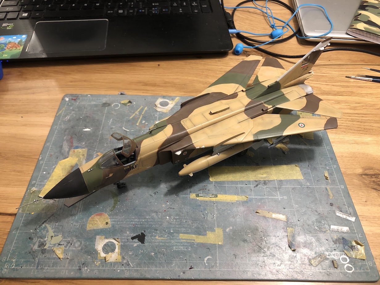

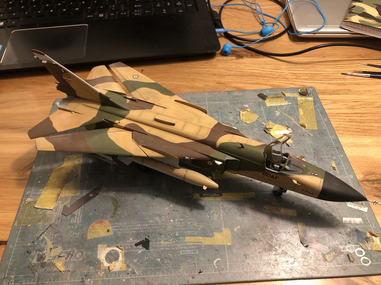

Thadeus Posted December 15, 2022 Author Share Posted December 15, 2022 I'm slowly getting back in the saddle after loosing my head for work. A couple of years of hard work has really payed off for me there. But as they say, now it only gets harder. Hopefully I can have a bit of time for modelling now. The first effect: Tornado. Really, the Revell kit is amazing. Shame I could not salvage the movable pylons. So no movable wings too. Ah well. I like Tonka with wings forward anyway. Pics make the paint look more pinkish, warm colour. But in reality it's a little more yellow. One thing I didn't know, was the canopy has inner frames scribed on. I only found out when I unmasked the part and lifted quite a few pieces of paint. And I always run a knife by the edge of masking tape. Fixing all these little imperfections was pretty annoying. I had to paint the entire frame from the inside. But now the effect is kind of nice. Thanks for stopping by. I'm almost done with the Su-24! Can't wait! Quote Link to post Share on other sites

crackerjazz Posted December 21, 2022 Share Posted December 21, 2022 The camo paintjob turned out really great, Thadeus! Getting to be quite a collection, there : ) Quote Link to post Share on other sites

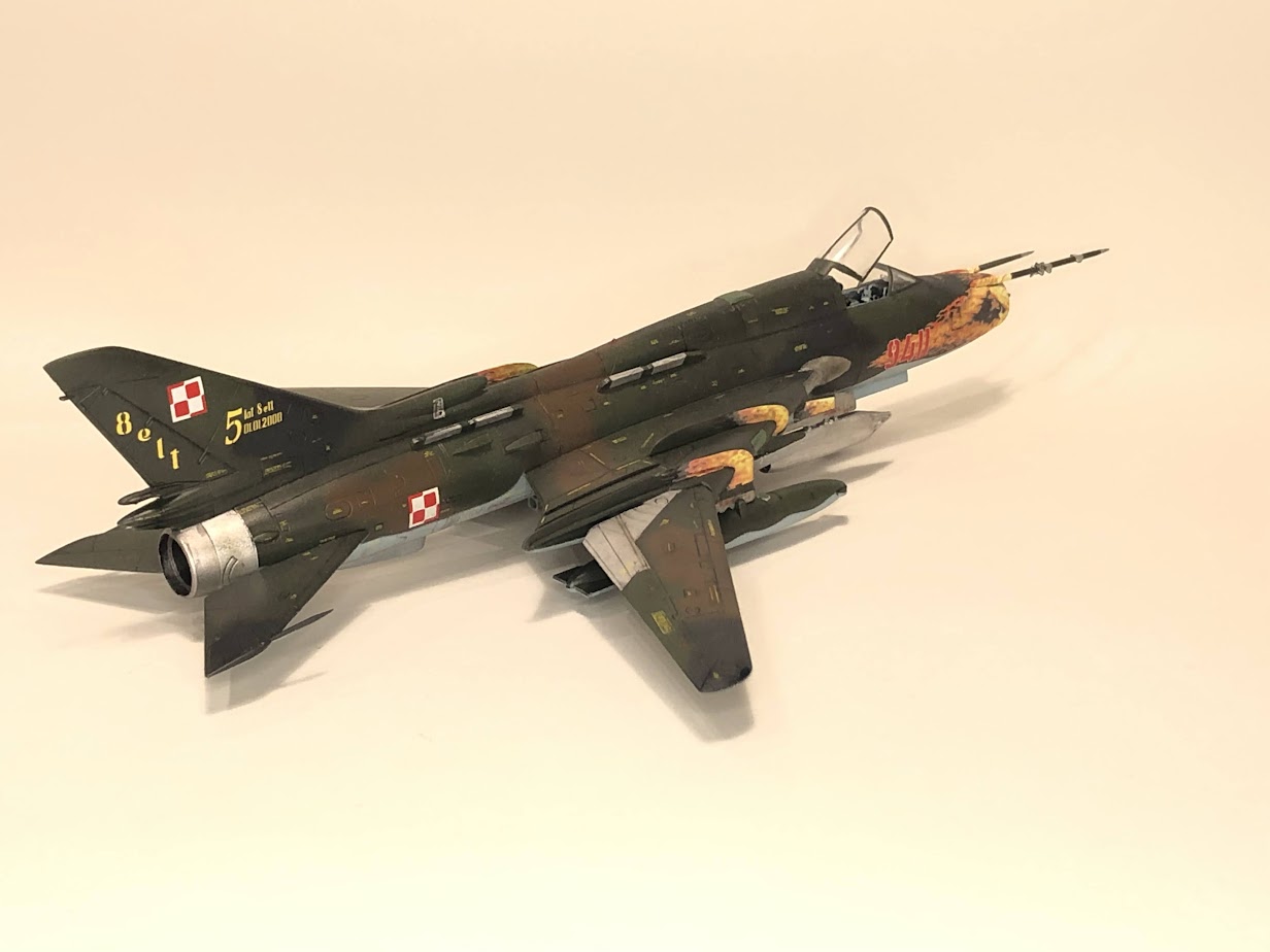

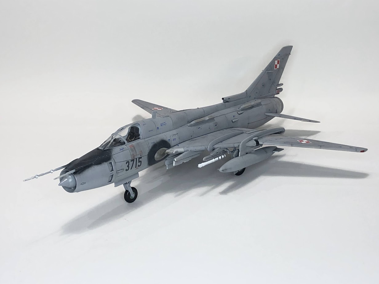

Thadeus Posted December 30, 2022 Author Share Posted December 30, 2022 So, as I've mentioned, I used to not like the lines of the Su-22. Lack of pointy end was probably to blame. However, once I built the Plastyk Su-22Um3K that changed. And then I found out there were much better kits - the Bilek ones. Now that I built both, side by side I'm conflicted. I really like all the panel lines and detail of the Bilek kit. It's indeed much better than on the Pantera kit. There are four underfuselage hardpoints, there are much better shaped vents. The cockpit is also better looking. The overall shape however... Well, I don't have any plans for the Su-22. But there are a few points of interes one can check without the plans. The canopy is the main one. I think the Pantera kit has a better windscreen, albeit not a perfect one. The Bilek kit feels wrong. Too small. The line of the canopy and windscreen is weird too. Feels much too slanted. There is a Pavla replacement, supposedly the best. I'm going to get one for myself for my next build if I can find one. Next point is the thickness of the fin and wings. It's obvious they are too thick on the Bilek kit. But frankly, that is nitpicking. The last point, is the stance. And I'm really at a loss here. For me, the Bilek kit sits too much "butt down". This shows really bad when the fuel tanks are on the underwing stores. The Pantera kit sits much higher. It has simply some longer gear legs. Both the main ones, and the nose one. I'd have to check the sixe of the parts. It's absolutelly fixable, if You know what to expect. As You can see, there is significant difference in height. But that is almost exclusivelly in the gear legs. The stance, the angle is pretty much the same. You can also see the difference in overall detail - look at the base of the fin - much more accurate in the Bilek kit. Check out the profile picture of this beuty https://www.planespotters.net/photo/052218/3713-polish-air-force-sukhoi-su-22 You can also see the difference in windscreen shape and size on a real jet and these two. Here lies the problem. I've used the Su-20 to compare. But it uses the excact same landing gear as the Su-22 kit. And the wheels are almost identical. I kind of hoped, this build would make me choose which one of the -22's are better. The Pantera kit unfortunatly isn't a 100% better option. The detail is much weaker. The fit is much worse than Bilek. Literally, the only thing it has is slightly better overall outline. And even that can be questioned. The more You look at the model up close, the more faults You can see. My stencil is quite good metaphore actually. From afar it looks passable. There is an obvious question of price. I can get three Mastercraft (Pantera) kits for one KP (Bilek). Kind of makes me think about kitbashing. It gets even better when considering the Plastyk kits. The Mistercraft one goes for 26 PLN, the Plastyk ones go for like 18 or something. That's like less than 7$ and 5$ respectivelly. I kind of can't find the KP ones right now though. It's weird. I'm thinking about another Fitter right now. I actually have decals for the 3717. And it's a very nice scheme. Huh... Thanks for stopping by! Quote Link to post Share on other sites

Thadeus Posted January 30 Author Share Posted January 30 So, all the decaling is done on both MiG-23's. Eventually, I decided against repaint on the sand colour. I don't have anything dark and not yellow. I tried mixing two shades, but on the test piece they seemed off. So I figured too yellow can't be that bad. I'll darken it and hopefully break the mustard hue at a later stage. KP decals were not so good. I mean, the look allright. It's just the stencils seem a bit too thick. They were also crumbling in water, easilly breaking when pulled. A tiniest bit of decal film helped a lot. Fun fact, smaller designs were printed almost entirelly off the clear film. For the MF, Techmod decals were a pleasure to work with. A tiniest bit too thin was the Bort number. When I was separating it from the decal sheet it kind of glued itself together. It's barely noticable though. The hardest part, I could not find any picture of this bird in silver. So I guesstimated the checkerboards were of the earlier design, with red square to the upper left. From 1993 Polish air force uses a checkerboard rotated by 90 degrees, with white square occupying the left upper spot. I wonder how all this shine will look under a semi matt coat. Next, some weathering! Thanks for stopping by! Quote Link to post Share on other sites

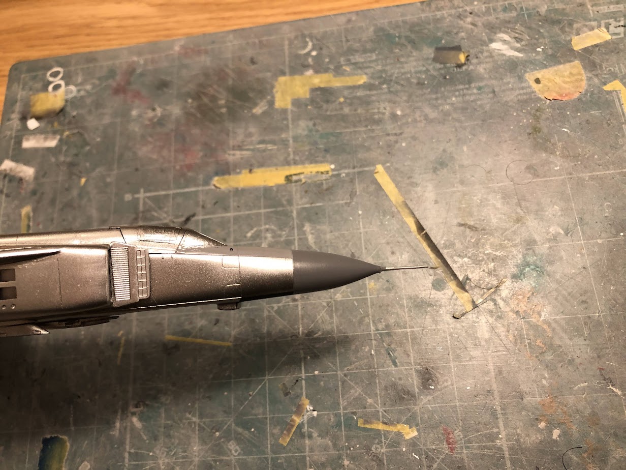

Thadeus Posted March 9 Author Share Posted March 9 (edited) One more lands on the shelf!! I couldn't resist doing the Polish AF bird first. Building it next to the KP bird really shows how basic this kit is. Very little panel lines, especially on the wings. There's no rearward mirror on this one, hell there wasn't even the center bar on the canopy. . I might do it sometime later though. But it does have the pitots. But, once built up I have to say I really like the way it looks. Reminds me of my first Academy MiG-23. I'll probably have the MLD done this weekend too. All it needs is a flat coat, painting of all the hanging stuff, and I'm done! Thanks for stopping by! Edited March 13 by Thadeus reuploaded the photo Quote Link to post Share on other sites
