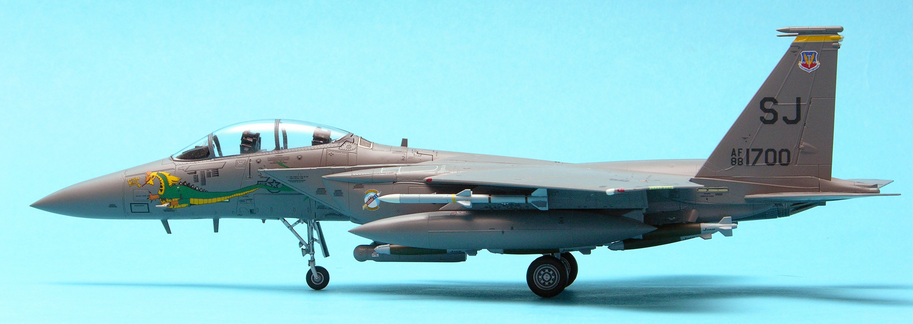

I think the Academy "press fit" kit is great. I built one out of the box for FSM review. All the weapons pylons are included. And you're just one razor saw cut away from having an open canopy; and I guess you'd have to make a retractor piston . . . .
