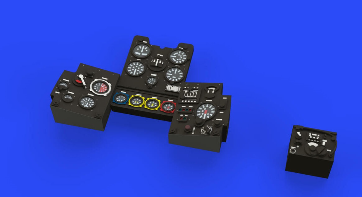

Also ordered this "LooK" set from Eduard. I have not used this offering before but this looks much more refined than the vinyl 3D decals from Quinta Studio (not available for this Ki-61 kit).

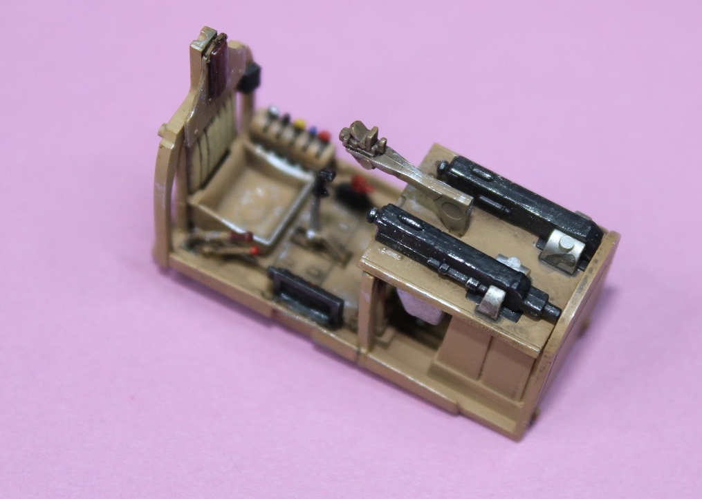

Started to work on the cockpit. Interestingly the Zoom cockpit PE set from Eduard does not include seat belts. So must wait for the LooK set to arrive so I can install the instrument panel and seat belts. Very odd from Eduard. Dai

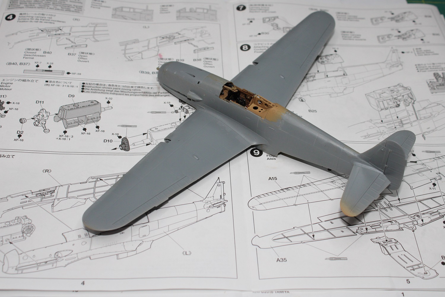

Some more progress... Start to look like a Tony now. The progress moves quickly because of the fantastic engineering and fit. After the Tamiya P38 and now this, I don't know if I can handle any other manufacturers. Dai

Very nice and neat prep work! What primer are you using?
Thank you ! The primer is Badger Stynylrez gray. Spray straight from bottle, covers beautifully and thin, sands to feather edge, warp speed drying. I think this is
the world's best acrylic primer. Too bad Badger does not offering paints with this formula. Dai

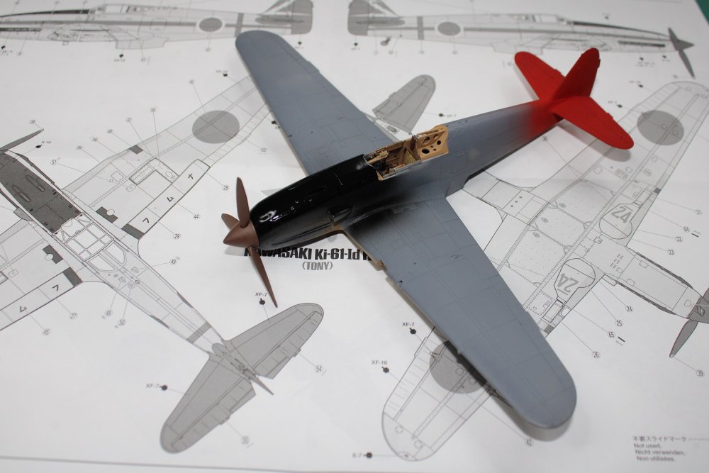

This project caught me with a suprise. That is the Tamiya is the long nose version (Tei) and the Hasegawa has both long (early releases) and short (late releases). Most of the decals are made for the short nose version. Life Like decals has made some decals for the Tamiya but most are the typical red tail/green mottle schemes except for one with olive green. I want something different but unfortunately this olive green version does not have the appeal (simple markings) and the shade is speculative. After much debate I decided to go for the red tail w/o the green mottlings (I do not have the skill to do such fine free hand work). I rarely use the kit's decals as it is too thick for my liking but the Life Like decals thas has the red tail schemes are off in color. The red is too light and if you paint the tail then you need to mask and paint the hinomarus to match as I did on my Claude. Print Scale also makes the decals with darker red but my experience with it is so poor so I do not consider. There is a review on the Net that praises the kit's decals so I hold my breath and go for the Tamiya's offerings. The hiniomaru is still a little bit off the XF-7 (red) but very close and I can live with it. Many modelers on the Net are also dissappointed with the lack of decal offering for the Tei versions. Dai
