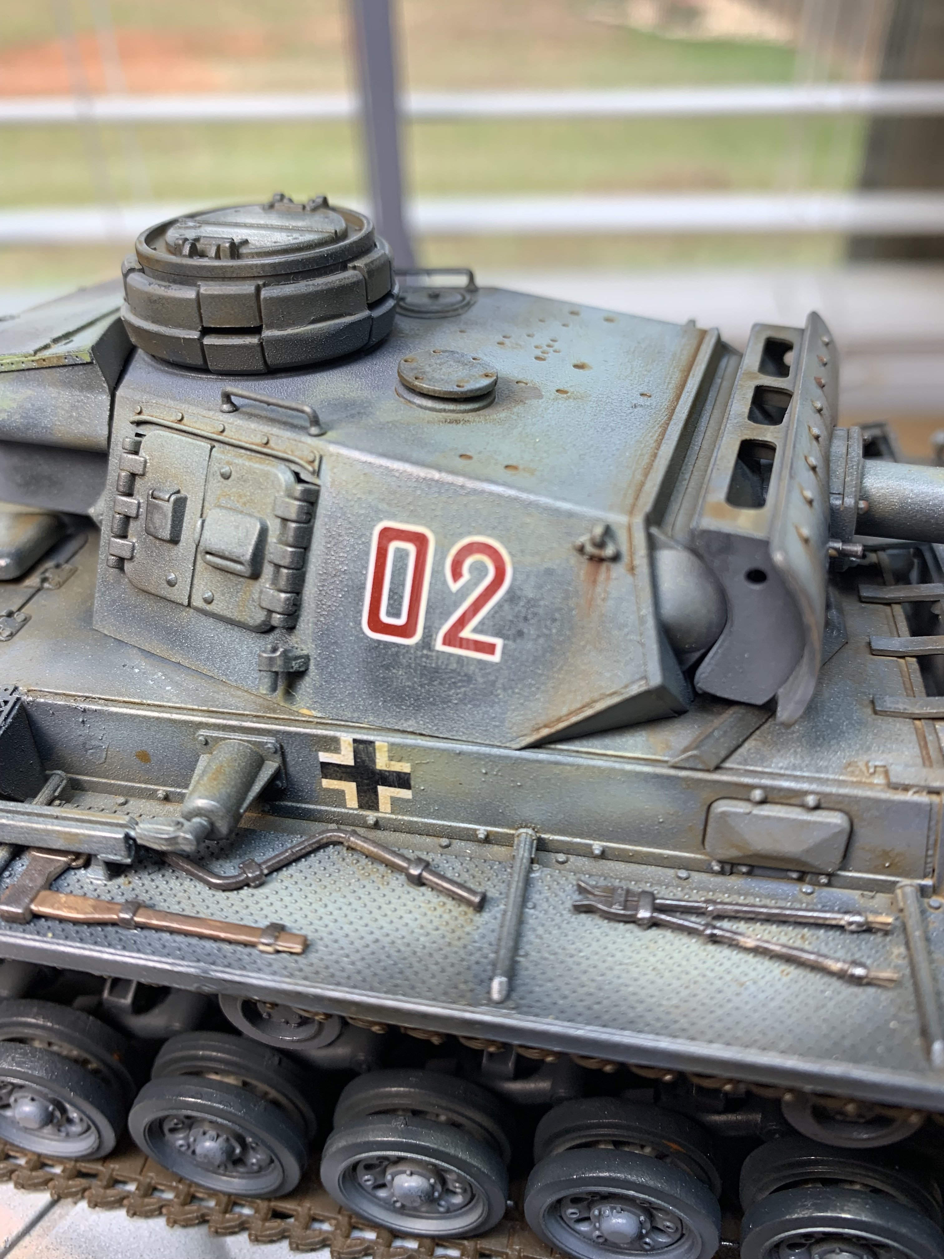

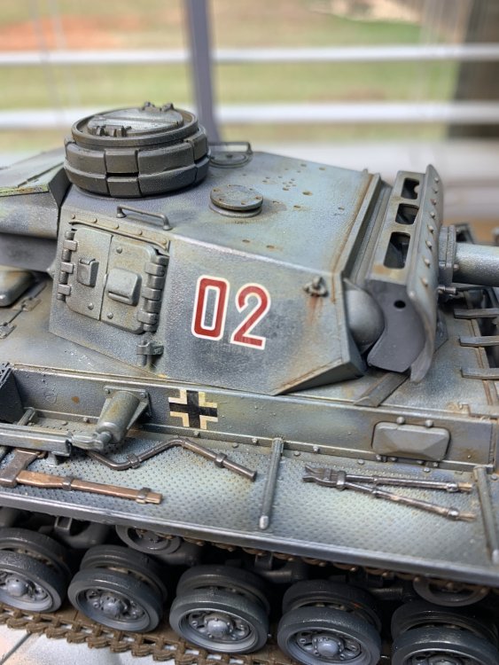

I also just returned to hobby after 20+ yrs away.  For me Tamiya paint thinned with Mr Leveling thinner is easy to use. I also like the Mr. Color line of paint. For metal I love I mean love Alclad!  I use their primers on all my models also. Iv only completed three models and found I improve each time I finish one. I also watch video after video Nightshift, Plasmo! and this gentleman from Japan. He is very skilled and paints in a different manner. I just completed a Panzer III and came kinda close to his. Good luck with your modeling!
