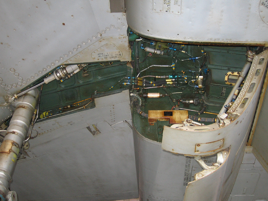

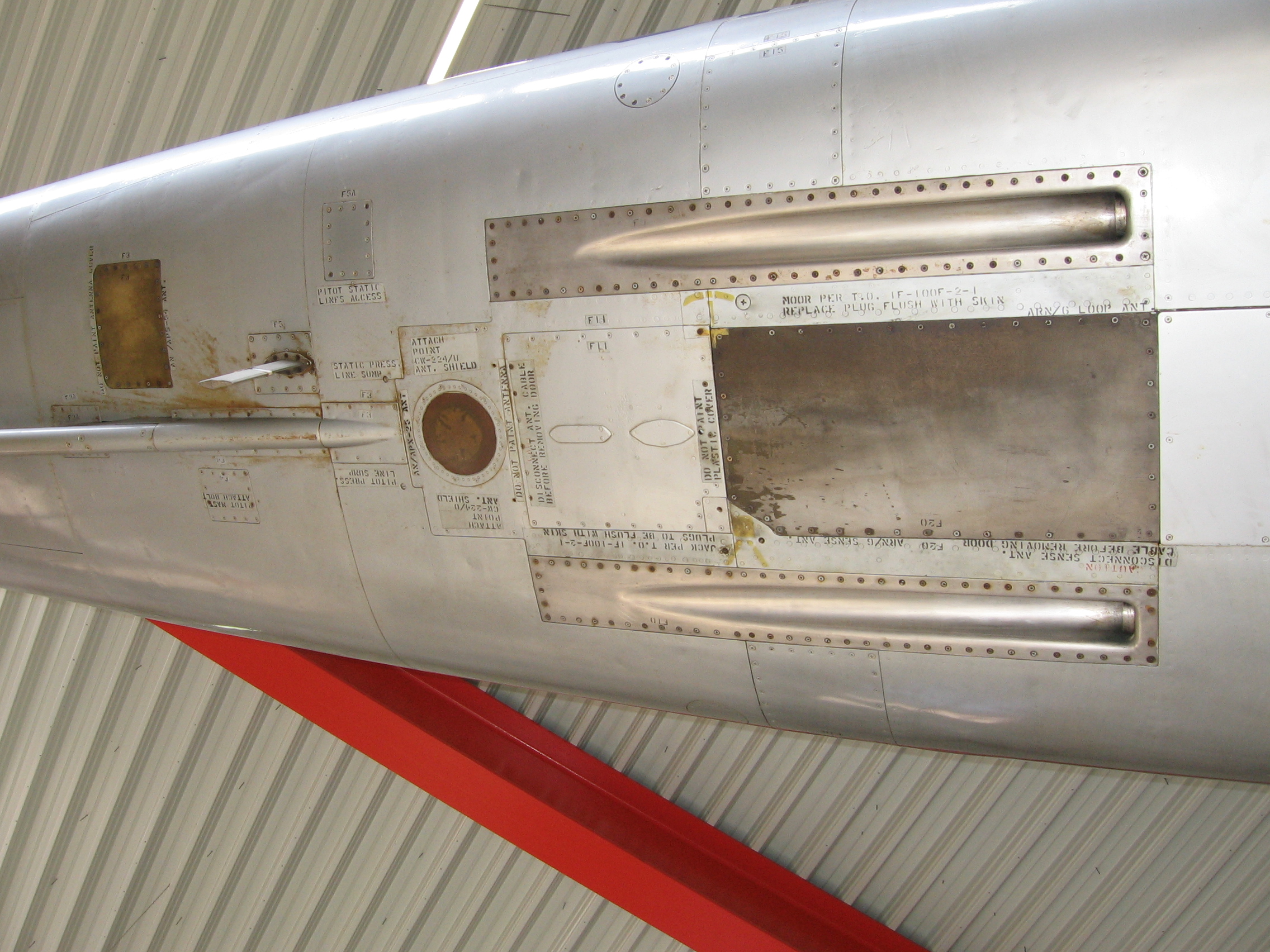

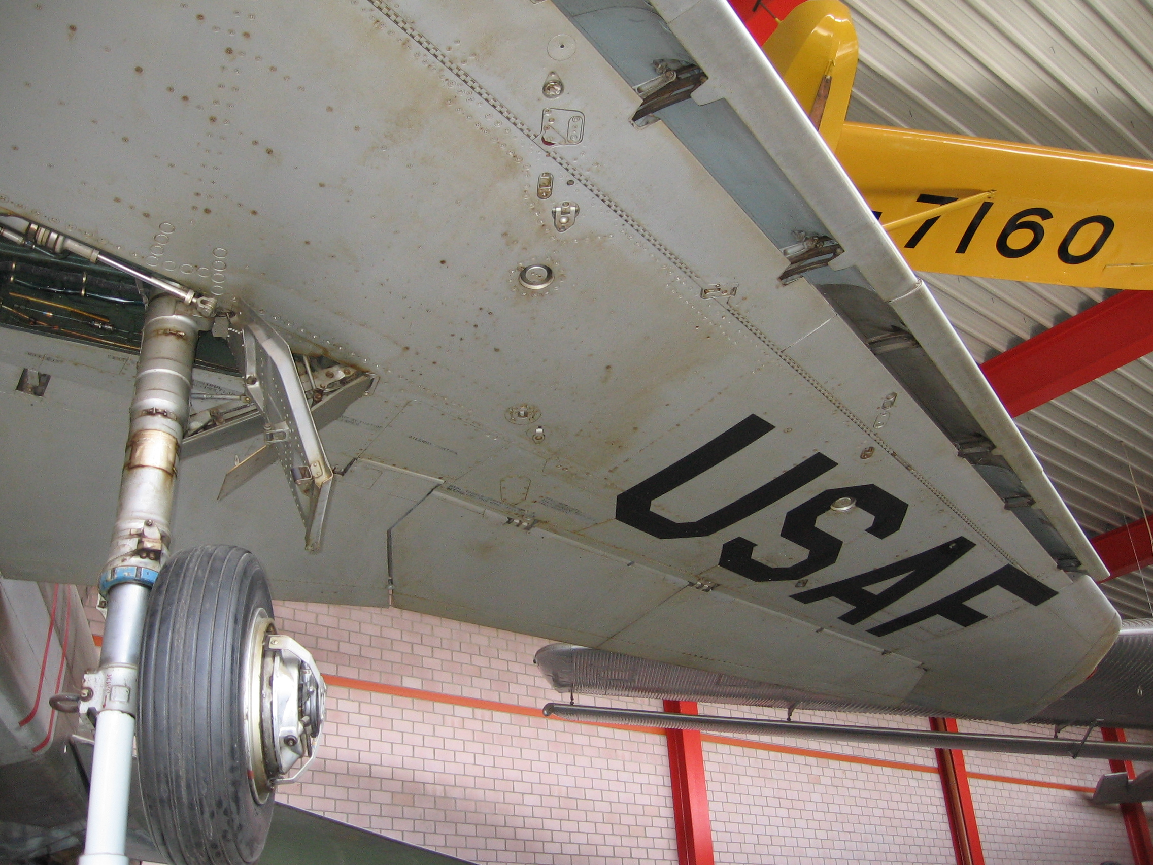

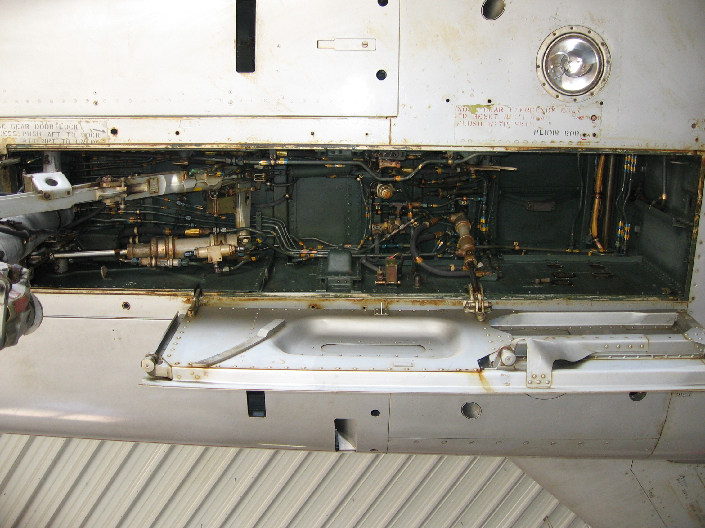

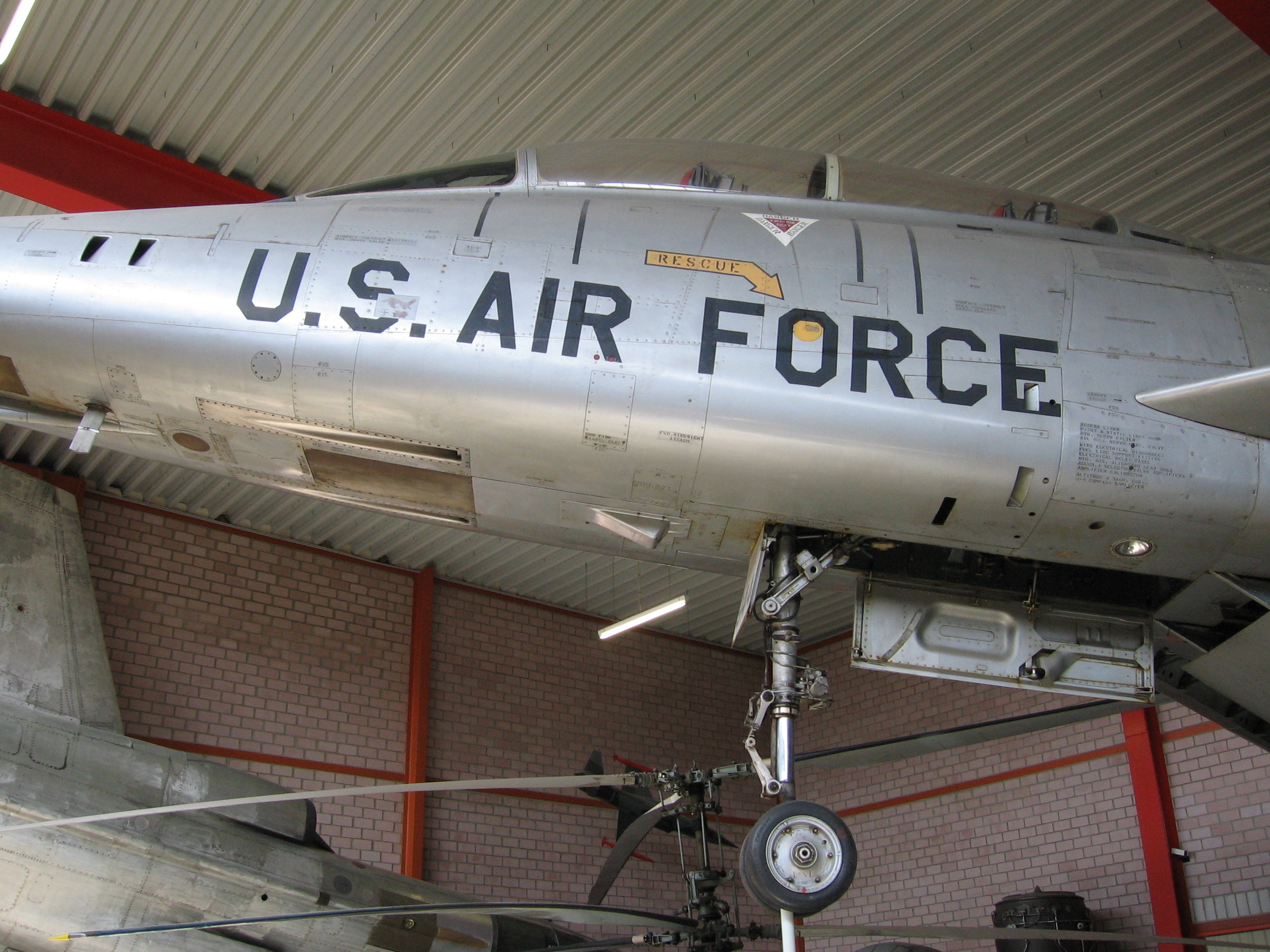

I was at Holloman in the early 80s sharing the ramp with the ‘102 and ‘100 drone outfit. The green in these photos is the way I remember those huns. These are GREAT reference photos of an original, unrestored jet. I believe there was a lot more of that green, approximating 34092, than we might think. That color was all over the inside of a KC-97L I photographed at one time as well.
Thanks for posting those photos! That's the green I remember on an F-100C and a couple of Ds. It is slightly different than the green I suggested, so go with Bill's suggestion, not mine.  I also recall that paint flaking off in spots, revealing a layer of zinc chromate green beneath it.
