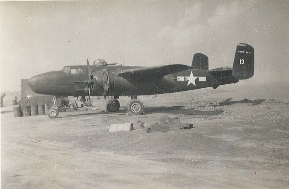

arg Posted November 1, 2021 Share Posted November 1, 2021 Many PBJ-1Js had the top turret removed and replaced with a small dome. I happened to find the photo below that apparently shows an aircraft in the overall dark blue, but before any turret modifications. Oddly enough, it almost appears it still has the nose gun, even though the nose is painted over! I did this aircraft in 1/48 with the Monogram B-25J, with white lettering and numbers to do the tail markings. Quote Link to post Share on other sites
