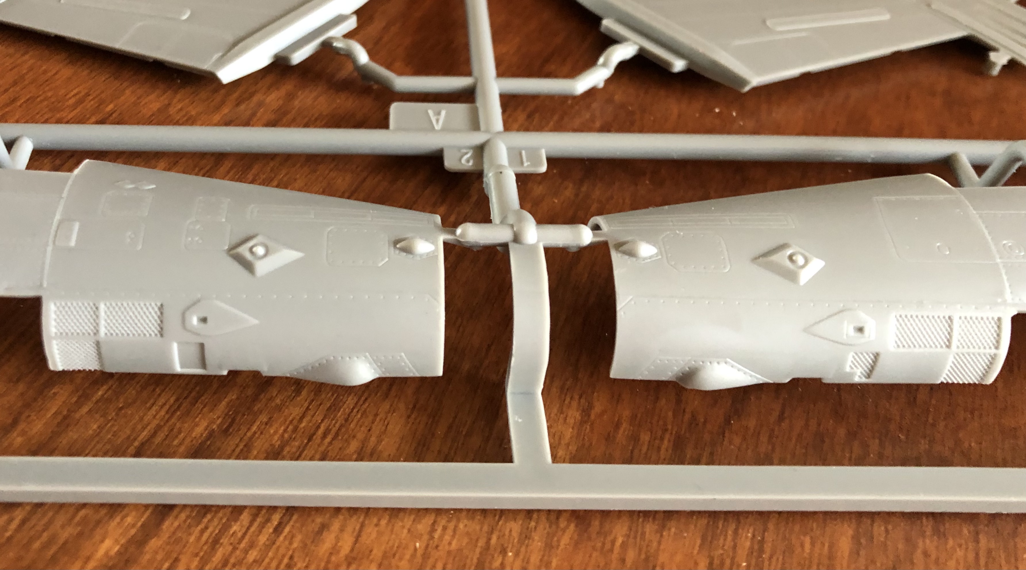

I am considering this kit to do an RAAF Growler, using Skyart decals. Can someone confirm that the kit has the correct forward fuselage with the gun vents blanked and the additional sensors on the sides just behind the radome. Looking at the sprues on the Hobby Boss website it shows the same nose parts as the E and F. I know it wouldn’t be hard to fill and scratch the sensors (like Italieri) but wouldn’t mind knowing in advance.

All the correct blisters aft of the radome are present on the kit (as seen on Growlers, including Aussie versions), unfortunately so are the gun gas vents. These will need to be blanked/ filled in.

The fuselage parts do seem the same however as in the E and F. They are all marked as sprue A. I did not see on the pictures these small bumps just aft of the radome.
They seem to be the only ones that are missing.

I have the HB Growler kit. The small side blisters just aft of the radome are indeed there. As these nose parts (A1 & A2) are the same parts included in the E/F kits, those blisters would need to be removed for the HB E/F kits.
The gun gas vents I am referring to that are there on the G (that should not be) are the series of square mesh/vents on the underside of the nose just forward of the nose gear. As you say, the gun muzzle port and side vent part is replaced with a blank part (J7) in the G kit, so that is correct.

Thanks for posting pictures. I stand corrected then. However, on my Echo there are no blisters. Strange.
On the HB kit? Huh… that is strange. I guess they made common side nose parts for the F and G then.

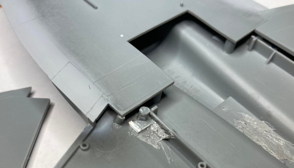

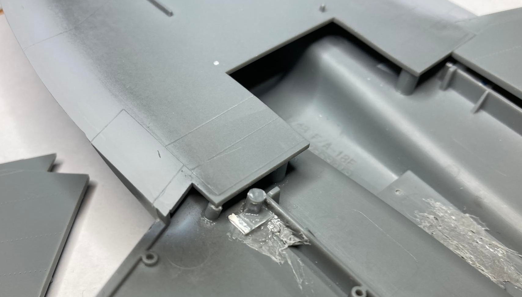

- Dry fit & add some extra pylons (see attachement) to help with the correct alignment. It will avoid an effort with the fixing of steps between fuselage/wings.
