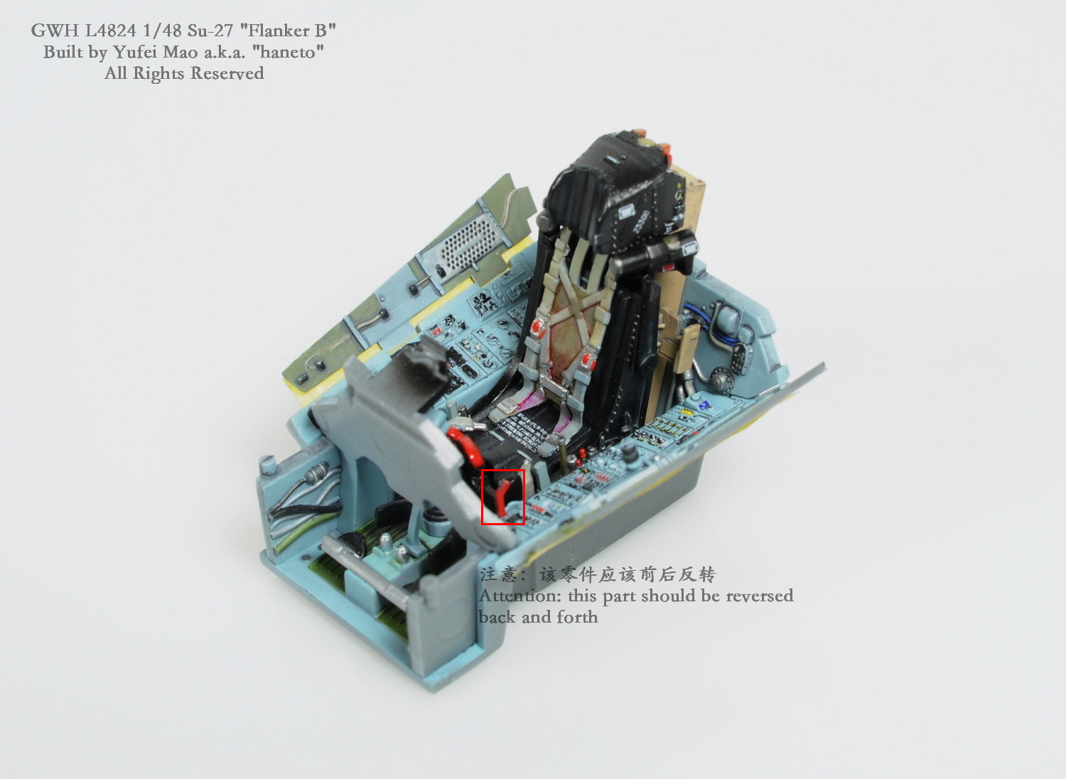

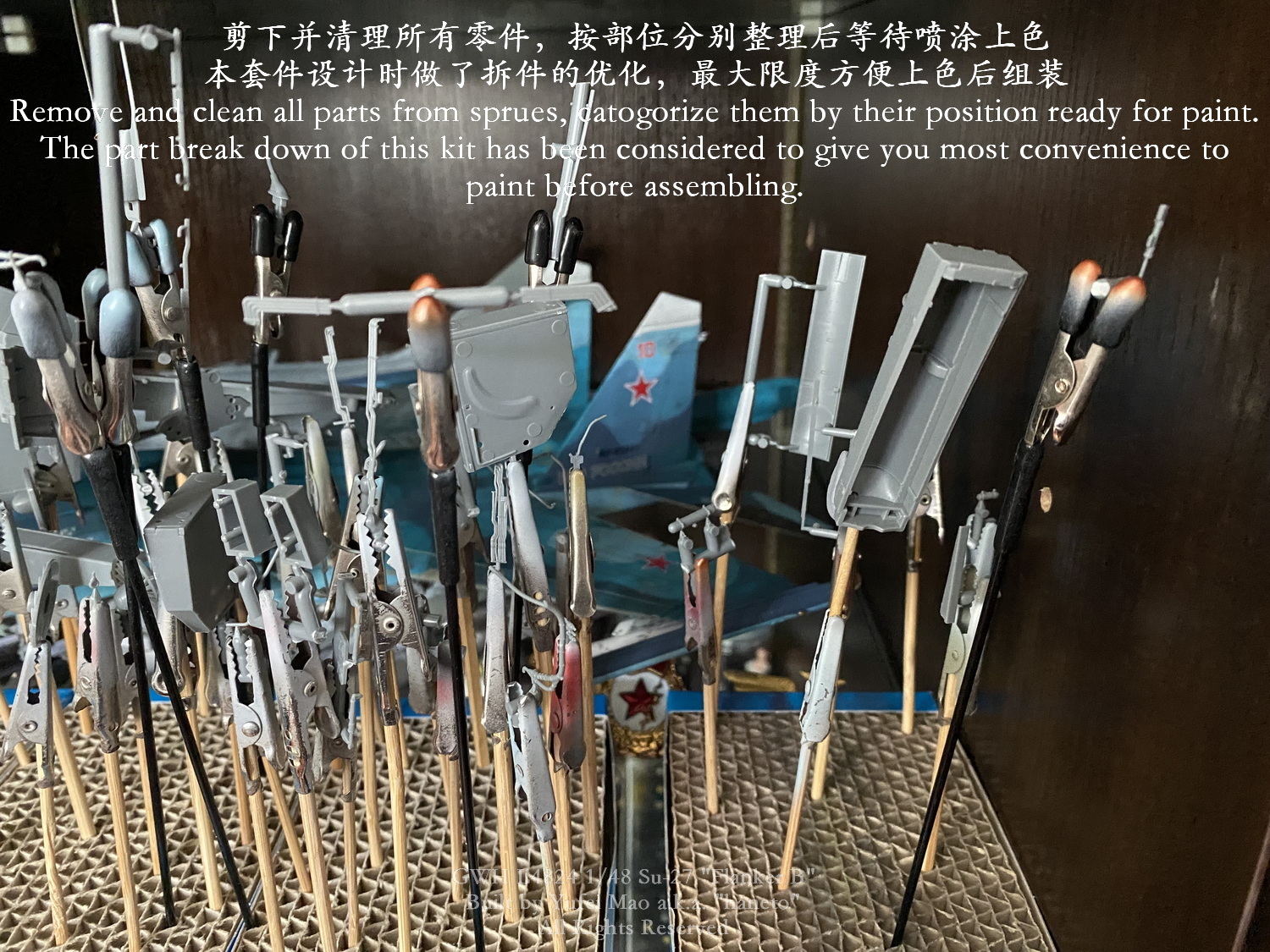

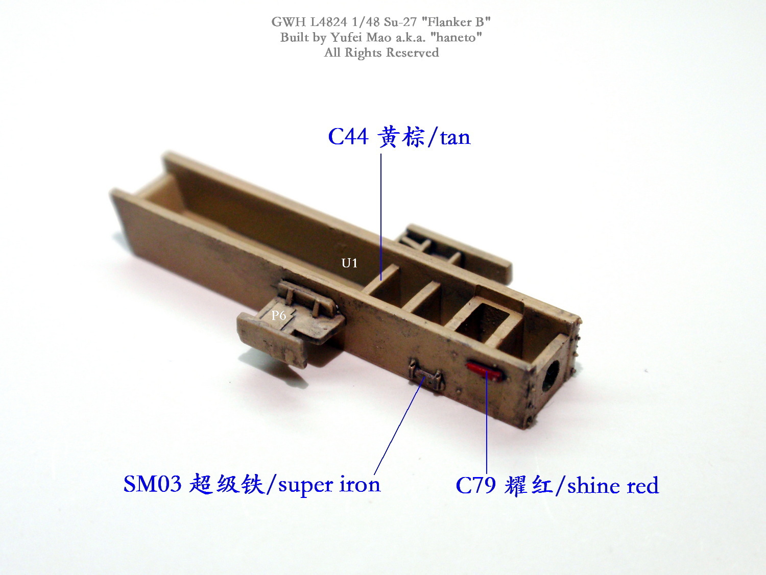

First, let's start with the "dirty" part of the built.
Edited by haneto

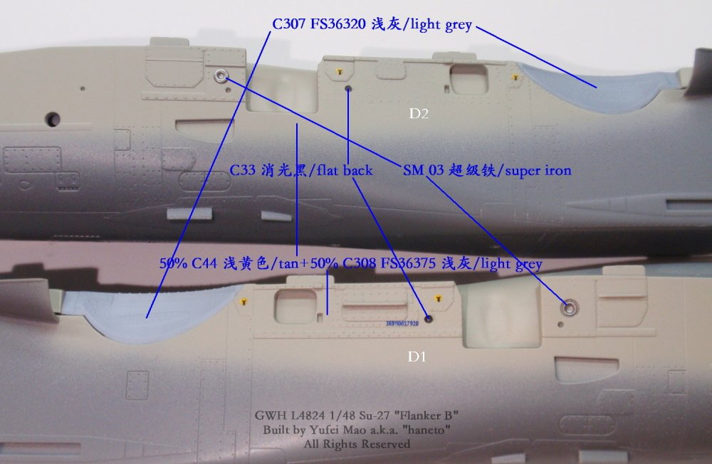

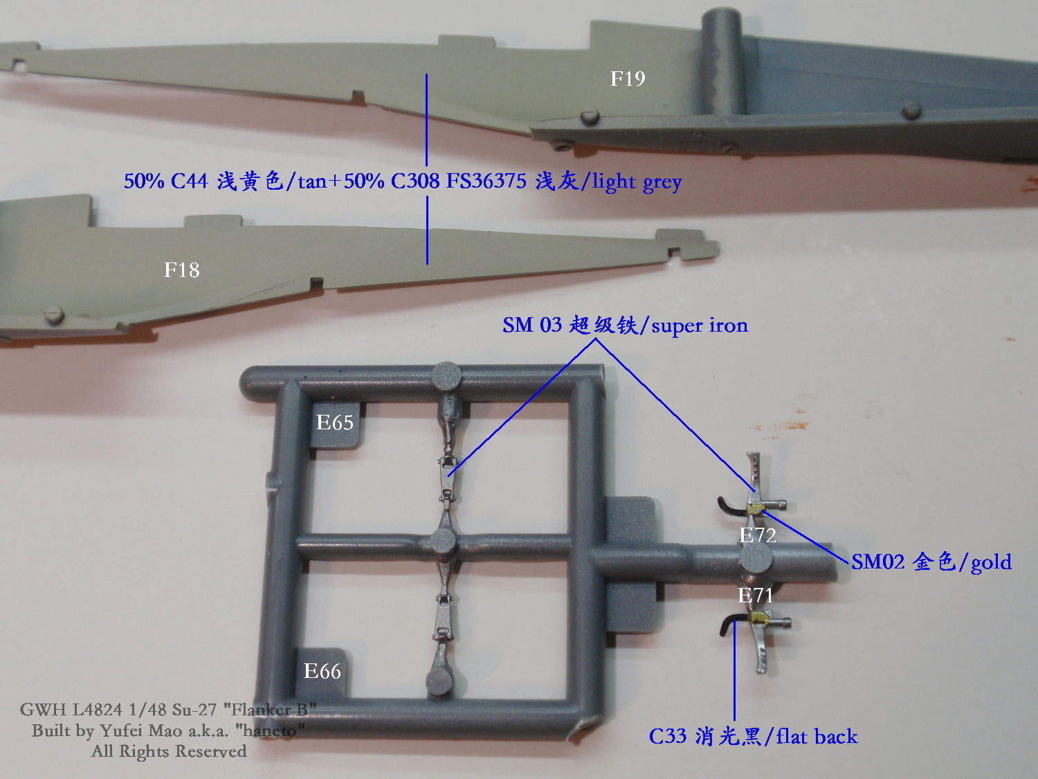

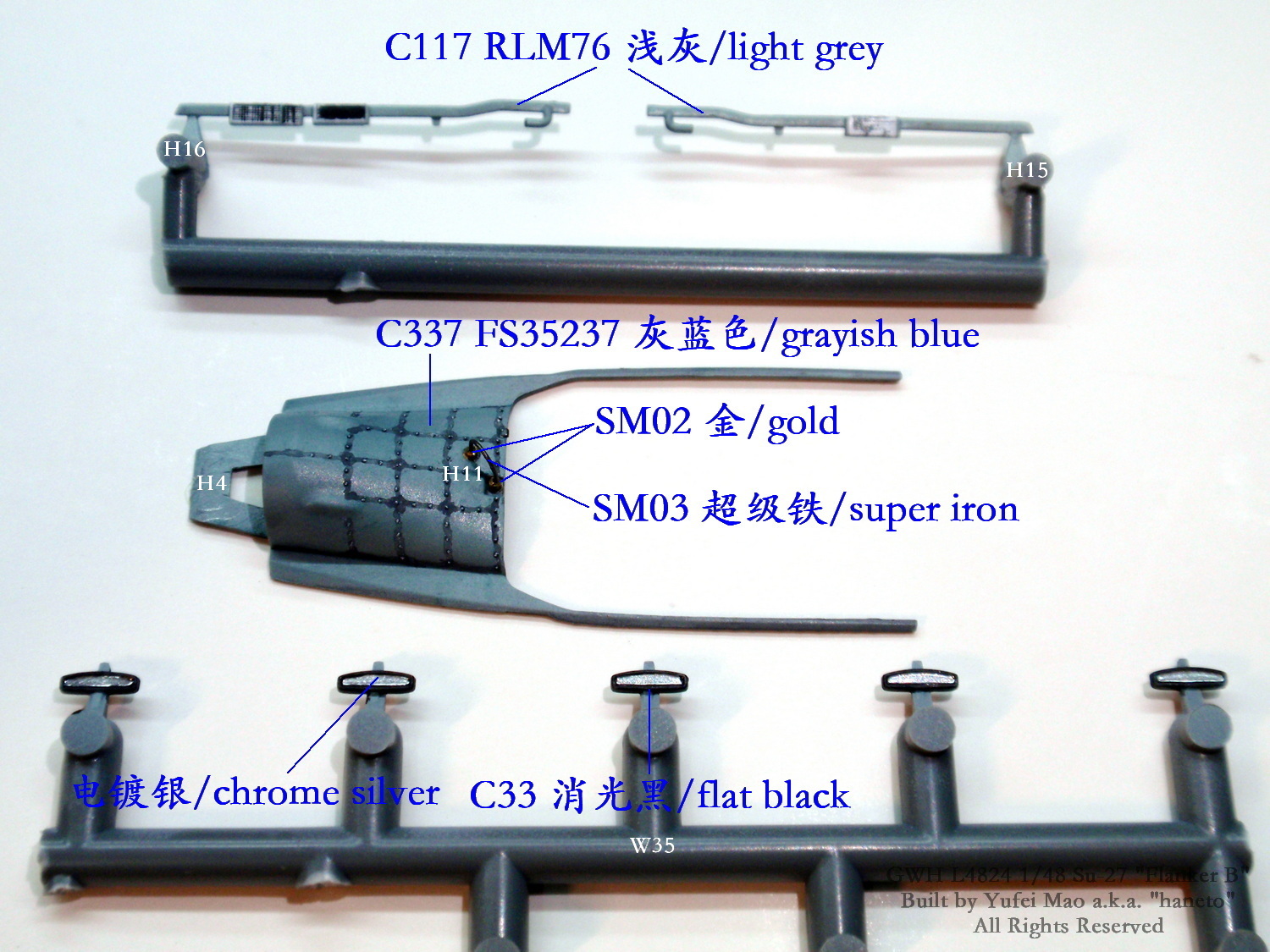

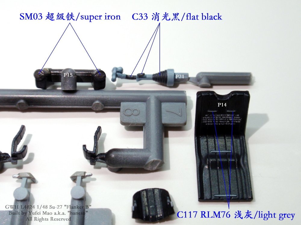

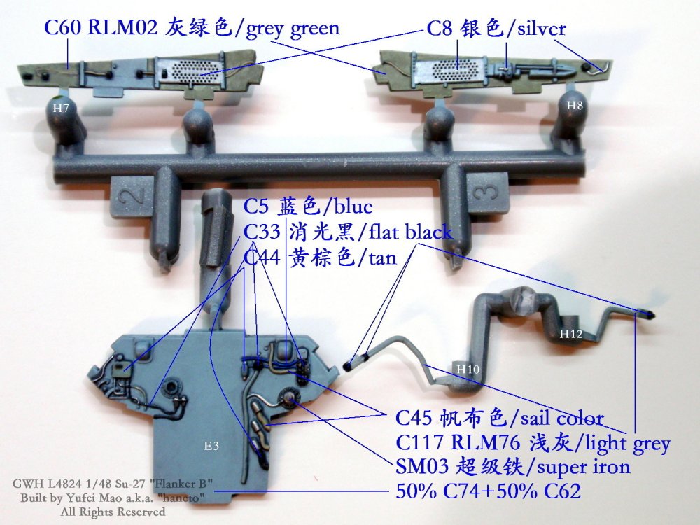

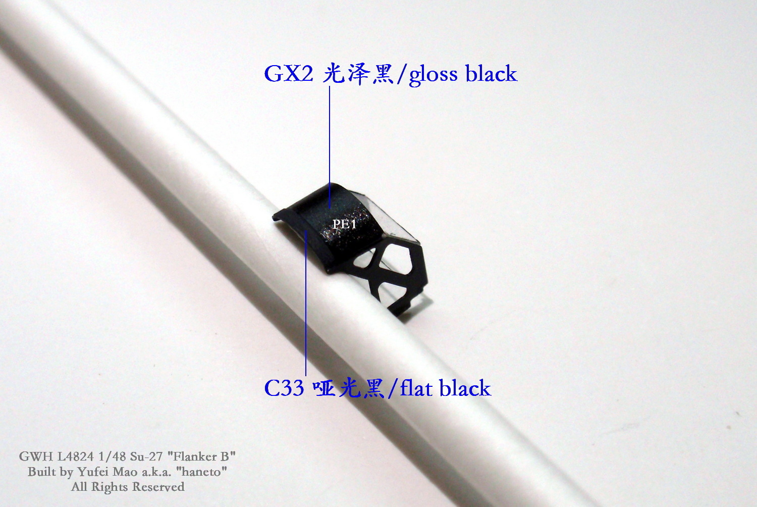

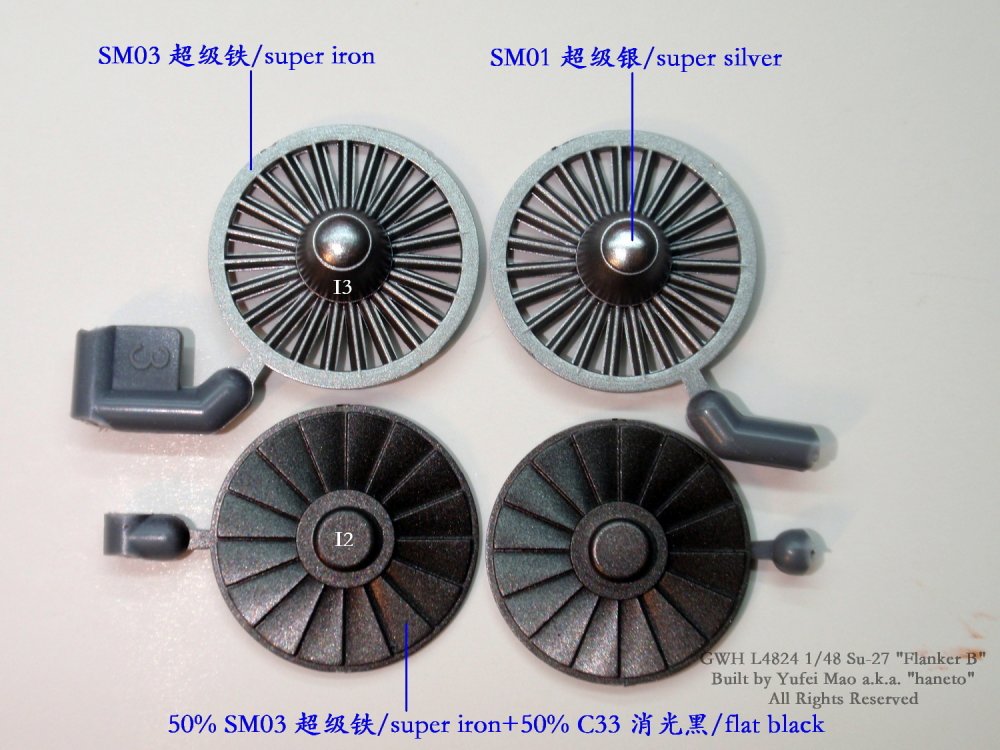

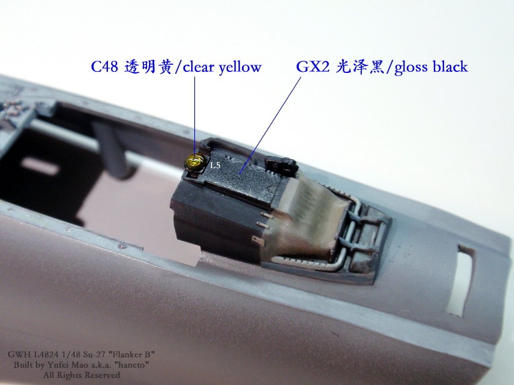

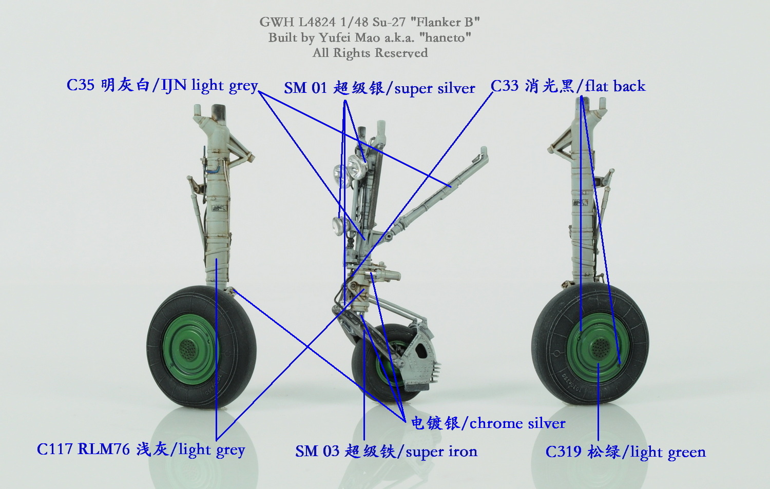

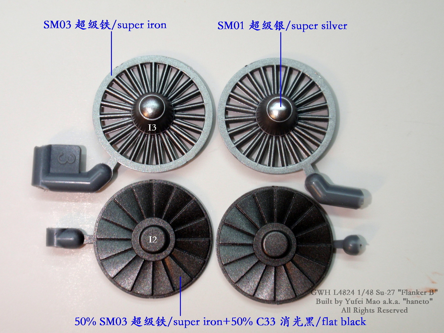

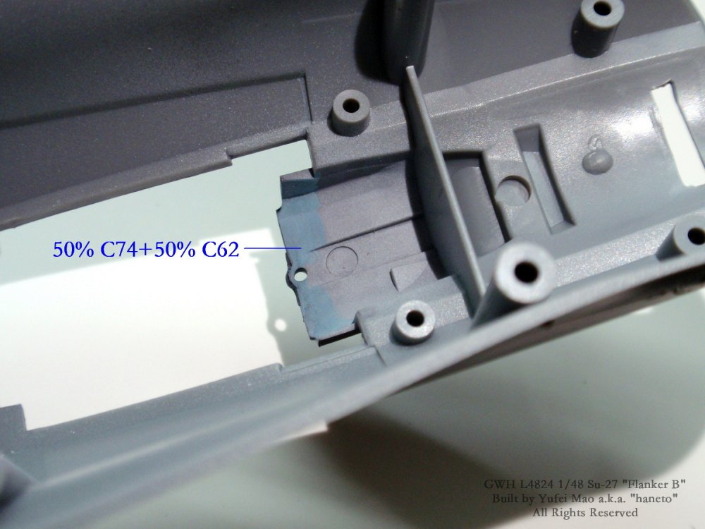

Now here comes the colour recipe for small parts.
I painted them by airbrush one by one, and glued them after washing.
You can also add more weathering after assembling.
I believe this is the best way to save time and effort, also to assure the best outcome/result!
Unfortuantely lots of details are invisible after you install the "bathtube" into the fuselage.
That's why I am not a big fan of some over engineered model kits——just don't want to waste my precious time and energy on those so called "details"...

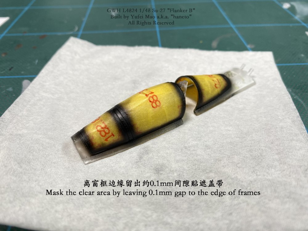

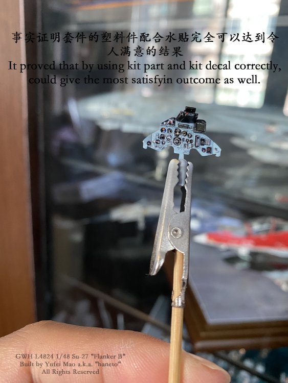

The inner side of both windshield and canopy.
I always like to switch the canopy from open to close time by time, so test fit the canopy closing status is very important.

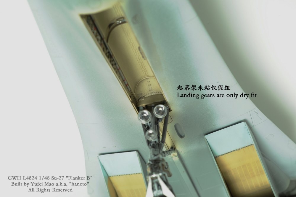

Engine intake and trunk.

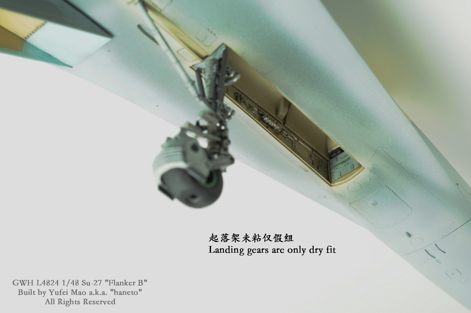

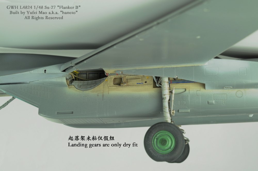

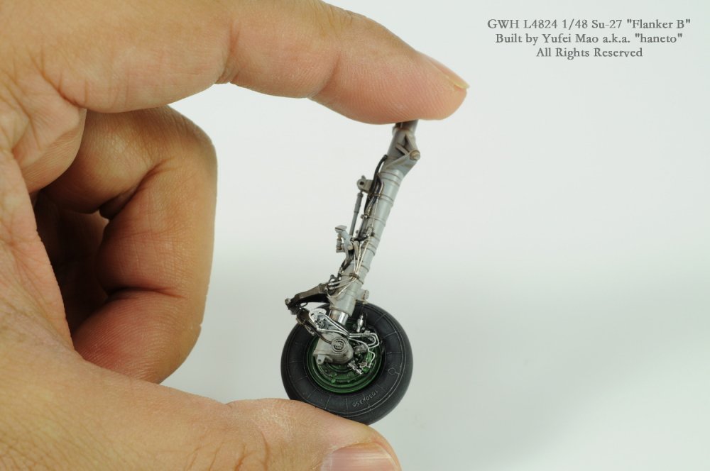

Now the Flanker is sitting by herself!

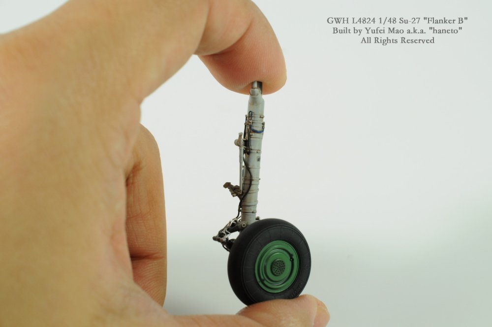

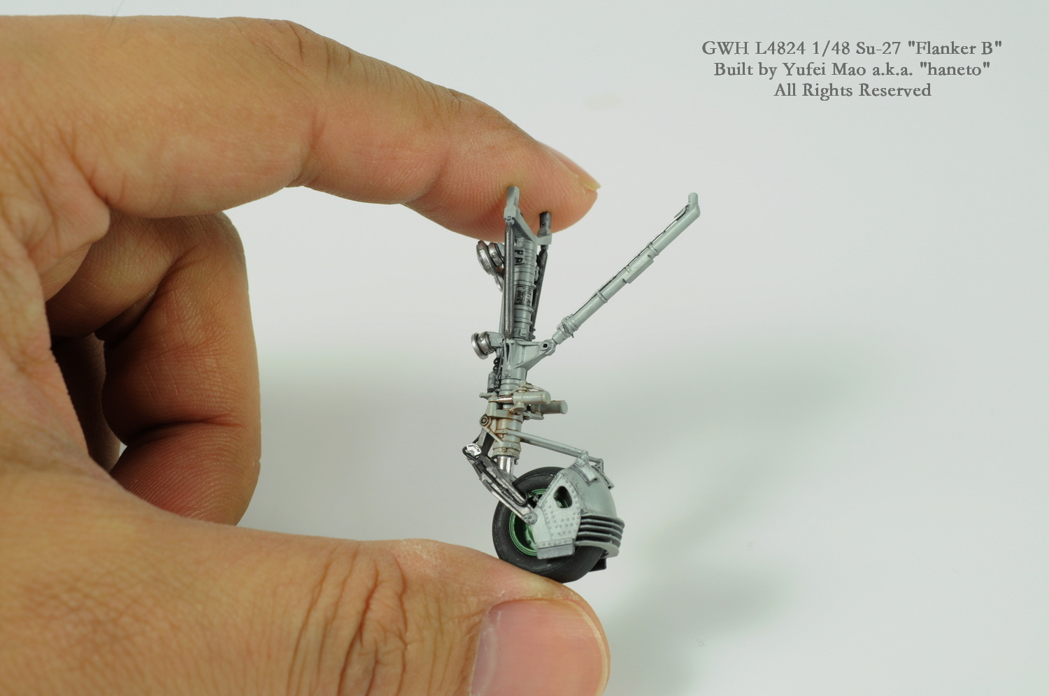

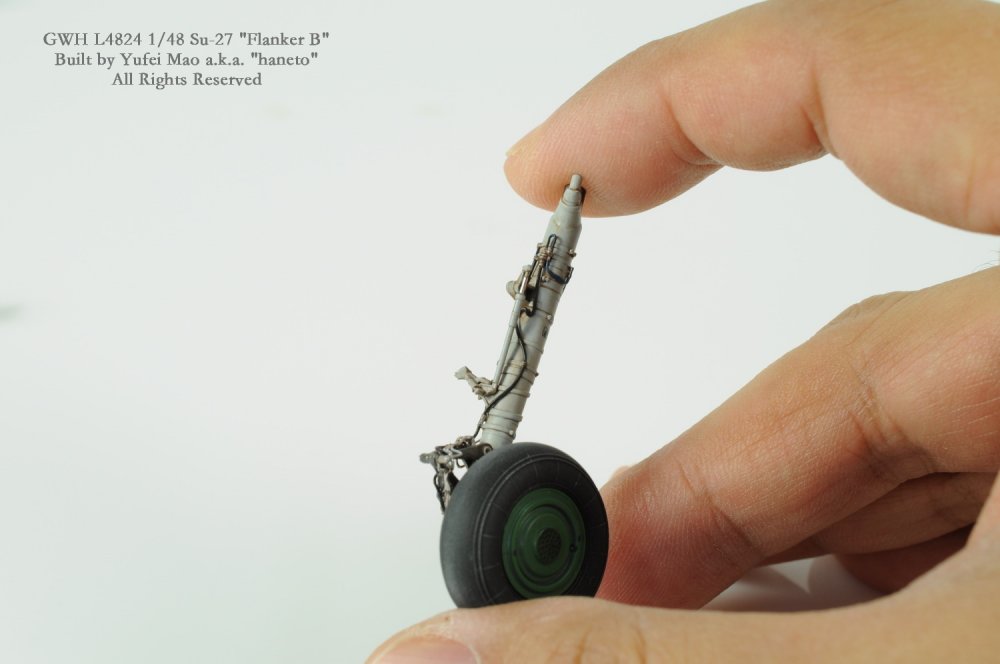

The D&W 3D print landing gears, thanks to the super strong engineering material and stainless rods inside, are more than strong to take all the weight from this beast!
