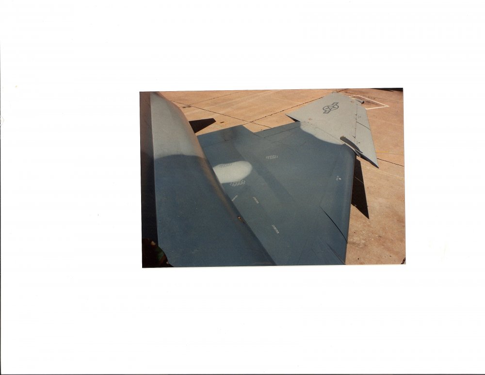

Drifterdon Posted December 30, 2021 Share Posted December 30, 2021 (edited) Question for the Phantom experten on the board. I have found some pics of Nebraska Air Guard RF-4C's and it almost appears that the black or very dark grey walkways are almost transparent. This is for birds painted in SEA early and wrap around camos. Was the anti-skid areas some kind of paint that was sprayed over the base camo and susceptible to wear? This seems to be on aircraft other than Nebraska planes. Examples can be found here. If you look closely between the dark tan and greens, you can see the tan showing through the walkway. Edited December 30, 2021 by Drifterdon Quote Link to post Share on other sites

BillS Posted December 31, 2021 Share Posted December 31, 2021 There were two methods of painting non skid on USAF F-4s. Aluminum oxide grit was one. Many USAF F-4s had the walkways applied but were consequently painted over leaving an uneven appearance. With time the walkway non skid wore unevenly. Here is an F-4E from the 704TFS late in life wearing a special scheme for Gunsmoke competition. You should be able to discern the faint outline of a walkway atop the intake. Quote Link to post Share on other sites
Drifterdon Posted December 31, 2021 Author Share Posted December 31, 2021 18 hours ago, BillS said: There were two methods of painting non skid on USAF F-4s. Aluminum oxide grit was one. Many USAF F-4s had the walkways applied but were consequently painted over leaving an uneven appearance. With time the walkway non skid wore unevenly. Here is an F-4E from the 704TFS late in life wearing a special scheme for Gunsmoke competition. You should be able to discern the faint outline of a walkway atop the intake. Thank you Bill for the information. I think this is exactly what I am seeing but from an angle it appears that the walkway was painted black. I'm wondering what could be done to replicate this on a 1/48 model kit. Was thinking of masking off the area of the walkway after painting the camo and shooting it with either a very thinned down black to just give a light darkening of the base paint or maybe try a layer or Tamiya Smoke to darken it. Quote Link to post Share on other sites
