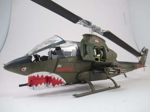

Gary posted the Revell Cobra he built in Vietnam so you can see that the flags are on top and some codes on the bottom:
51 yr. old 1/32nd AH-1G Cobra repair | Modelers Alliance
https://modelersalliance.org/threads/51-yr-old-1-32nd-ah-1g-cobra-repair.156231/post-370480

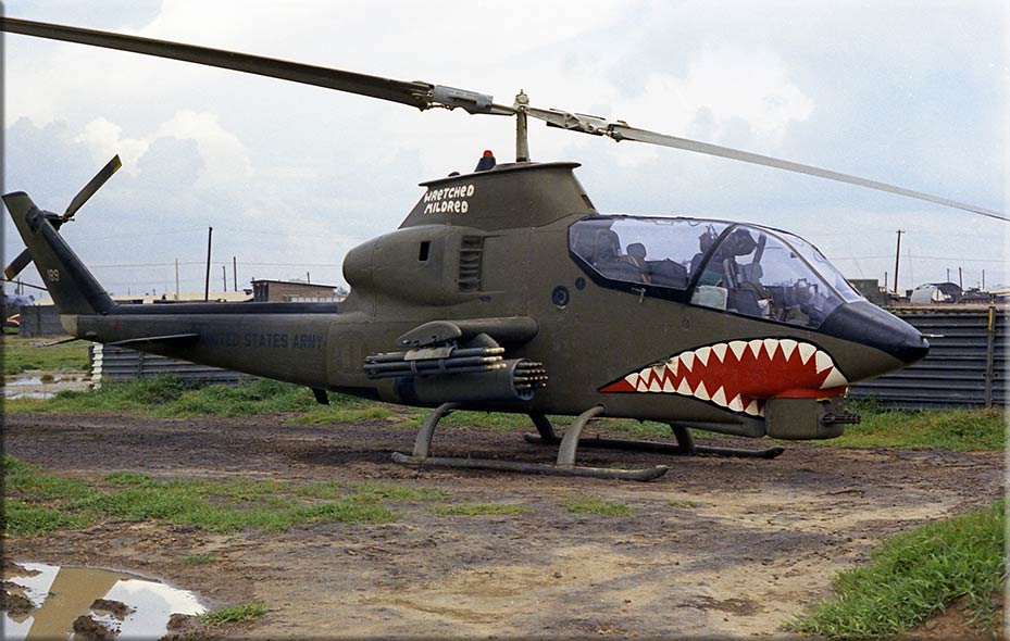

2 hours ago, top gun said:
... another question, what's the primer color of the Cobra befor the camo painting. At the factory... Zinc chromate ?
what is your opinion...

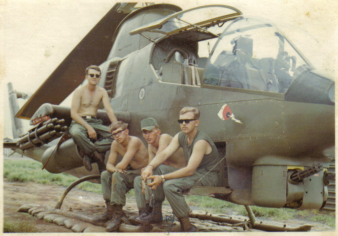

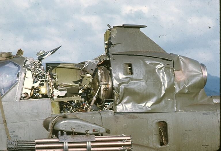

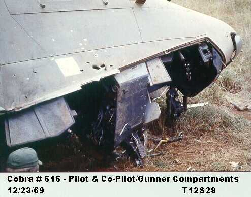

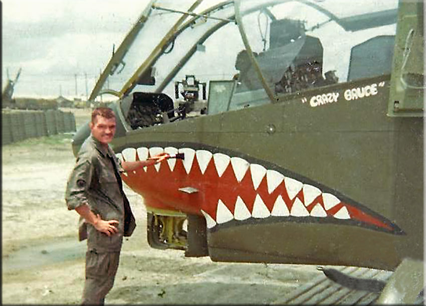

Since Gary maintained Wretched Mildred and there are many photos of Cobras under maintenance, opinions are useless when facts abound.  I am curious as to why you would use the primer prior to the camouflage?  If chipping, as popular as it is, I don't see that on the photos of the Cobras as they seem to be well maintained.  In particular, we have many images of Wretched Mary (see the Modelers' Alliance links I posted), some of her under maintenance, and I don't see chipping to the primer, do you?  There is chipping to bare metal on the stub wings on many photos though.1387343863_d008(3).jpg.2c4aded270719ad6062c89edc210cd1a.jpg
Impacts from ground fire and shrapnel

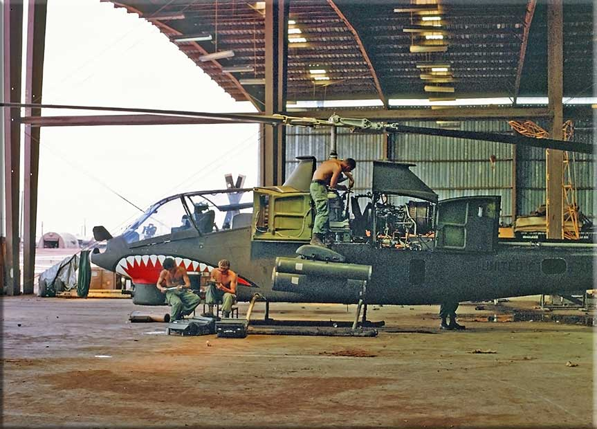

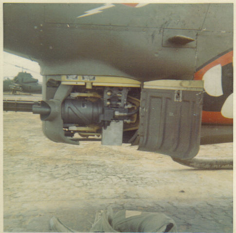

Nose turret panels off, you can see primer:

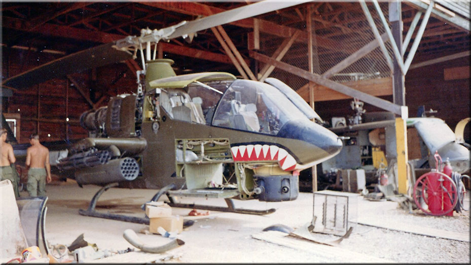

Rotor shaft tunnel panels open, see primer inside:
Hopefully, this answers your question.  Will you be posting in progress photos to see what you do with the responses provided?

32 minutes ago, Floyd S. Werner, Jr. said:
To answer your question, yes zinc chromate is the primer for the airframe.
  😆 Thanks Floyd,
After posting all those photos, I forgot to mention the color seen!

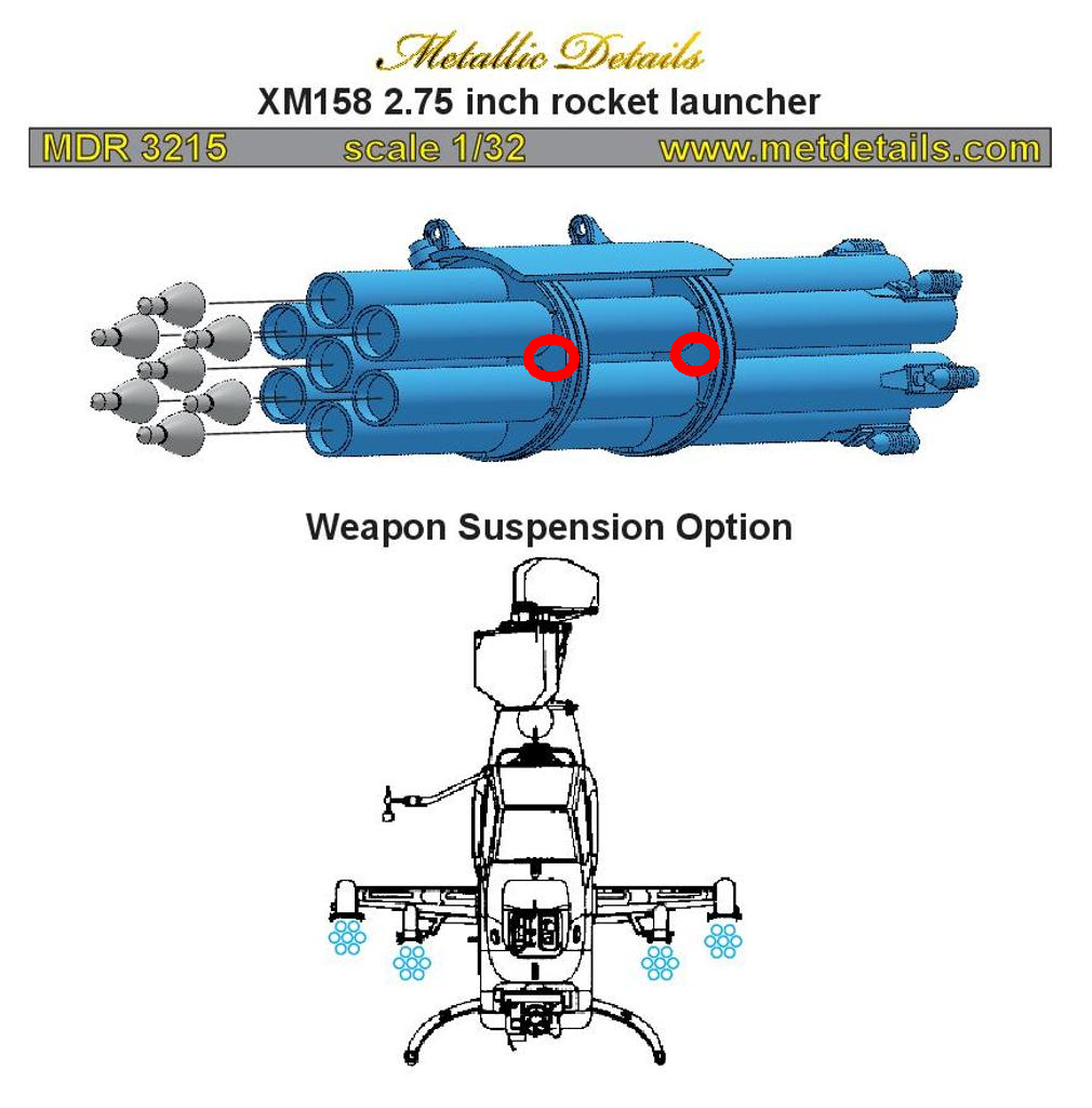

I’ve got the SH kit (3 of them actually), and while the resin XM-158 rocket launchers look great, I’m not to keen on them being in two pieces, front and rear.  You have to remove the parts from the casting blocks keeping the mating surface perfectly level, which is something I always have trouble with. It looks like Metallic Details has a 3D printed set with one piece tubes.
http://metdetails.com/catalog/metalic-details/aircraft/132/mdr3215-xm158-275-inch-rocket-launcher

Lightening holes are missing.
Not hard to drill I guess:

I ordered some of the Metallic Details sets off of eBay.  They make gun turrets, minigun pods, and all three rocket launchers.  On eBay, some sellers are offering combo packs.

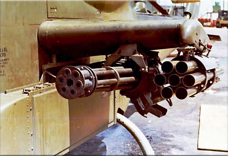

These are the older ones that were done with tubes.  I saw his resin ones and I suspect that they are even better than these.  I'll probably order some just for my other ICM kits.
