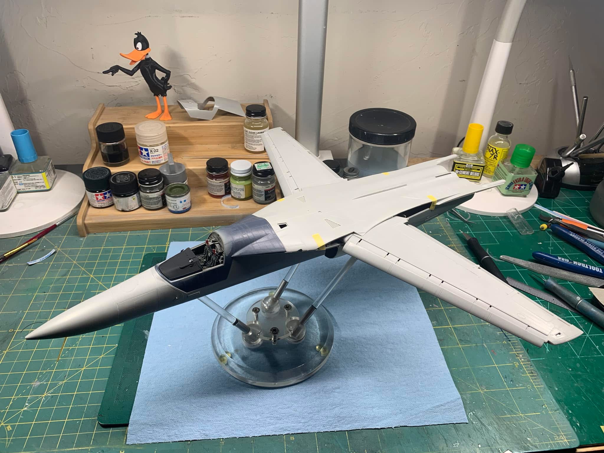

F-16 Posted March 6, 2025 Share Posted March 6, 2025 How's this? 1/48 Hobby Boss EF-111 Raven kit. "All hanging out"...LOL Scott CNJC-IPMS Quote Link to post Share on other sites

Gwen Phoenix Posted March 10, 2025 Share Posted March 10, 2025 On 3/5/2025 at 9:42 PM, F-16 said: How's this? 1/48 Hobby Boss EF-111 Raven kit. "All hanging out"...LOL Hi Scott, Yes, that's the idea I've got for my Vark kit (just the wings, not the electronics bay and radome). Also, how do you chums tell whether the ResKit escape module is resin cast vs 3D printed? Cheers, Gwen Quote Link to post Share on other sites

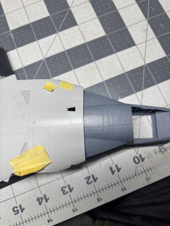

longmc Posted March 10, 2025 Share Posted March 10, 2025 1 hour ago, Bozothenutter said: Even weirder...where did you buy it? I bought my F direct, and the main part is definitely printed. (And dimensionally challenged) Here's a picture showing the size difference. I had to check double that I didn't order 1/72! I bought the F from eBay, but it arrived from Amazon. I bought the A directly from Amazon. I emailed Reskit, and they got right back to me, stating they know about the issue and offered replacement parts. Quote Link to post Share on other sites

RichB63 Posted March 10, 2025 Share Posted March 10, 2025 3 hours ago, longmc said: Here's a picture showing the size difference. I had to check double that I didn't order 1/72! I bought the F from eBay, but it arrived from Amazon. I bought the A directly from Amazon. I emailed Reskit, and they got right back to me, stating they know about the issue and offered replacement parts. “Honey I shrunk the Escape Capsule!” Yikes, how did that pass QC? Quote Link to post Share on other sites
cruiz Posted March 10, 2025 Share Posted March 10, 2025 In my limited experience with 3D printers, it seems that the part was scaled to fit the print area without someone noticing. Quote Link to post Share on other sites

longmc Posted March 11, 2025 Share Posted March 11, 2025 3 hours ago, ijozic said: Is that like an early batch problem or it's a very widespread issue? Better check mine, though I didn't jump on it at the first chance. Good question. They immediately responded to me and said it was a defect in the manufacturing process. They offered to send a new part right away. Like I said previously, the F-111F early cockpit I have is resin cast (it has a casting block on the rear of the capsule) and fits perfectly into the kit. I'm hoping it was a settings issue on the printer as it's too small in every dimension. Other than that, it's a beautiful part! The whole thing is a kit in itself, and every part has amazing detail. I'm considering ordering the 1/32 escape capsule kit now. Quote Link to post Share on other sites

Bozothenutter Posted March 12, 2025 Share Posted March 12, 2025 On 3/10/2025 at 4:08 PM, longmc said: Here's a picture showing the size difference. I had to check double that I didn't order 1/72! I bought the F from eBay, but it arrived from Amazon. I bought the A directly from Amazon. I emailed Reskit, and they got right back to me, stating they know about the issue and offered replacement parts. this pic isn't wholly truthfull, compared to mine, it seems to cover the first 2.2mm of the capsule Quote Link to post Share on other sites
longmc Posted March 13, 2025 Share Posted March 13, 2025 On 3/12/2025 at 3:34 AM, Bozothenutter said: this pic isn't wholly truthfull, compared to mine, it seems to cover the first 2.2mm of the capsule In the picture, the rear fuselage rests on the front cockpit's gluing/alignment tab. I can take another photo with a gap between the two if you suggest I faked the picture. Quote Link to post Share on other sites

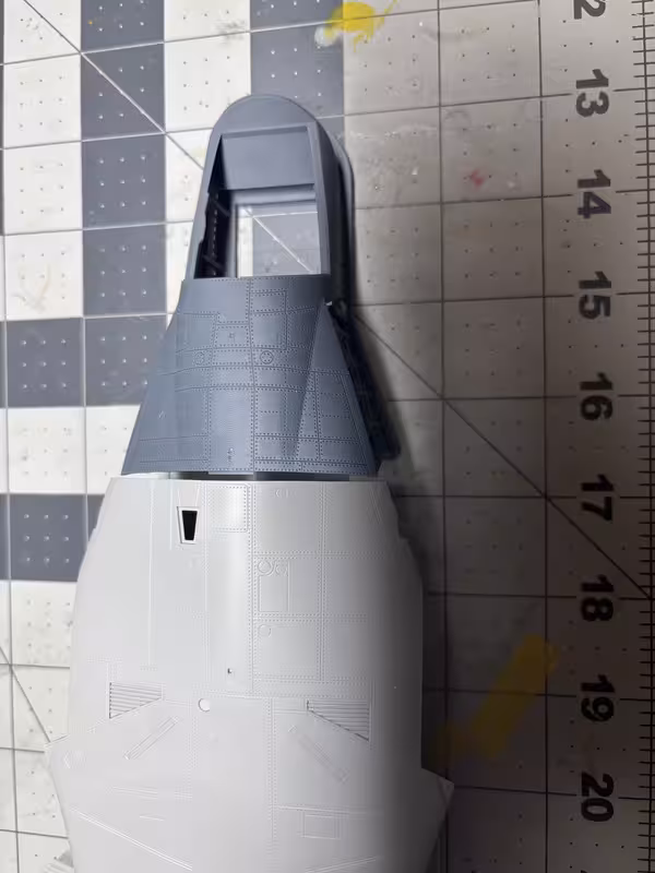

longmc Posted March 13, 2025 Share Posted March 13, 2025 (edited) These show the size difference better. Edited March 13, 2025 by longmc Quote Link to post Share on other sites

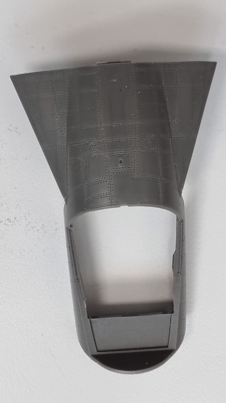

Bozothenutter Posted March 13, 2025 Share Posted March 13, 2025 1 hour ago, longmc said: In the picture, the rear fuselage rests on the front cockpit's gluing/alignment tab. I can take another photo with a gap between the two if you suggest I faked the picture. not suggesting you faked it, the pic is not showing part of the capsule though.. behold my favourite red arrows! Quote Link to post Share on other sites
longmc Posted March 13, 2025 Share Posted March 13, 2025 2 minutes ago, Bozothenutter said: not suggesting you faked it, the pic is not showing part of the capsule though.. behold my favourite red arrows! I see what you are saying, my apologies. My first picture, the capsule and fuselage are aligned at the top center, but angling towards each other so that area is covered. I took clearer photos, but they are not showing up for some reason. Quote Link to post Share on other sites
longmc Posted March 13, 2025 Share Posted March 13, 2025 (edited) Resin cast F-111F compared to the 3D printed A/E cockpit. Edited March 13, 2025 by longmc Quote Link to post Share on other sites
Bozothenutter Posted March 13, 2025 Share Posted March 13, 2025 euhhhh...ok, now I'm confused, apparently I have a 'cast' version, as mine has the flat dashboard shelf, not the diagonal one.🤯 But mine has all kinds of fit problems so far.....no 'click into place' for me..... Quote Link to post Share on other sites
