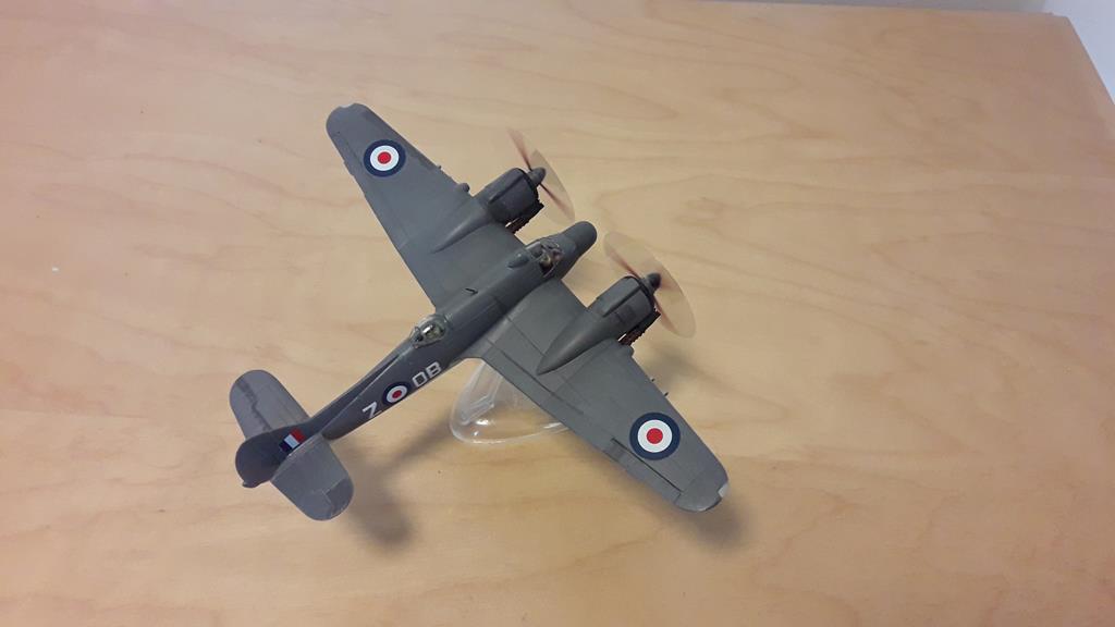

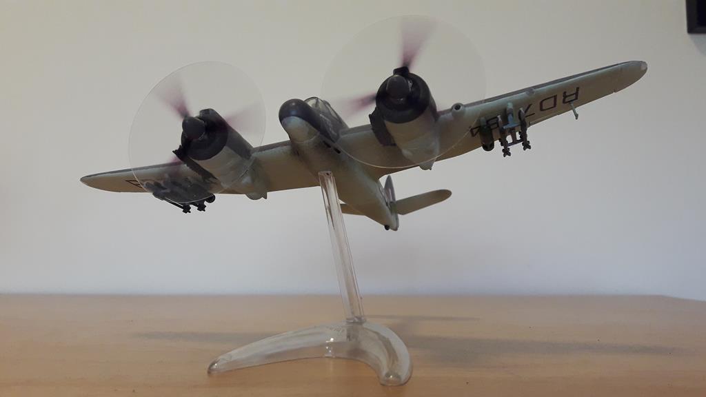

1/72 Matchbox Beaufighter TF.10 Operation Firedog
There were almost 6,000 Beuafighters built in WW2.   The RAF mainly retired theirs soon after the war except for target tug duties.   However, 2 squadrons - 45 and 84 - used them in the first few years of the Malayan Emergency (1948-1960 )when the Royal, and Royal Australian, Air Force waged war on communist terrorists.

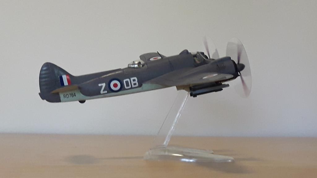

RD784 was named "Winnie the Pooh" and had been with 84 squadron but is depicted here after her transfer to 45 squadron.   The Beaufighters, with 4 20mm cannons plus 8 rockets and 2 bombs, must have been quite formidable ground attack machines but probably had a hard time finding their targets in the overgrown jungles of Malaya.
I replaced the poor Matchbox cowlings with ones from the Aeroclub set for the Lancaster B.II and carb intakes from a C-47, moulded a new rear canopy and scratchbuilt the stacked rocket rails that seem to be unique to these Operation Firedog Beaufighters.   The squadron codes were white paint masked with EZ-Mask lettering, the serials are off my inkjet and the name on the port nose is handpainted (poorly).  The problurs were made using artwork by James Perrin.    Her paint was pretty patched up towards the end of her time with 45 squadron.  I have tried to roughly represent her condition  rather than accurately reproduce it.
David

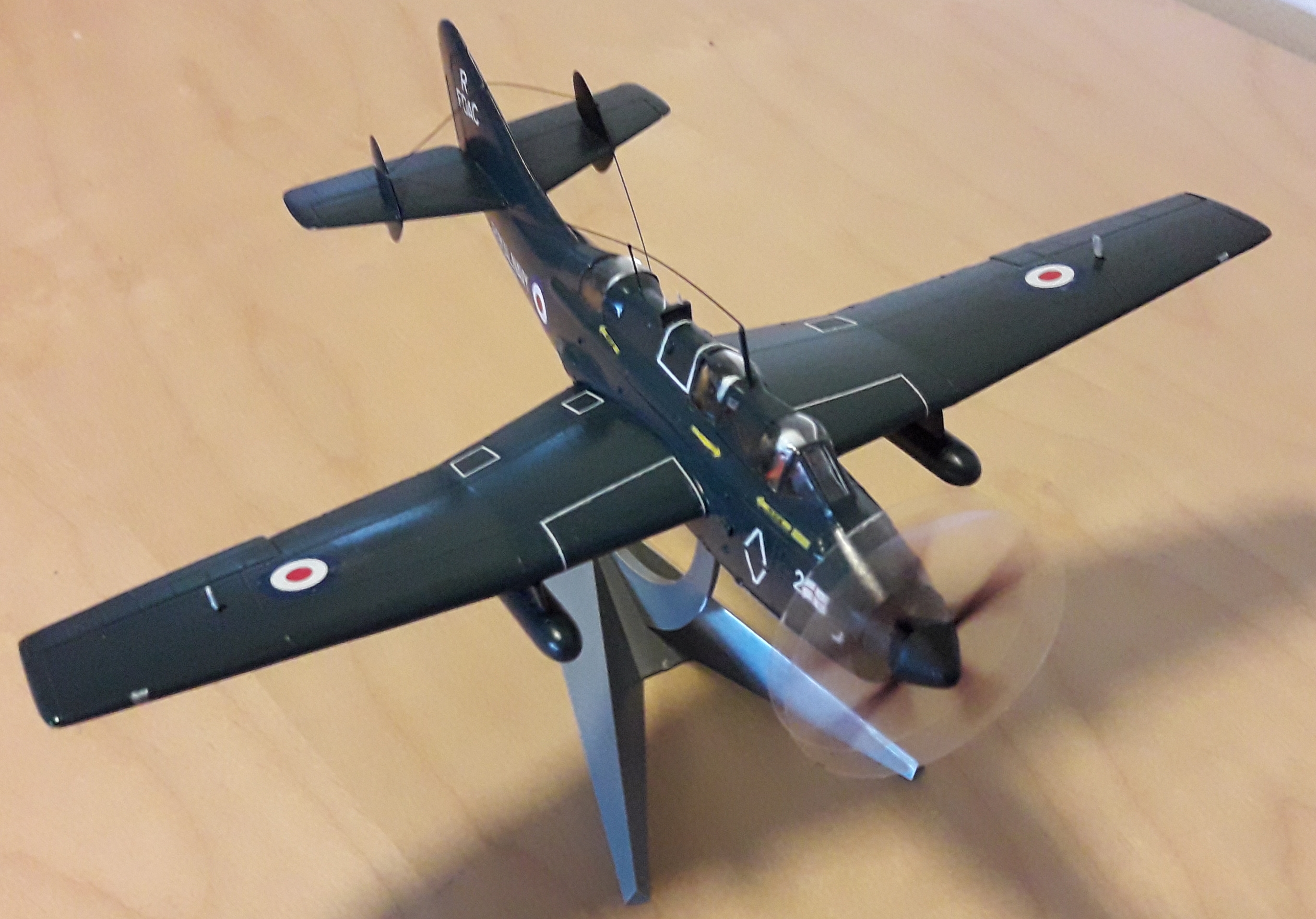

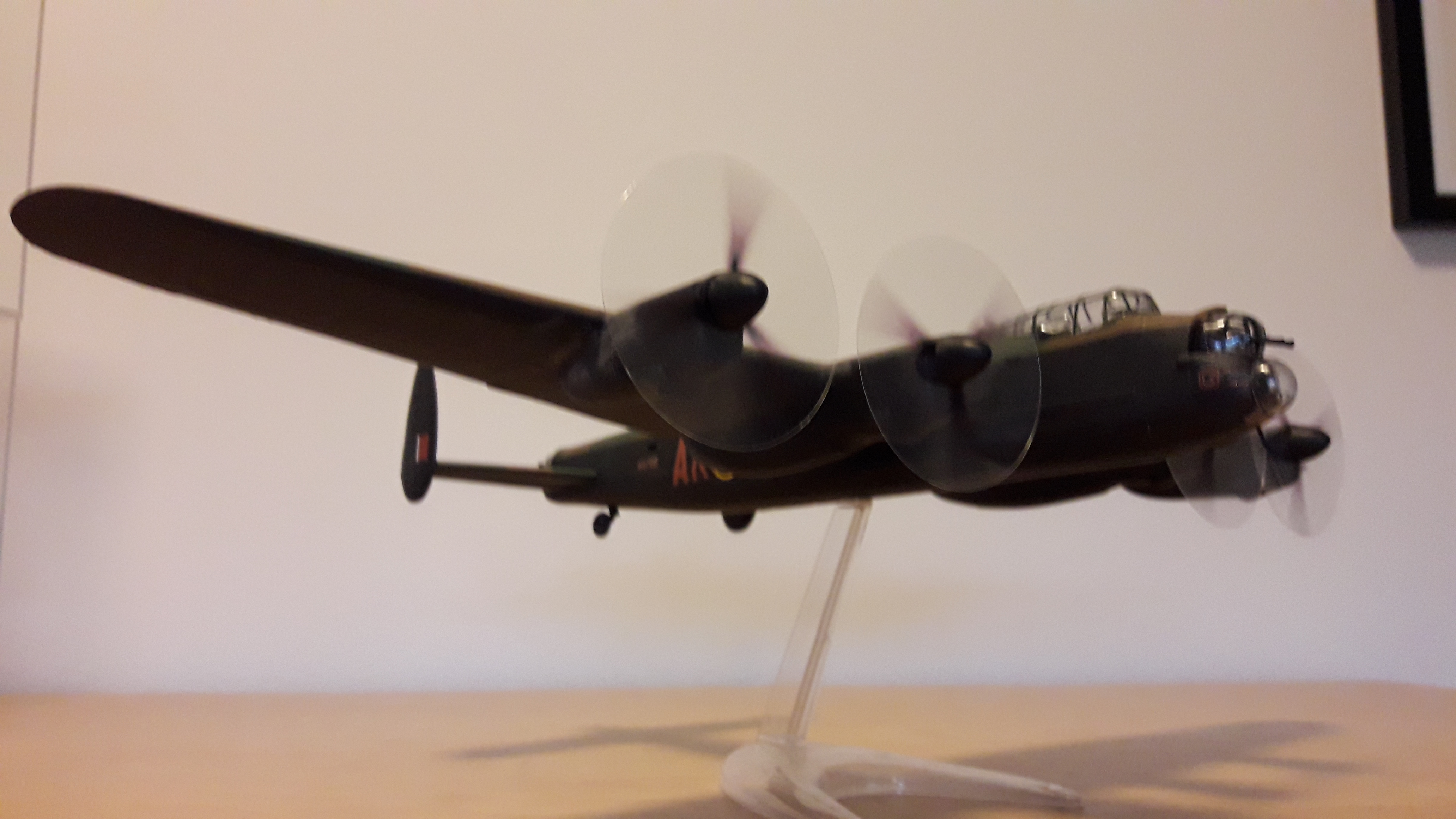

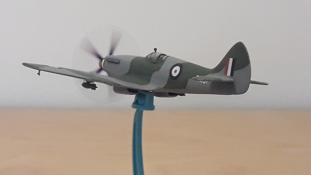

A word of warning - they look like a shiny disc if the light catches them.  The photos I take are angled to minimize that but in the display case, you will see it sometimes and they look a bit silly then.  Here's a few more examples of the propblurs.
