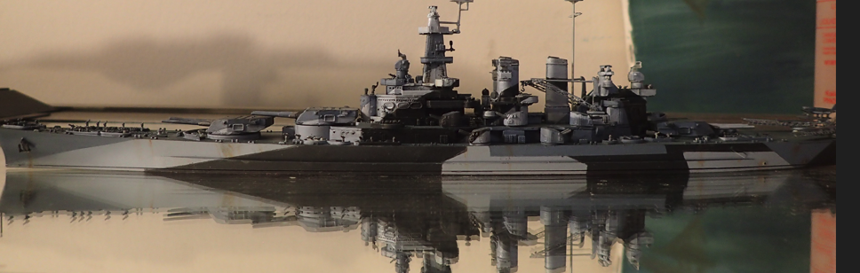

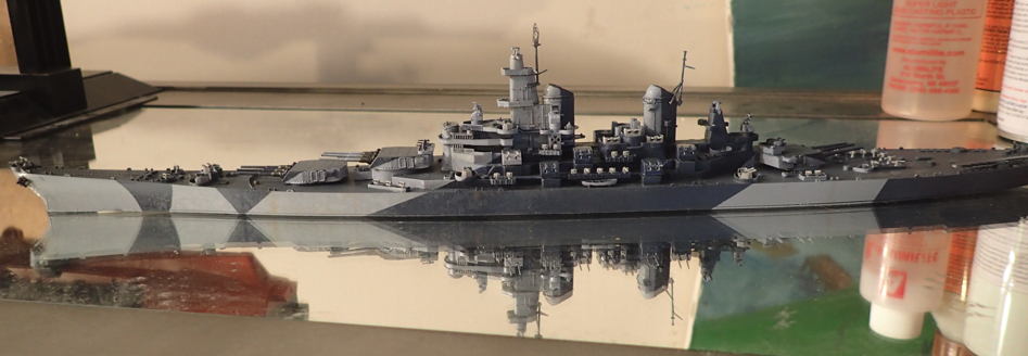

vvwse4 Posted February 22, 2022 Share Posted February 22, 2022 Hi everyone, The first ship I am building and it wil be a long term project, notice long.... That is how I want it to look in the end, not sure wether I make the blurred or straight lines on the hull. This is where I am right now, about 10 months after I started the build. So far the only part that is finished, number 1 turret PE and books, most of the fun is research Question what colours should be used fot the hull? Next question if I want to raise the guns on number 2 turret, looks less static I think, how do you make the blast bags? It will be a very long term job this one. Cheers Rick. Quote Link to post Share on other sites
Slartibartfast Posted February 26, 2022 Share Posted February 26, 2022 The dazzle looks like it’s been modified or repainted in-theater. You could keep the hard edges and probably be very close to the photo date. Quote Link to post Share on other sites

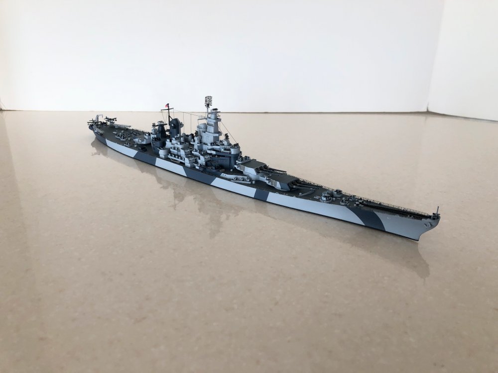

arg Posted February 20 Share Posted February 20 I completed a build of the Tamiya 1/700 Iowa. The Scale Colors paints of Light Gray/Navy Blue/Deck Blue were used (Black and Gray just seemed too drab). Used the Gold Medal photoetch for details, and Master Models barrels for the 16-inch guns. Quote Link to post Share on other sites
