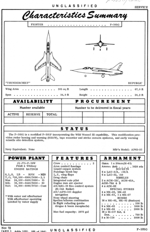

Finn Posted March 8 Share Posted March 8 Here are some specs on the F-105G, the F would be the same: http://www.alternatewars.com/SAC/F-105G_Thunderchief_CS_-_November_1972.pdf The F-105F was used in combat in Vietnam so there is no reason why it would not be used to carry nukes if the situation arose. Jari Quote Link to post Share on other sites

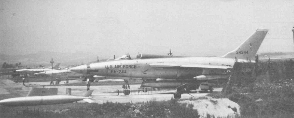

Susaschka Posted March 17 Author Share Posted March 17 Thanks guys. Range wise a nuke on one wing pylon and a fuelltank on the other one together with an internal and centerline fueltank would give the F-105 more range, but I don't know if this was done at Spangdahlem. I do know nukes were carried on wing pylons under F-105's on Victor Alert stationed in Japan, together with a centerline fueltank as can be seen below. Quote Link to post Share on other sites

11bee Posted March 31 Share Posted March 31 On 3/17/2022 at 10:07 AM, Susaschka said: Thanks guys. Range wise a nuke on one wing pylon and a fuelltank on the other one together with an internal and centerline fueltank would give the F-105 more range, but I don't know if this was done at Spangdahlem. I do know nukes were carried on wing pylons under F-105's on Victor Alert stationed in Japan, together with a centerline fueltank as can be seen below. Nice picture, you don't see many shots from that era of jets fitted with live weapons. I'm guessing who ever took this picture was taking some serious risks. Quote Link to post Share on other sites
jenshb Posted April 1 Share Posted April 1 Considering that the shapes of US Nuclear bombs was classified until 1977 or thereabouts, the person would be in a world of trouble if caught taking that photo... Quote Link to post Share on other sites
Rob de Bie Posted April 1 Share Posted April 1 On 3/17/2022 at 3:07 PM, Susaschka said: Thanks guys. Range wise a nuke on one wing pylon and a fuelltank on the other one together with an internal and centerline fueltank would give the F-105 more range, but I don't know if this was done at Spangdahlem. I do know nukes were carried on wing pylons under F-105's on Victor Alert stationed in Japan, together with a centerline fueltank as can be seen below. I have trouble recognizing what weapon it is, B28 would be my best guess because of the nose details. But I don't know whether that fits the time and whether it's an authorized F-105 load. Anyone know? Rob Quote Link to post Share on other sites
Susaschka Posted April 2 Author Share Posted April 2 According to the link Murph supplied, the F-105 was eventually certified to carry the MK-28, MK-43, MK-57 and Mk-61 nuclear bombs, but I'm also not sure which one is loaded. Quote Link to post Share on other sites
Rob de Bie Posted April 2 Share Posted April 2 I built the Belcher Bits 1/48 B28EX and RE, and the nose details agree with the photo I think. Rob Quote Link to post Share on other sites

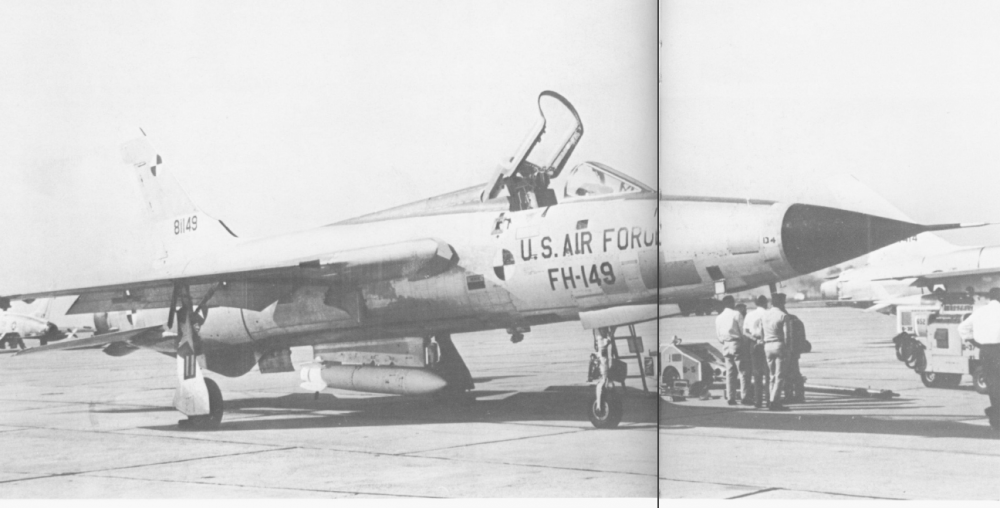

Susaschka Posted May 27 Author Share Posted May 27 Found some additional pictures of F-105's with centerline nukes in the Osprey Air Combat F-105 Thunderchief book: With Mk.28: With BDU-8: It also states: Knowing the above, I might go for 3 droptanks and 2 Mk.43-0 for my F-105D and 2 droptanks and a centerline Mk.28RE for my F-105F. Quote Link to post Share on other sites
Finn Posted May 27 Share Posted May 27 3 hours ago, Susaschka said: Knowing the above, I might go for 3 droptanks and 2 Mk.43-0 for my F-105D and 2 droptanks and a centerline Mk.28RE for my F-105F. You can't have 3 drop tanks and 2 Mk43s, pylons have a weight capacity, c/l and inboard ones can carry a good size load, the outboards are limited in stores weight. Scroll down to pg 8 & 9 here: http://www.alternatewars.com/SAC/F-105D-31_Thunderchief_SAC_-_June_1970.pdf to see what can go where. Jari Quote Link to post Share on other sites
Susaschka Posted May 28 Author Share Posted May 28 (edited) Thanks Jari! Looks like the info in the Osprey Air Combat F-105 Thunderchief book is not accurate, as they are clearly stating the F-105D and F models could be loaded with 4 Mk.28's or Mk.43's. However now that I think about it, I don't think F-105's could carry a nuke in the bomb bay and centerline at the same time. I think they probably meant that there were 4 "stations" that could take these, but not at the same time. So it's going to be: - 2 droptanks and a centerline Mk.43-0 for my F-105D; - 2 droptanks and a centerline Mk.28RE for my F-105F; - 2 droptanks and a centerline Mk.28EX for my F-100D. All pylons not in use will not be mounted. These slightly different loadouts should be interesting to see and accurate enough for my purpose. Edited May 28 by Susaschka typo Quote Link to post Share on other sites
