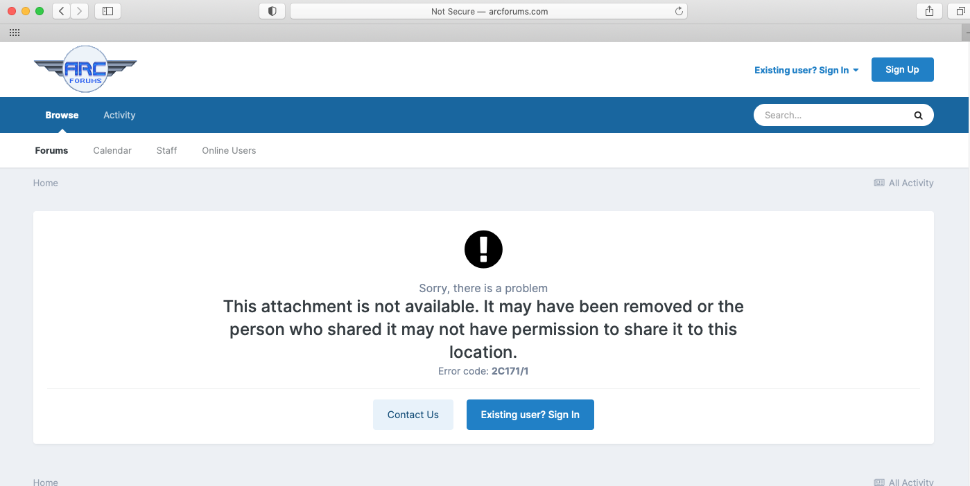

Um ... your images don't show up ... this is what I get ...
1029482667_ScreenShot2022-04-22at5_34_55PM.thumb.png.ee08147ca93633c2805b2272bcaee635.png

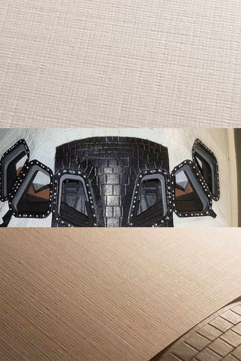

Sanding the wings and fuselage today. Not very exciting picture-wise. I did cut the control surfaces away from the wings to pose them in a drooped look based on pictures I found online of Atlantis being rolled over prior to STS-71. Do have a question because I tried searching but didn't come up with anything - to simulate the thermal blankets I am going to experiment with white "linen texture paper" that I found at Michael's. It's cardstock material. I know it's not an original idea to me, and I know I've seen that idea talked about somewhere, but as I said, searching these forums didn't produce any good results. Anyone else try this? Or know of someone who did that I could refer to? Thanks!

since i want to build the same model (one and one only) i came to the same solution. I`ve seen it done by someone else before, can`t find it at the time.
Looked at alot of paper and found Papyrus Linen here in Europe to be an adequate match..looks better in person imho. The problem will be the seams around them (maybe white glue or putty and modelling in the wrinkles?)
btw: one hell of a task, your project. Homers parts alone are quite tricky to clean and paint, not to mention to fit them into the monogram or revell models...

That papyrus linen looks really good. Maybe even more of an obvious texture pattern than my linen texture version. The seams are also challenging me. There isn't a true border or separation around each blanket section, but if you look at an orbiter close up, you can see a obvious line of demarcation between one area and the next. I was thinking that maybe a tracing wheel could make an indentation around the edge of each square that I cut. Maybe it'd create the appearance of the joint between each blanket.141252355_AtlantisSide.thumb.jpeg.b4996a4045c4bd0d40693e03c633ecbd.jpeg
