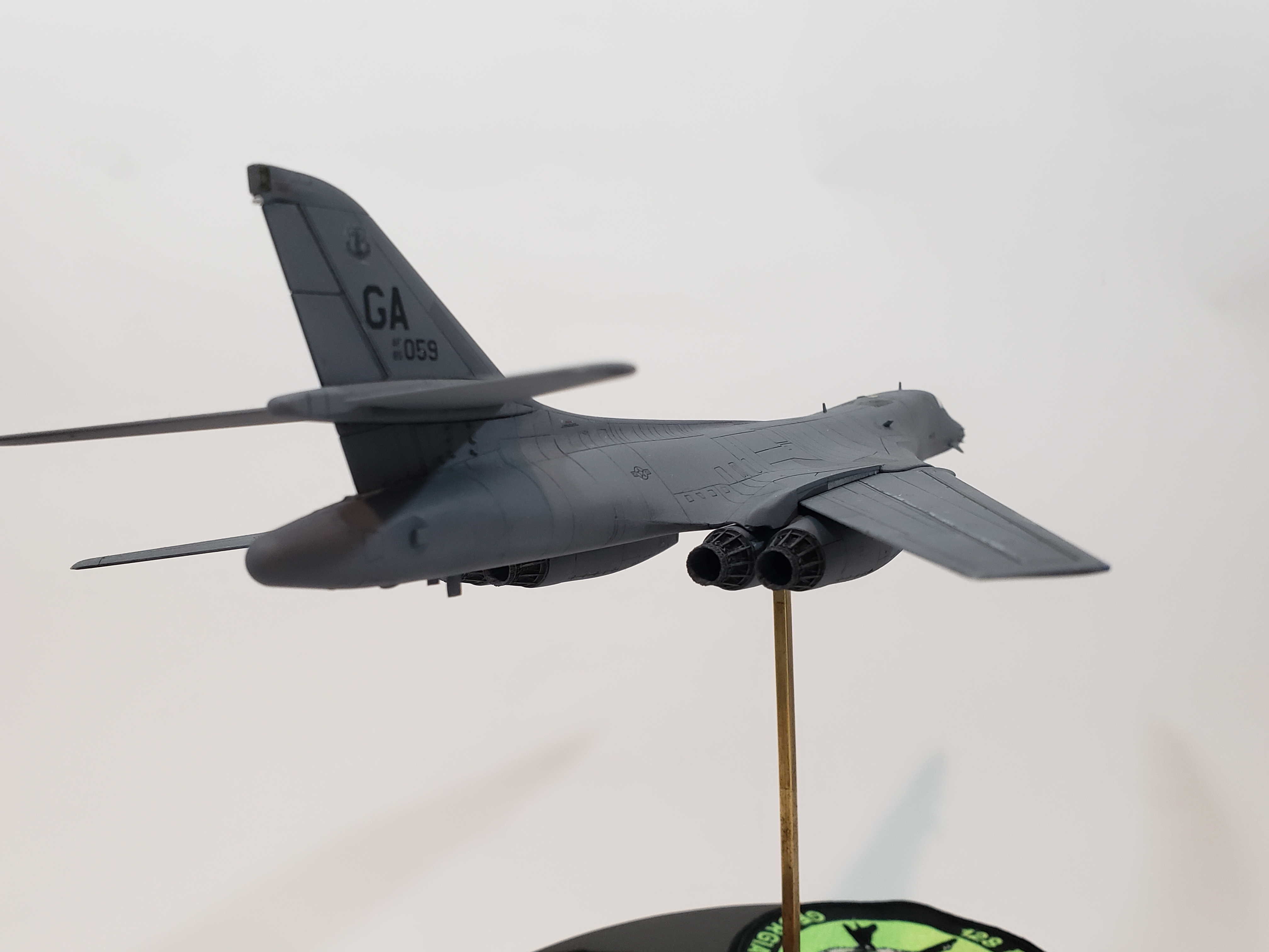

Gator52 Posted April 26, 2022 Share Posted April 26, 2022 With Caracal 144025 coming soon, I've been thinking about what's involved with backdating the Academy B-1B to the SAC era. Here's what I've got so far: - Omit targeting pod & fill opening - Omit towed decoy fairings and fill openings - Remove ALQ-161 DAS fairing from underside of aft fuselage, add original blade-type antennas - Replace late exhausts with original turkey-feather exhausts (any options yet? Didn't see any on Scalemates) - Nuc mission loadout: use kit bay tank, SRAMs from Crown/Minicraft B-52H...any 1/144 B61s or B83s out there? Would need to come up with rotary launchers. Not sure about the antennas on the upper fuselage; I'm thinking the round flush-type ones may need to go, but more research is needed. Thoughts? Chris Quote Link to post Share on other sites
RCarlson Posted April 28, 2022 Share Posted April 28, 2022 (edited) That sounds about right Chris. I haven't seen any turkey-feather exhausts out their yet, but I'm sure they will come along. When I was making my Georgia ANG Bone I didn't realize until I was to the point of decaling that this plane didn't have the towed decoys or ALQ-161, so I had to do some late surgery. Pretty sad considering I had photos of the plane in front of me! Edited April 28, 2022 by RCarlson Quote Link to post Share on other sites
Gator52 Posted April 30, 2022 Author Share Posted April 30, 2022 Turned out really nice; did you have drawings to help with the ECM blade antennas, or did you eyeball it? Chris Quote Link to post Share on other sites
RCarlson Posted April 30, 2022 Share Posted April 30, 2022 Just eyeballed from photo's. I think the Daco book had a shot of the bottom, but I would have to check again. Ron Quote Link to post Share on other sites

HOLMES Posted May 3, 2022 Share Posted May 3, 2022 Chris , That looks SUPERB from here. any more pics? thank you. Quote Link to post Share on other sites
