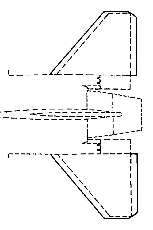

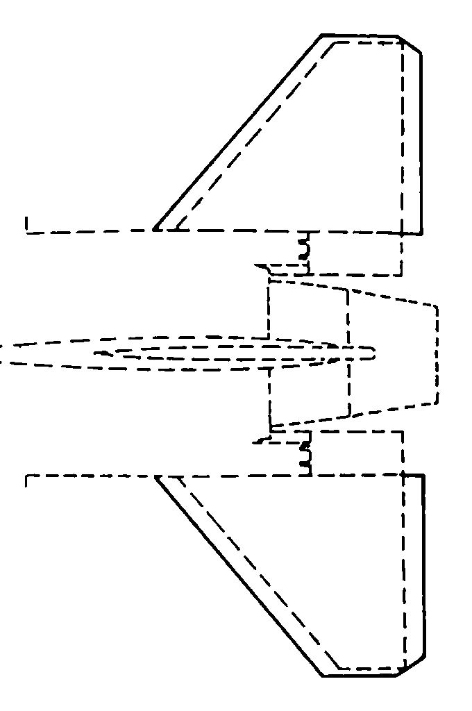

habu2 Posted January 4 Share Posted January 4 On 12/22/2022 at 11:37 AM, habu2 said: If you only want the small tail stabs just cut down the big tail stabs in your (insert manufacturer name here) kit. Drawings are readily available on the 'net... Quote Link to post Share on other sites
JeffreyK Posted January 6 Share Posted January 6 On 1/5/2023 at 5:19 AM, habu2 said: Where is this drawing from and is it reliable? I thought only the trailing edge was extended... J Quote Link to post Share on other sites
jenshb Posted January 6 Share Posted January 6 The leading edge was extended as well - the original stab lines up with a panel line on the upper fuselage - the larger stab extends approximately to the lights. Then it is just a matter of cropping the span to eliminate the chamfered trailing edge and sand the leading and trailing edges sharp. Quote Link to post Share on other sites
JeffreyK Posted January 6 Share Posted January 6 1 hour ago, jenshb said: The leading edge was extended as well - the original stab lines up with a panel line on the upper fuselage - the larger stab extends approximately to the lights. Then it is just a matter of cropping the span to eliminate the chamfered trailing edge and sand the leading and trailing edges sharp. Thank you! That is of course on the premise that the kit ones are accurate 🙂 I already found differences between Tamiya and Kinetic there...slight variation in leading edge sweep angle and a very different anchor/pivot point position... J Quote Link to post Share on other sites

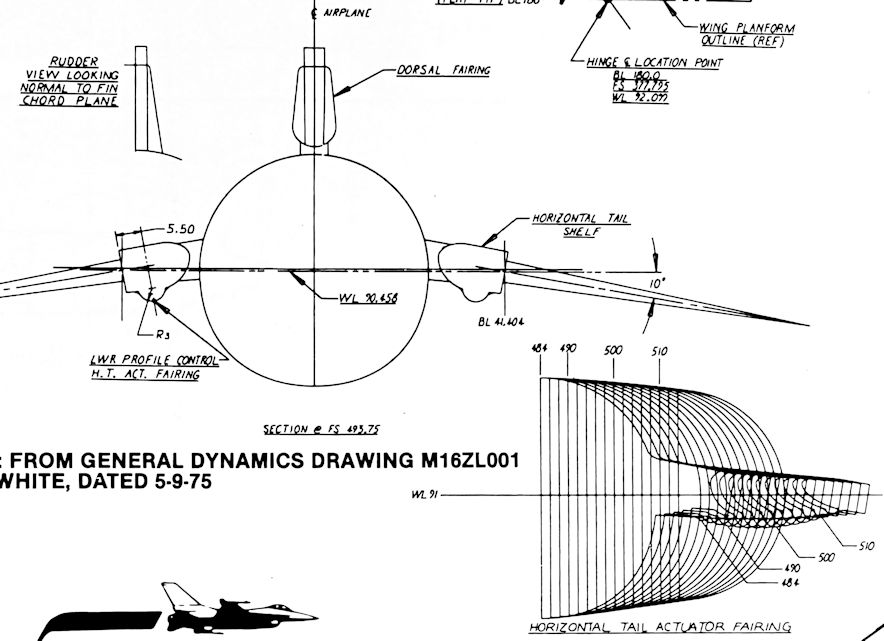

habu2 Posted January 6 Share Posted January 6 (edited) 7 hours ago, JeffreyK said: Where is this drawing from and is it reliable? I thought only the trailing edge was extended... J I think it's from the old Detail & Scale book. From an aerodynamic load standpoint you need to keep your area moments roughly equal about the pivot axis. The outer rear corner was clipped to provide approximately the same ground clearance in a nose-up stab-up configuration. . Edited January 6 by habu2 semantics Quote Link to post Share on other sites

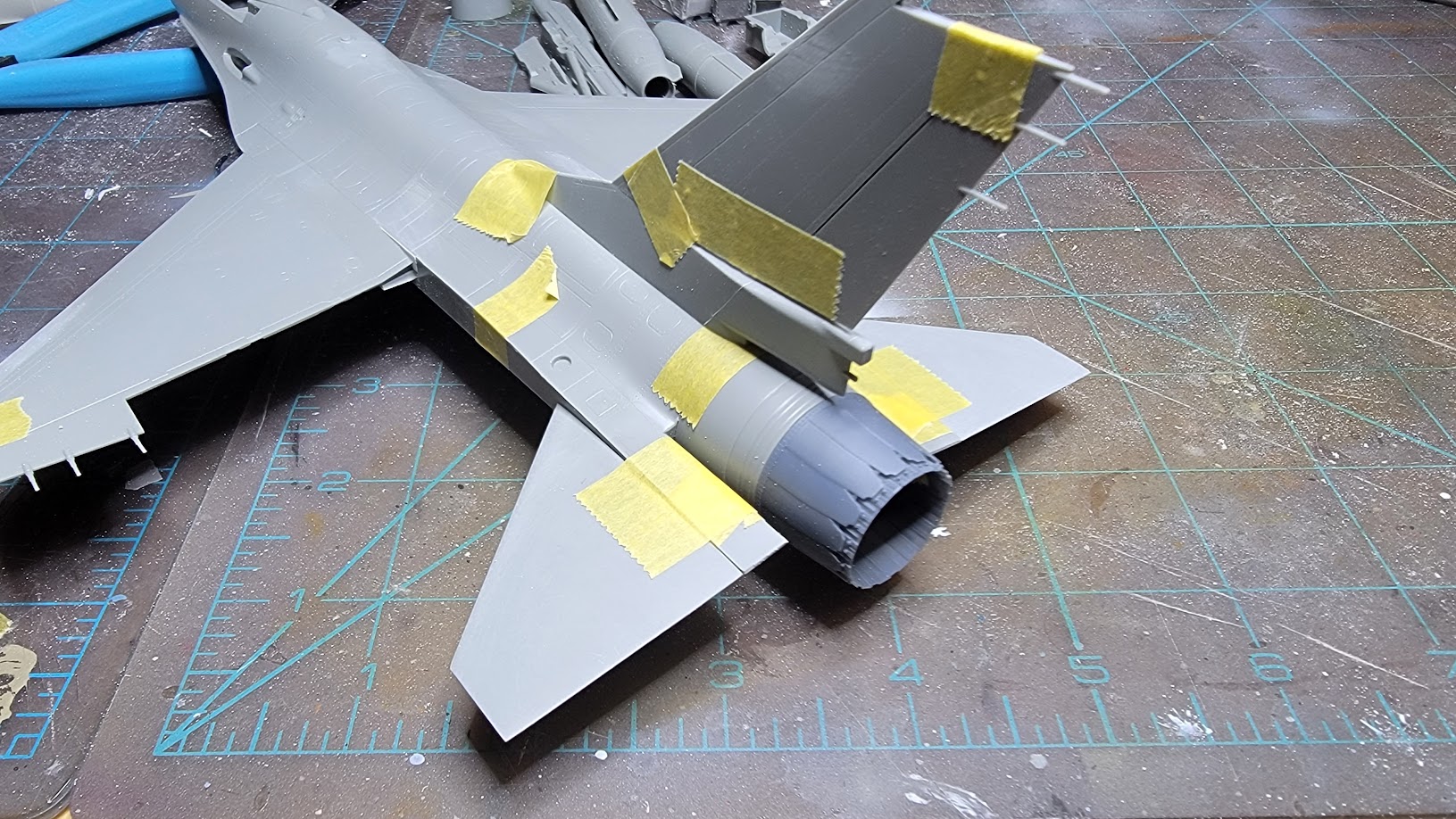

sigtau Posted January 7 Share Posted January 7 I received the first of my three copies of the F-16C kit and dug into it immediately. My goal is to build a block 10 bird from the NY ANG during Desert Storm. Most of those block 10 mods of the kit parts went fine, but I still have to pick through references to make panel line and smaller detail fixes. There are two aftermarket horizontal stabilizers replacement sets that you could try to start from, Quickboost and Wolfpack. I happen to have both, and to make a long story short, neither is a quick solution. Neither appear to have properly reduced the cord length. And neither of them have trailing edges that align with the speed brakes correctly. I gave up on those sets and just modified the kit parts. As for the cuts to make, I used the top view from the Bullseye DS viper decal sheet for the Block 10. Based on those measurements and estimates from photos, I arrived at ~1.6825" for the root cord length and ~0.5200" for the wingtip cord length. I squared off the aft edge first, then hacked off the leading edge based on those dimensions. Some impressions of the kit: - Surface detail is very crisp, on par or better than the Tamiya kit. - Fit is fair to good. It is a little clumsy in a few places (like the lower engine cover part that's molded separately). - Kit exhaust nozzle is OK. I ended up testing every resin PW F-16 set I had. The Reskit set for the Hasegawa kit fits into the kit shroud with just a slight modification. - The cockpit is not very detailed. The tub is OK, but the seat and cockpit sill parts are very poorly detailed. I would say it's just slightly better than the old Hasegawa F-16 kit in this area. - Wheel bays are nice, other than a few ejector pin marks on the main gear bay parts. - Flap down position appears to be fore full flaps. Most of the time they are parked with ~15 degrees of down flap in reference photos. - Crazy amount of ordnance, most of which won't be used. I'm probably going to shelve it for now to see what kind of aftermarket sets come out to address the sparsely detailed cockpit situation. Ken Quote Link to post Share on other sites

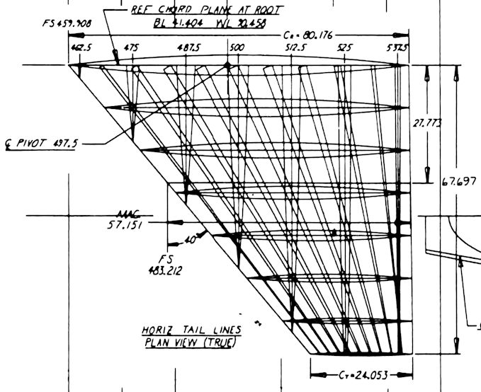

habu2 Posted January 8 Share Posted January 8 On 12/22/2022 at 11:37 AM, habu2 said: If you only want the small tail stabs just cut down the big tail stabs in your (insert manufacturer name here) kit. Drawings are readily available on the 'net... These should be accurate enough: Quote Link to post Share on other sites
JeffreyK Posted January 8 Share Posted January 8 8 hours ago, habu2 said: These should be accurate enough: ...the weird thing is that the construction data (root chord, tip chord, span and 40° leading edge sweep) doesn't actually line up geometrically, unless the trailing edge is not totally perpendicular (90°) to the centreline (although all indications point to that being the case...), or the tip chord shorter or the root chord longer... J Quote Link to post Share on other sites
habu2 Posted January 8 Share Posted January 8 3 hours ago, JeffreyK said: ...the weird thing is that the construction data (root chord, tip chord, span and 40° leading edge sweep) doesn't actually line up geometrically, unless the trailing edge is not totally perpendicular (90°) to the centreline (although all indications point to that being the case...), or the tip chord shorter or the root chord longer... J I'm not sure I understand your concern. If I use the dimensions provided in the drawing and do the trig, the leading edge sweep comes out to 39.7 degrees, a difference of less than 1%. The difference could be explained if the 40 degree sweep is the projected sweep angle at 10 deg anhedral, although I admit that seems a strange way to dimension the drawing. If I could get to <1% accuracy when modifying a 1/48 kit part I'd be absolutely thrilled..... Quote Link to post Share on other sites
Crash Test Dummy Posted January 8 Share Posted January 8 4 hours ago, JeffreyK said: ...the weird thing is that the construction data (root chord, tip chord, span and 40° leading edge sweep) doesn't actually line up geometrically, unless the trailing edge is not totally perpendicular (90°) to the centreline (although all indications point to that being the case...), or the tip chord shorter or the root chord longer... J The trailing edges isn't perpendicular to the centerline. There are fuselage stations lines marked off every 12.5 inch in the drawing. These are aligned with my phone screen when I zoom in. The trailing edges is not and has a slight aft sweep. Quote Link to post Share on other sites
habu2 Posted January 8 Share Posted January 8 Full disclosure: this isn't from a scanner, the image was captured by my cellphone camera from a reference book (Aerofax) at a distance of ~40", as close to orthogonal as I could eyeball it, then cleaned up (contrast, monochrome, straightened) on my laptop before uploading. Quote Link to post Share on other sites
JeffreyK Posted January 9 Share Posted January 9 (edited) 10 hours ago, habu2 said: I'm not sure I understand your concern. If I use the dimensions provided in the drawing and do the trig, the leading edge sweep comes out to 39.7 degrees, a difference of less than 1%. The difference could be explained if the 40 degree sweep is the projected sweep angle at 10 deg anhedral, although I admit that seems a strange way to dimension the drawing. If I could get to <1% accuracy when modifying a 1/48 kit part I'd be absolutely thrilled..... My concern is that when I do something I want to do it as best and as accurately as I can 🙂 And if I find a discrepancy I want to find the cause for it. I would not alter the leading edge sweep - 40° is stated in pretty much every document so I don't think there is +/- wiggle room on that. Now, surprisingly, the drawing from the Aerofax book lines up nearly perfectly with what the geometry I had produced with the figures (also supported by real-world measurements as well). Most importantly, it lines up with a trailing edge that is very slightly swept!! So not dead-perpendicular. (What is also apparent is that Tamiya's (large) stab is dead on as per measurements and angles (perfect 40° sweep) while Kinteic's is not quite right, the sweep is slightly larger and also the stabilator pivot or anchor point is too far aft on the Kinetic kit. Tamiya has that correct as well.) J Edited January 9 by JeffreyK Quote Link to post Share on other sites

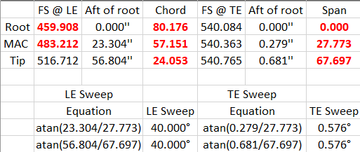

Steve McArthur Posted January 9 Share Posted January 9 So I got bored and did some math. Red numbers are defined by the drawing @habu2 included. I used the coordinates for the MAC location to determine the leading edge sweep, then use that to calculate the leading edge Fuselage Station of the tip chord. Using the MAC and Tip chords I calculate the locations of the trailing edge and then calculate the trailing edge sweep at both of these points. All the numbers worked out consistent with the drawing and gave consistent answers for the trailing edge sweep at both the MAC and tip locations. One thing to keep in mind this is all looking down in the plan view for the airplane. This doesn't account for the anhedral they are mounted with. This means the horizontal surfaces are about 1.5% wider that the dimensions given in the image. 67.697/cos(10) = 68.741" This should be what you would get if you measured the tail with a tape measure from root to tip. Quote Link to post Share on other sites
JeffreyK Posted January 9 Share Posted January 9 3 minutes ago, Steve McArthur said: So I got bored and did some math. Red numbers are defined by the drawing @habu2 included. I used the coordinates for the MAC location to determine the leading edge sweep, then use that to calculate the leading edge Fuselage Station of the tip chord. Using the MAC and Tip chords I calculate the locations of the trailing edge and then calculate the trailing edge sweep at both of these points. All the numbers worked out consistent with the drawing and gave consistent answers for the trailing edge sweep at both the MAC and tip locations. One thing to keep in mind this is all looking down in the plan view for the airplane. This doesn't account for the anhedral they are mounted with. This means the horizontal surfaces are about 1.5% wider that the dimensions given in the image. 67.697/cos(10) = 68.741" This should be what you would get if you measured the tail with a tape measure from root to tip. Thanks for that 🙂 Woking it geometrically in CAD (and at slightly rounded, scale converted figures) I get 0.6° sweep so in accordance with your calculation. While one drawing I took from a manual is showing the stabs in their downward projection view (i.e. with anhedral, span forshortened), the drawing posted above is an actual size representation, not forshortened. Also, all measurement figures given above (and in other drawings), except for the butt line where the root is located, are the dimensions of the flattened, actual stabilator as if it had no anhedral, not the downward projection. For the time being I think that's "case closed" for me 🙂 J Quote Link to post Share on other sites
habu2 Posted January 9 Share Posted January 9 Agree the drawing I posted is a "projection" view showing "true size" not the anhedral shortened top down view. Quote Link to post Share on other sites
sigtau Posted January 9 Share Posted January 9 (edited) The trailing edge issue.....we're talking about ~0.3 mm of sweep from the root to the tip of the horizontal stabilizer. When I overlaid a square box over the drawing, sure enough the trailing edge has a slight sweep to it. Also, the dimensioning line for the span is perpendicular to the root cord line. But the drawing isn't correctly defining the angle with the proper number of decimal places and doesn't call out the trailing edge angle. That probably had the manufacturing engineers asking "but, why????" Here's mine cut down and reshaped to fit the Kinetic kit. Edited January 9 by sigtau Quote Link to post Share on other sites
habu2 Posted January 9 Share Posted January 9 When I calculated the leading edge sweep as something every so slightly different than 40 deg I thought it was odd, and I had assumed the trailing edge had zero sweep in my calculations. Pixel peeping the drawing does seem to show a slight trailing edge sweep and, after all these years, if you had told me the rear sweep wasn't zero I would have laughed at you. It may seem nerdy/obsessive/nitpicking but I find it extremely interesting. Now I'm curious about the main wing trailing edge.... Quote Link to post Share on other sites
