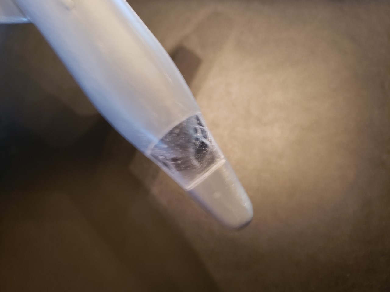

Drifterdon Posted August 12, 2022 Share Posted August 12, 2022 So I thought someone asked if the spare tanker windshield from the Roden RC-135 kit would fit the Minicraft KC-135 kit. I think with some serious carving, sanding and filling, it might be made to fit. It's larger that the Minicraft windshield. Attached is a Minicraft nose that I whacked off to replace with the Fisher resin replacement nose. I placed the Roden windshield over it. You can see how much larger it is. Quote Link to post Share on other sites

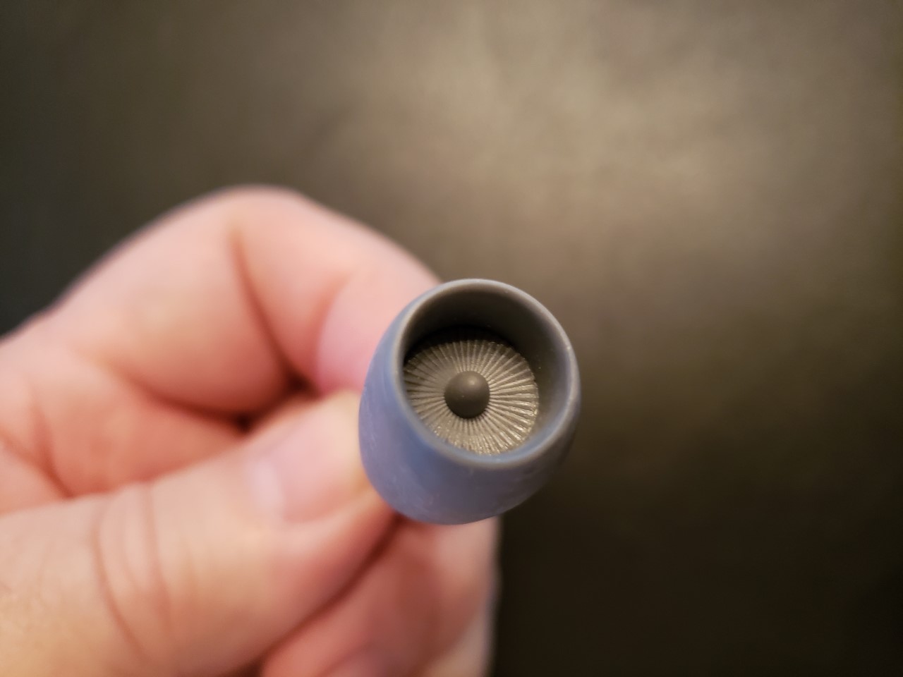

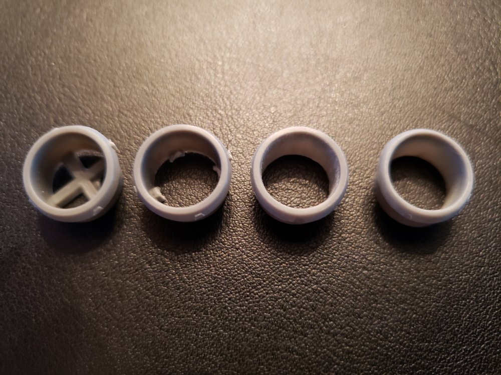

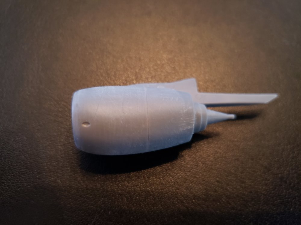

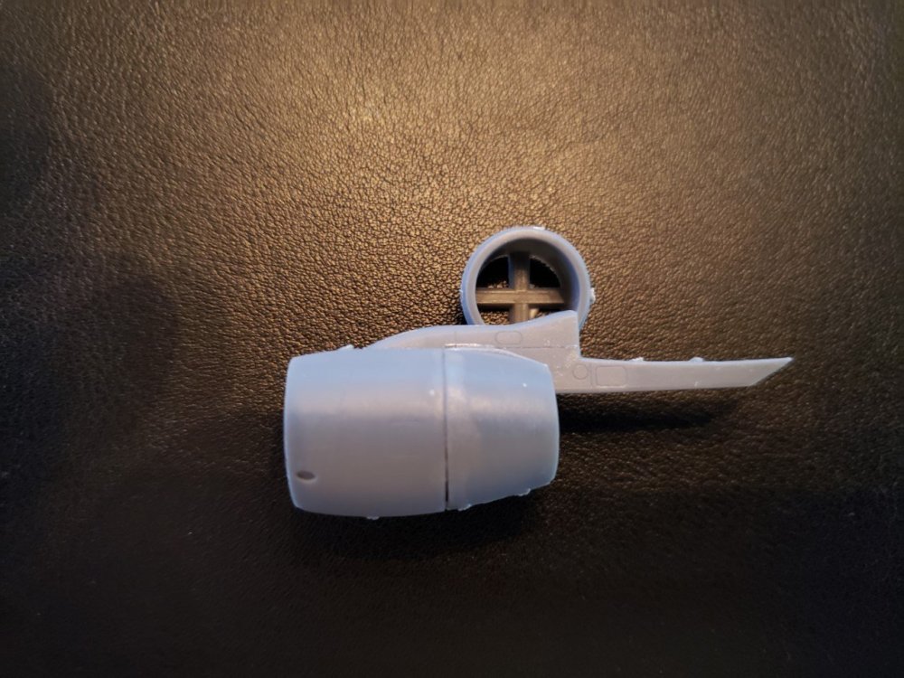

Drifterdon Posted August 15, 2022 Share Posted August 15, 2022 (edited) Moving along on the Roden Rivet Joint kit I have a couple updates on my build. With your permission Dutch. I mentioned somewhere else that the engines are problematic. What I should have said is they need work to look right. With enough elbow grease they acually look much better than the Minicraft engines. This pic shows the intake rings provided in the kit. The one on the far left is cut straght from the sprue. The next one shows the sprue cut from inside the ring. You have to be careful here or you will crack the ring. The next shows sprue cleaned up and the last one on the far right is the finished ring with the square leading edge rounded like the real engine. This is the basic engine with main parts glued together. I tried to clean up the seams as best as I could but it still left a large gap. This is one of the engines that is from my Cobra Ball build. The seam is filled and the intake ring is blended in with engine nacelle. It still needs to be cleaned up prior to paint but the main contruction is done. This is the Intake ring with fan showing. Nothing is painted but the shadows make it look dark metallic grey. Edited August 15, 2022 by Drifterdon Quote Link to post Share on other sites

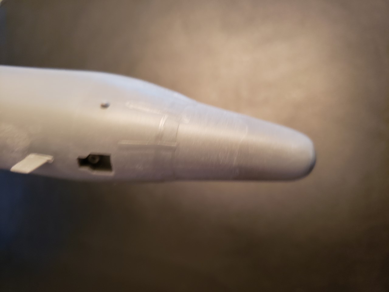

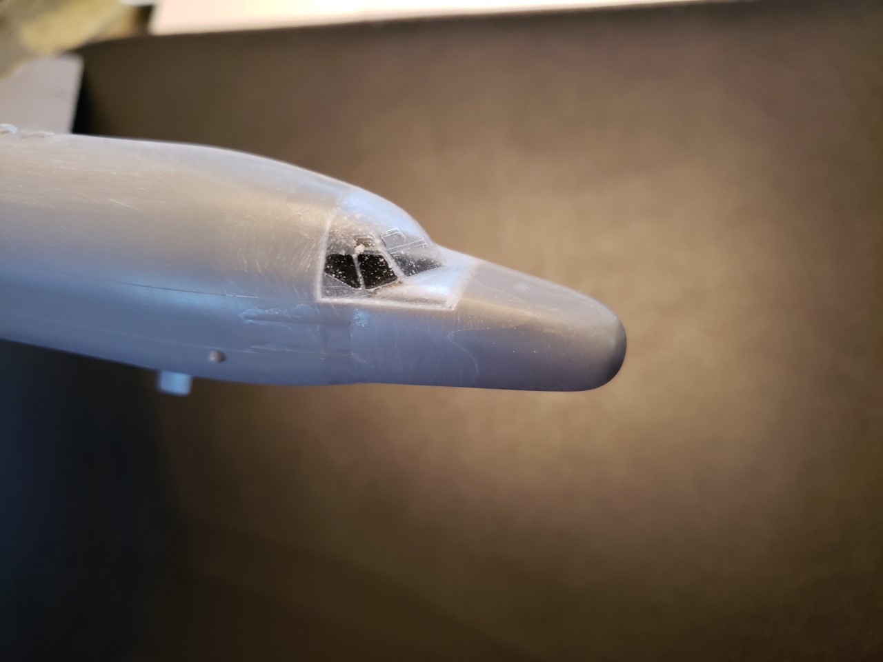

Drifterdon Posted August 15, 2022 Share Posted August 15, 2022 (edited) I also decided I wanted to see if I could fix the undersized hog nose that comes with the kit rather than hack it off and replace with a resin one. I use gap filling CA as filler of choice as it dries pretty hard and won't shrink or crack when done. Here are a couple pics that show the updated kit nose. I'm not concerned with the sanding dust behind the windshield as that will be painted and decaled. So as you can see, the kit nose can be built up and saved. Edited September 6, 2022 by Drifterdon Quote Link to post Share on other sites

Stefan buysse Posted August 15, 2022 Share Posted August 15, 2022 42 minutes ago, Drifterdon said: Steve. I tried to reload. Let me know if you can see them now.... Don Hi, That looks great, Don. I also could not see the images earlier on, now I can. Cheers, Stefan. Quote Link to post Share on other sites
Drifterdon Posted August 15, 2022 Share Posted August 15, 2022 7 minutes ago, Stefan buysse said: Hi, That looks great, Don. I also could not see the images earlier on, now I can. Cheers, Stefan. Had to delete and reload. Not sure why it didn't work. Funny thing is I could always see them on my computer but when I tried my phone, I couldn't see them either. Quote Link to post Share on other sites
Dutch Posted August 16, 2022 Author Share Posted August 16, 2022 (edited) Don, You have my absolute permission to carry on the build thread here. I hope to catch up to you soon. Yes, your engine work hits all the same points I was going to make, and you seem to have done them justice! They look really nice! I used a 3/8" or 1/2" dowel with sandpaper over it that fit the inside of the cowling nicely. Keep calm and carry on! 😉 Dutch Edited April 3 by Dutch Quote Link to post Share on other sites

Drifterdon Posted August 17, 2022 Share Posted August 17, 2022 On 8/15/2022 at 7:31 PM, Dutch said: I have a dowel that I will fit sandpaper over that will fit the inside of the cowling nicely. Dutchmaster. This is exactly what I used to clean up the inside of the intake rings. It's a piece of brass tubing with medium and fine grit sandpaper taped to each end. Works great and makes quick work of cleaning these rather large sprue stubs off. I use the same deal (only smaller size) to clean up the inside of the Minicraft TF-33 engine intakes. Don Quote Link to post Share on other sites
