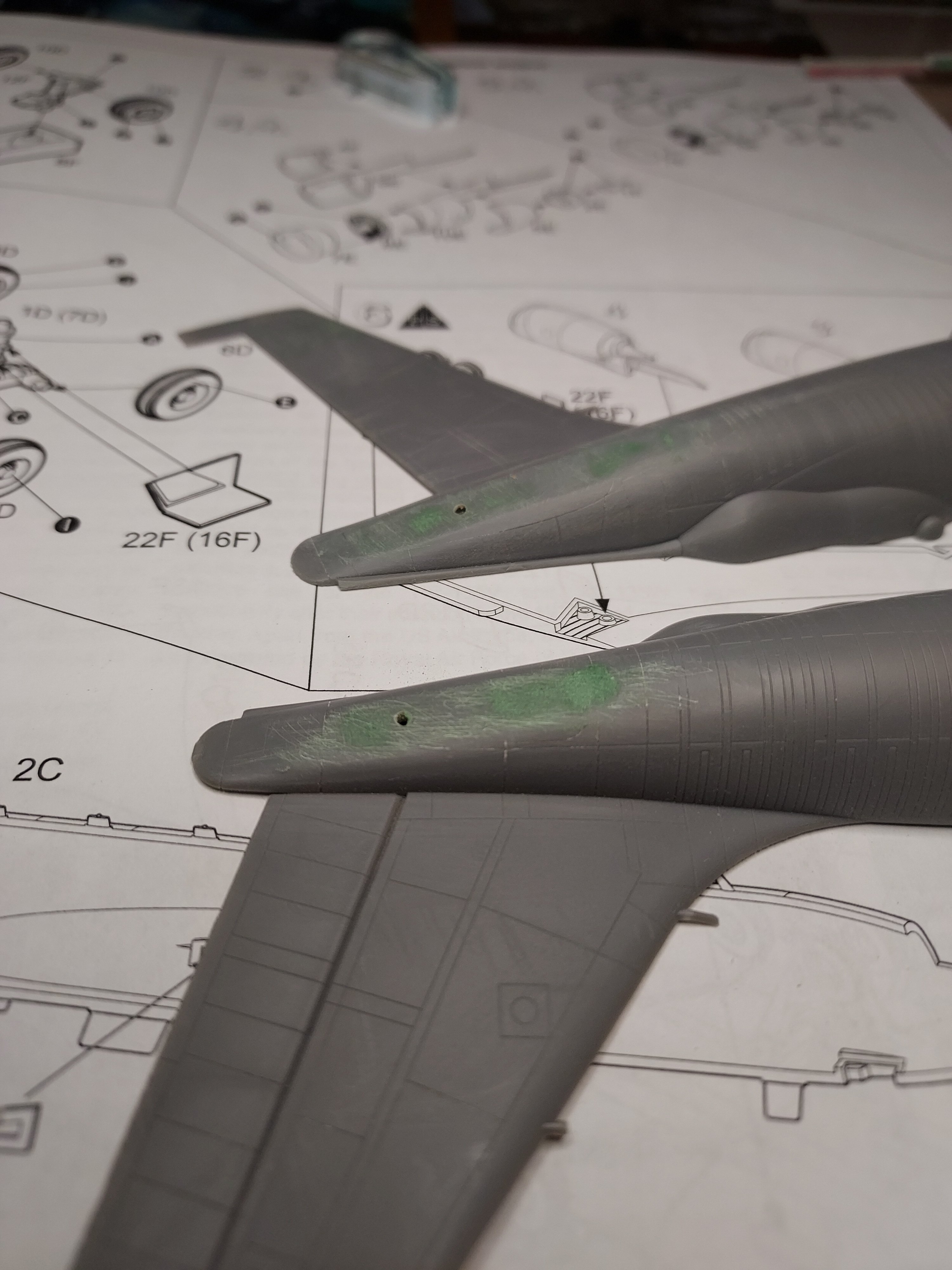

Here is a synopsis of some of the issues I've had with my Roden RC-135 builds.

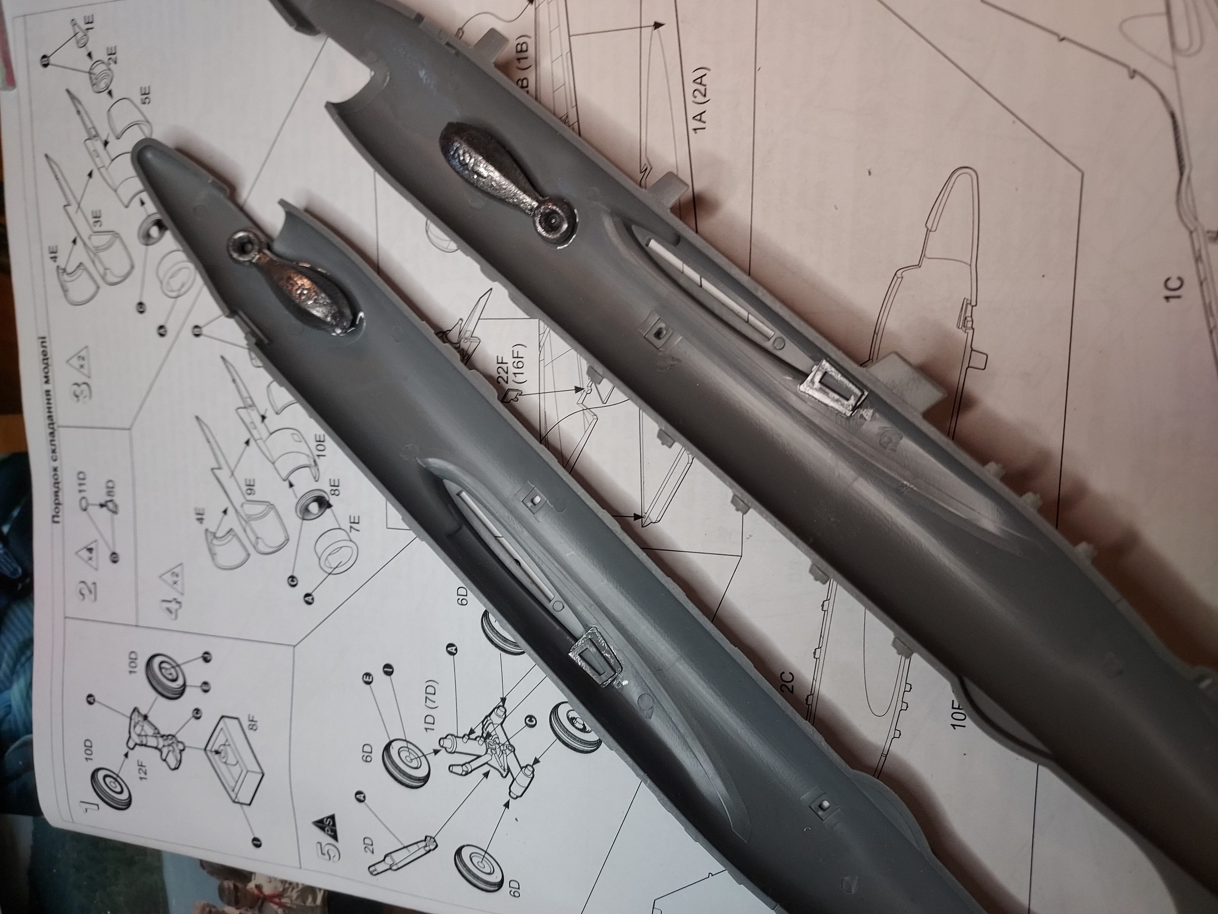

The nose radome is undersized and tapers in too much.  Looks like a blunt F-105 radome (slight exaggeration).  The attachment point on rear fuselage where horizontal stabs attach is way too pronounced.   Looks like a butte in Utah.   I discovered with all three builds that the lower fuselage area that runs the entire length of the lower wing is too thick.  I had to file it down so it was level with the bottom of the wing and then clean up and fill the seam.   The entire upper and lower fuselage has a grainy pebbly texture that needs to be sanded smooth.   The upper Satcom antennas are all lined up with the centerline of aircraft and should be staggered.  Those were the main areas that need to be addressed.    Do I recommend the kit?   Absolutely!  I have five of them.

It's a minor nit pick, but the two square air outlets for the air cycle machines in the lower wing roots are missing.  Should be just ahead of the main gear bay close to the centerline.  Scribe in a couple small squares and paint black, although in this scale nobody will ever see them.  I did cut out the openings and scratch the duct work on the AMT kit.  The outlets are already scribed on the 1/72 kit.
The surface texture on the Roden kit to me is just dumb.  I hate sanding more than any other part of model building, and I despise having to sand every surface of a model kit.  It's very noticeable on the parts.  I know its Roden, but I expect more of mold makers in 2022.

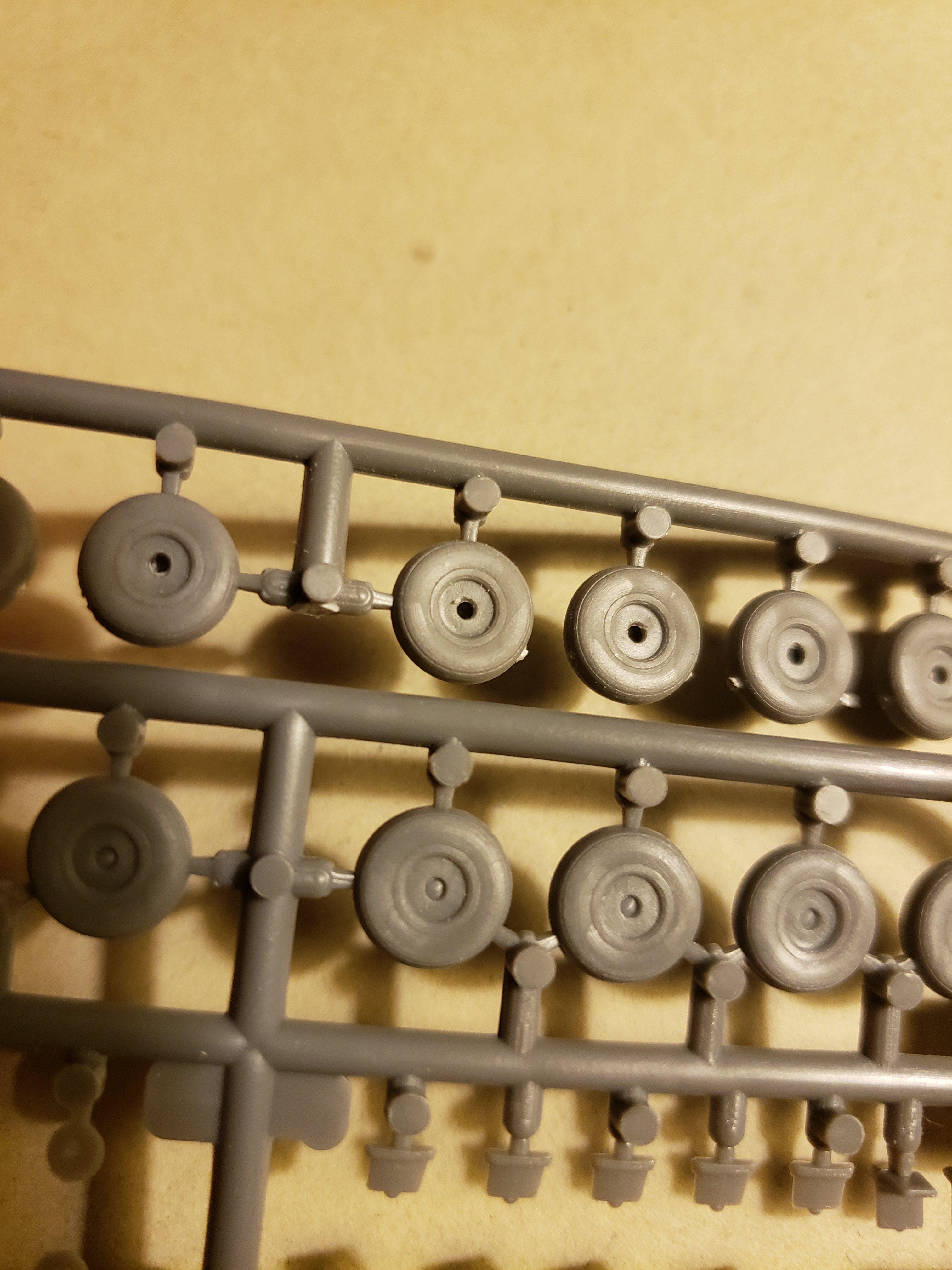

Discovered one other area that needs addressing with this kit and I'm sure it will include Roden's new release of their KC-135R kit.   The mounting location for the wheels, all 10 of them need to be drilled out in order to fit on the axles of the gear struts.   What comes in the kit are very slight depressions that are not even close to allowing the wheels to be properly mounted.   It's a minor nit but one that needs to be addressed when you build your kit.
Update to show what comes in the kit and what I did to fix.
Edited by Drifterdon

Thank you for that very keen observation.  I too worked on my RC-135W a little tonight. I re-sanded the mounting area for the horizontal stabilizers. Then I glued the landing gear mounts into the fuselage sides and added a 1/2 oz weight to each side of the forward fuselage, offset so they wouldn't interfere with each other. That's it for tonight.
