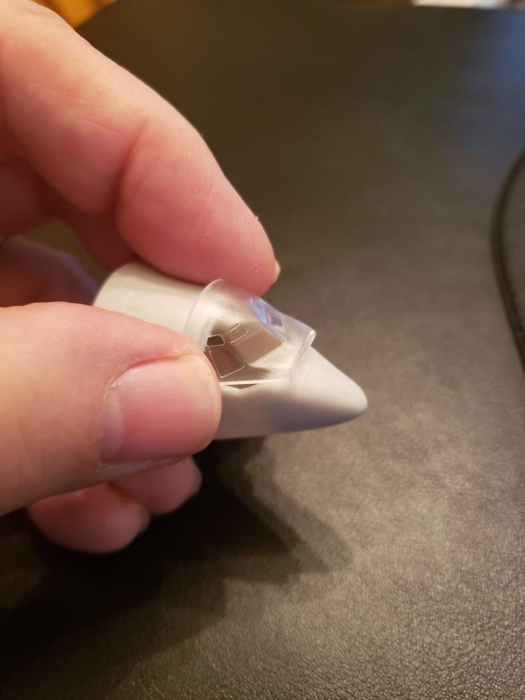

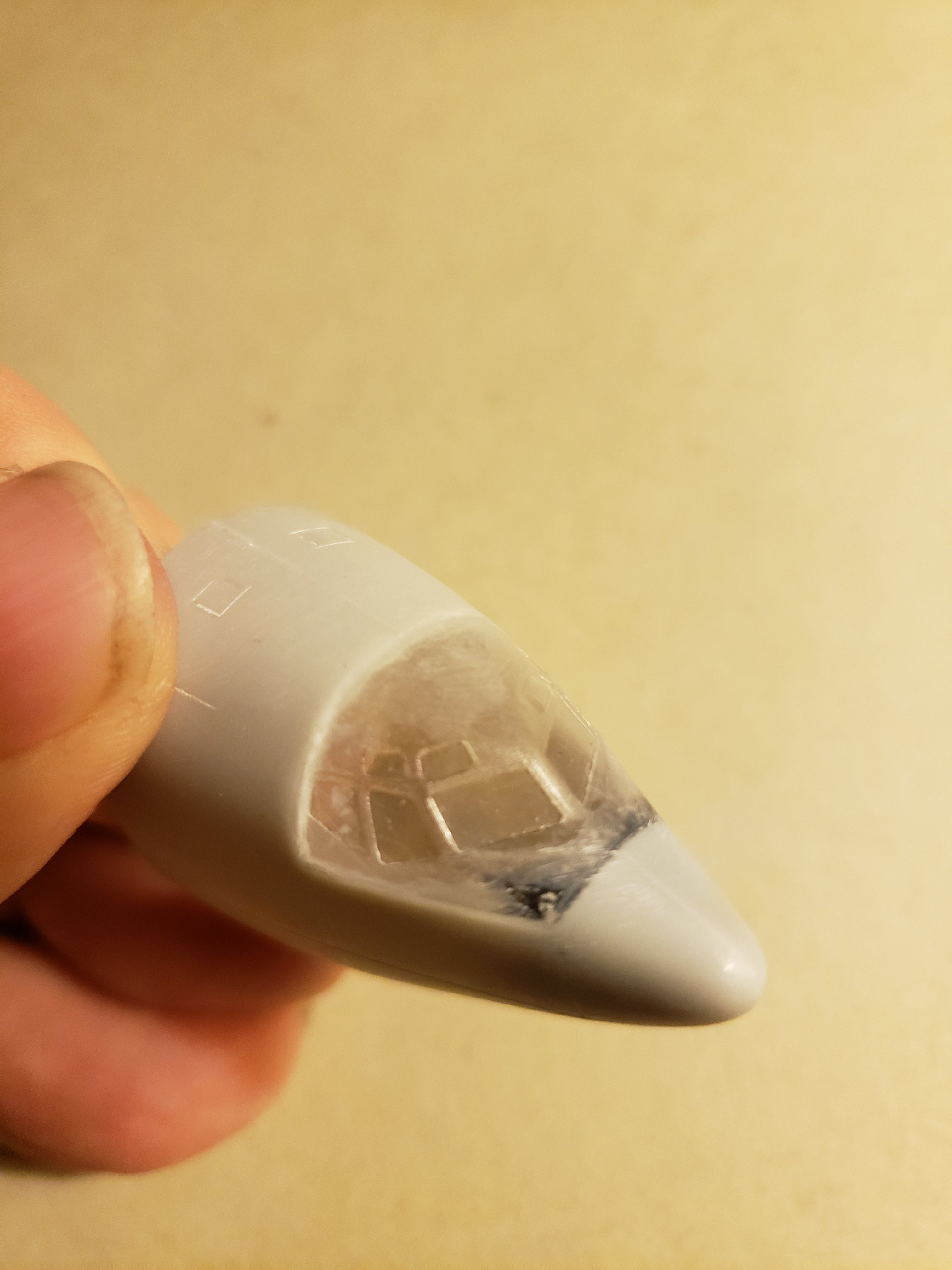

Drifterdon Posted August 25 Share Posted August 25 (edited) On 8/11/2022 at 7:54 PM, Drifterdon said: So I thought someone asked if the spare tanker windshield from the Roden RC-135 kit would fit the Minicraft KC-135 kit. I think with some serious carving, sanding and filling, it might be made to fit. It's larger that the Minicraft windshield. Attached is a Minicraft nose that I whacked off to replace with the Fisher resin replacement nose. I placed the Roden windshield over it. You can see how much larger it is. Update on fitting the Roden 135 windshield to the Minicraft 135 in an effort to fix the badly mishapen windshield that comes with their kit. When I first held the extra Roden windshield up to the Minicraft kit, it appeared to be way oversized. I went ahead and started to carve and sand to see if I could force this square peg into the round hole so to speak. After much work, I was able to make it work. It is most definitely not a drop fit replacement. Check out the pics to see what you think. I'll shoot it with some primer to see how it looks all one color but I think it just might work. Edited August 25 by Drifterdon Quote Link to post Share on other sites

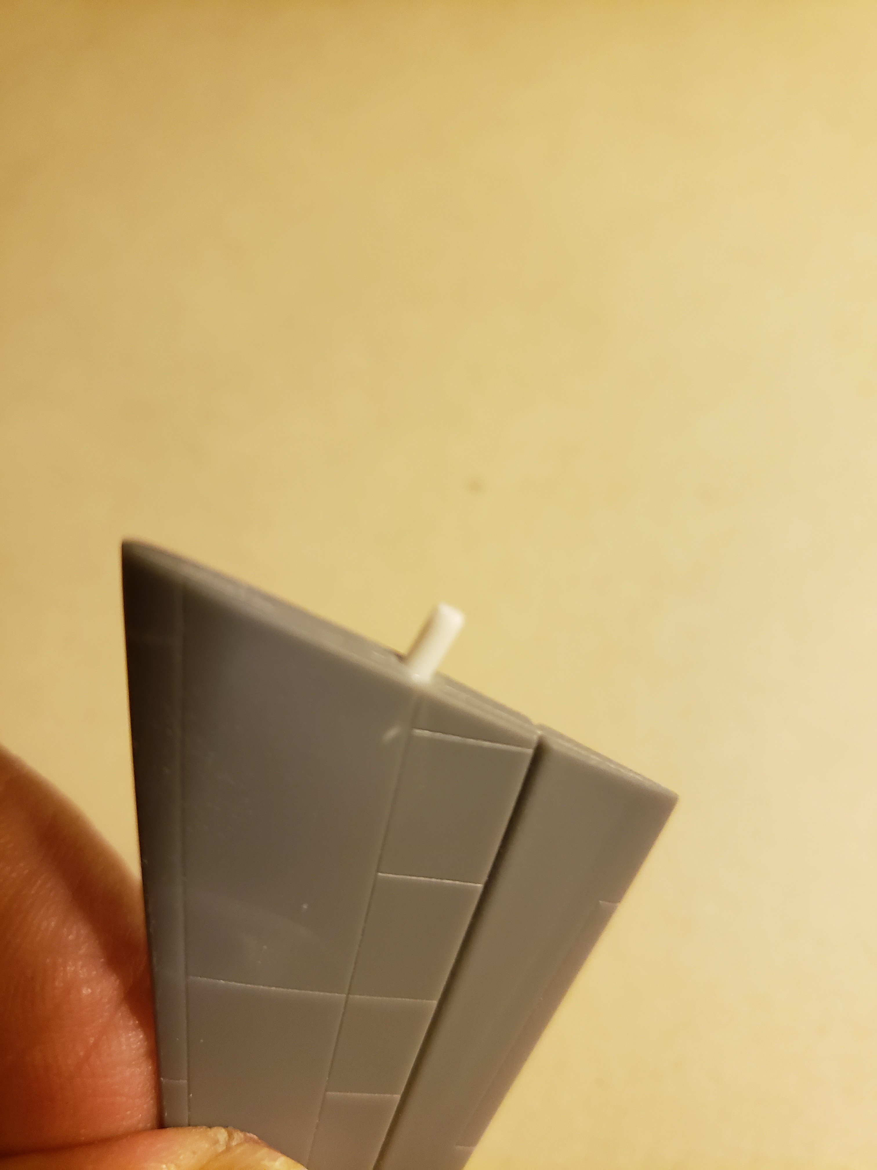

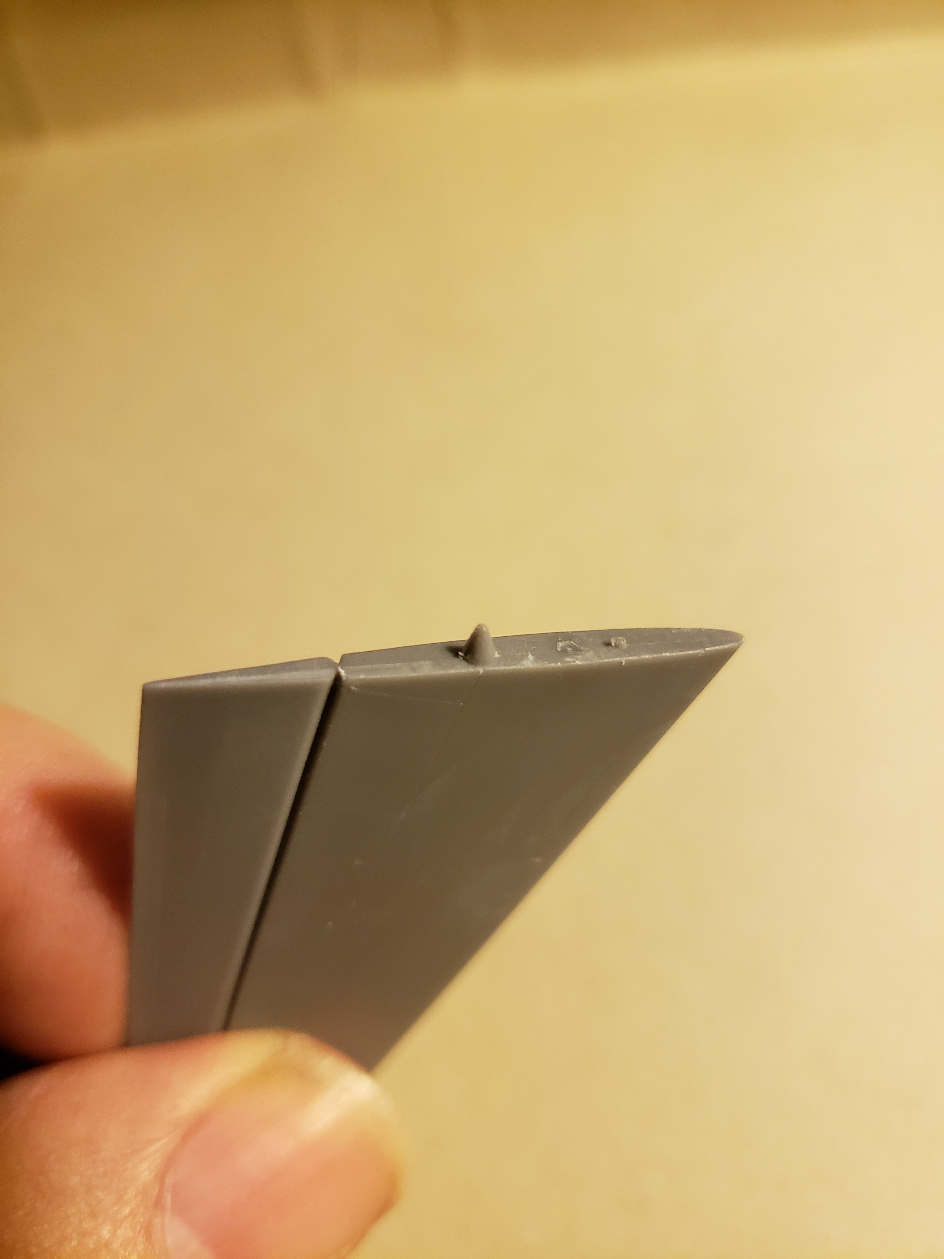

Drifterdon Posted August 25 Share Posted August 25 (edited) One other area of concern I have is the mounting point for the horizontal stabilizers. Roden provides this tiny cone shape that is supposed to fit into the small hole in the fuselage. To me this just begs to get knocked off the finished model. What I did was shave this cone off and drill a hole in the stabs then inserted a short piece of 1/16" Evergreen rod (part #222). I enlarged the corresponding hole in the fuselage and the stabs now fit great without worrying about knocked them off. Plus, it gives me something to hold onto while I'm painting them. Edited August 28 by Drifterdon Quote Link to post Share on other sites
Dutch Posted August 27 Author Share Posted August 27 On 8/25/2023 at 5:16 PM, Drifterdon said: One other area of concern I have is the mounting point for the horizontal stabilizers. Roden provides this tiny cone shape that is supposed to fit into the small hole in the fuselage. To me this just begs to get knocked off the finished model. What I did was shave this cone off and drill a hole in the stabs then inserted a short piece of Evergreen rod. I enlarged the corresponding hole in the fuselage and the stabs now fit great without worrying about knocked them off. Plus, it gives me something to hold onto while I'm painting them. I was wondering what to do about the stab mounting myself. Thank you, Brother Don, for showing us the way ahead. Quote Link to post Share on other sites

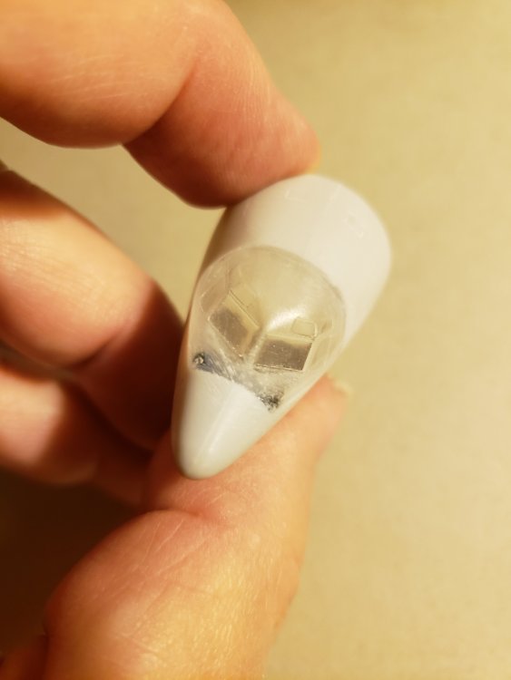

Dutch Posted August 27 Author Share Posted August 27 On 8/25/2023 at 12:18 PM, Drifterdon said: Update on fitting the Roden 135 windshield to the Minicraft 135 in an effort to fix the badly mishapen windshield that comes with their kit. When I first held the extra Roden windshield up to the Minicraft kit, it appeared to be way oversized. I went ahead and started to carve and sand to see if I could force this square peg into the round hole so to speak. After much work, I was able to make it work. It is most definitely not a drop fit replacement. Check out the pics to see what you think. I'll shoot it with some primer to see how it looks all one color but I think it just might work. Don, I was wondering if I could do the same, but thought to trim the back of the Minicraft opening a little to correspond to the size of the Roden windscreen trailing edge. Then trim the Minicraft forward fuselage to accept the flat bottom of the Roden windscreen as you have done. How close to the radome did you get (in mm?). I think I will apply the tape masks to the windscreen as I do this to protect the windows a little. Perhaps a diagram will help. K/r, Dutch Quote Link to post Share on other sites
Drifterdon Posted August 27 Share Posted August 27 1 hour ago, Dutch said: Don, I was wondering if I could do the same, but thought to trim the back of the Minicraft opening a little to correspond to the size of the Roden windscreen trailing edge. Then trim the Minicraft forward fuselage to accept the flat bottom of the Roden windscreen as you have done. How close to the radome did you get (in mm?). I think I will apply the tape masks to the windscreen as I do this to protect the windows a little. Perhaps a diagram will help. K/r, Dutch I'll have to go back and try to see what I did Dutchmaster. I just took a file and x-acto and started in until it sort of fit. I used the side window that slides open on the real deal as my point of reference. I did have to backfill the Roden windshield from the inside down near the radome as all the grinding and sanding wore away the plastic. Since I'm planning on painting these, I wasn't too worried about messing up the glass panels. I'm not sure if I'd do this again. Was a lot of work to get it to fit. I'm leaning towards casting this one in resin to see how it looks. Don Quote Link to post Share on other sites
Drifterdon Posted August 29 Share Posted August 29 On 8/27/2023 at 5:35 PM, Drifterdon said: I'll have to go back and try to see what I did Dutchmaster. I just took a file and x-acto and started in until it sort of fit. I used the side window that slides open on the real deal as my point of reference. I did have to backfill the Roden windshield from the inside down near the radome as all the grinding and sanding wore away the plastic. Since I'm planning on painting these, I wasn't too worried about messing up the glass panels. I'm not sure if I'd do this again. Was a lot of work to get it to fit. I'm leaning towards casting this one in resin to see how it looks. Don I wish someone would do up windshield decals for the Roden RC/KC-135 kits. Granted, there is enough relief molding into the kit clear part that you can easily paint and mask off but a decal would be so much quicker and easier. Call me lazy. Quote Link to post Share on other sites

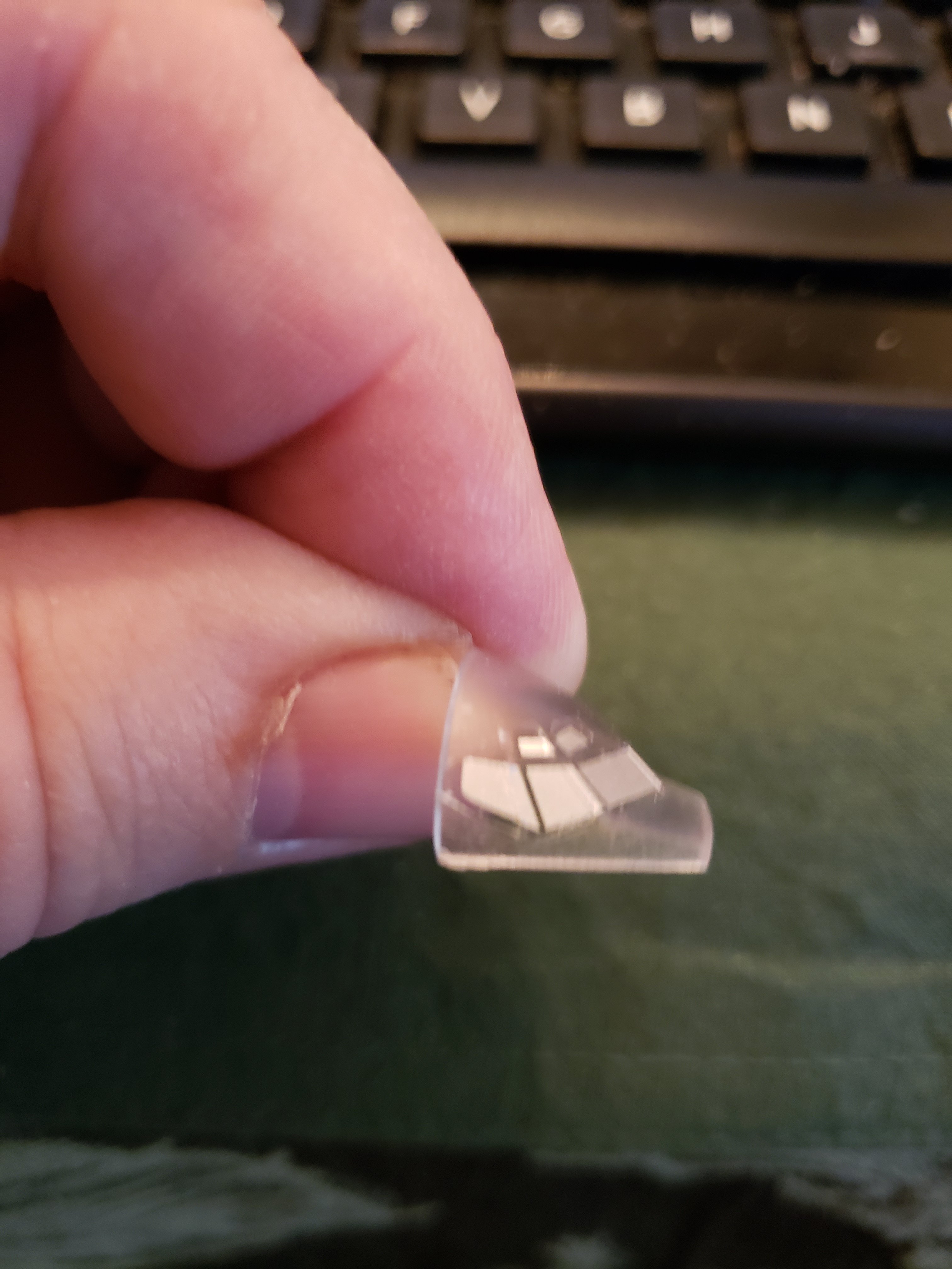

Drifterdon Posted August 30 Share Posted August 30 (edited) 1 hour ago, AD-4N said: Wouldn't this sheet by Caracal work? I have this sheet as well as the 1/144 C-135 Family General Purpose Markings sheet. They are designed to fit the Minicraft kit. I did try one of the windshield decals on the Roden part and found the decal was slightly undersized. I suppose I could fill in the depression area and use these, but I was hoping that someone would do up something that fit the Roden kit. I don't know if the Roden windshield is too big or what but it definitely looks 1000% better than the Minicraft windshield. Here is a pic of the Caracal decal on the Roden windshield. Sorry for the crummy pic. Edited August 30 by Drifterdon Quote Link to post Share on other sites
