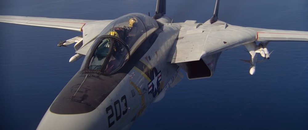

JNordgren42 Posted July 11, 2022 Share Posted July 11, 2022 This is more a personal curiosity question for any of the Tomcat experts out there. I'm working on a 1/72 Academy F-14A in VF-84 markings for an eventual diorama of the Tomcat/Zero dogfight scene in The Final Countdown. I've been over the film footage more than is reasonable for a sane person and I noticed that the F-14's have mismatched Sidewinders loaded. AJ202 has an older Sidewinder (probably AIM-9H) on Station 1A (it's got a dark metallic seeker head with the smaller swept single delta canards) and a newer 'Winder (I'm guessing AIM-9L, grey seeker with larger double delta canards) on Station 8A. AJ 203 is just the opposite 9L on 1A and 9H on 8A. I thought this might have been done so that they could expend an older round for the film, but I'm sure firing a live missile in such curcumstances would break endless safety regs. Also the shot they show on the film is AJ200 and only has Sidewinders loaded (no Sparrows and empty Phoenix pallets). I'm guessing it's test footage from a real live fire exercise. Also, fun little continuity error (besides the Modex switching); after the Zero's are splashed, both Tomcats still have their full compliment of ordinance. Does anyone know if it was common in that timeframe to load different Sidewinder variants? Or was it just something they did for the film for whatever reason? Quote Link to post Share on other sites
GW8345 Posted July 12, 2022 Share Posted July 12, 2022 The mixing was done for the movie, the missiles were training missiles (CATM's) painted to look like live missiles so they grabbed what they could. I've never seen or heard of a Tomcat carrying mixed Sidewinder's or mixes of any other missiles. We always carried the same type missiles in case one station fails to work (VF-32 Libyan Shoot Down) the aircrew can switch to another station quickly and get the shot off. Quote Link to post Share on other sites
JNordgren42 Posted July 12, 2022 Author Share Posted July 12, 2022 14 hours ago, GW8345 said: The mixing was done for the movie, the missiles were training missiles (CATM's) painted to look like live missiles so they grabbed what they could. I've never seen or heard of a Tomcat carrying mixed Sidewinder's or mixes of any other missiles. We always carried the same type missiles in case one station fails to work (VF-32 Libyan Shoot Down) the aircrew can switch to another station quickly and get the shot off. It makes sense that they would use training missiles. Although it still seems odd that they would split them like that. They obviously had two of each so why not match them in pairs on the individual aircraft? I guess it's a question for the ages. 🙂 Quote Link to post Share on other sites
