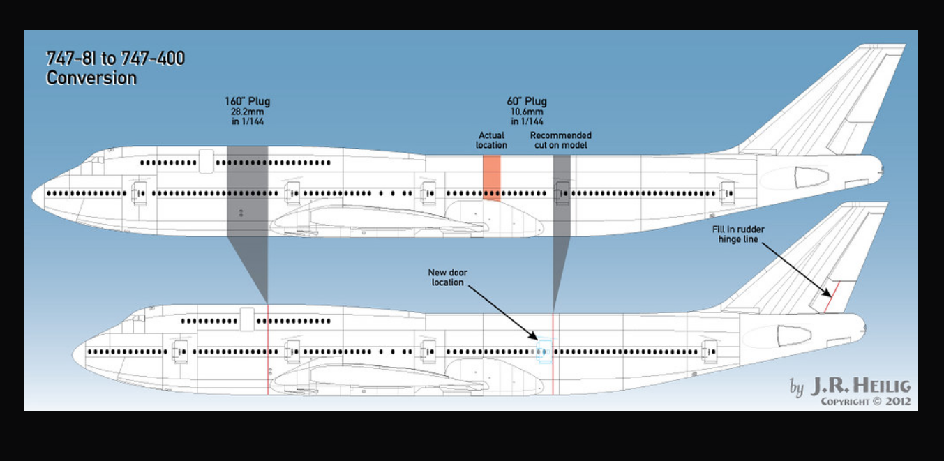

Phil Ciborowski Posted July 14, 2022 Share Posted July 14, 2022 I have found several graphical representations of how and what to do in order to make the 747-400 from a Zevezda 8i (see below), and similar chop conversions for the 767 and 777 - but for the life of me I cant find anything similar for the A320- to A319. I searched the "New" airlinercafe, but nothing. Is there someplace else I missed? Thanks! Quote Link to post Share on other sites

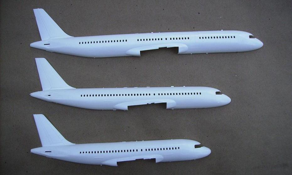

Whisky Papa Posted July 20, 2022 Share Posted July 20, 2022 Maybe this helps you with the window count (Revell): Quote Link to post Share on other sites
