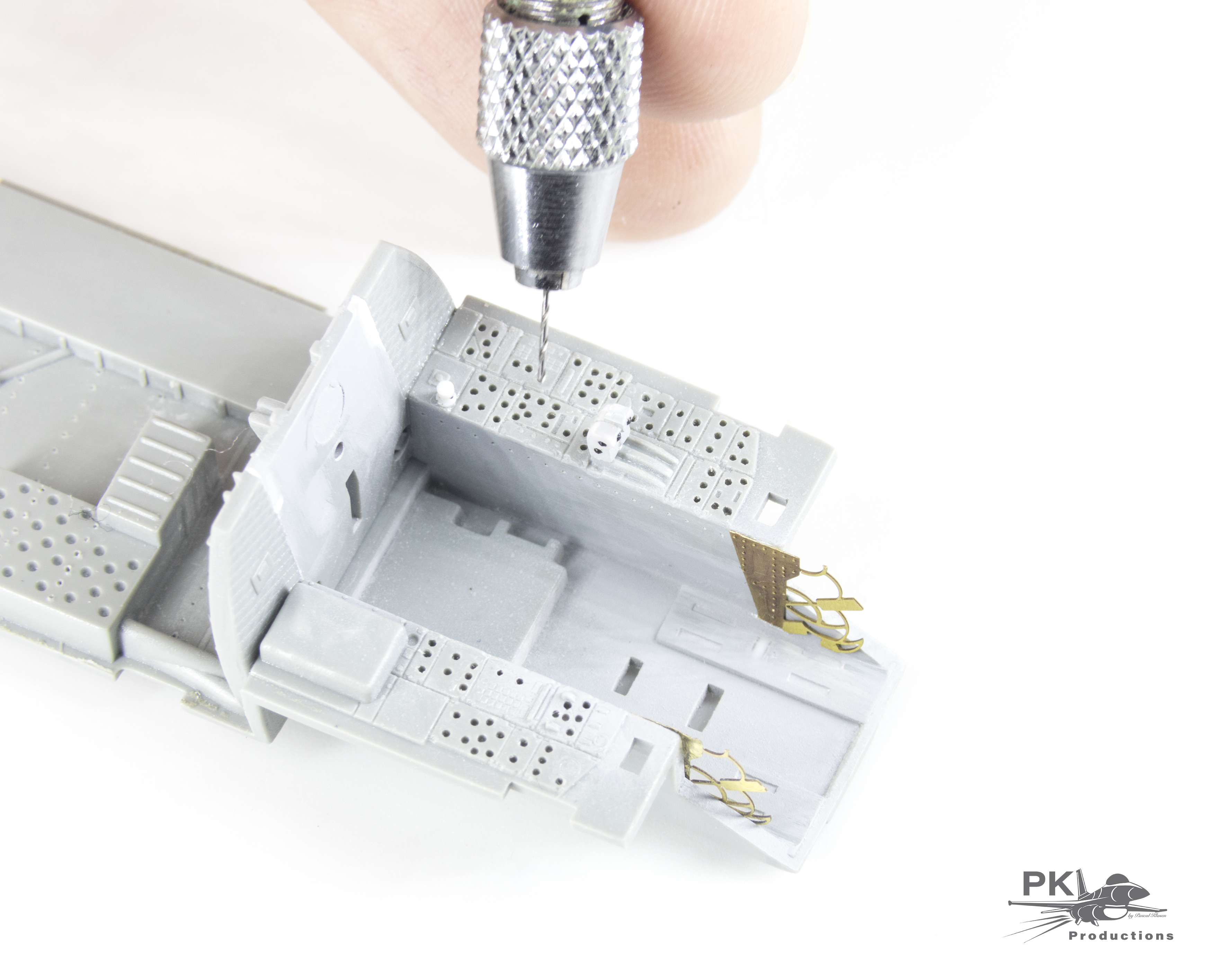

PascalK Posted August 14, 2022 Author Share Posted August 14, 2022 (edited) The Great Wall Hobby kit offers a fantastic Cockpit, so there is not much rework needed. But I will add some 3D printed switched and knobs by Anyz later on. As preparation I need to drill 0,4mm holes into the panel. Edited August 14, 2022 by PascalK Quote Link to post Share on other sites

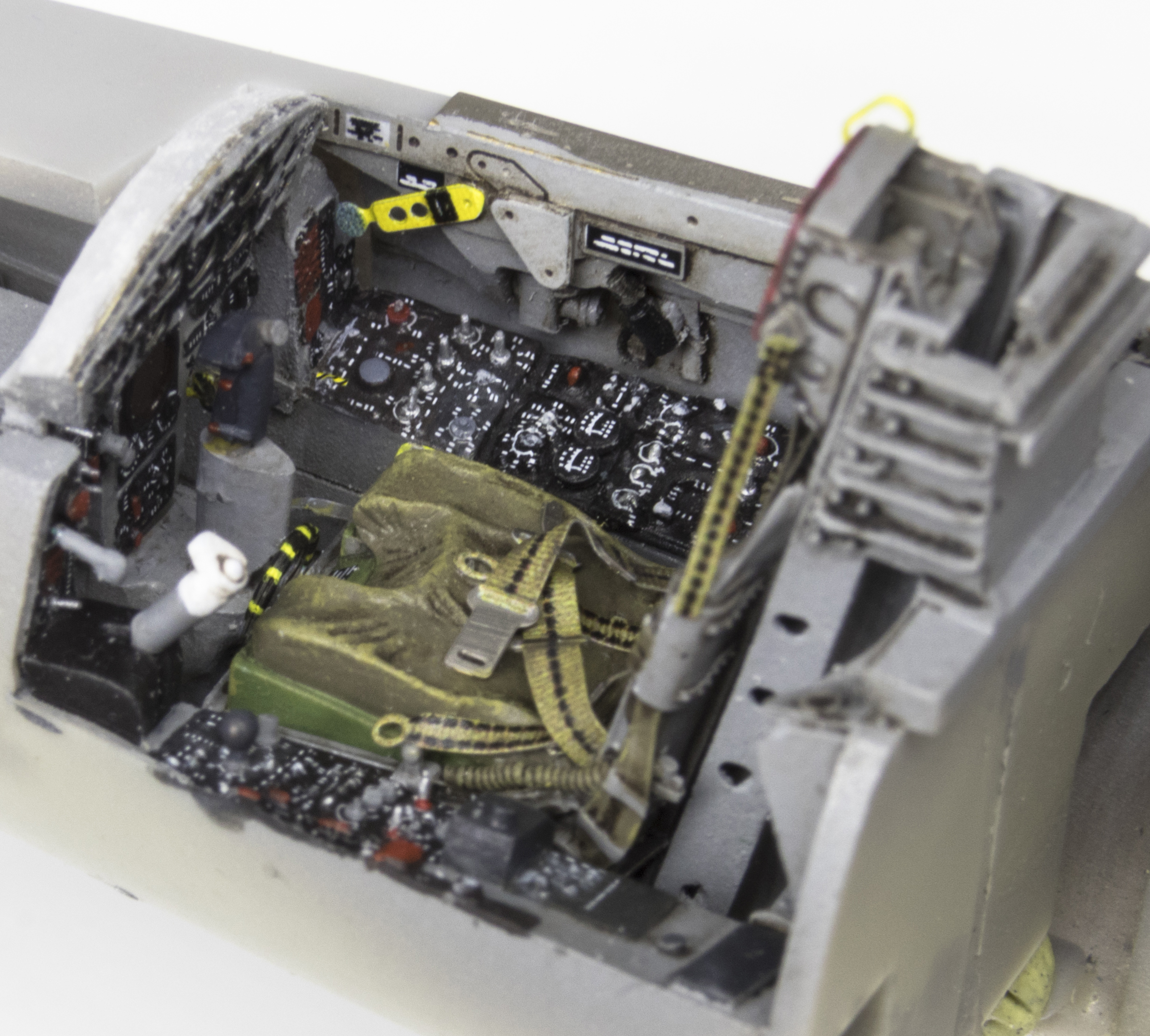

PascalK Posted August 14, 2022 Author Share Posted August 14, 2022 Hey Steve, first of all thank you! Thats no option for me, I know the quality is really great but I really enjoy the cockpit work. There is no other reason 😉 I have a few models here, were I only finished the Cockpit. I will attach my F-104 Cockpit for you in 1/48, done with decals and 3D switches. Quote Link to post Share on other sites

longmc Posted August 14, 2022 Share Posted August 14, 2022 3 hours ago, PascalK said: Hey Steve, first of all thank you! Thats no option for me, I know the quality is really great but I really enjoy the cockpit work. There is no other reason 😉 I have a few models here, were I only finished the Cockpit. I will attach my F-104 Cockpit for you in 1/48, done with decals and 3D switches. If I could do work like that, I'd never finish a build! Why close all that great detail inside a kit that will never be seen?! I guess the old saying, "you know it's in there", but that's some amazing work! Quote Link to post Share on other sites
A-10 LOADER Posted August 15, 2022 Share Posted August 15, 2022 9 hours ago, PascalK said: Hey Steve, first of all thank you! Thats no option for me, I know the quality is really great but I really enjoy the cockpit work. There is no other reason 😉 I have a few models here, were I only finished the Cockpit. I will attach my F-104 Cockpit for you in 1/48, done with decals and 3D switches. Understood. Cockpits are my favorite as well but, as I grow older and my hands get more shaky I think I'll have to go the decal route for the cockpits. Thank goodness for these and, my OptiVisor. The above cockpit looks awesome. Steve Quote Link to post Share on other sites

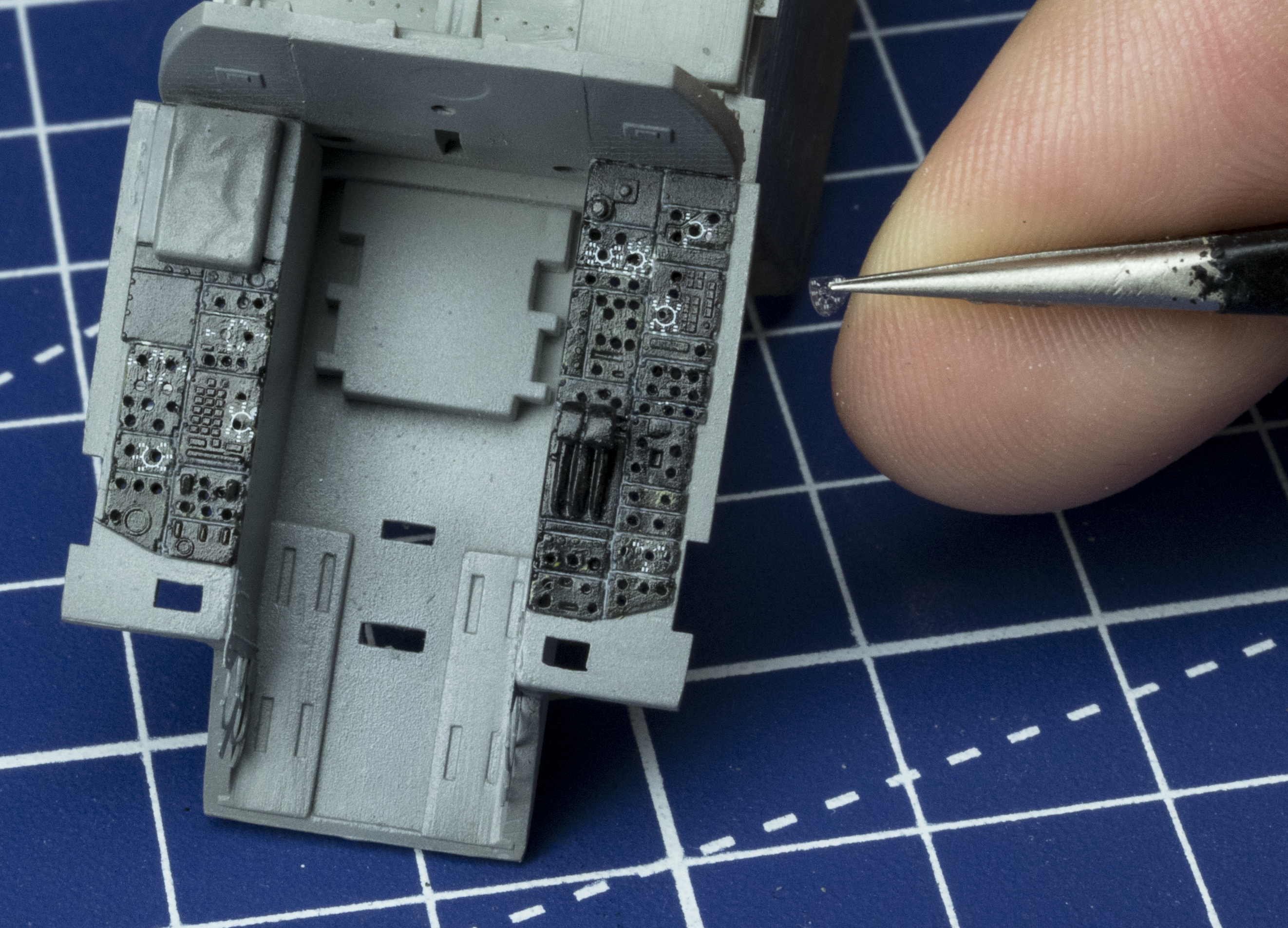

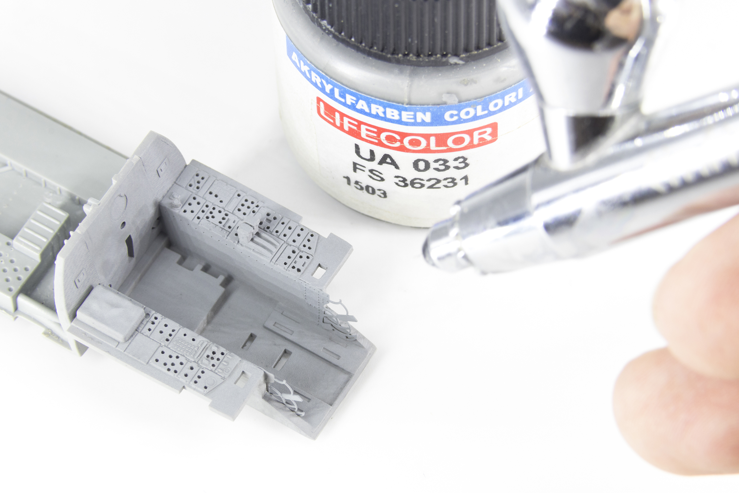

PascalK Posted July 10, 2023 Author Share Posted July 10, 2023 Let's get back to the F-15 and finish the cockpit! A base layer of FS36231 was applied by airbrush. After that I used several black color tones for the panels and finally I'm adding the decals from ANYZ models. Quote Link to post Share on other sites

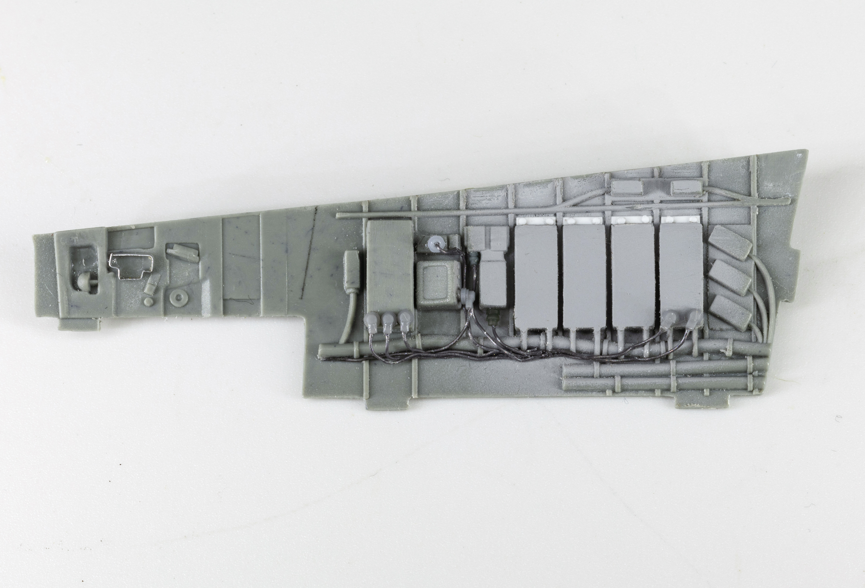

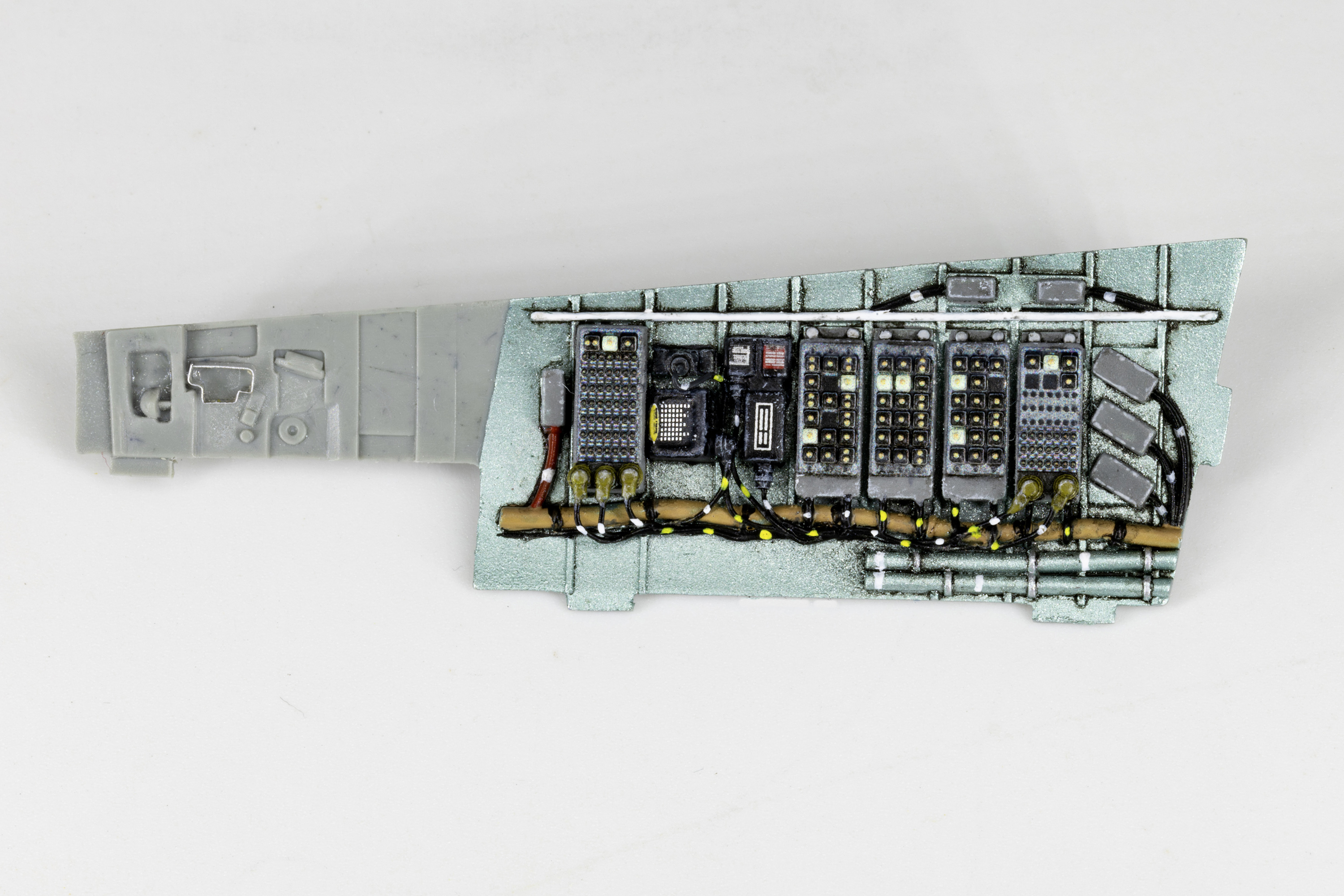

PascalK Posted July 11, 2023 Author Share Posted July 11, 2023 Guys, here are more pictures of the detail work in the bay 5 area. Lead wire and 3D printed connectors from ANYZ Models were used to get this result. It was much easier to use copper wire instead of the kit plastic handles. Quote Link to post Share on other sites
lgl007 Posted July 11, 2023 Share Posted July 11, 2023 You are blowing us away with this level of detail and accuracy! At 1/48? Simply stunning! You must have great eyesight or a fantastic magnifying glass for all that detail work 😜 -Greg Quote Link to post Share on other sites
A-10 LOADER Posted July 12, 2023 Share Posted July 12, 2023 Holy Cow, fantastic job there Pascal !! Steve Quote Link to post Share on other sites

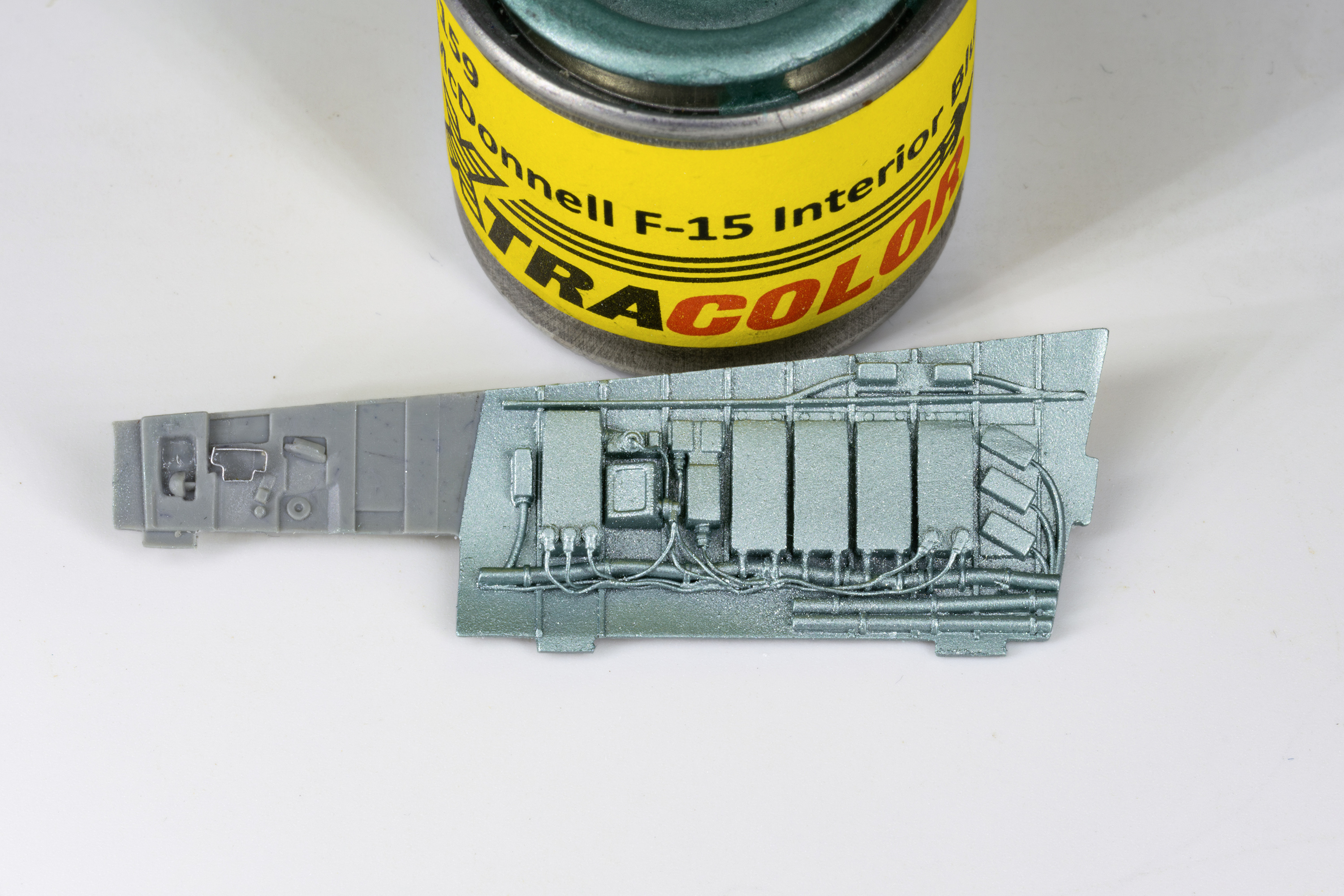

PascalK Posted July 17, 2023 Author Share Posted July 17, 2023 (edited) The only authentic color for the F-15 metallic blue is Xtracolor X159, very old school... After a drying time of one week, I start painting the details. A mix of ANYZ models and Quinta 3D decals push the side wall on a higher level. Edited July 17, 2023 by PascalK Quote Link to post Share on other sites
