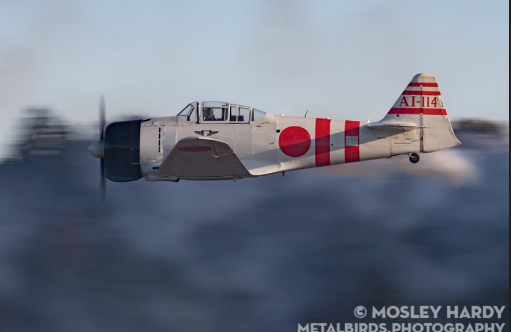

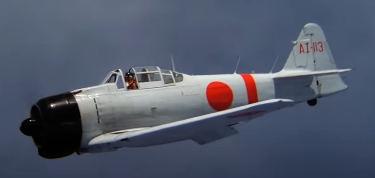

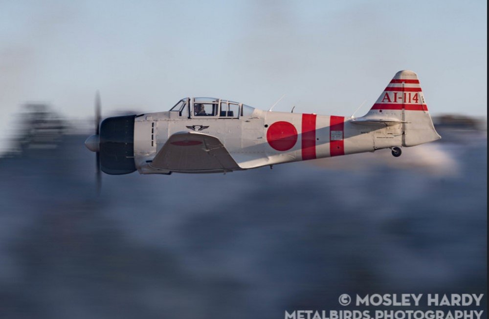

Steve N Posted August 25, 2022 Share Posted August 25, 2022 I'm not sure you could use any actual Zero parts..the proportions are very different from the AT-6. I did a conversion using the Airfix kit back in the late 1970s! The engine was a standard AT-6 cowl, just with (fake) cowl flaps added. I still plan to eventually do the conversion using a Academy AT-6. The mods include: Rear cockpit faired over, with solid rollover pylon behind the pilot New canopy (taller and fatter than an actual Zero) Decking forward of the cockpit built up, with fake guns leading edge "bump" for the wheels smoothed out Round wingtip extensions Lower landing gear doors added Fake cowl flaps, and fake cooling vents on the fuselage behind the engine Intake added under the engine cowl Oil cooler intake on the side removed Pointed extension added to the lower corner of the rudder Center flap removed or faired over And I think there was a wing filet added where the trailing edge meets the fuselage Part of the problem with nailing down the specifics of the conversions is that most of the existing ones have been significantly modified over the years, and there are a number of them on the airshow circuit that are T-6s converted by individual owners long after the Tora planes, with varying degrees of modification. Probably the best reference is to simply grab the DVD of "Tora! Tora! Tora!" Cheers! Steve Quote Link to post Share on other sites

Scott Smith Posted January 13 Share Posted January 13 1 hour ago, Dutch said: Different movie! But I like the idea! Yea, they used the planes built for Tora, Tora, Tora. I’ve been looking into this a bit closer and it seems that no two conversions were done the same. Sadly, one was lost along with the pilot due to a crash. But one conversion they added “fillers” at the root of the wings leading edge to hide the T6 wing profile. Another has modified landing gear doors and also has wheel wells modified a bit too. saw one with a cut down 3 blade prop and the zero shaped spinner, another with just a T6 spinner and two blade prop. Quote Link to post Share on other sites
