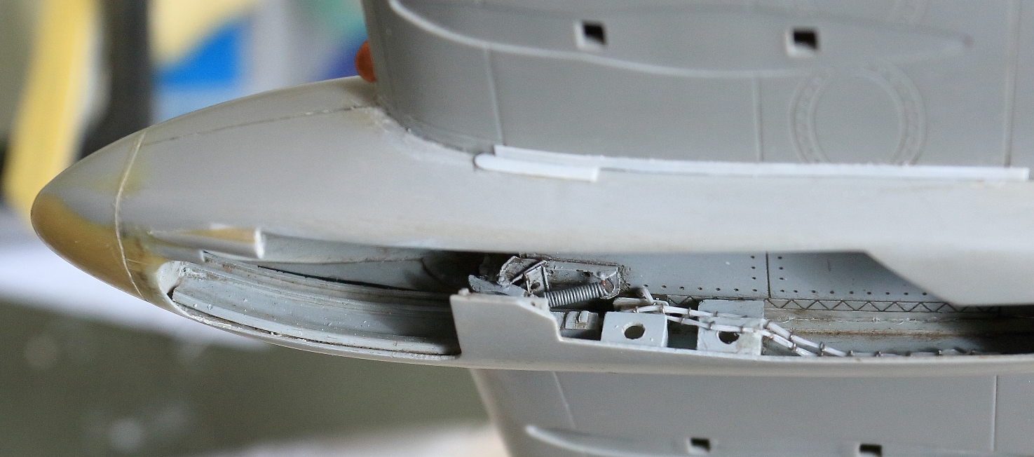

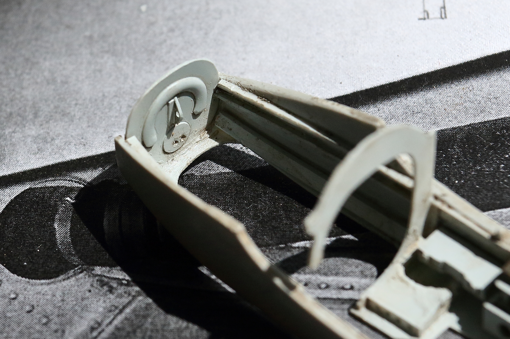

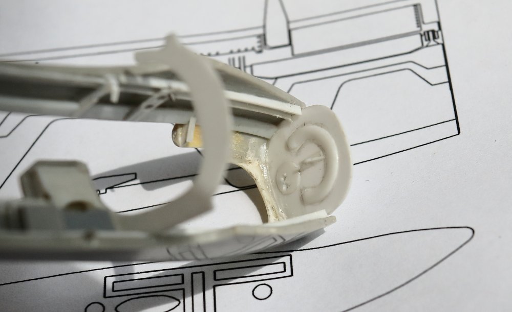

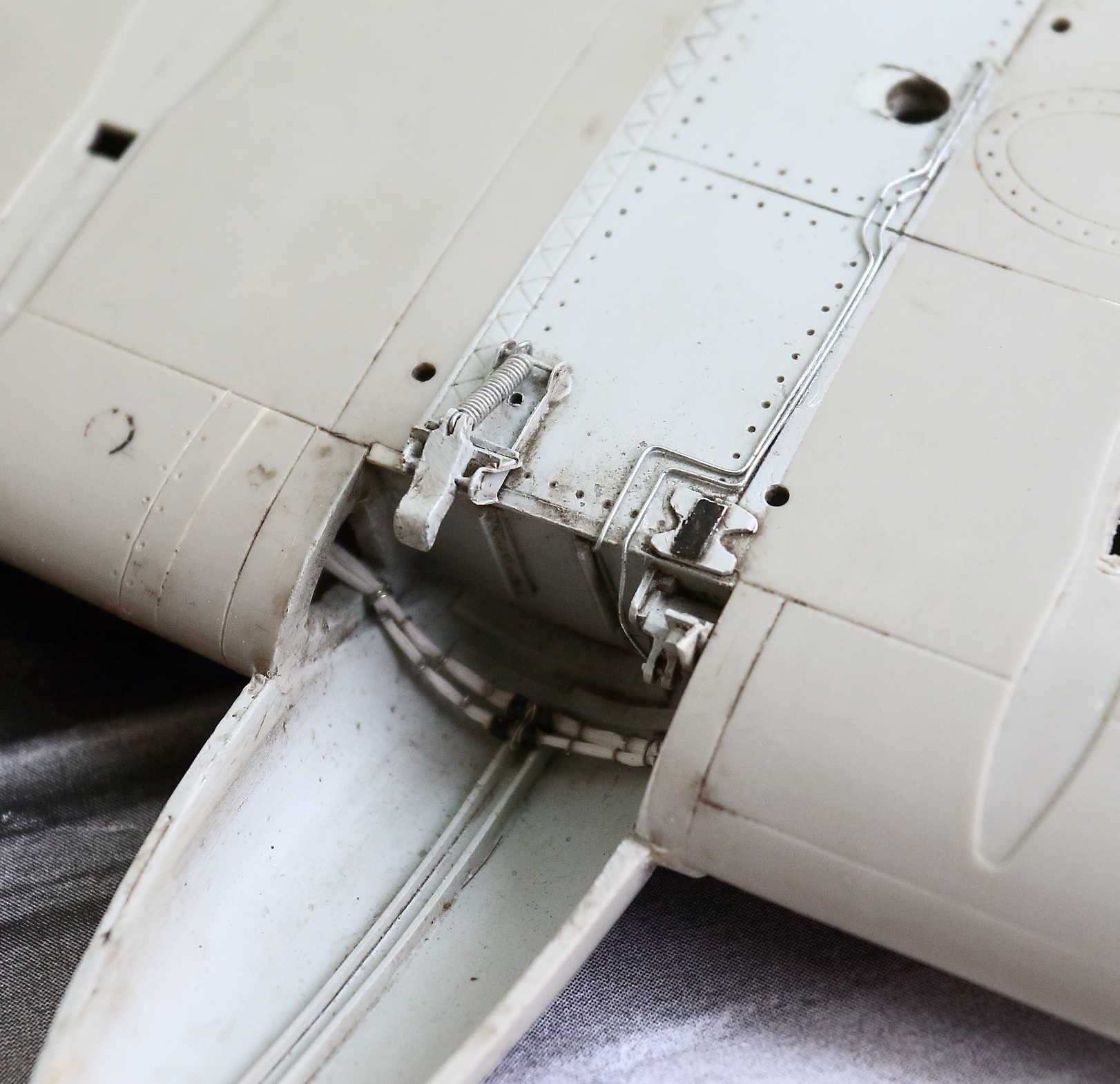

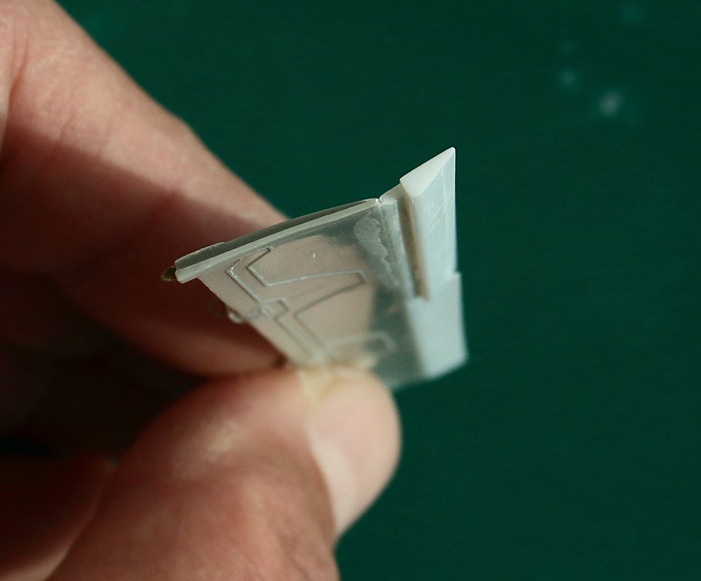

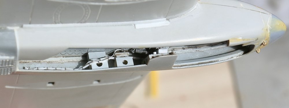

Eastern Posted March 23, 2024 Author Share Posted March 23, 2024 (edited) Hi guys, After a long delay on the posting I managed to post some images concerning my progressing on the build. Now into the main gear wells. I soldered one element (have no idea what its name is) and pinfiled some details to fix on the area within the wells. And some images how they look after some more details have been added. Cheers! Alexander p.s. Please, give me a clue how to move the cursor below the images field to type below them. Edited March 24, 2024 by Eastern Adding more images Quote Link to post Share on other sites

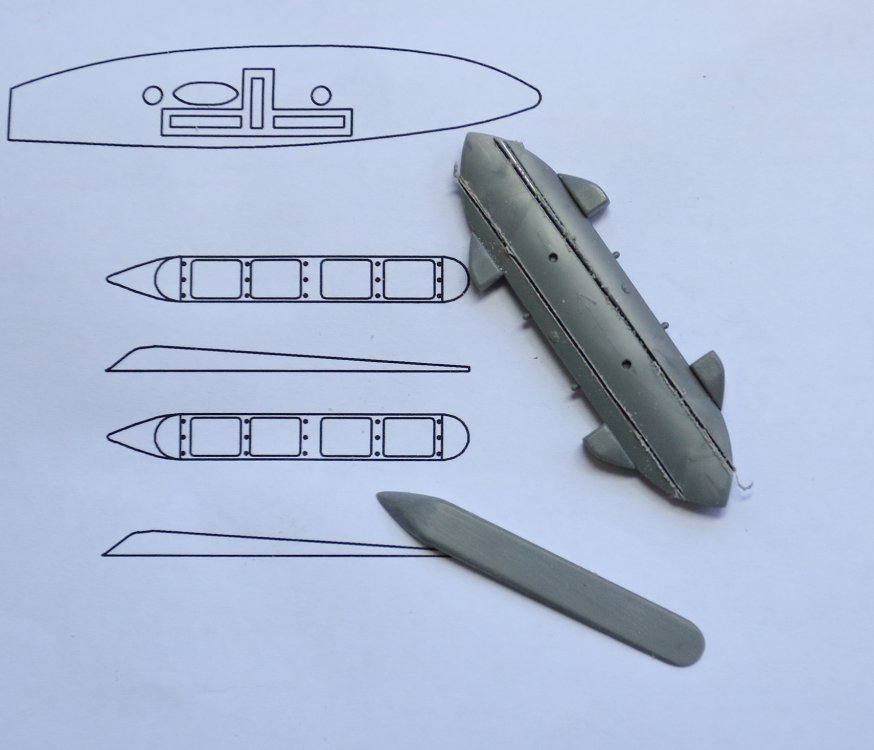

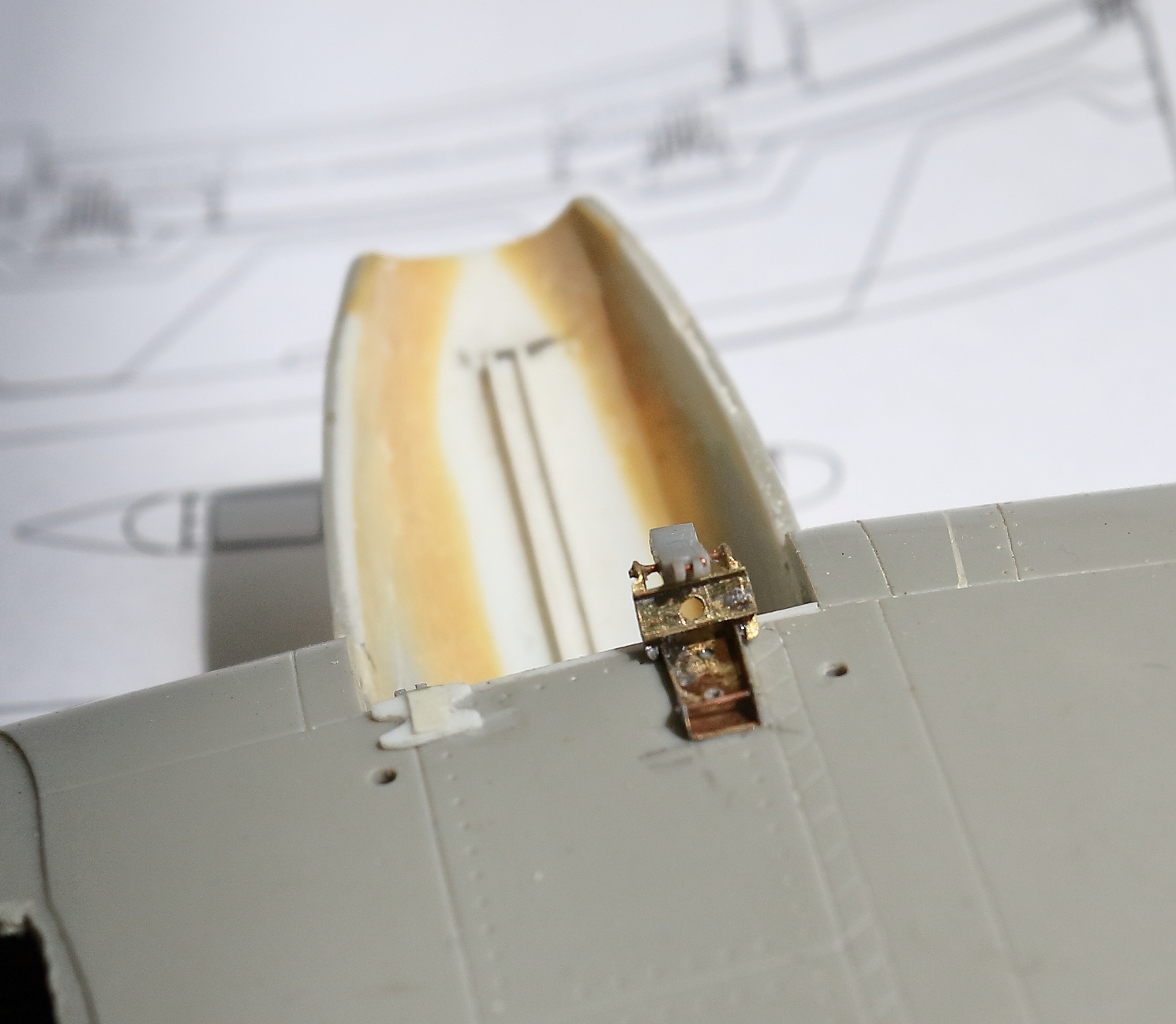

Eastern Posted March 23, 2024 Author Share Posted March 23, 2024 Some more updates. Now on the chaff/flare dispensing system. I removed the in-kit part and scratch built the one using a part leftover from another kit. Quote Link to post Share on other sites

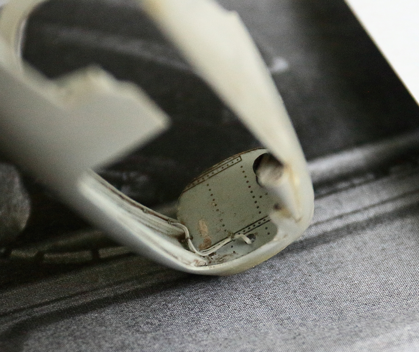

Eastern Posted March 23, 2024 Author Share Posted March 23, 2024 Some more updates on the main gear wells. Quote Link to post Share on other sites

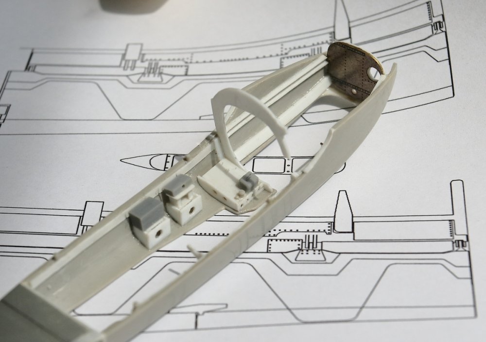

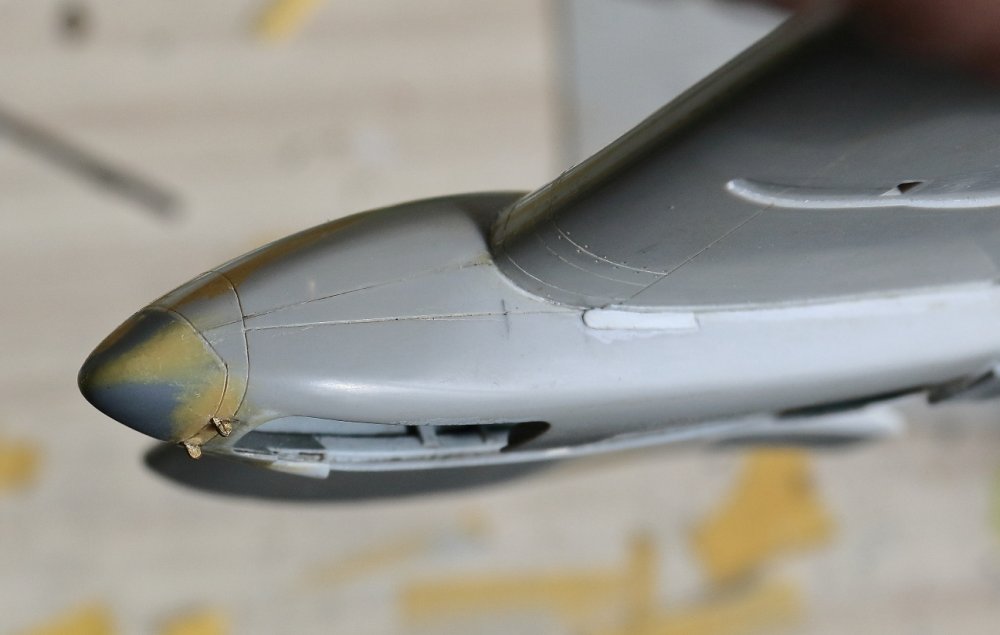

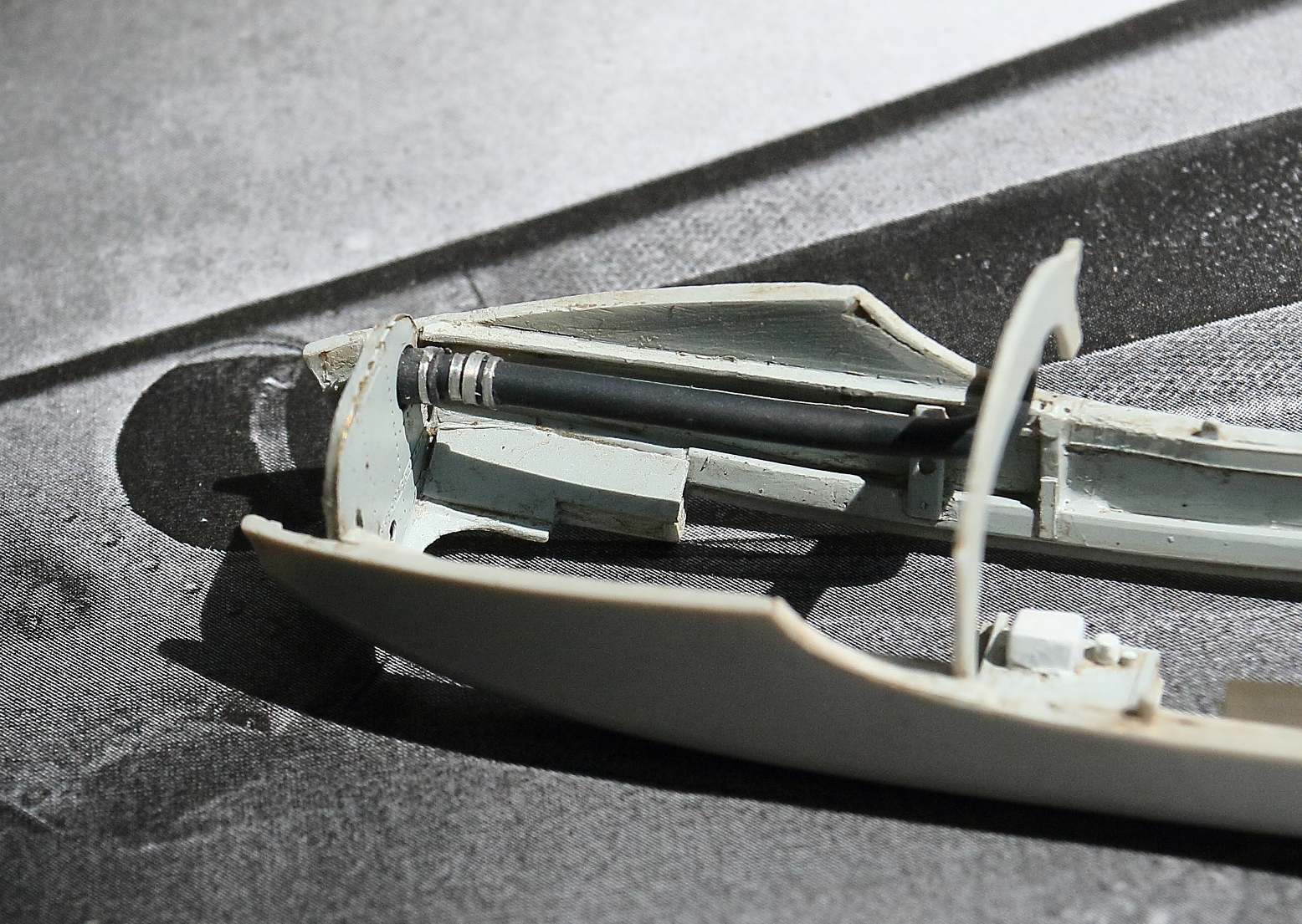

Eastern Posted March 24, 2024 Author Share Posted March 24, 2024 Hi there, Some more images as progressing on the main gear nacelles. Quote Link to post Share on other sites

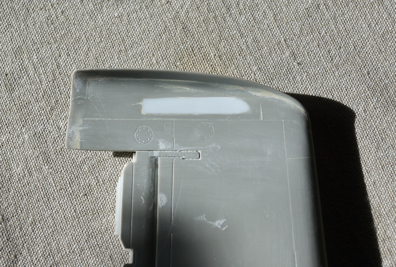

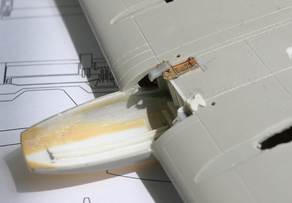

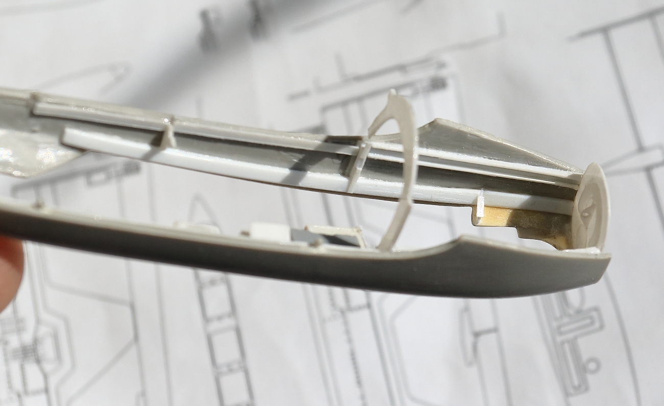

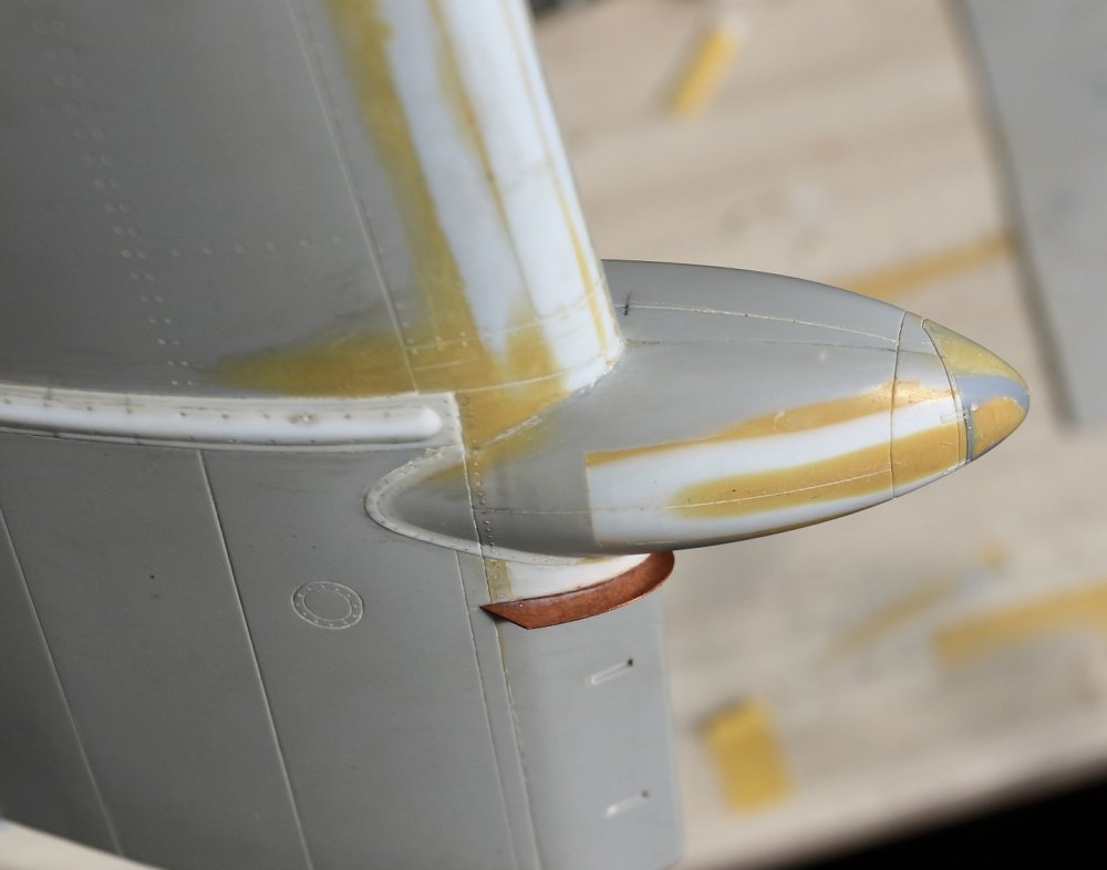

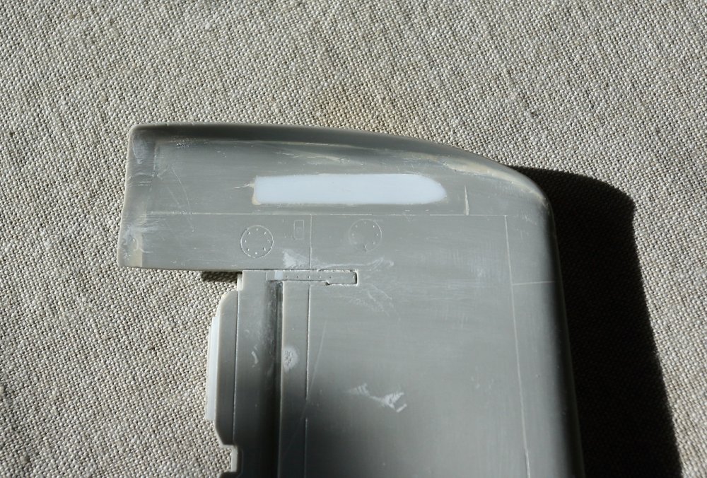

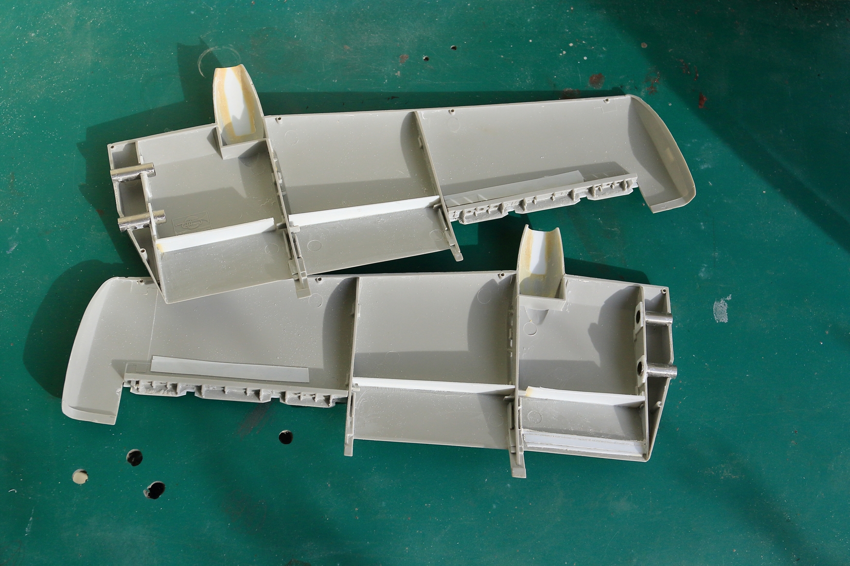

Eastern Posted March 24, 2024 Author Share Posted March 24, 2024 It is more than a year past by since I started working on the wings and only now I'm to show what I did so far. Before gluing top and bottom parts together I added stiffening ribs of plastic 1 mm thick. After the parts were cemented together I added some lengths of plastic to the fore edge of the wings to make the edge to be more rounded as closer to the prototype. Then I removed the long protruding element (have no idea what it is) from where the wing forms a V shape right closer to the main gear sponson and replace it with a scratchbuild part. BYW, the in-kit sponsons are of a wrong shape so I had to correct them. Quote Link to post Share on other sites

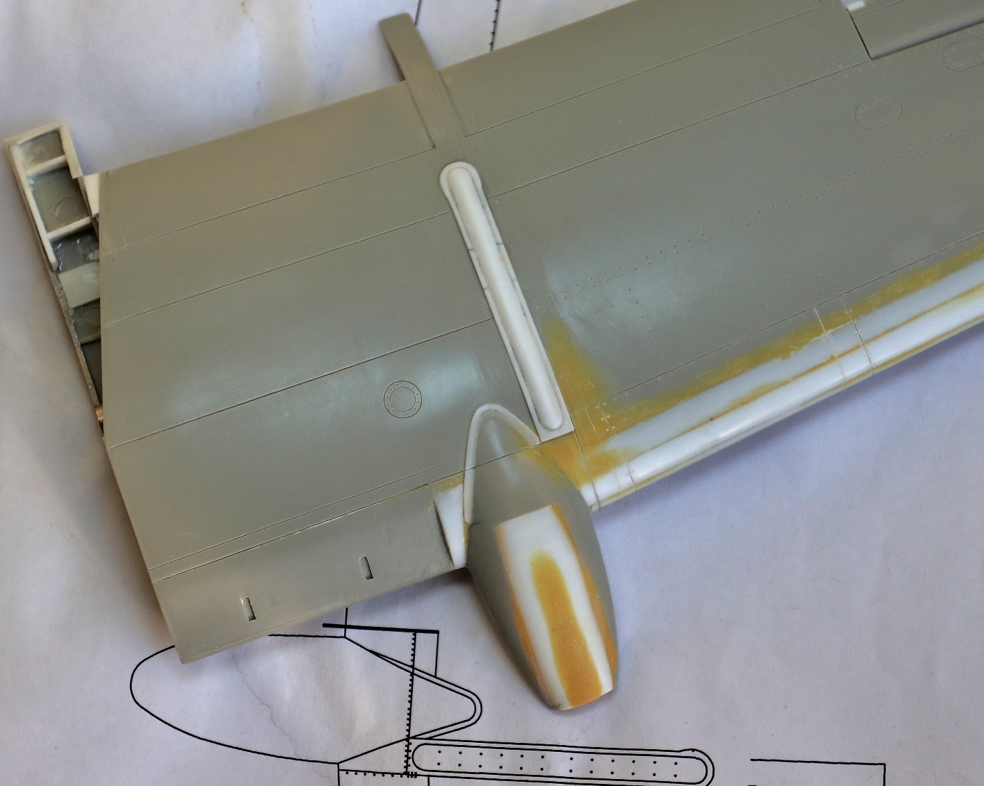

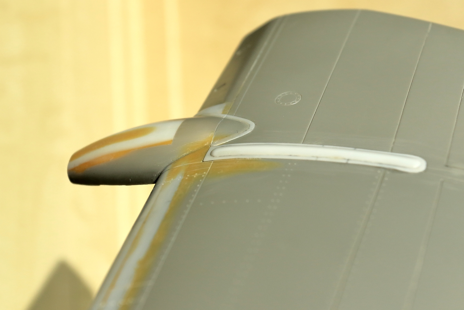

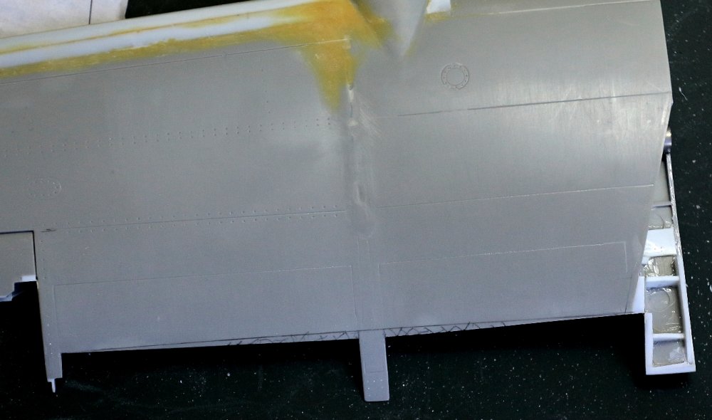

Eastern Posted March 25, 2024 Author Share Posted March 25, 2024 BTW. Thank you guys for the interest and nice comments (Greg, you da man.) Back to the progress. One more pic on the wings. The grooves where the pylons are to be placed are in wrong position so I had to fill the grooves and drill holes to place the pylons where they are to be. Quote Link to post Share on other sites

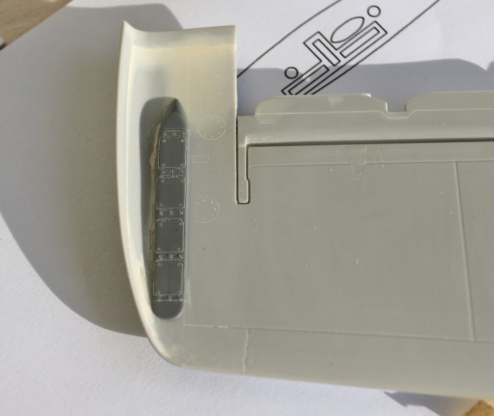

Eastern Posted March 26, 2024 Author Share Posted March 26, 2024 7 minutes ago, karl h said: i thought the yellow stuff was the light curing putty Hello Karl, The yellow stuff was this: Quote Link to post Share on other sites

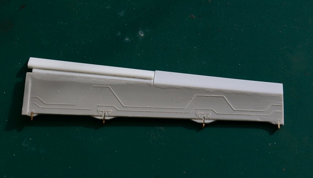

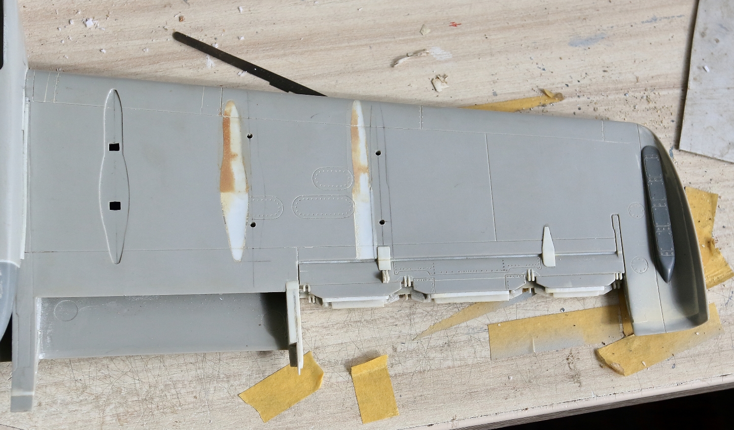

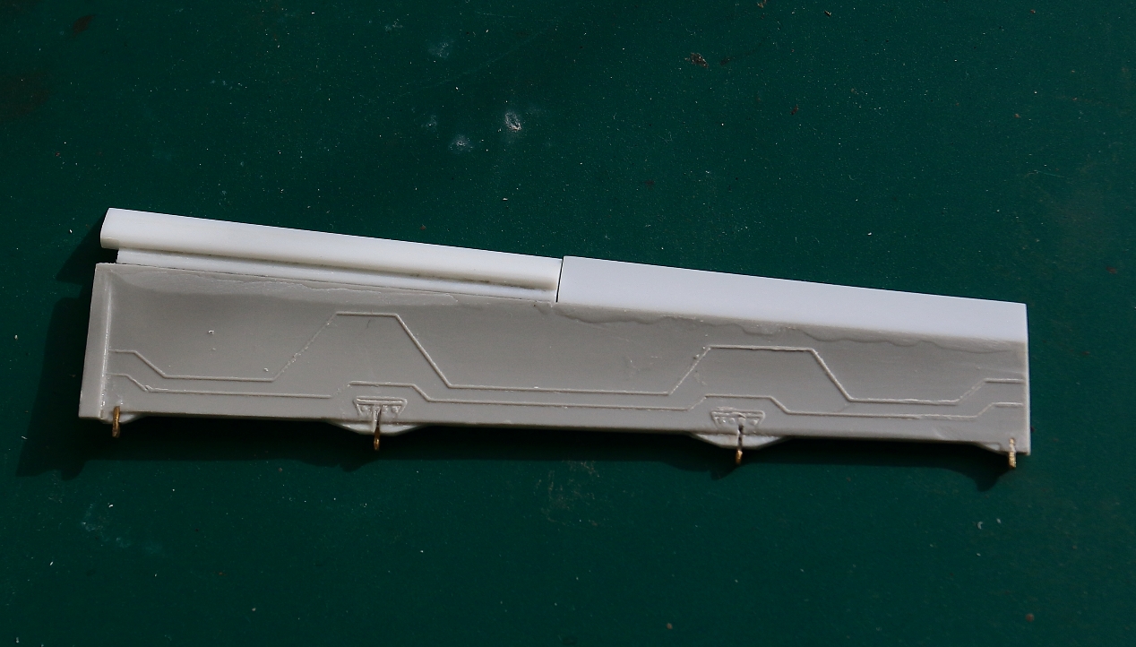

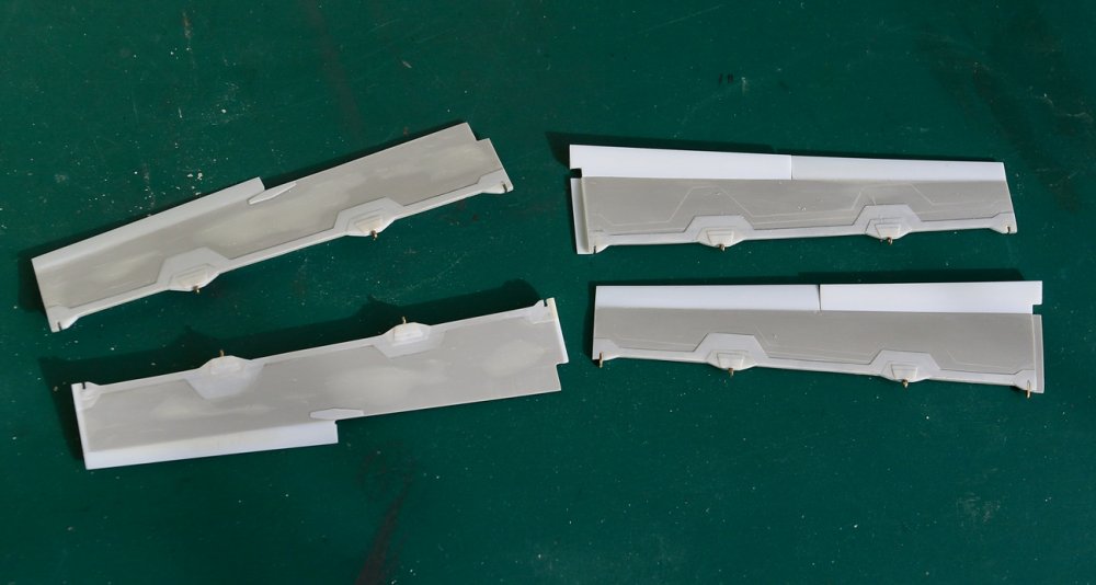

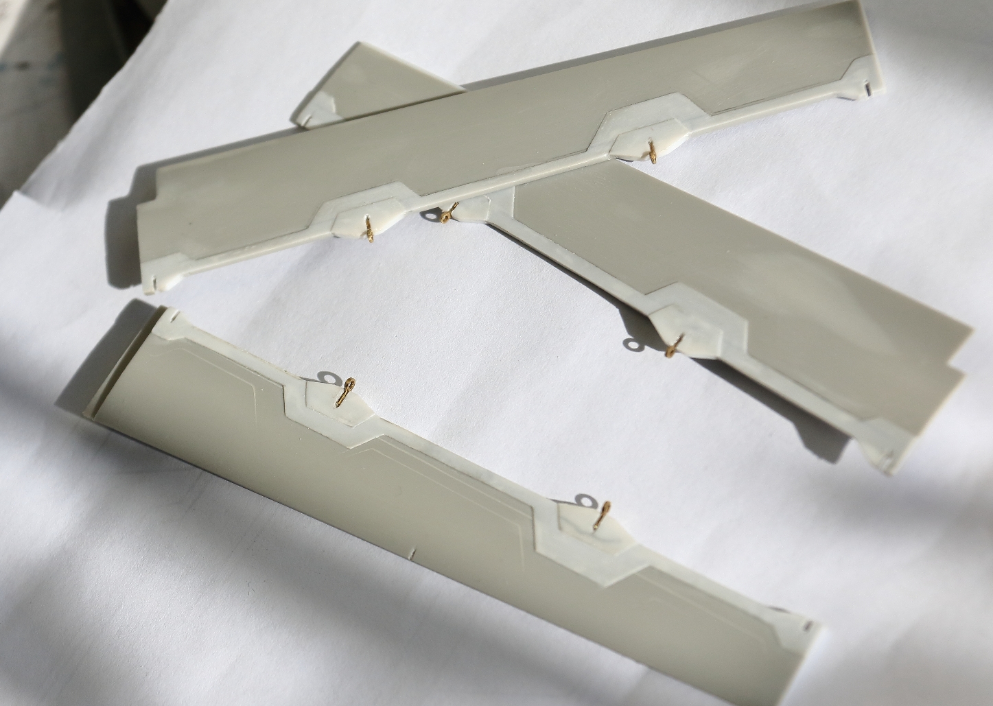

Eastern Posted March 26, 2024 Author Share Posted March 26, 2024 Well, more updates. Now on the ailerons and flaps. As the hinges I used some brass stuff leftover from my wooden ship kit. Quote Link to post Share on other sites

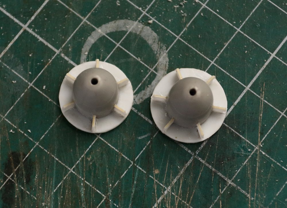

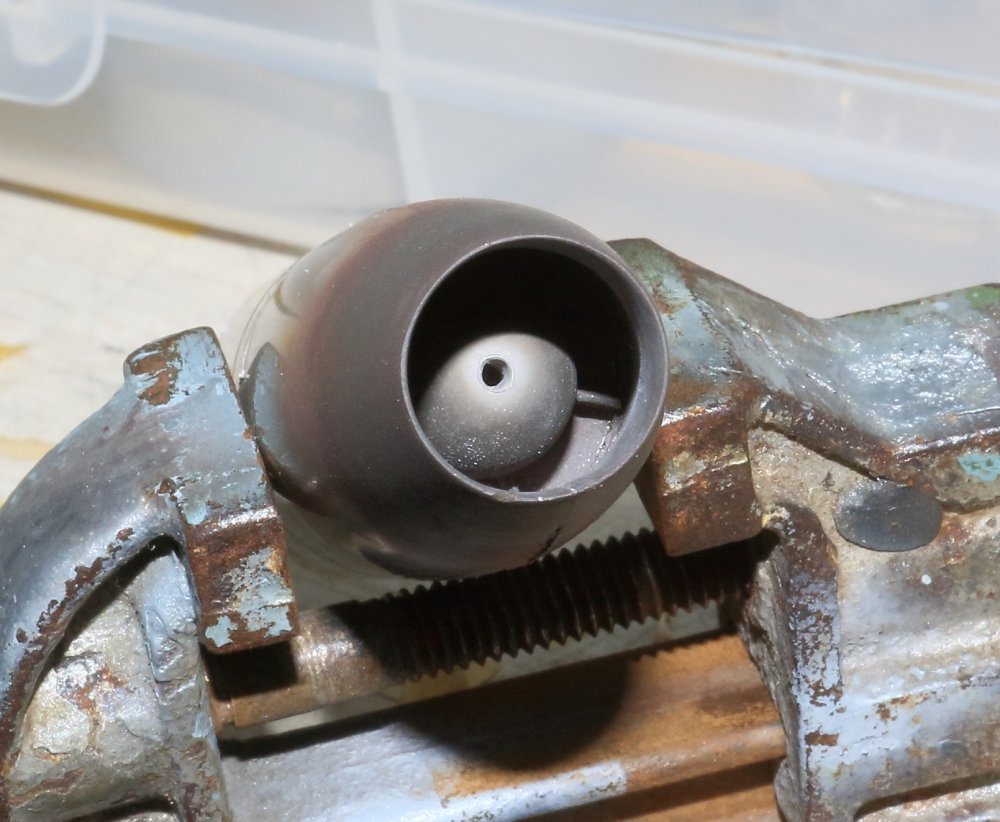

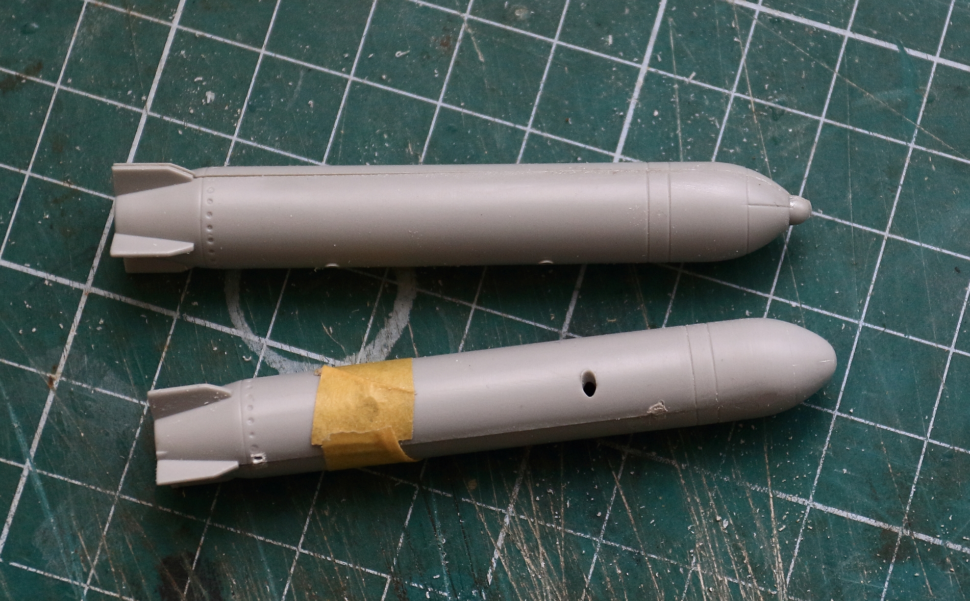

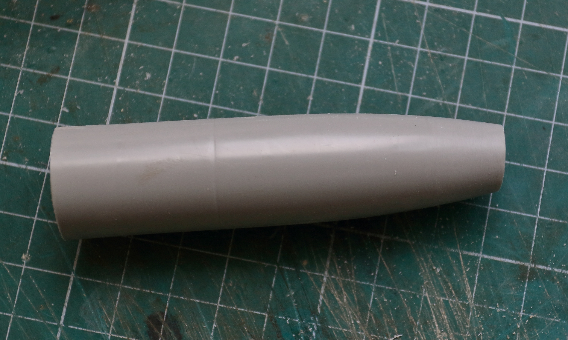

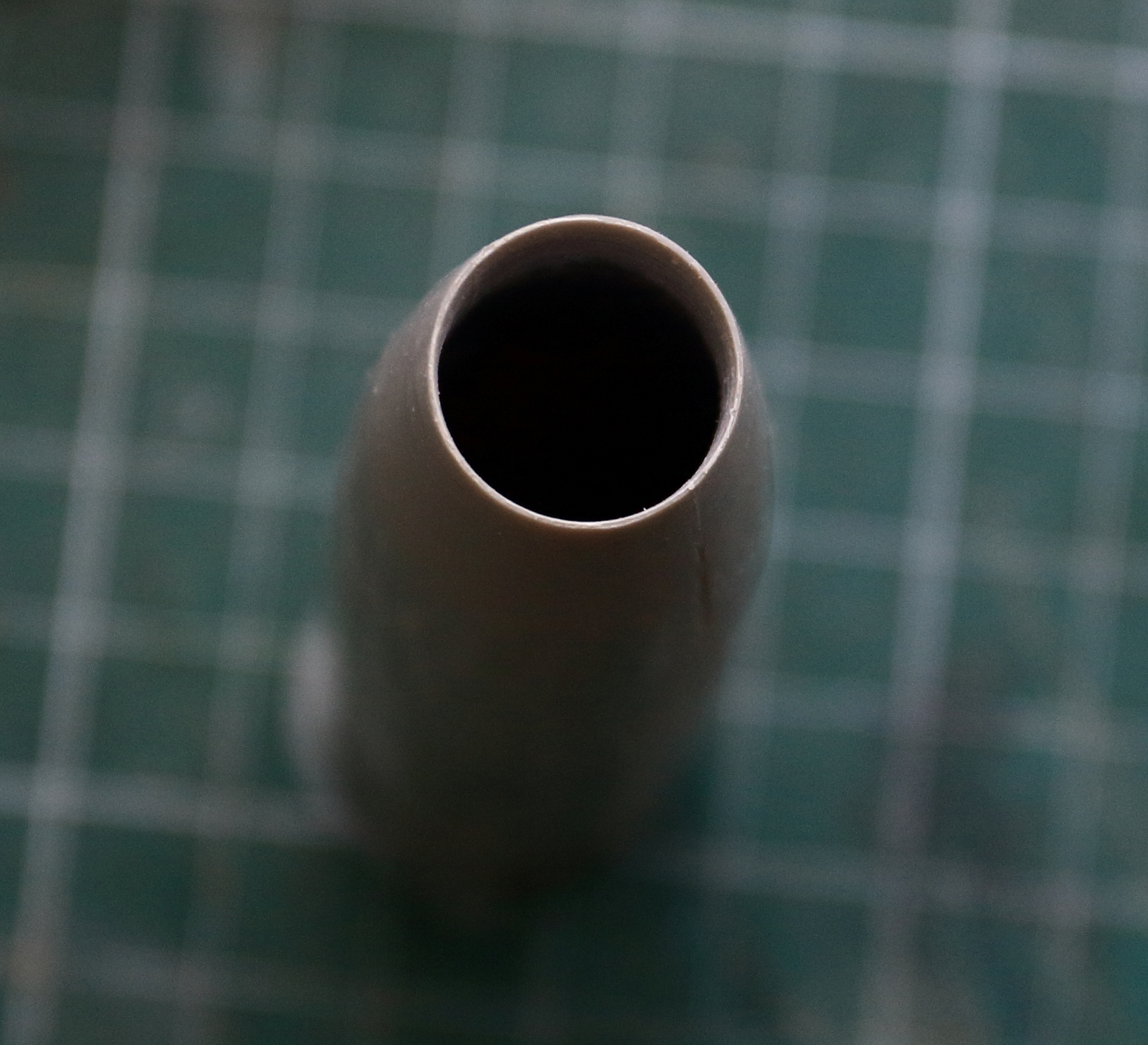

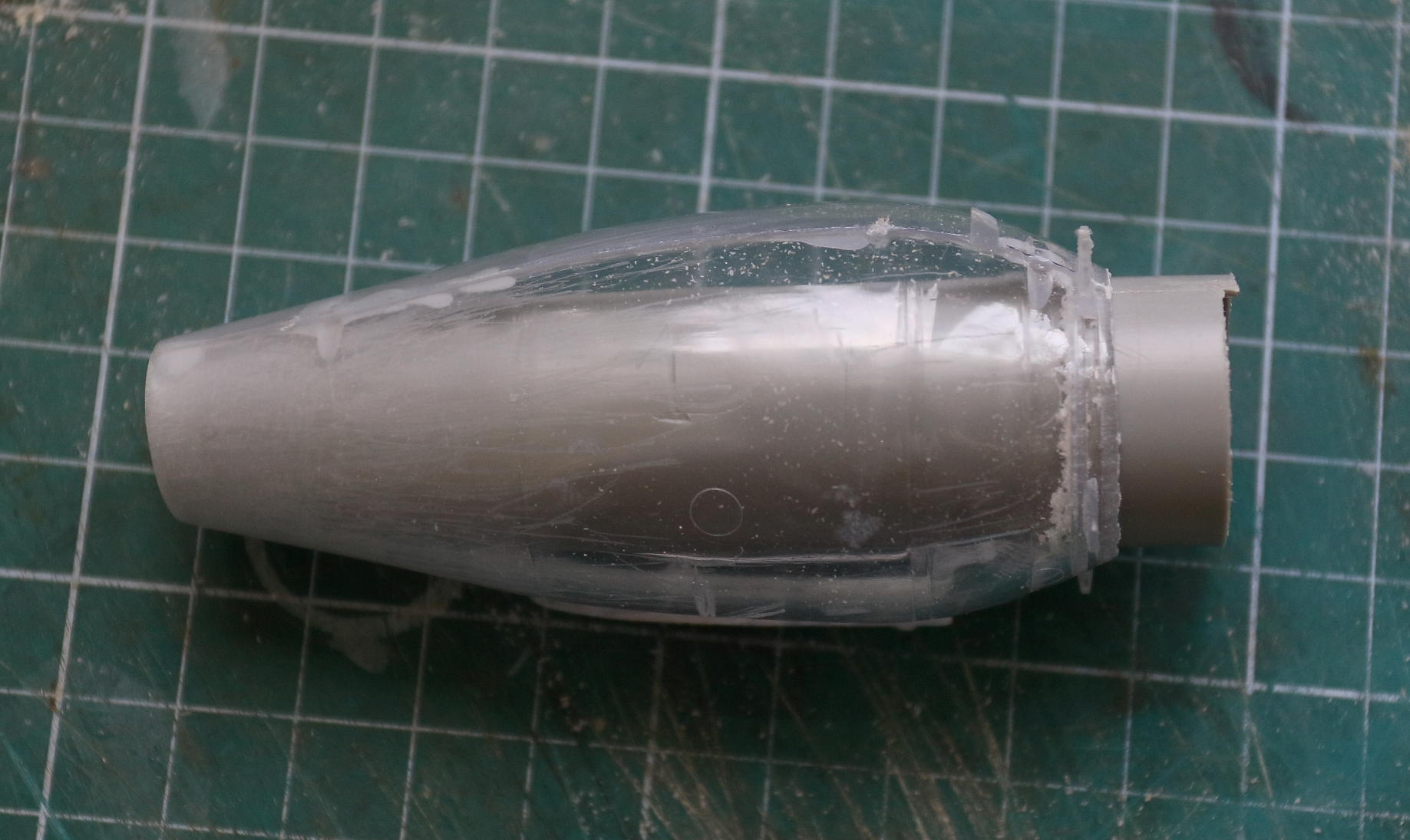

Eastern Posted July 17, 2024 Author Share Posted July 17, 2024 Hi each and everyone. 🙂 After a long delay I decided to post some images concerning the exhausts. Among the kit sprues I found a CL drop fuel tank so I thought it would fit nicely due to its length and diameter to make two pipes. Another sprue contained bombs with the nose suitable to be shaped into that bulbous thing one can see on the engine's rear end (have no idea how they call the stuff). 🙂 So this is how it turned out: Quote Link to post Share on other sites
