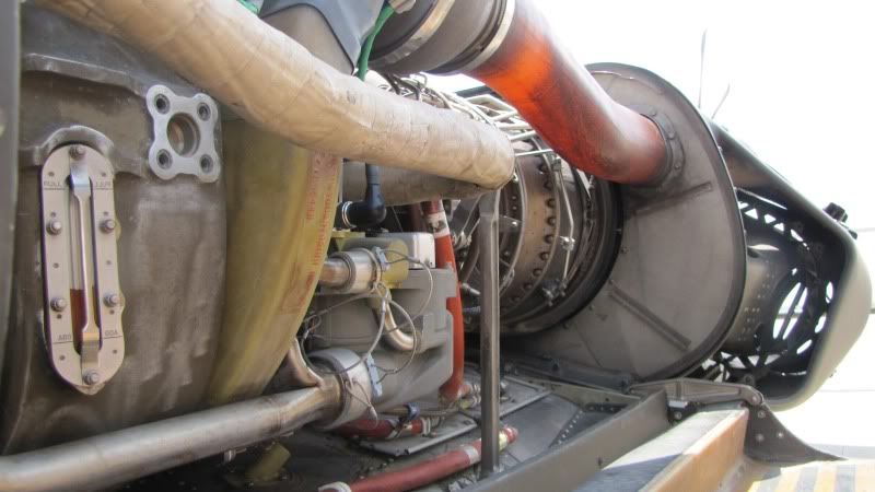

Here's a USN example, rear wall here too looks (to me) to be a dark grey metallic.
Also unlike the pics above of Army/USCG, for Navy the work platform interior is (usually) green/yellow, this specific one below including the front support edges, others like the second/third pics instead with black there.

Here's another photo of the open bay..
Thecolor of the rear bulkhead is dull metal, titanium likely since it is abutting the hot (VERY HOT) section of the engine. the work platform is cured fibreglass/

I was an Chief Aviation Electricians Mate on H-60B/F/H/R/S for 17 years and can tell you that all Navy H-60 engine bays are bare aluminum on the bottom and inboard side .  The front is actually part of the intake and is part bare aluminum and part fiberglass.  The aft part and the exaust itself are titanium, thats why the back part of the last pic poasted looks gray, Titanium is not coated on Naval aircraft as it forms an oxide on its surface that is tougher than any coating and gives it a dull aperance.  The door is kevelar with a fiberglass honeycomb core. Hope that helps.
