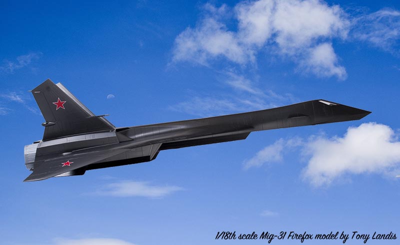

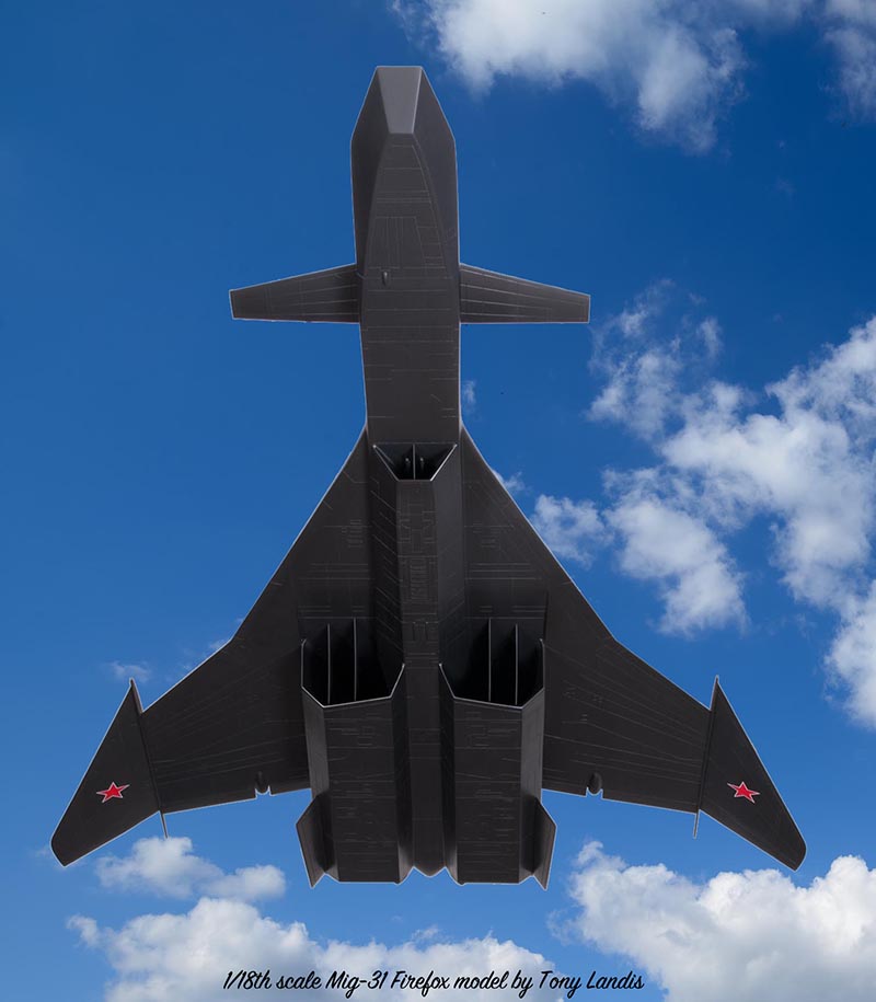

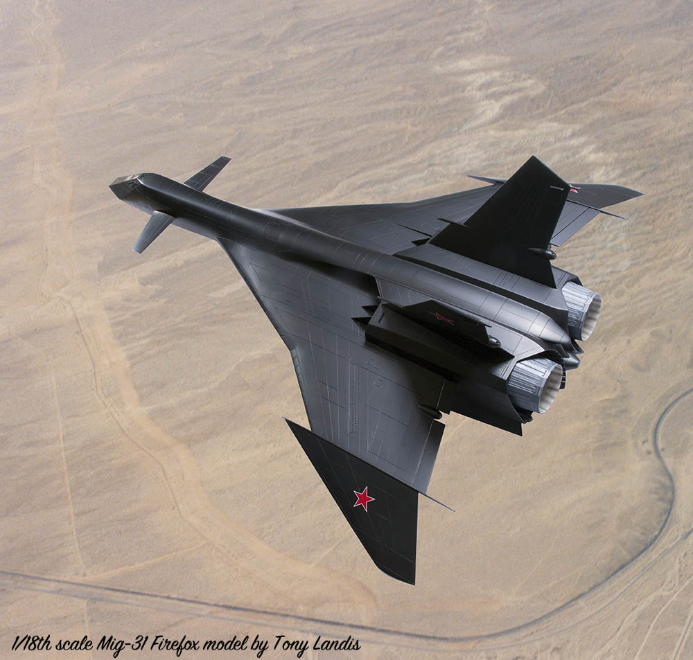

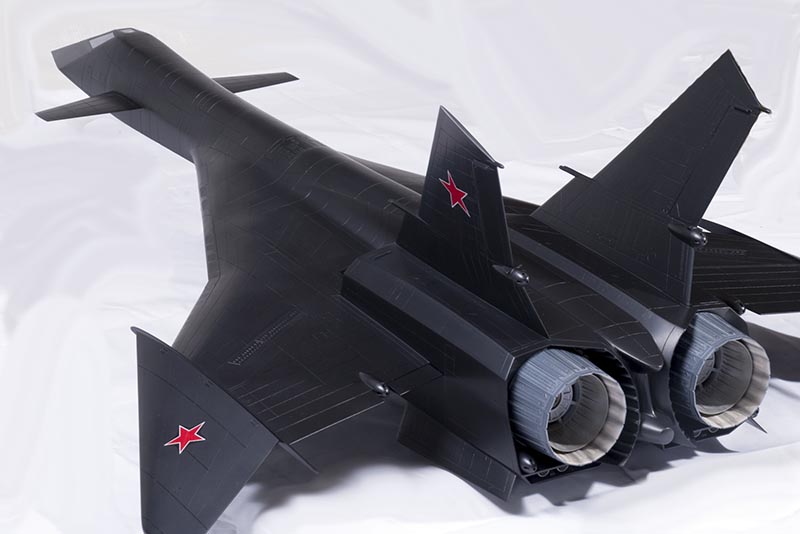

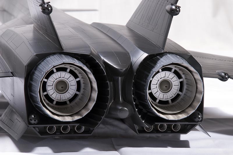

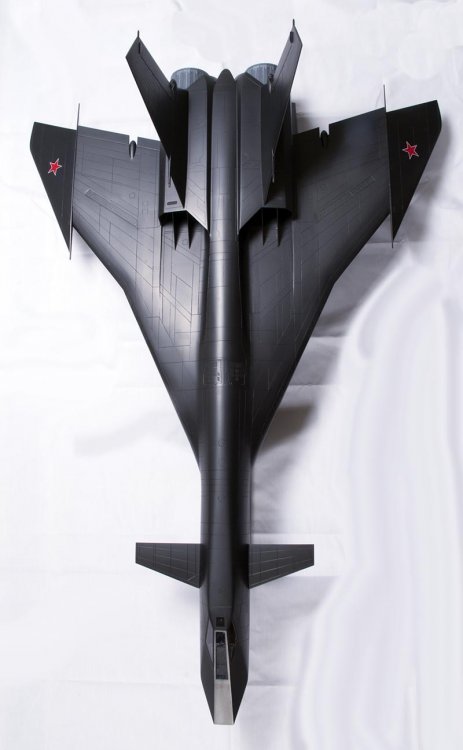

X-Plane Fan Posted October 26, 2022 Author Share Posted October 26, 2022 Well, I think it's about time I wrapped this up. In actuality, it took about 4 months to finish this model, but it was time well spent. With wet sanding and final details addressed, I painted the intakes and splitter plates before they were installed. The big challenge was getting the correct color. I knew the movie mockup and models were not black, so I reached out to my friend John Eaves, who has been in the movie model business for much of his life. Having worked with the guys who made the actual mockup and models, he informed me that the color used was not paint at all, it was Dietzgen Opaquing Fluid. An alcohol-based liquid that used carbon dust to make it opaque. Primarily used in the custom photo and old printing industry for covering pinholes in lithographic film. It's long out of production, so finding a suitable paint substitute became the challenge. After a lot of testing, I came up with a 50/50 mix of Rustoleum Black Chrome and Rustoleum gloss black removed from the spray can and diluted with lacquer thinner at 2:1 and airbrushed with a Paasche VL and #5 needle/tip. The results are exactly what I was hoping for; shiny yet dull, black but not totally black. The outside of the exhaust nozzles used the same black chrome with a bit of blue tint. Decals are custom, Alps-printed type. The model is designed to place on a stand, but I chose to simply make a cover for the hole that can be removed if I ever change my mind. It will now hang in my model room along with a couple other oversize kits. The Firefox model has quite a menacing look in person. Just for fun, a 1/72 scale Bede BD-5 on the canard of Firefox. Quote Link to post Share on other sites
A-10 LOADER Posted October 26, 2022 Share Posted October 26, 2022 Wow congrats, pretty cool and definitely a one of. Nice to see the Paasche VL get some love as well. I thought I was the only one who still used them. Steve Quote Link to post Share on other sites

Bsin Posted November 3, 2022 Share Posted November 3, 2022 On 10/26/2022 at 12:44 PM, X-Plane Fan said: Well, I think it's about time I wrapped this up. In actuality, it took about 4 months to finish this model, but it was time well spent. With wet sanding and final details addressed, I painted the intakes and splitter plates before they were installed. The big challenge was getting the correct color. I knew the movie mockup and models were not black, so I reached out to my friend John Eaves, who has been in the movie model business for much of his life. Having worked with the guys who made the actual mockup and models, he informed me that the color used was not paint at all, it was Dietzgen Opaquing Fluid. An alcohol-based liquid that used carbon dust to make it opaque. Primarily used in the custom photo and old printing industry for covering pinholes in lithographic film. It's long out of production, so finding a suitable paint substitute became the challenge. After a lot of testing, I came up with a 50/50 mix of Rustoleum Black Chrome and Rustoleum gloss black removed from the spray can and diluted with lacquer thinner at 2:1 and airbrushed with a Paasche VL and #5 needle/tip. The results are exactly what I was hoping for; shiny yet dull, black but not totally black. The outside of the exhaust nozzles used the same black chrome with a bit of blue tint. Decals are custom, Alps-printed type. The model is designed to place on a stand, but I chose to simply make a cover for the hole that can be removed if I ever change my mind. It will now hang in my model room along with a couple other oversize kits. The Firefox model has quite a menacing look in person. Just for fun, a 1/72 scale Bede BD-5 on the canard of Firefox. WOW!!! Quote Link to post Share on other sites
