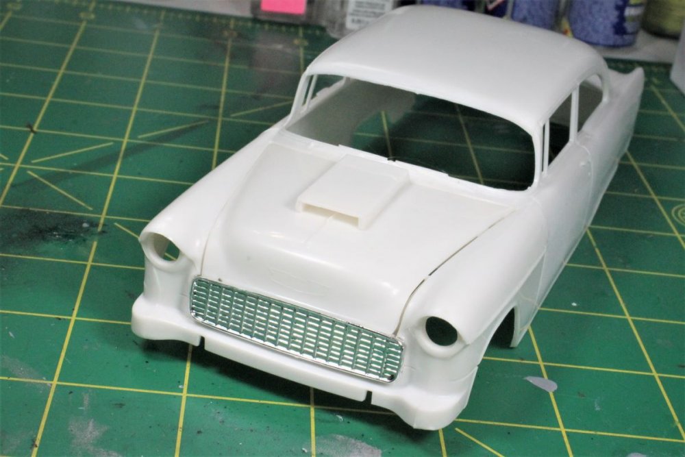

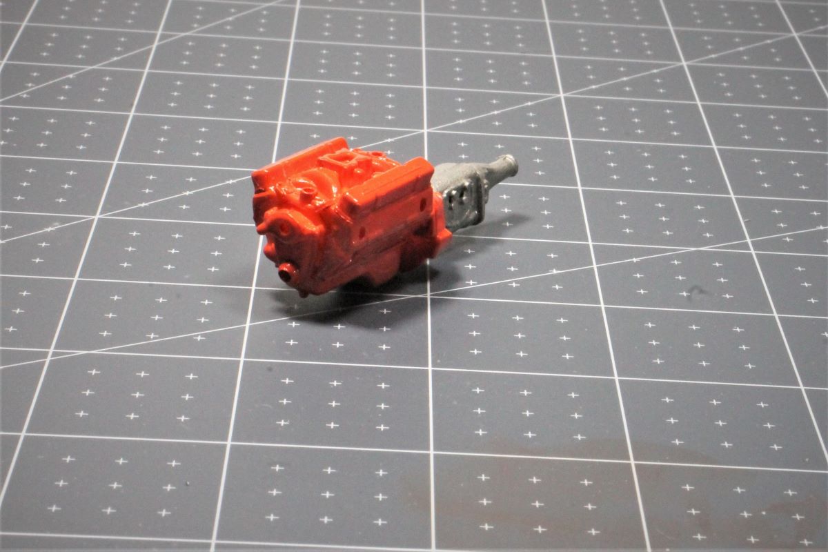

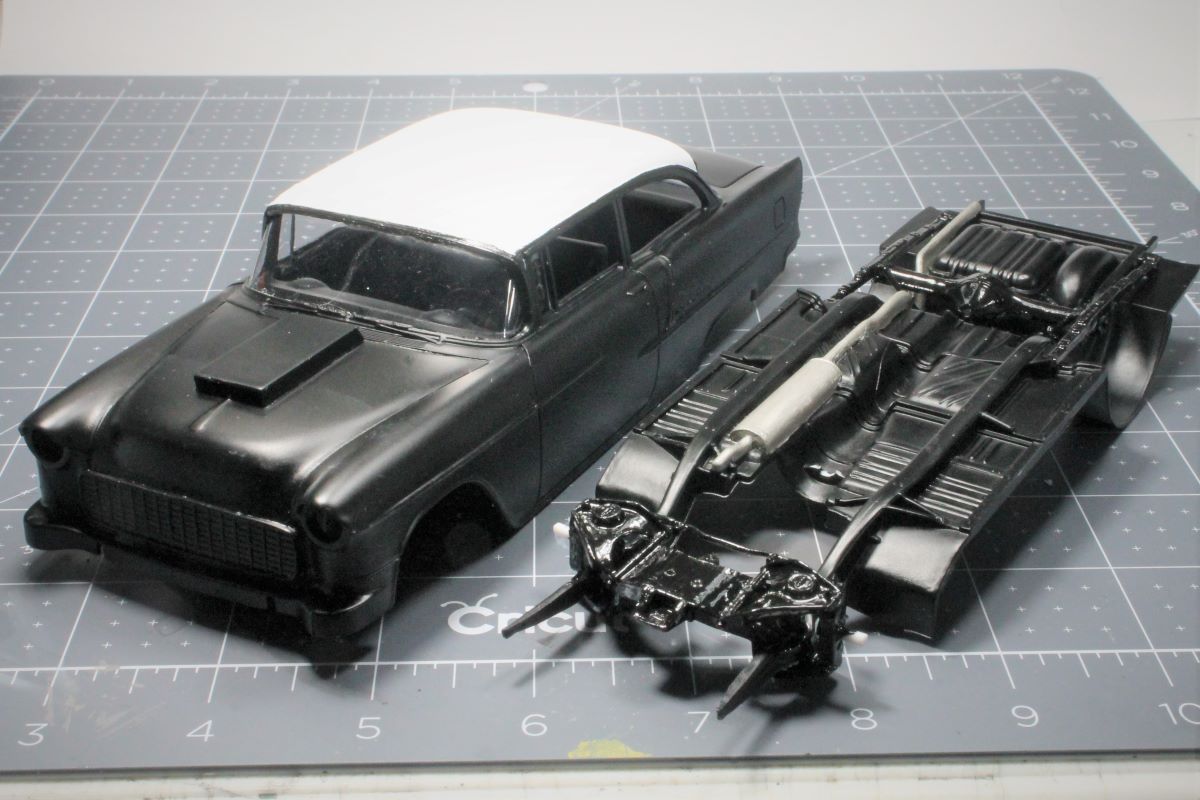

jonwinn Posted November 16, 2022 Author Share Posted November 16, 2022 I have a start on this. I sanded the Bel Air molding off the body and added the hood scoop. I am going to make a Chevrolet model 150 Utility Sedan converted into a street rod. Chevrolet had 3 models in '55, the basic model 150 bare bones car, the model 210 with ash trays and rugs, then the Bel Air which was called the "mini Cadillac" with a lot of "bells and whistles". I am using the kit 265 cu. in. small block V8 with the crossover exhaust as I do not want to attempt to sand the molded in single exhaust off the chassis. Here is where I am at, engine done and body ready for a first coat of paint. Quote Link to post Share on other sites

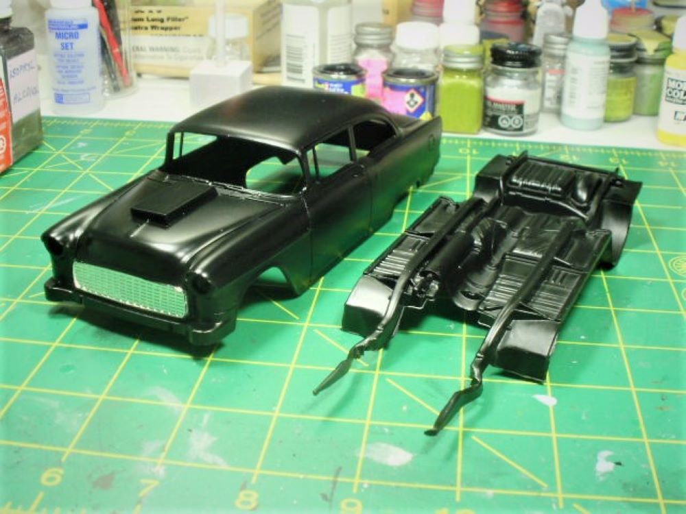

jonwinn Posted November 18, 2022 Author Share Posted November 18, 2022 The body and chassis are painted. I need to detail paint the molding on the body and exhaust on the chassis. Quote Link to post Share on other sites

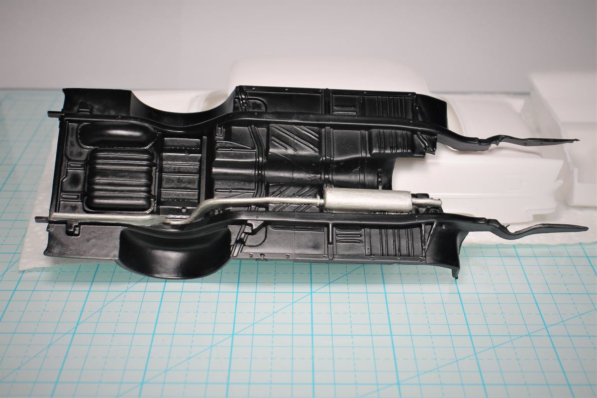

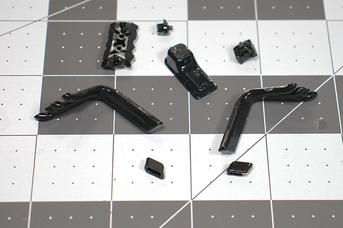

jonwinn Posted September 6, 2023 Author Share Posted September 6, 2023 I painted the chassis and de chromed some parts with oven cleaner sprayed into a sandwich bag....took less than 5 minutes. Quote Link to post Share on other sites

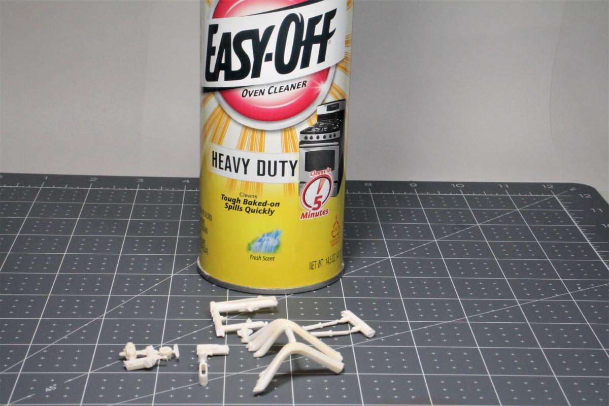

jonwinn Posted October 27 Author Share Posted October 27 (edited) I started with de-chroming the parts that need to be painted, I used my trusty oven cleaner. These were molded in black plastic unlike the white ones from the first kit. Edited October 27 by jonwinn Quote Link to post Share on other sites

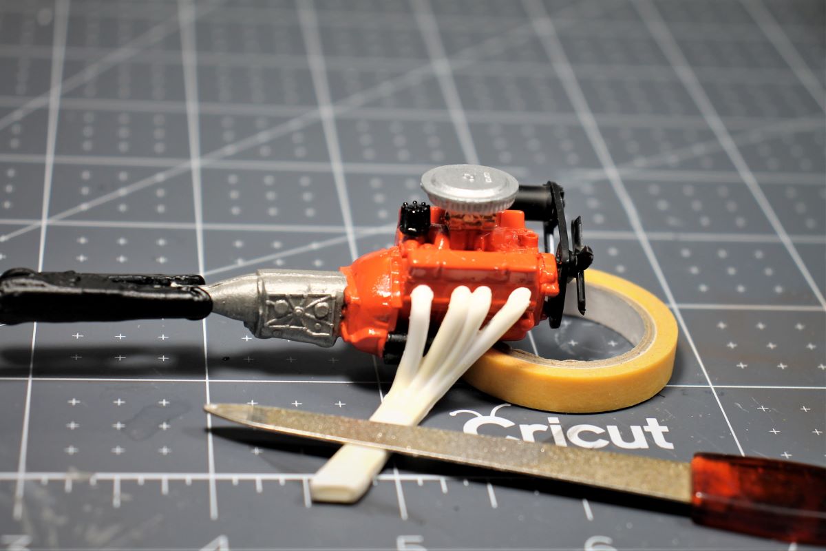

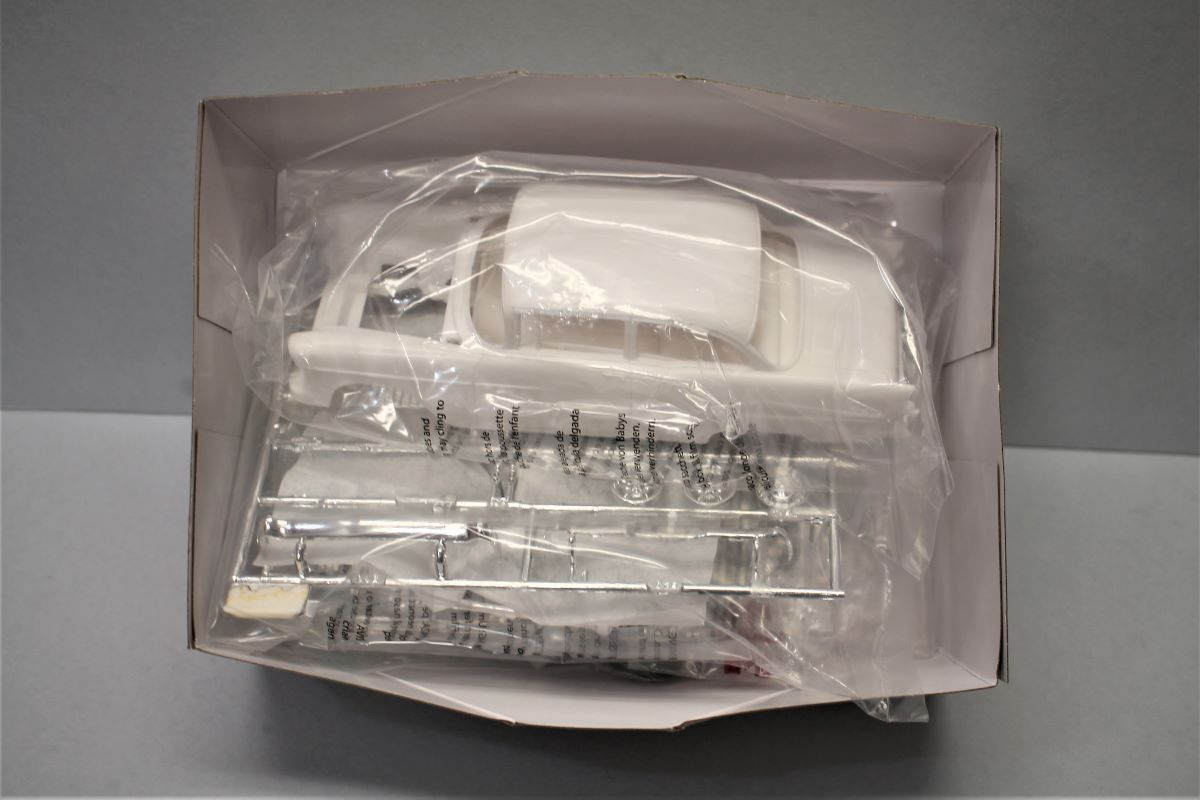

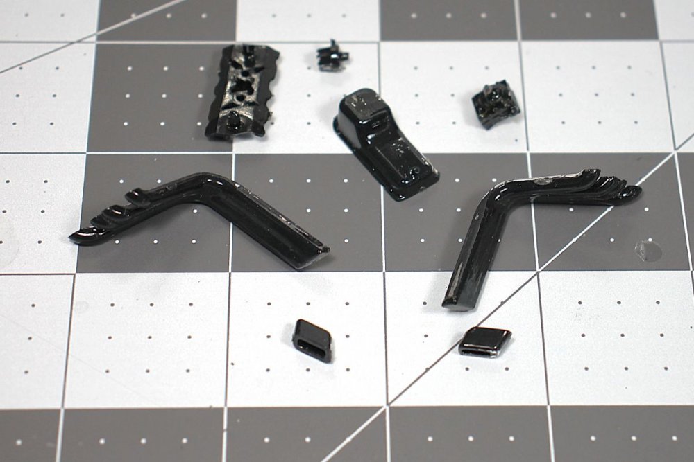

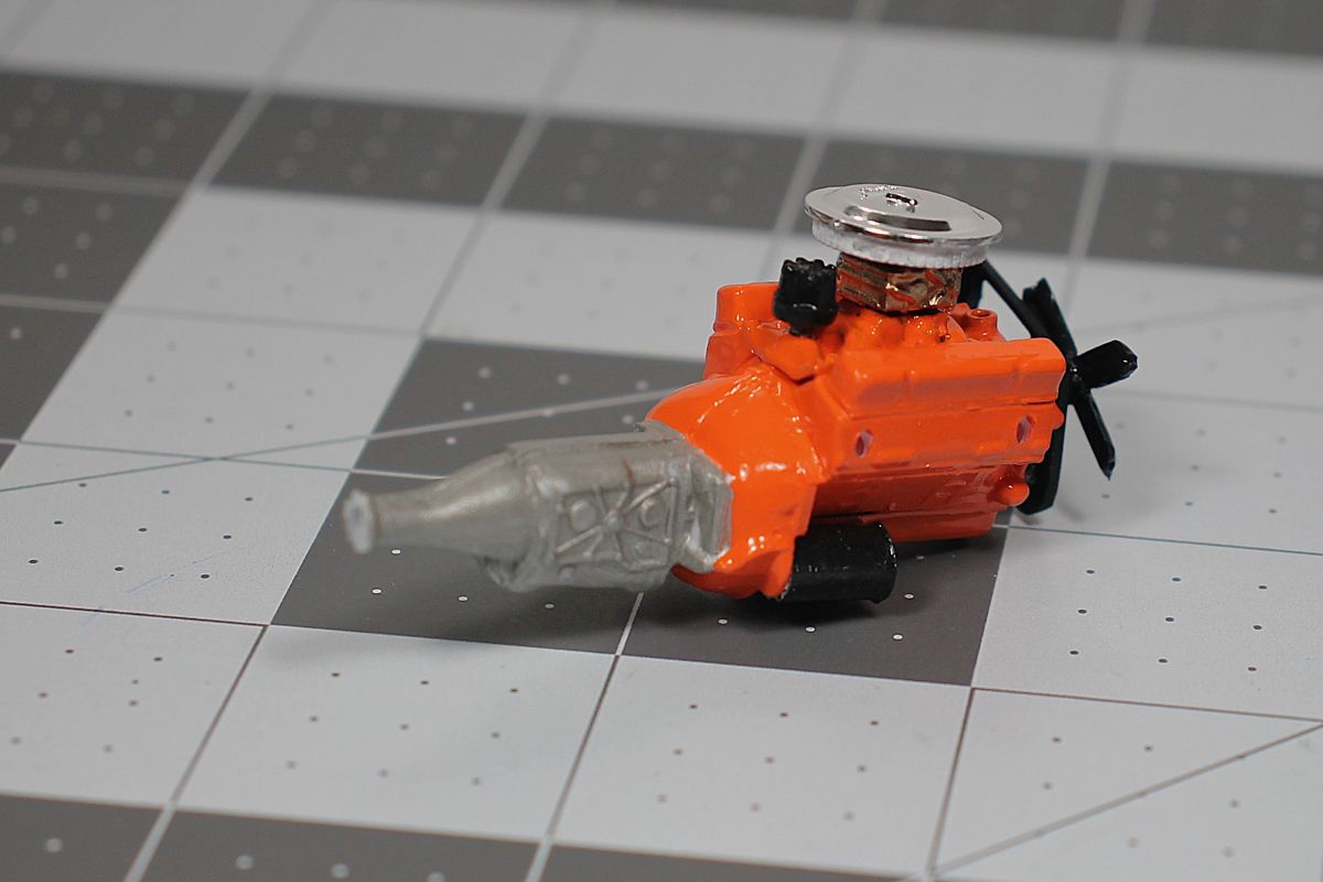

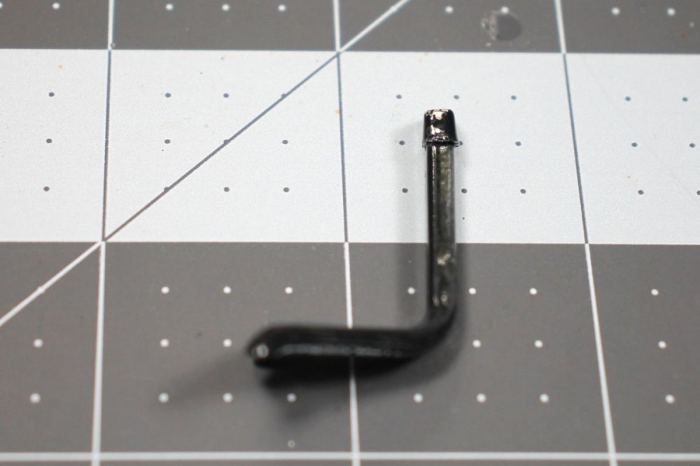

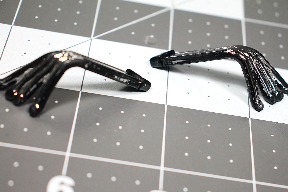

jonwinn Posted October 27 Author Share Posted October 27 I have a start. The fit is challenging to poor. I put the exhaust headers together and something is wrong. The pipes coming off the engine do not match the small flared exit pieces. I do not remember them fitting this bad plus this kit has a LOT of extra parts. It seems to have tons of parts for a "Funny Car". It seems to have lots of chromed rails and wheelie bars that this kit originally never had. There is no mention in the instructions where these extra parts go. The instructions have either "stock" or "street rod" instructions with no mention of a "Funny Car". Quote Link to post Share on other sites
jonwinn Posted October 28 Author Share Posted October 28 (edited) I think I figured out the header thicknesses. On the box cover's side panel is a picture of the header, it seems the flared exit is centered so that the extra thickness is divided equally to either side of the header, like so. Not all to one side as I had it originally. Edited October 28 by jonwinn Quote Link to post Share on other sites

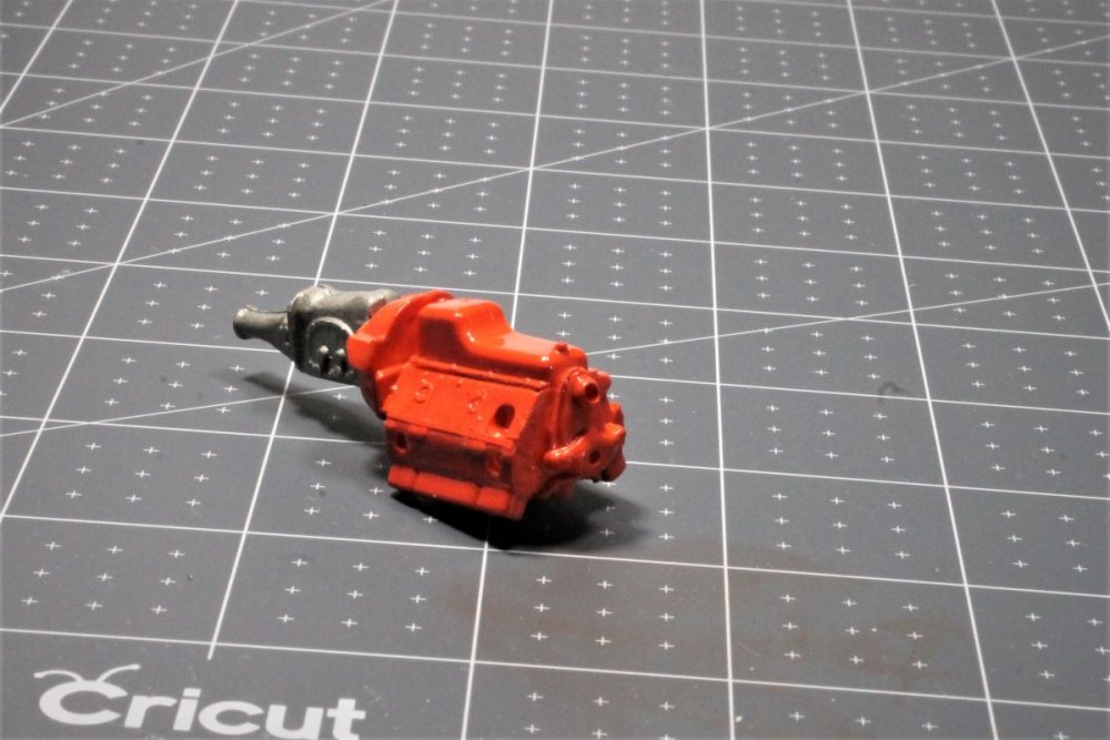

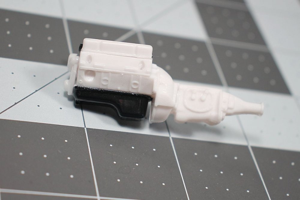

jonwinn Posted October 29 Author Share Posted October 29 Engine almost done, headers go on during chassis assembly. Quote Link to post Share on other sites

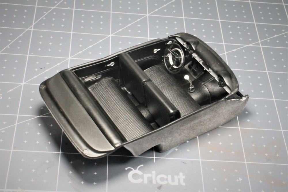

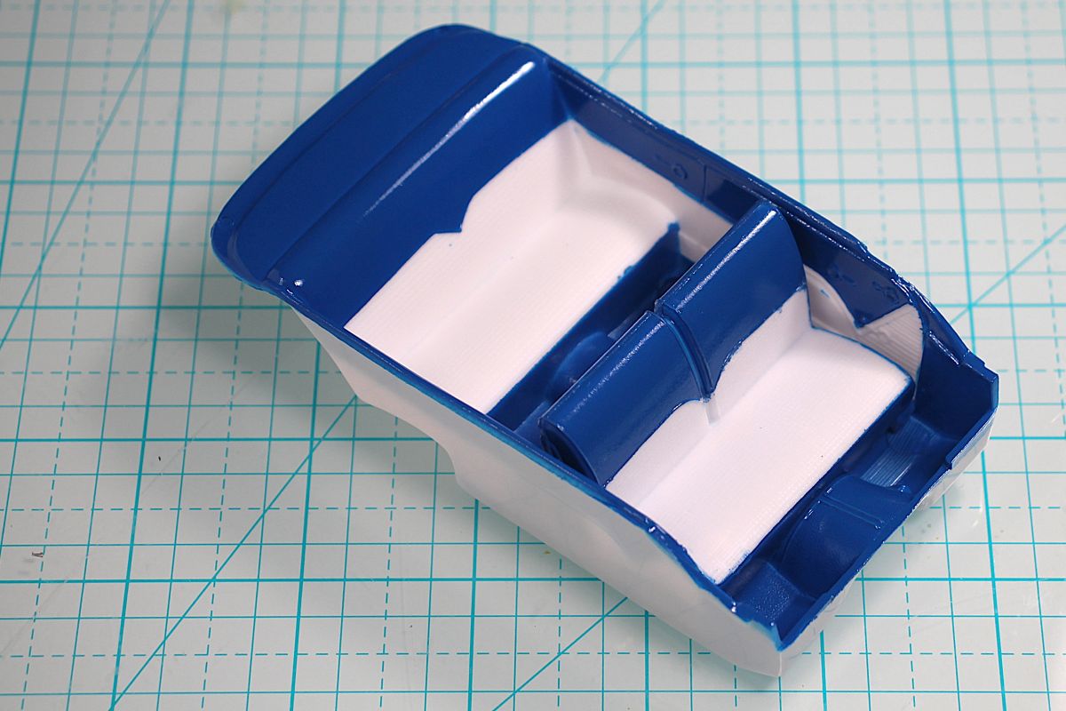

jonwinn Posted October 30 Author Share Posted October 30 The interior is started. I assembled the front seat and painted the blue, then painted the tub and rear seat blue. I need to buy some beige to do the white areas that were masked off. The front seat is not glued in yet. Quote Link to post Share on other sites

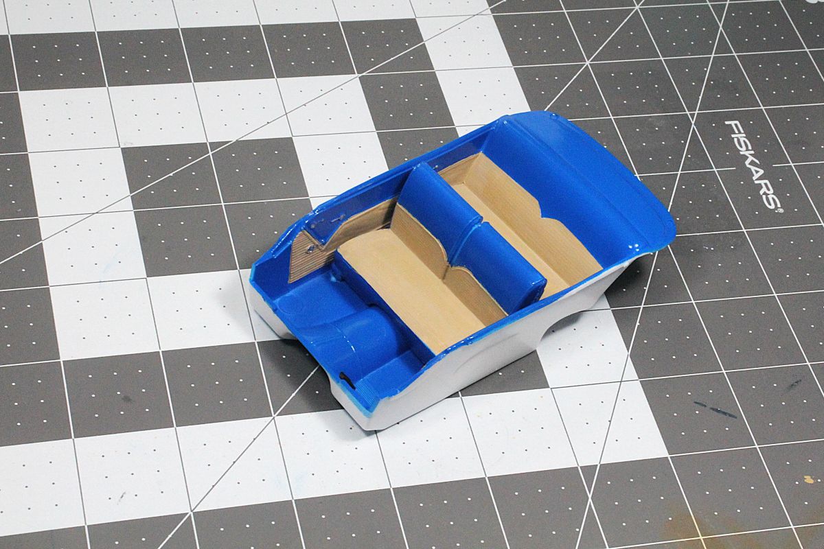

jonwinn Posted November 1 Author Share Posted November 1 (edited) Interior colors done. The kit comes with an arm rest for the rear seat. From all the images I have seen there was no arm rest of this style on the Bel Air, it did exist on the 1955 Chevrolet 210 model however. The brown interior below is a 1955 Chevrolet 210. Edited November 1 by jonwinn Quote Link to post Share on other sites

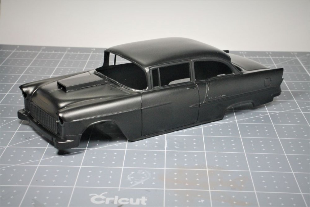

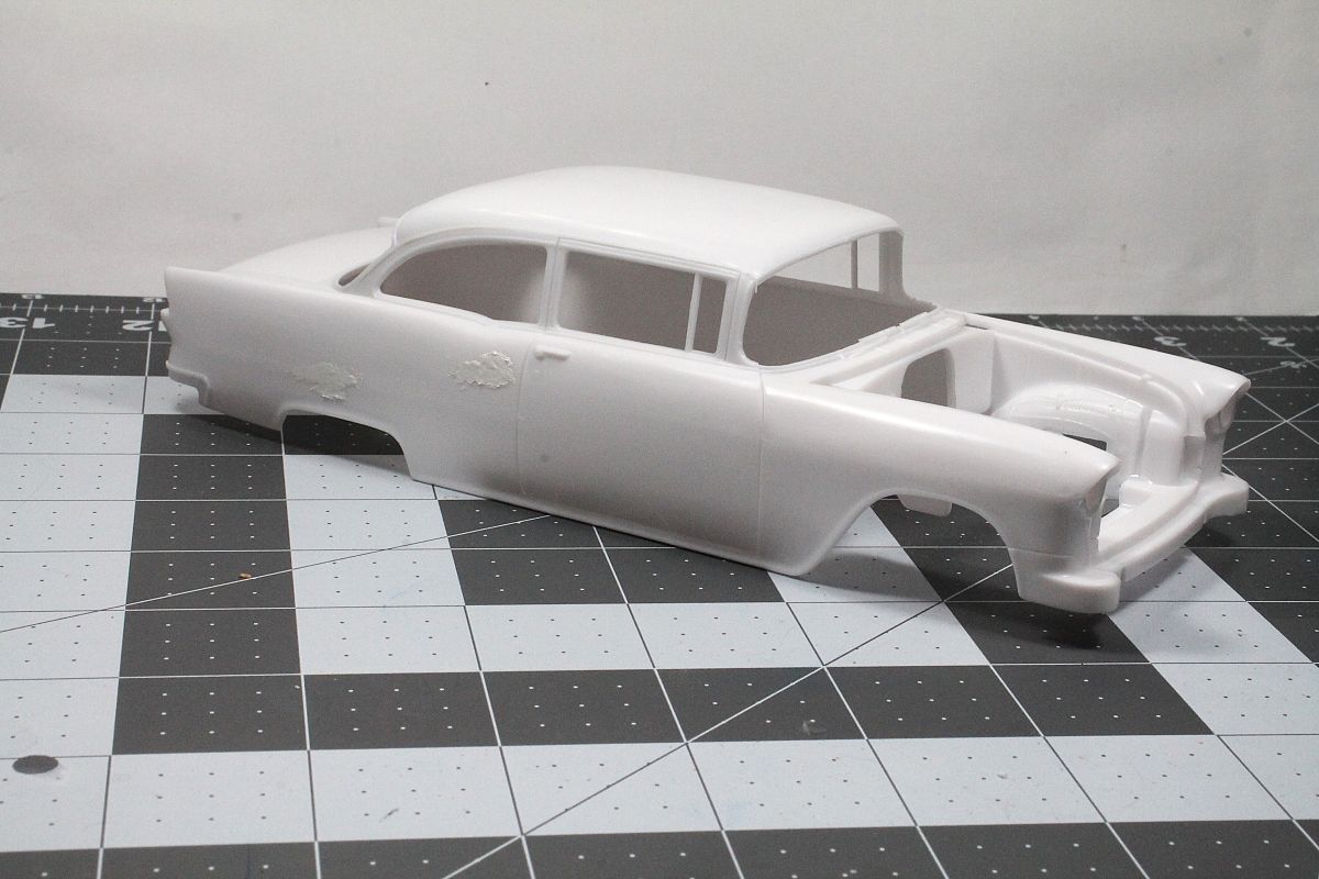

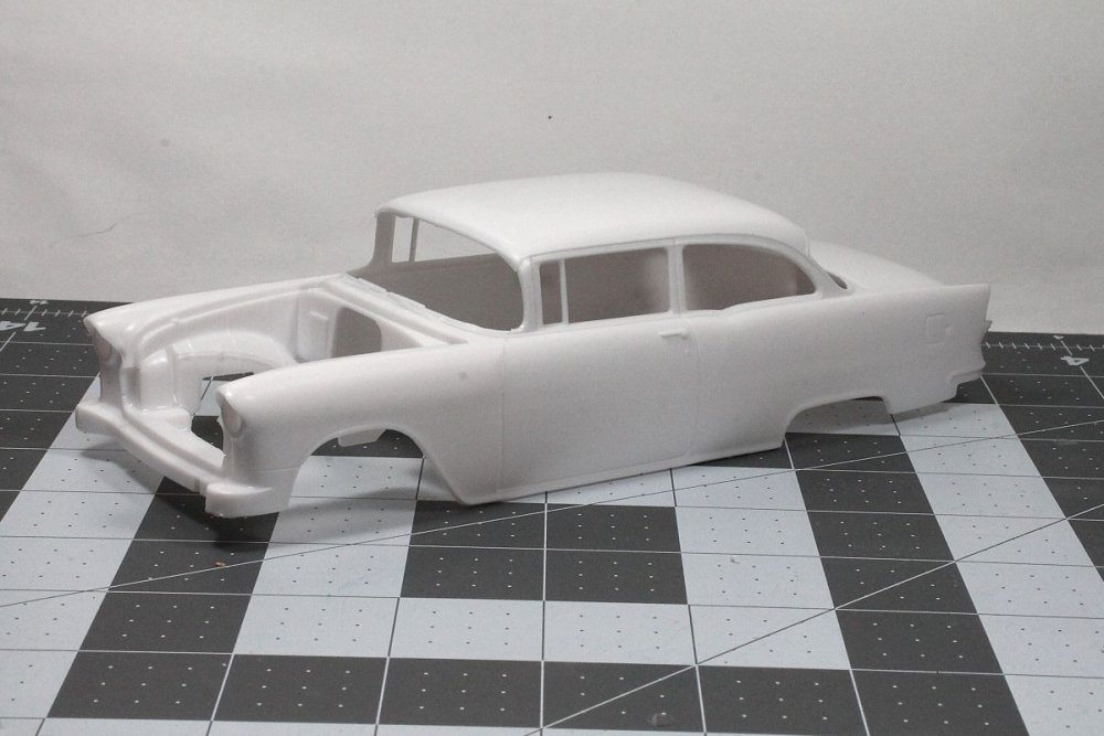

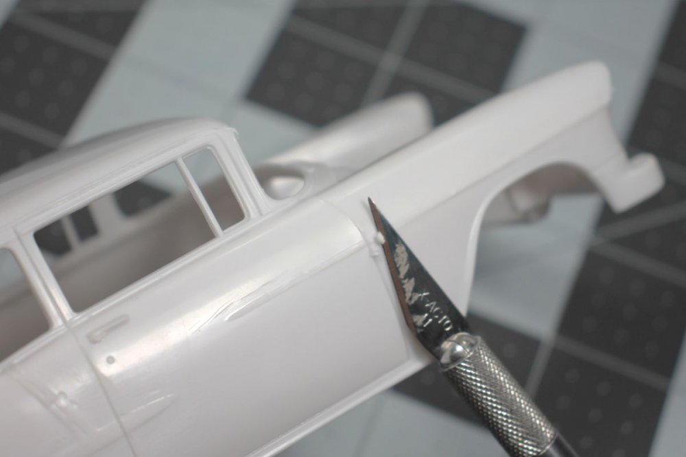

jonwinn Posted November 1 Author Share Posted November 1 (edited) Now to the not so fun part, removing the body molding. I did this once on a '65 Galaxie. The best way for me is to trim as close as I can with a sharp Exacto knife then sand starting with 180 grit to about 1000 grit wet dry sand paper. I am only doing the molding that runs down the side of the car, front quarter panel, door and body, and rear quarter panel and bow tie on the trunk. Tedious but effective. I am very cautious with the Exacto, ended up in the emergency room a few years ago for stitches in my thumb. That was less fun than sanding! Edited November 1 by jonwinn Quote Link to post Share on other sites

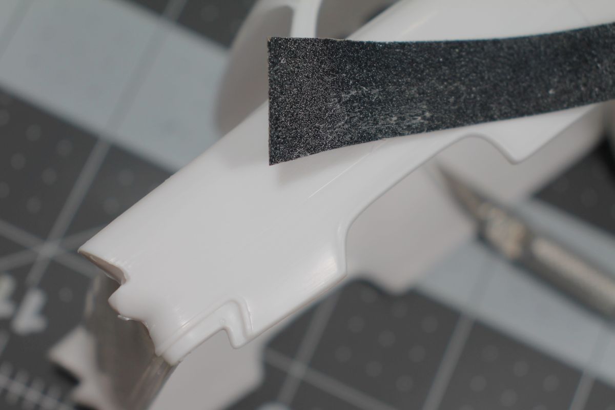

jonwinn Posted November 1 Author Share Posted November 1 (edited) An hours worth of knife work then wet sanding from 120, 180, 350, 400, 600, 1000, then 1500 grits. I still have a ghost line from the rear of the door to the tail light and 2 holes I need to putty where I went too deep with the knife. I need to redo the finer grits then maybe go from 1600 to 6000 grits. Lots of small scratches. Edited November 2 by jonwinn Quote Link to post Share on other sites

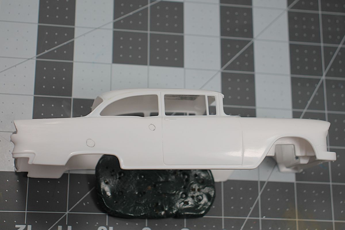

jonwinn Posted November 4 Author Share Posted November 4 I have the left side sanded and the right side "holes" puttied. I need to get some wet -dry sand paper from 2000 to 6000 grit to get rid of the fine scratches, sorta polish my mess up a bit. Quote Link to post Share on other sites
