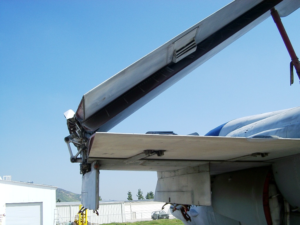

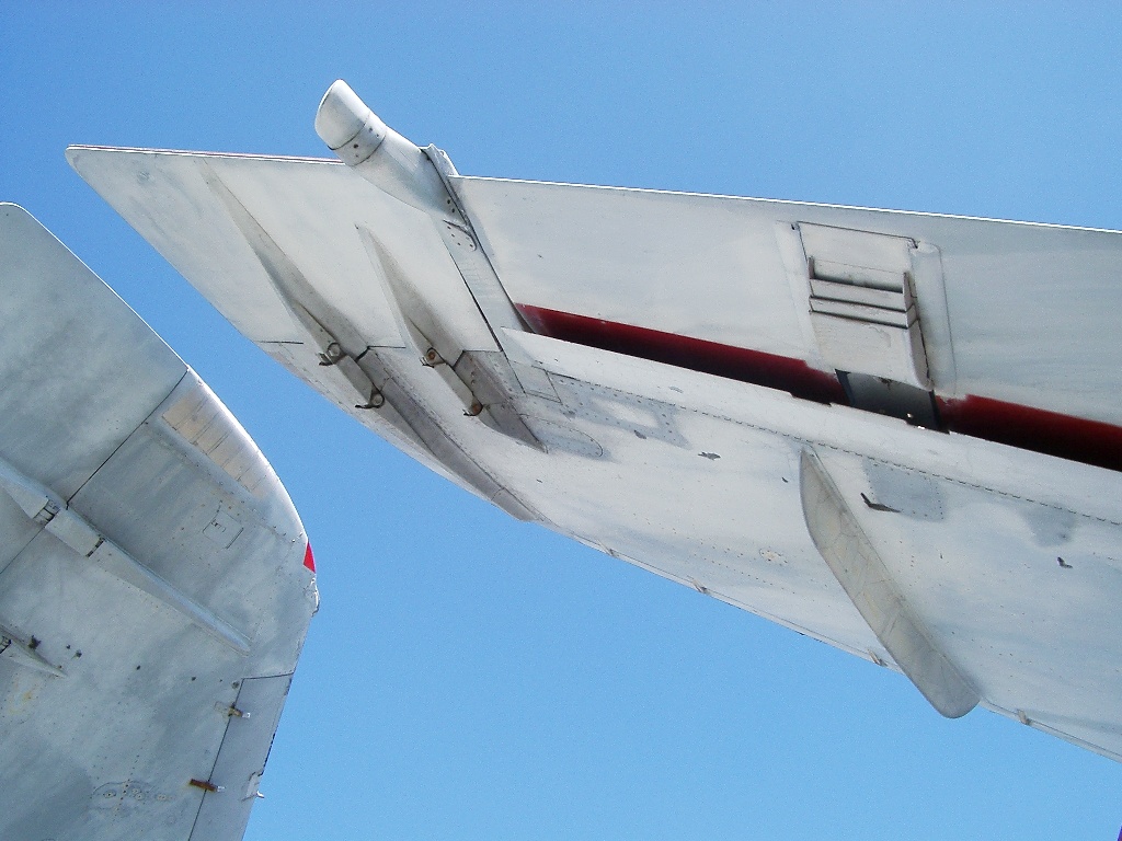

josefgarcia69 Posted February 11 Share Posted February 11 On 2/6/2023 at 7:33 PM, crackerjazz said: Hi Steve, Thadeus, RichB63, thanks guys! : ) I was hoping to post a little more progress on the flaps, but I'm kind of reworking the 3D details a bit and I'm actually stuck on one of the areas -- specifically the flap-track fairing which consists of overlapping lobes like a lobster tail's. On the Kinetic and Hobby Boss flap-down track parts I see 2 overlapping lobes only so I went with that on mine. I was thinking the reason for that was because the lobes splay out during operation and the 3rd one becomes hidden? There do seem to be just 2 lobes on the flap-track fairings of this Intruder. Or could it just be the photo's fuzzy? On this guy I see 3 overlapping lobes. I also compared photos of flaps retracted and extended and the separation between the lobes looks the same. They don't seem to splay farther apart or anything in the flaps-down position. Anyone know if the fairings actually came in different versions? Wonderful work and very inspirational. Please, keep it coming. In the meantime, here are some pictures: From the site Prime Portal and Airliners.net Quote Link to post Share on other sites
